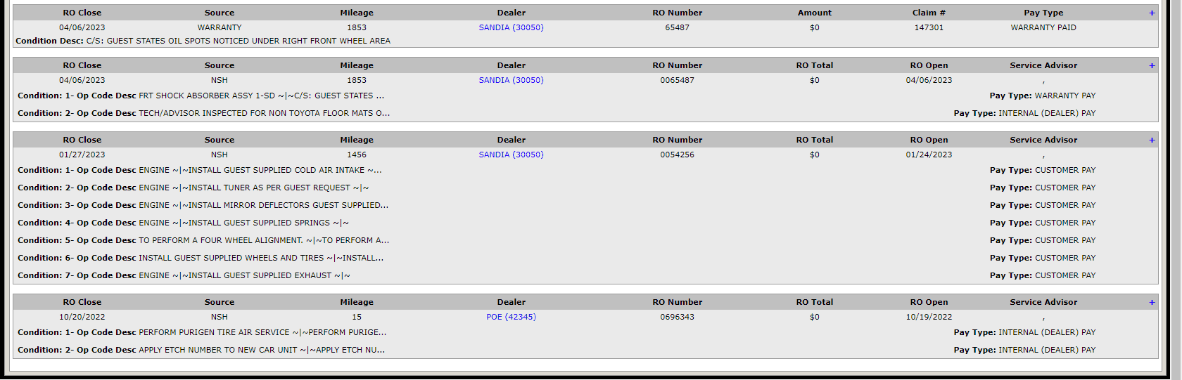

Only the RIGHT FRONT was replaced, due to excessive fluid leaking past the shaft seal (enough to drip onto the ground). They determined the aftermarket lowering spring was not at fault for the issue, and the seal was defective out of the gate.
Thanks so much for looking that up. This also confirms my suspicion that this car has been modified (looks lowered in pictures). So I'll be walking away from this one.

Iā€™m actually surprised that a dealer did warranty work and replaced the strut on a car that was modified.
bet that someone at the dealership owned the car.
Could be. You can also see that they had the dealer install a bunch of the aftermarket parts.
