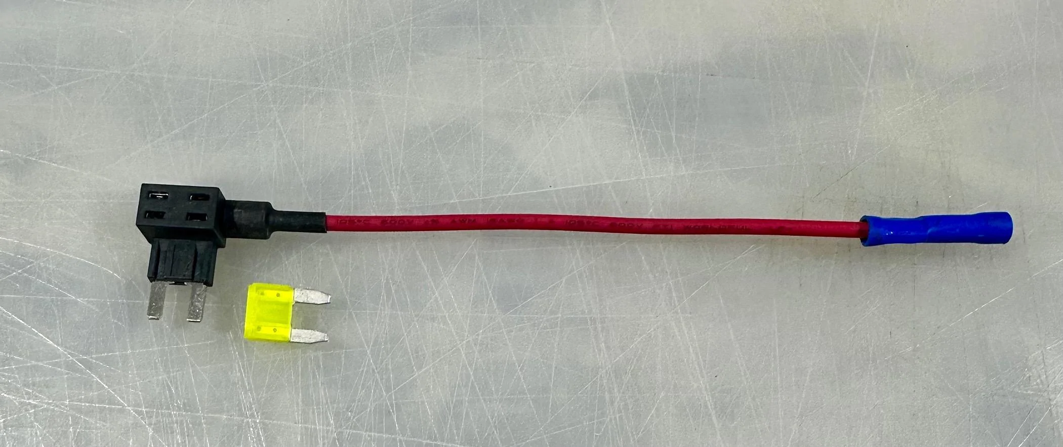

there actually is a plug and play tap in option with the Blendmount and pulling power from the mirror. Thatā€™s how I did it in my M4cs and my Supra with the Redline 360c.
When I had my C63s, I had to tap from the fuse box and she pulled power right from the mirror on her M4. I was jelly. So when we got the Supra, I said ā€œhey you know exactly how this install goes since you did your M4, so youā€™re doing it on my carā€
took her 15 minutes
You're right, they do sell taps. I use it on my STI. However, I could not tell which wire was the right one to tap back 4 yrs ago when people did not know what a BMW Supra was :crazy: so took the safe route and just tapped the fuse box.

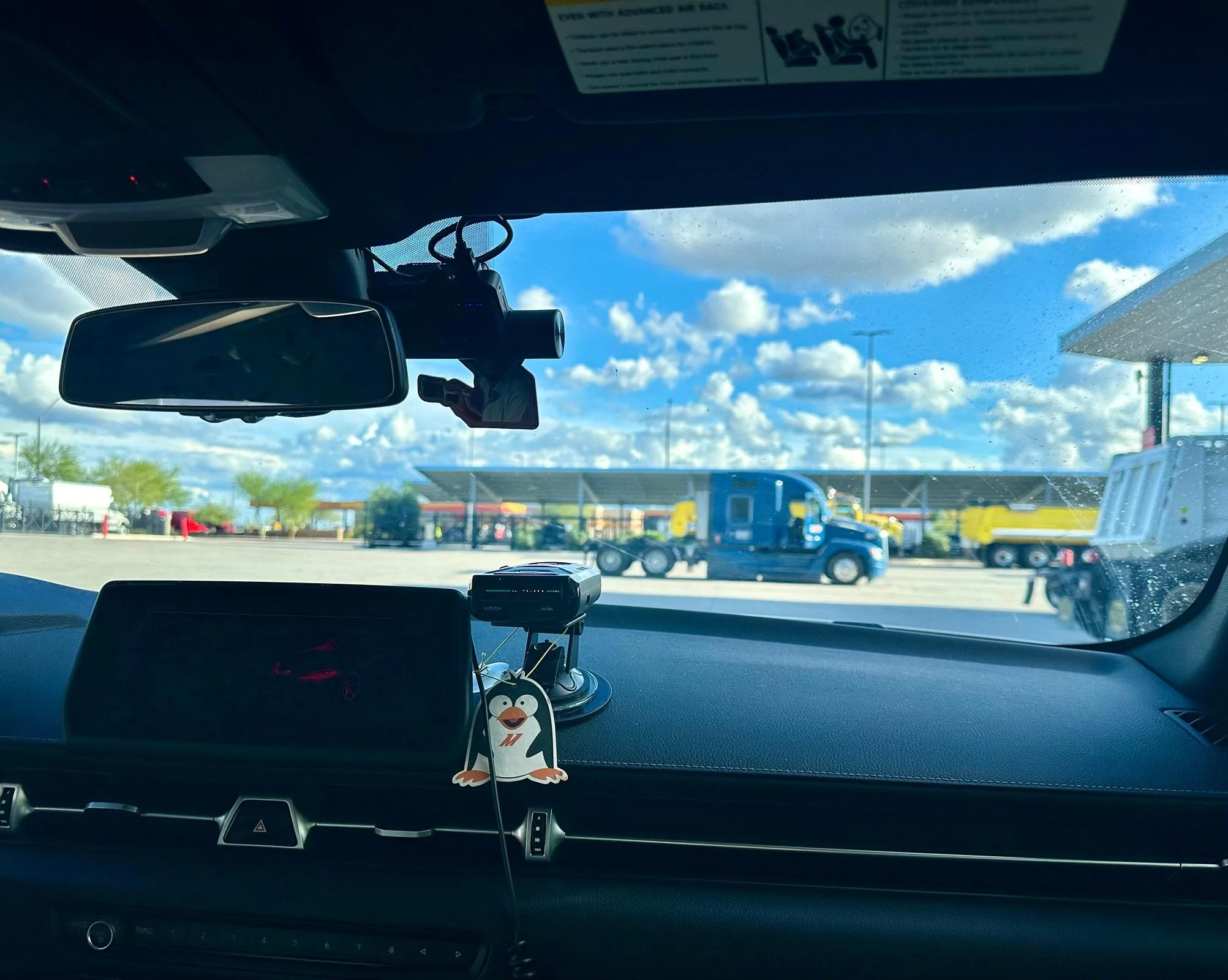

Right there with you puzzled. Here's my install of my R7.

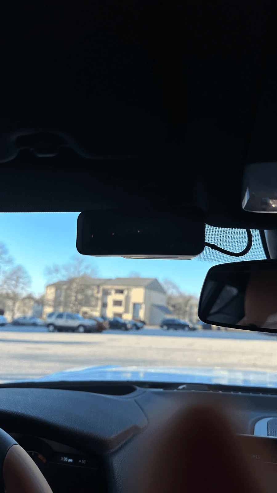

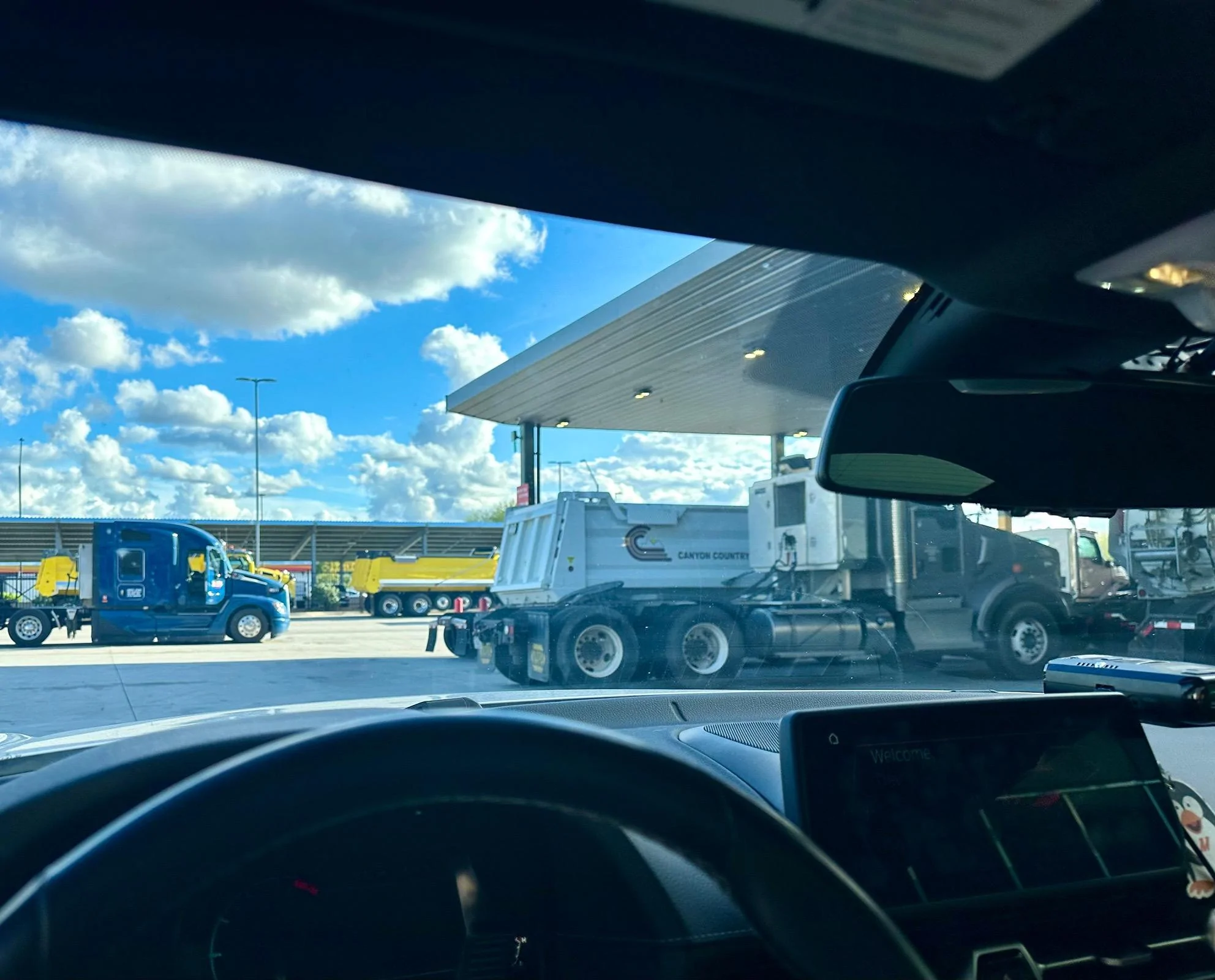

I replaced the two suction cups which tend to fail anyways with 3M plastic velcro tape (similar to this one https://a.co/d/7cdqqZ0 ) and got everything as close to the headliner as I could. This way I can move it from one vehicle to the next whenever I want to. These cars already have terrible visibility and getting a mount that hangs the radar under the rearview mirror or even using the larger suction cup mount that comes with the radar was just gonna make things worst IMHO. I can still use the visor within it's usable/effective range, just not fully open it which for me was perfectly fine.
Just want to quote this for emphasis, as my experience is the same. There's already a decent blindspot on the other side of the rear view mirror, no need to make it larger. I have mine tucked up by the headliner as you've shown and it doesn't impede visibility at all.

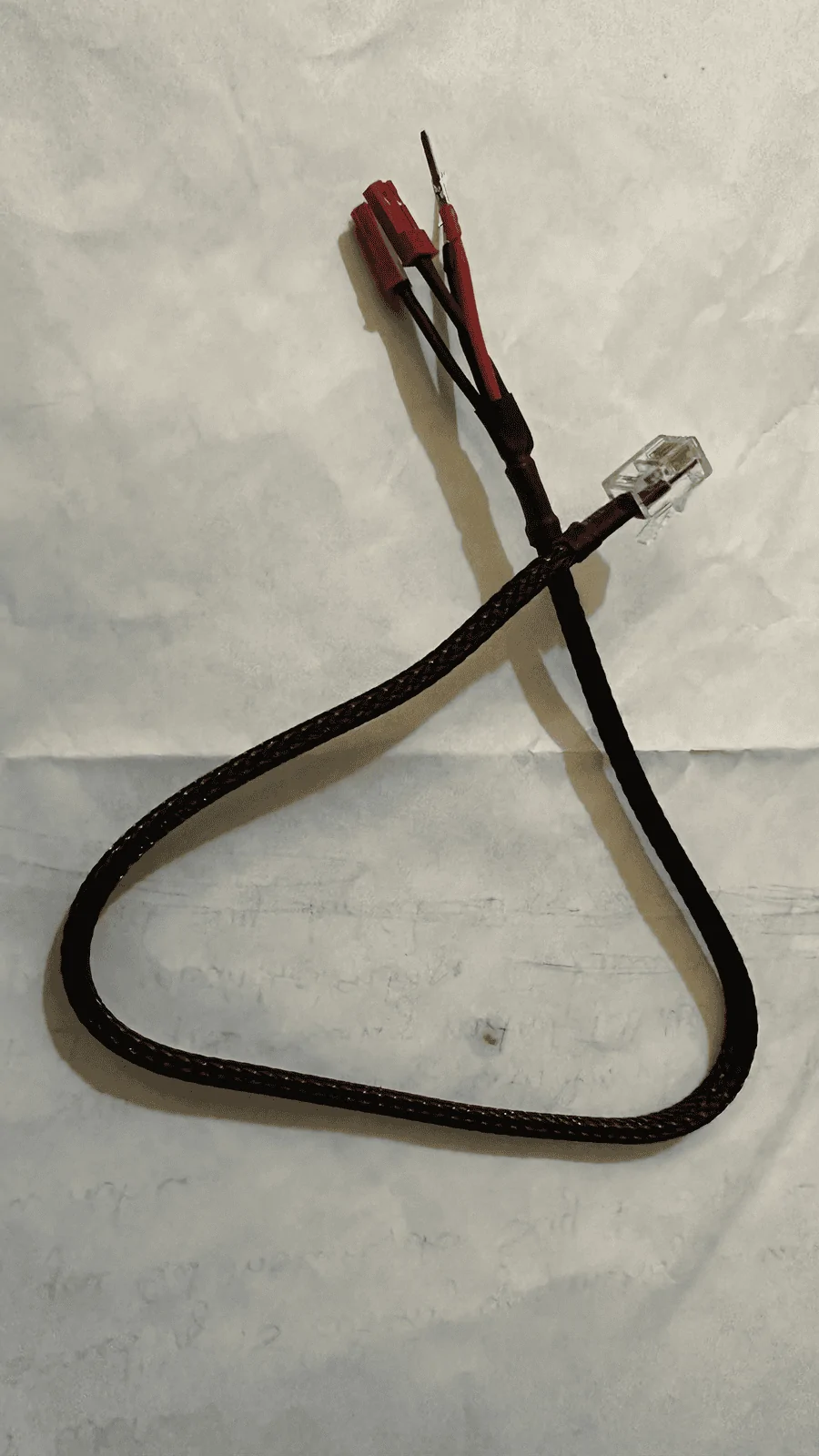

I wanted to add, for regular dash cam install, just get this 3 pin homelink usb adapter and usb cable and make your life easier. This made my life 10x easier. I use 4K rexing dashcams and have for a while.
edit: this adapter is unfortunately constant on in my car, so working on a solution to power down.
Iā€™d you are having trouble finding a spot for the usb adapter due to space, drop down the dome light assembly and it fits perfectly in the roof liner near the mirror.
