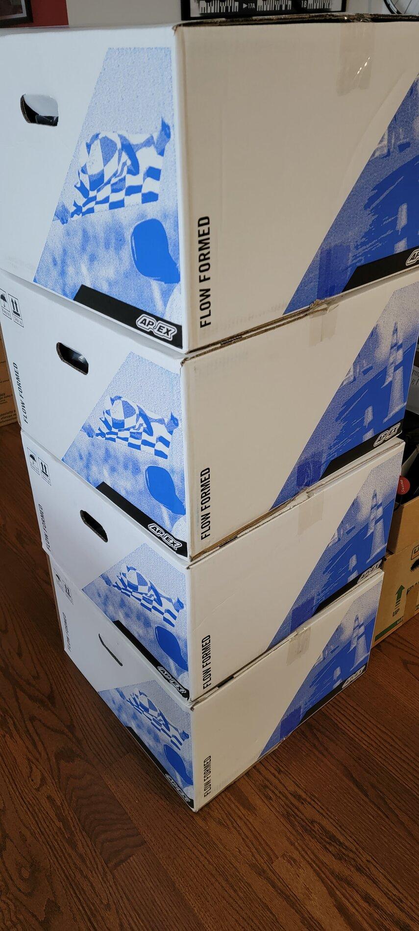

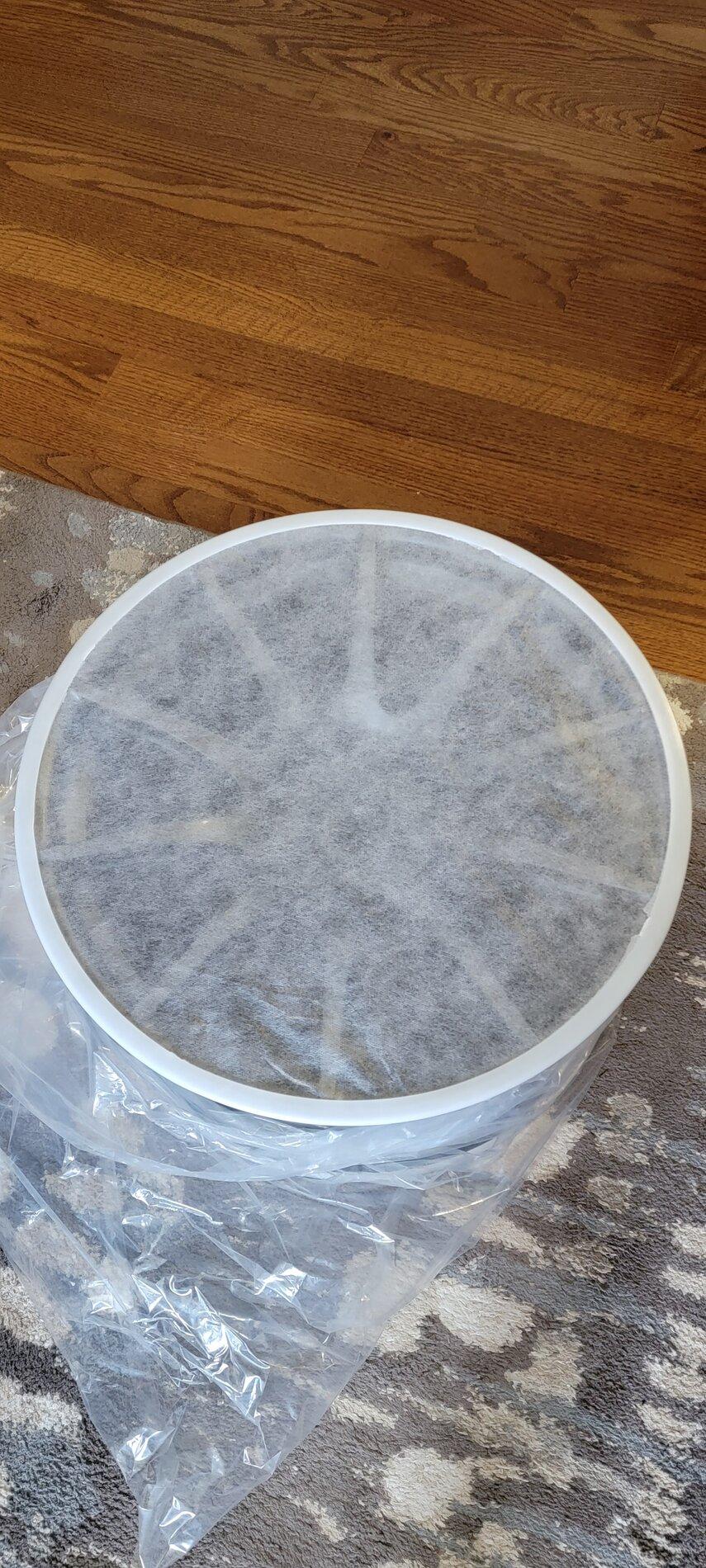

Just got mine. my 1st set of brand new wheels! super stalked!
BTW, these are 18".
Congratulations!!! Show us a pic without the plastic!! I ordered 19"s so hoping us 19" buyers will see our wheels on our doorstep soon.

Exciting to see these in your hands! Definitely update us when you get them mounted and on the car!

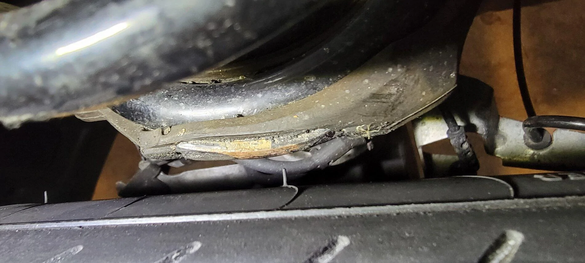

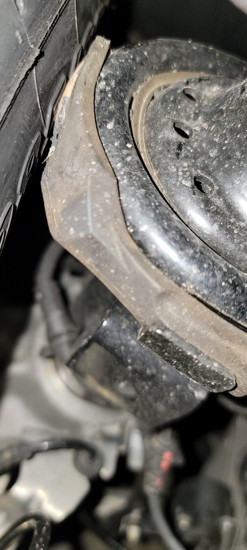

I'm using Pirelli P-Zero 285 35 18 size. I just got the wheels back from shop and test mounted but it is touching strut spring perch.. below is the photo when car was on jack.
I could not take photo when it was off the jack as i didn't have a lot of room... I did buy 5mm spacer to see if this will resolve this..

Understood, thanks for confirming that inner clearance. A 5mm spacer should hopefully be enough to clear the strut and spring perch without pushing the wheel too far outboard. These wheels were really made for 275s so their inner clearance is fairly tight. The amount of inner clearance between the tire shouldn't change much when the suspension is loaded for test fitment purposes. Keep us posted on the results after the addition of spacers.

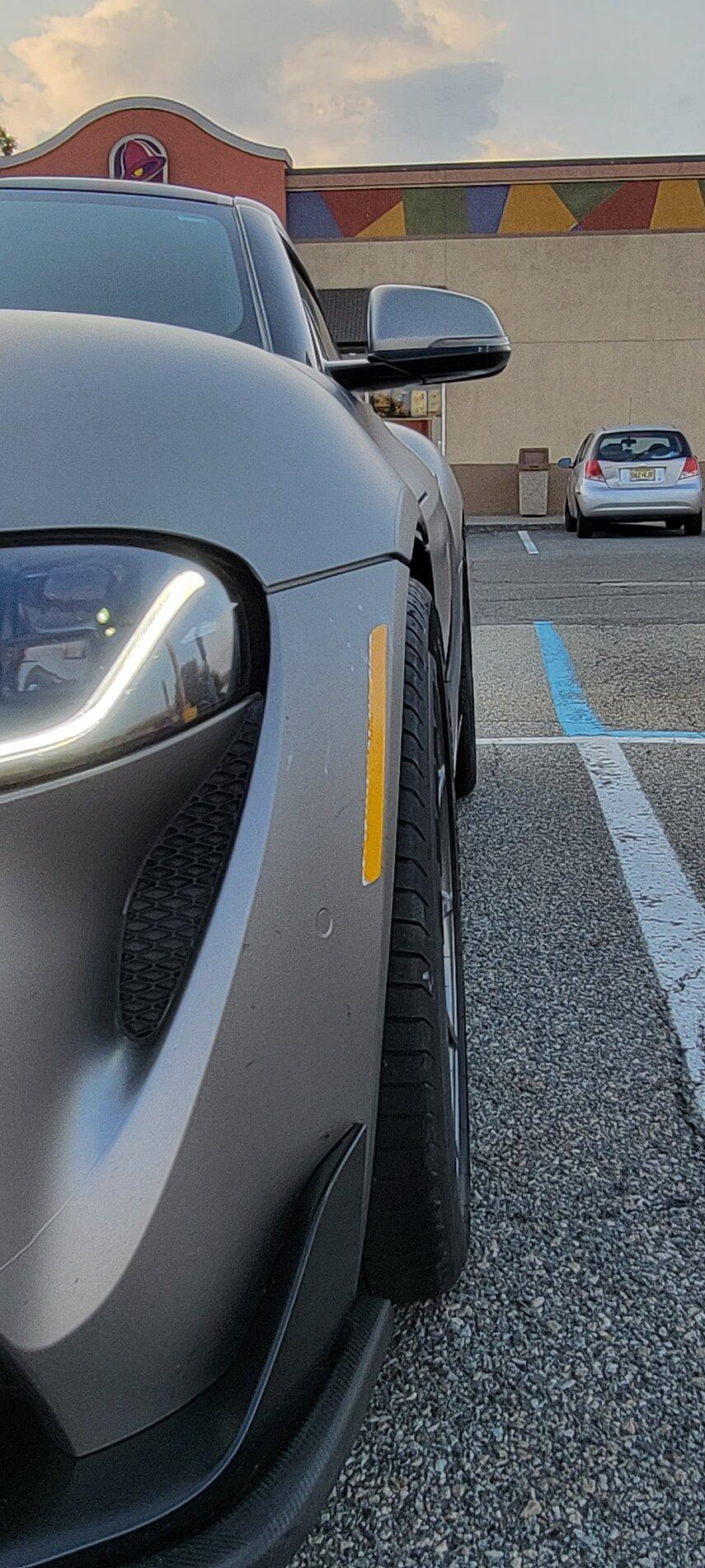

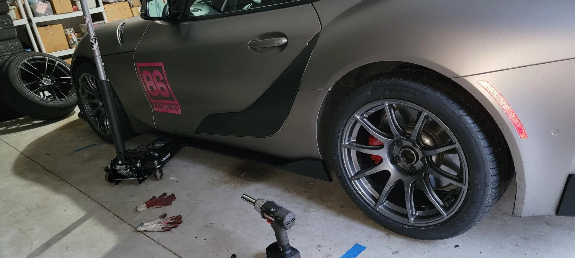

Here's the update. I had to get a pair of 5mm spacer at ridiculous price because one from amazon went postal... I could not wait because I have an appointment for alignment tomorrow morning which is last chance before track day on monday.. :( But I'm happy to report that 5mm clears spring perch.
this was when it was raised on jack and hard to get a photo when it's down..

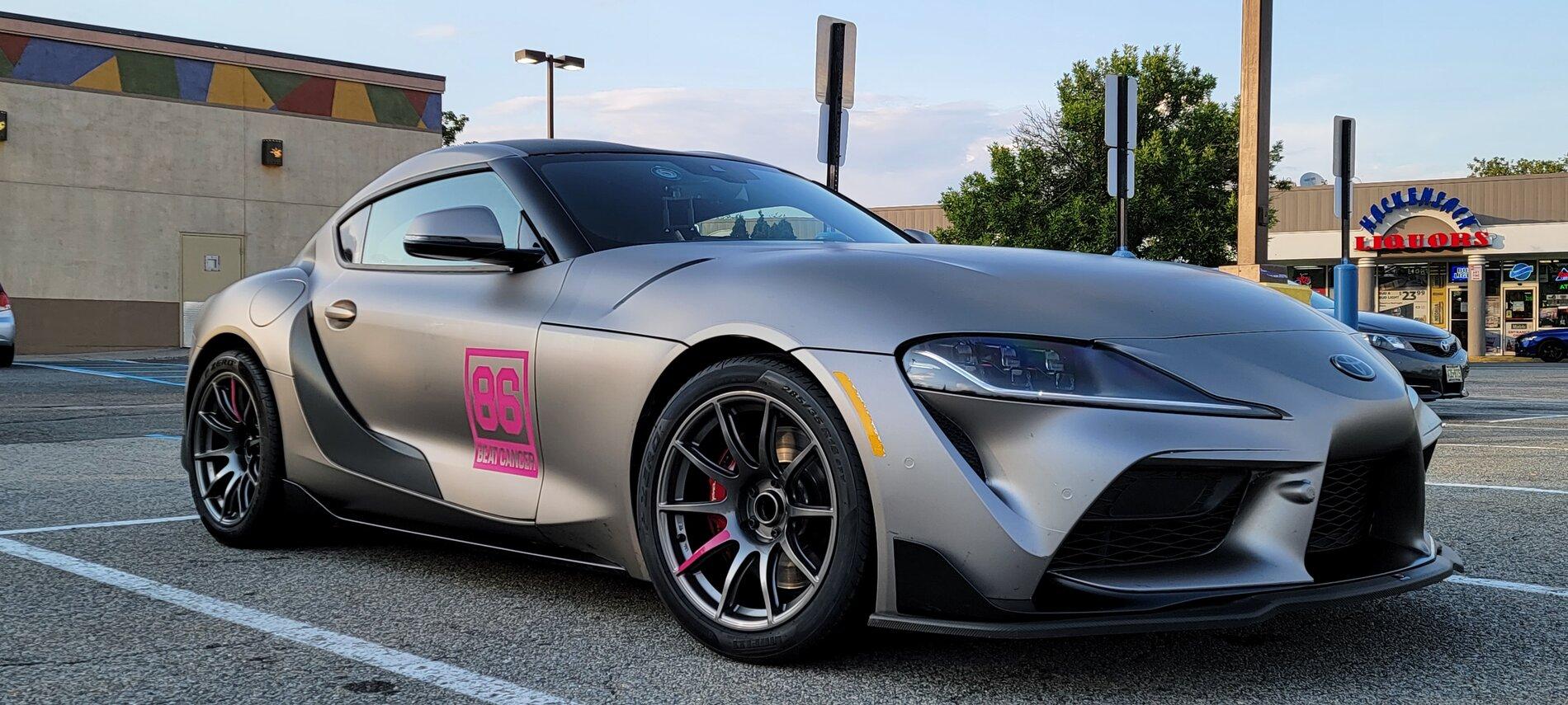

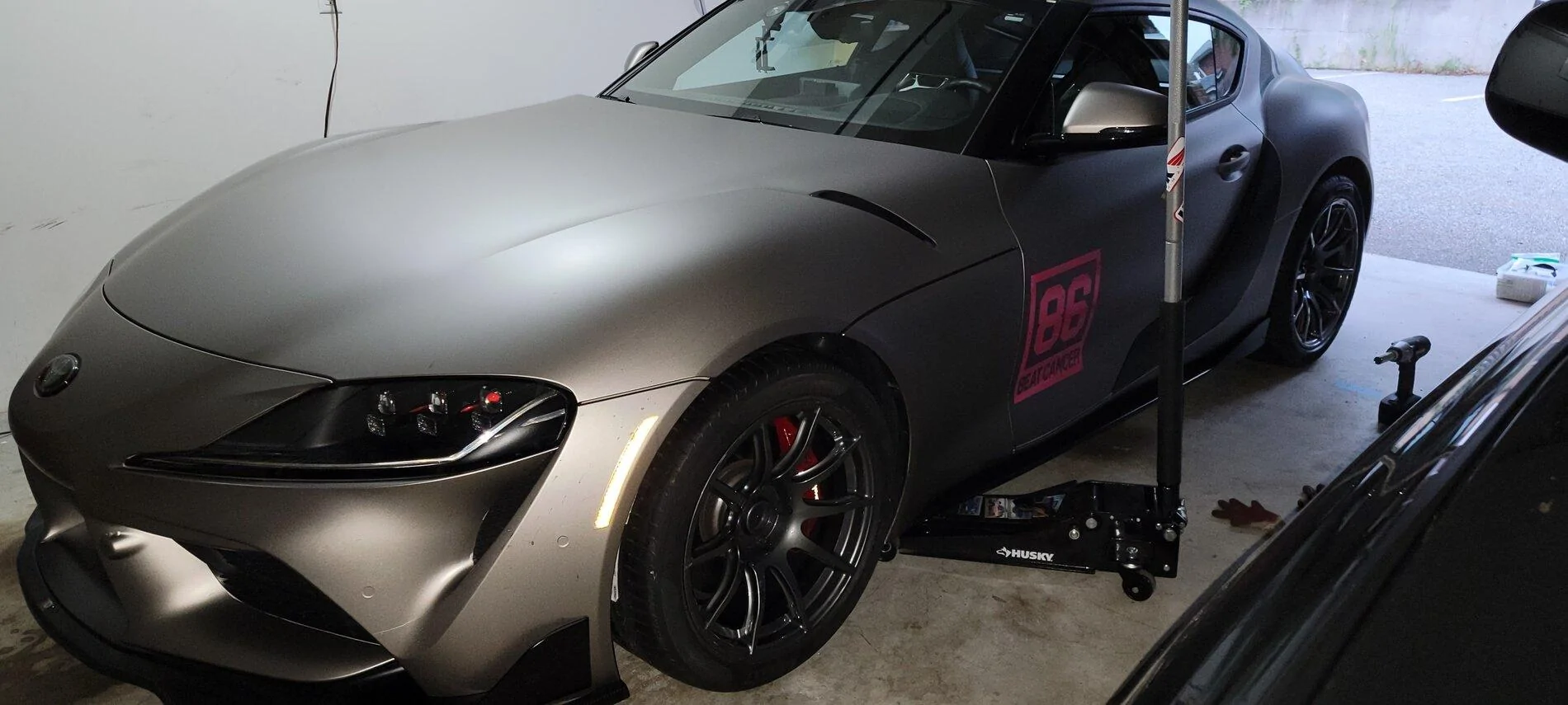

after all, this is what it looks like.

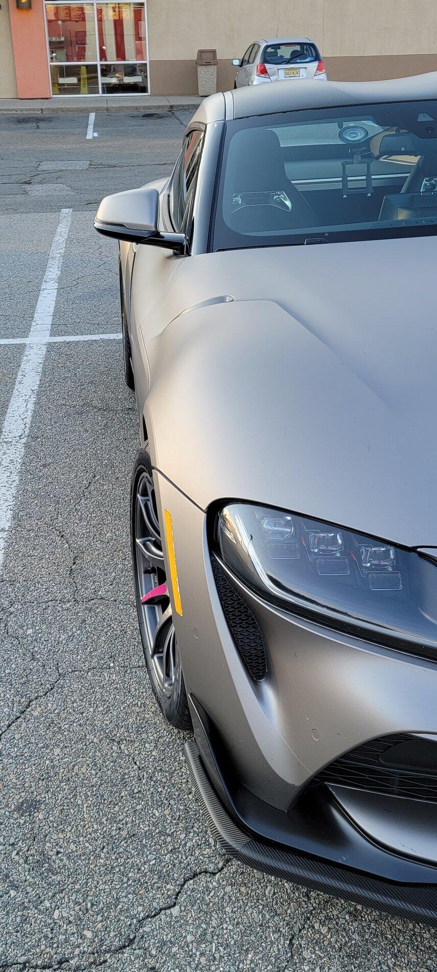

below is to show how much it comes out.

Thanks for the followup! Those 285s really are aggressive, but they should pay dividends on the track. Any rubbing up front under suspension compression?
The wheels look great on the car!
