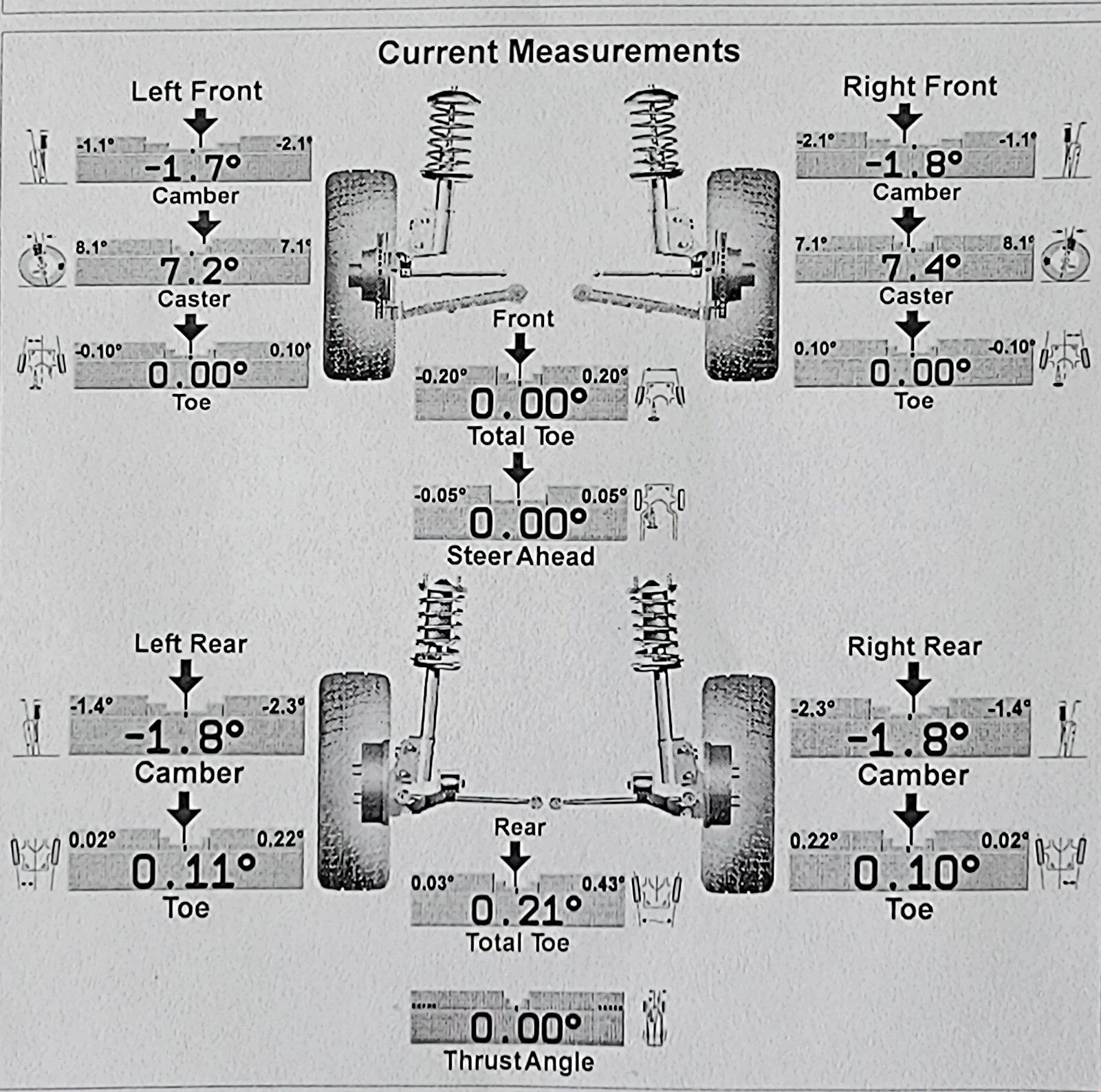

I will find out on monday. So far, no rubbing /w stock height. will also follow up after alignment tomorrow. ;)

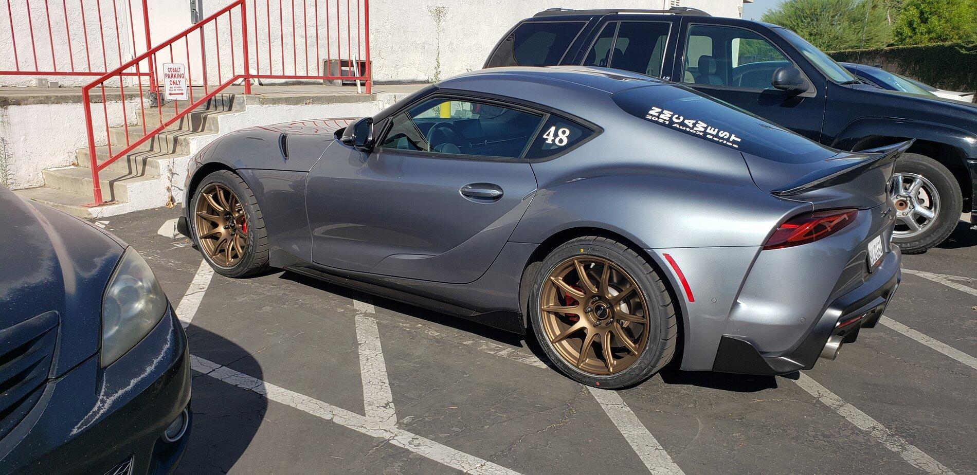

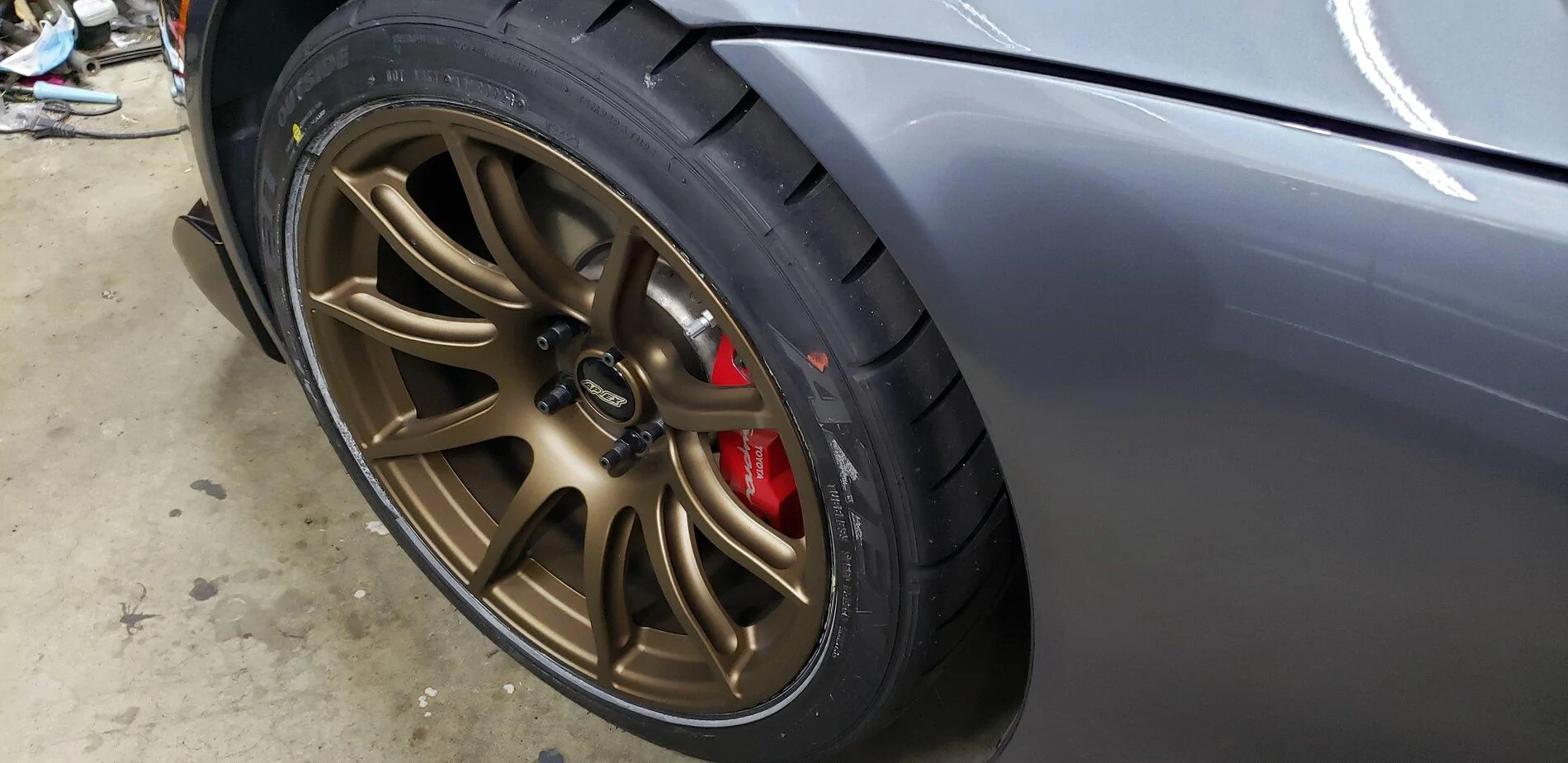

Just want to give everyone over at Apex a shout out for making a great Supra specific wheel! Finally got mine installed last night. I have to say, the way these things fit is just perfect. I dont think you guys could have got the offsets more perfect. Cant wait to do a couple more mods so that I can fit an 11" wheel up front!
SM-10
10x18 front
11x18 rear
Falken 615k+
275-35
315-35

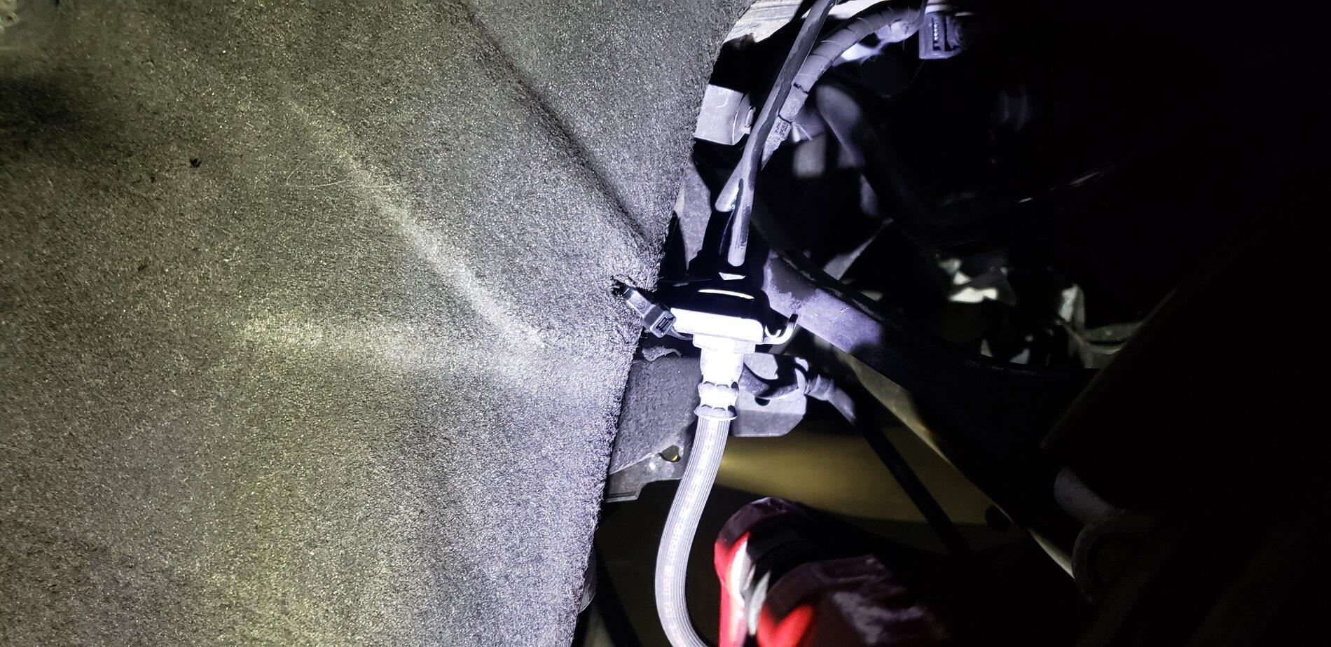

The only thing I had to do was drill a hole in the fender liners in the rear and suck them in with a zip tie. They rubbed a hair without doing that.

This setup looks amazing! Any additional shots of the 315 in the rear? That's a crazy wide tire!

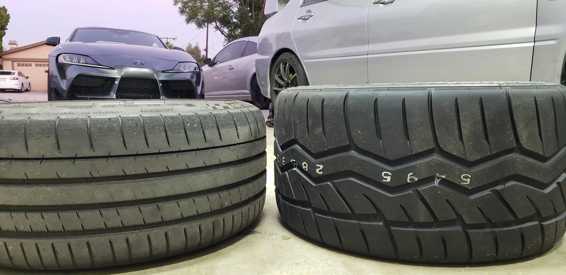

Tom - the lighting is bad right now. Too bright out/casting shadows in the wrong spots. I will get some booty shots when I get home. They are huge tires for sure. Here is a comparison to stock. Might not look like much from the picture but its a good 1.5" wider at the contact patch.

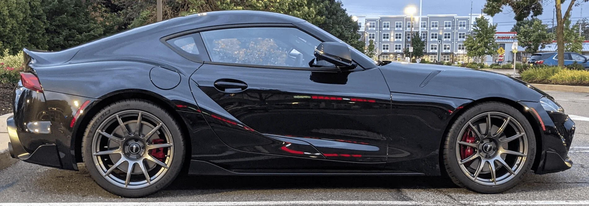

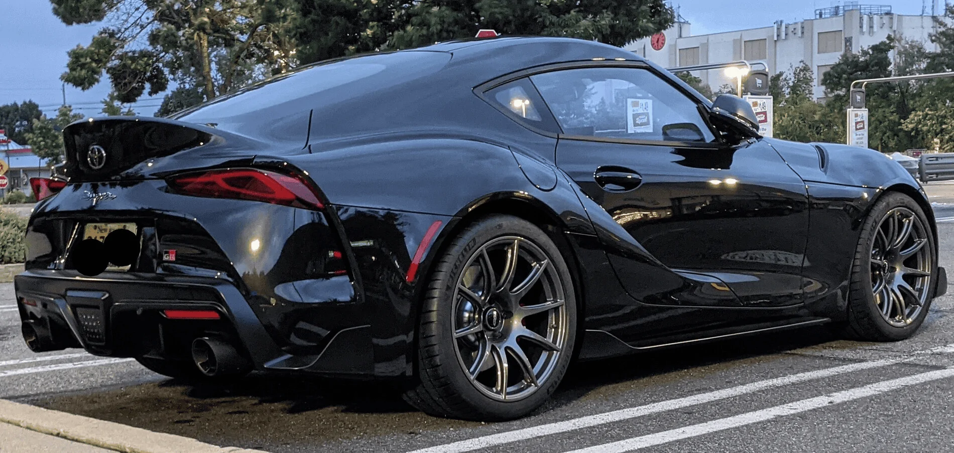

Bump for Apex. Order placed on 8/16. Mounted and Balanced. Shipped 8/18. Received 8/24 in NJ which is 2,800 miles away. Thank you @APEXRaceParts !
APEX SM-10 in Anthracite
19X9.5" ET25
19X11" ET40
Michelin Pilot Sport 4S
265/35-19
305/30-19
