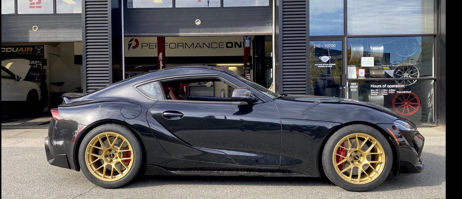

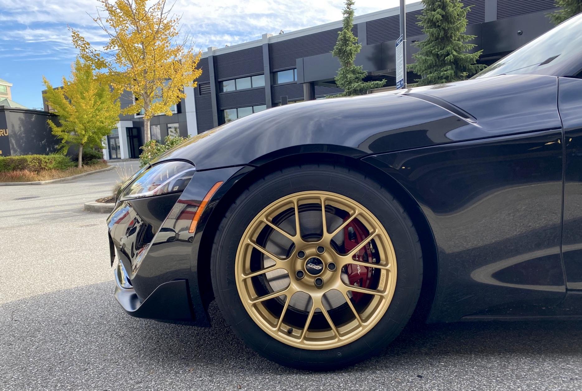

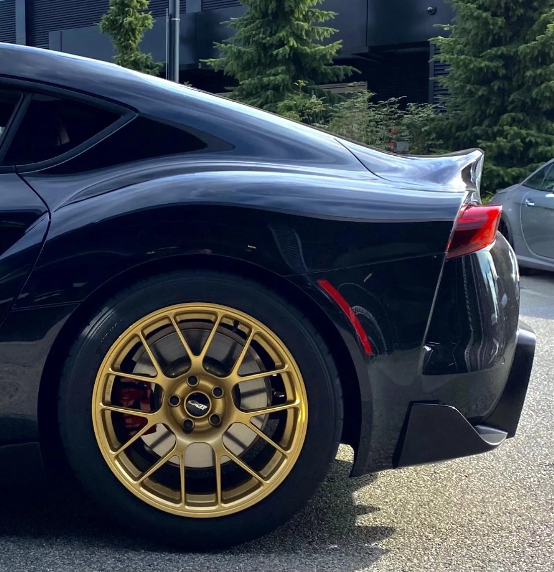

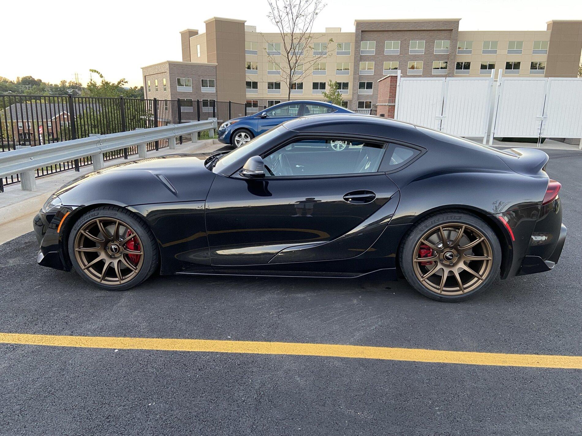

Here's my '21 on a set of 18 x 10.5" ET38 Apex EC-7Rs in satin gold and 275/40 A052s. I need more sidewall in my life, and I think the meaty tires are going to look amazing with the EVS fenders that might show up one day. Also installed the Öhlins Road & Track suspension, but waiting for a few more days on an alignment. It's currently at the recommended height and I suspect there'd be some rubbing up front if it went any lower.
Looking good on the gold! Are you running any front spacers with the 18x10.5 ET38 or did the Ohlins increase inner clearance up front enough to let you run without them?
-Tom
Oh yeah, forgot to mention those. The wheels don't clear the stock suspension (which I knew) but they do work with the Öhlins without spacers. The car is using 13mm spacers up front and 15mm for the rear and it's filled out nicely. Gonna be chunky with those fenders. Pre-alignment
