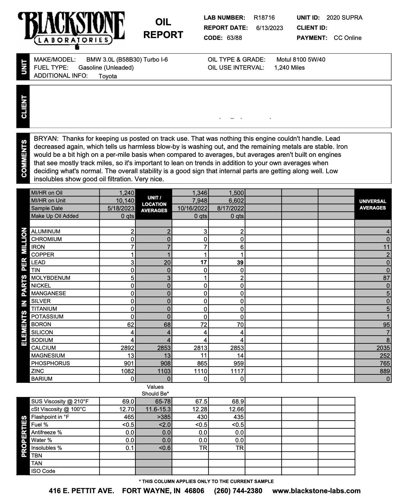

Posted this in another thread but seems appropriate here as well...
Oil report after 23 track days, the last three of them being with the Pure 700 turbo and tune. 10,140 total miles.
Motul 8100 XCESS 5w/40 since 1500 miles.

Got my analysis kit waiting for my next oil change with Liquid Moly 5W-30 special tech. I'll wait until I get a few more events on my engine. I have 3 so far on this oil change.
I did one track day in 2022 with the OEM 0W-20, but changed to 5W-30 we'll see how my engine looks at ~35K.
