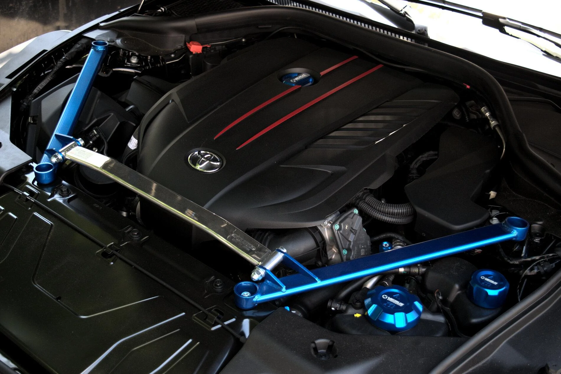

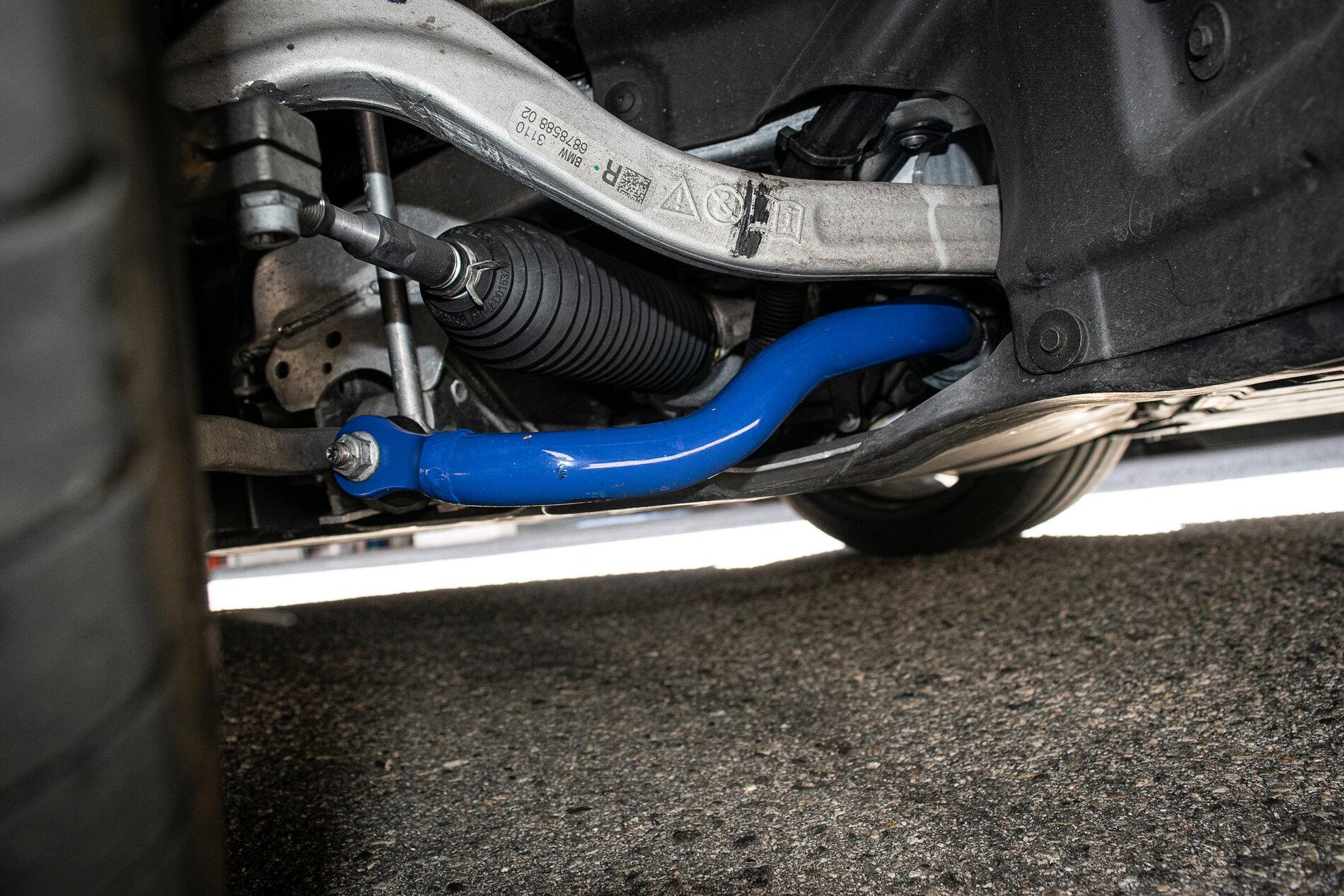

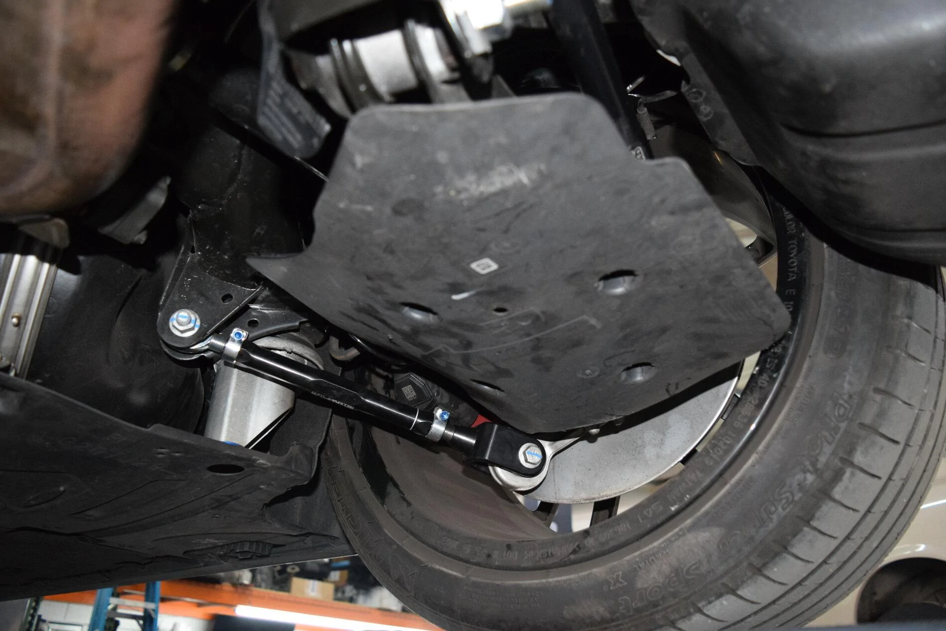

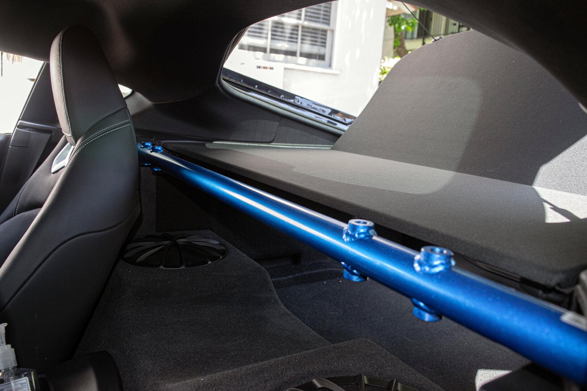

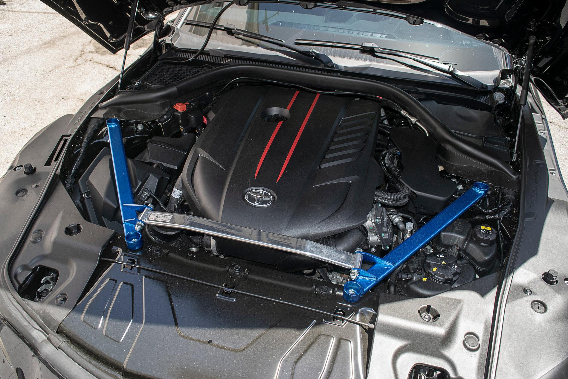

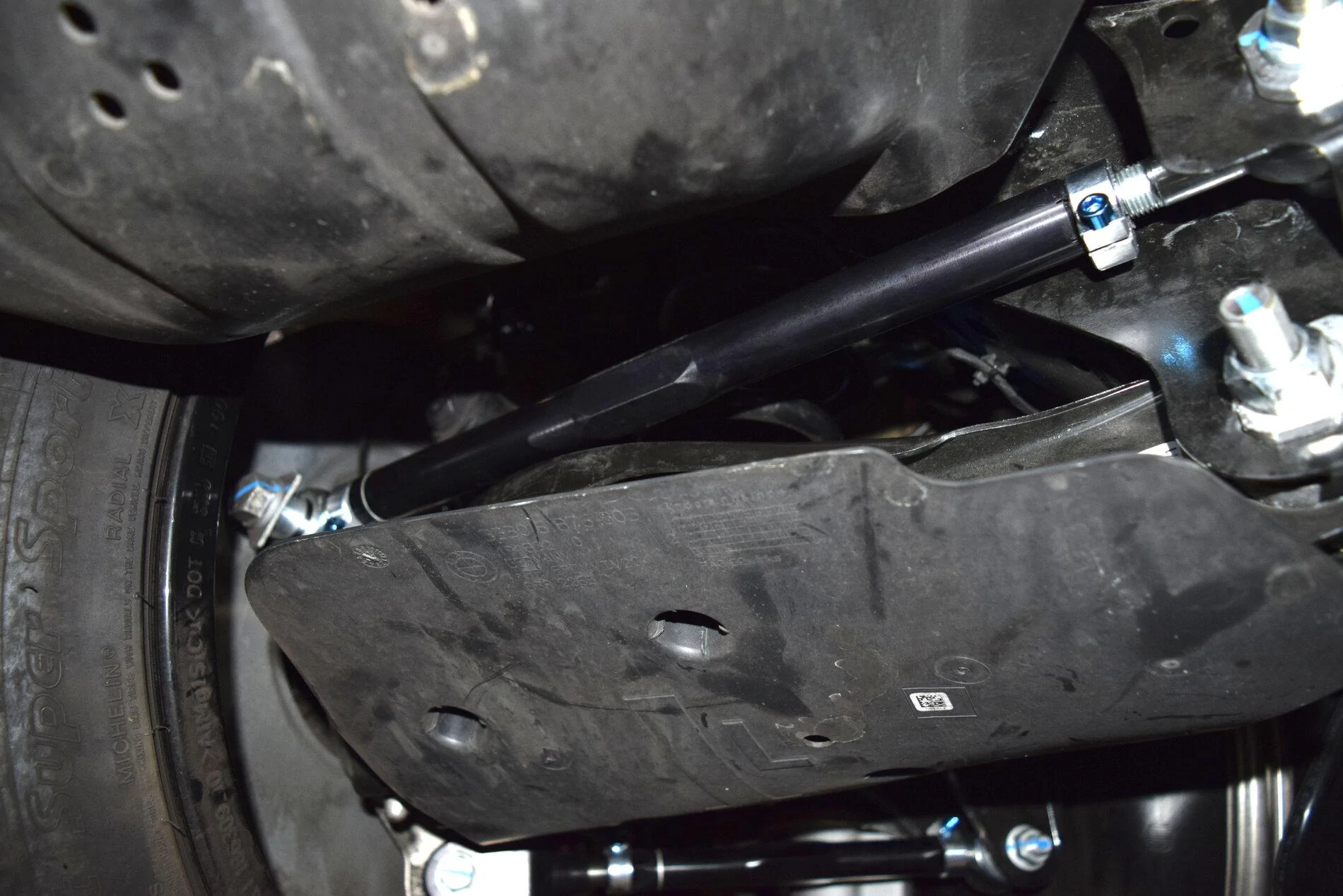

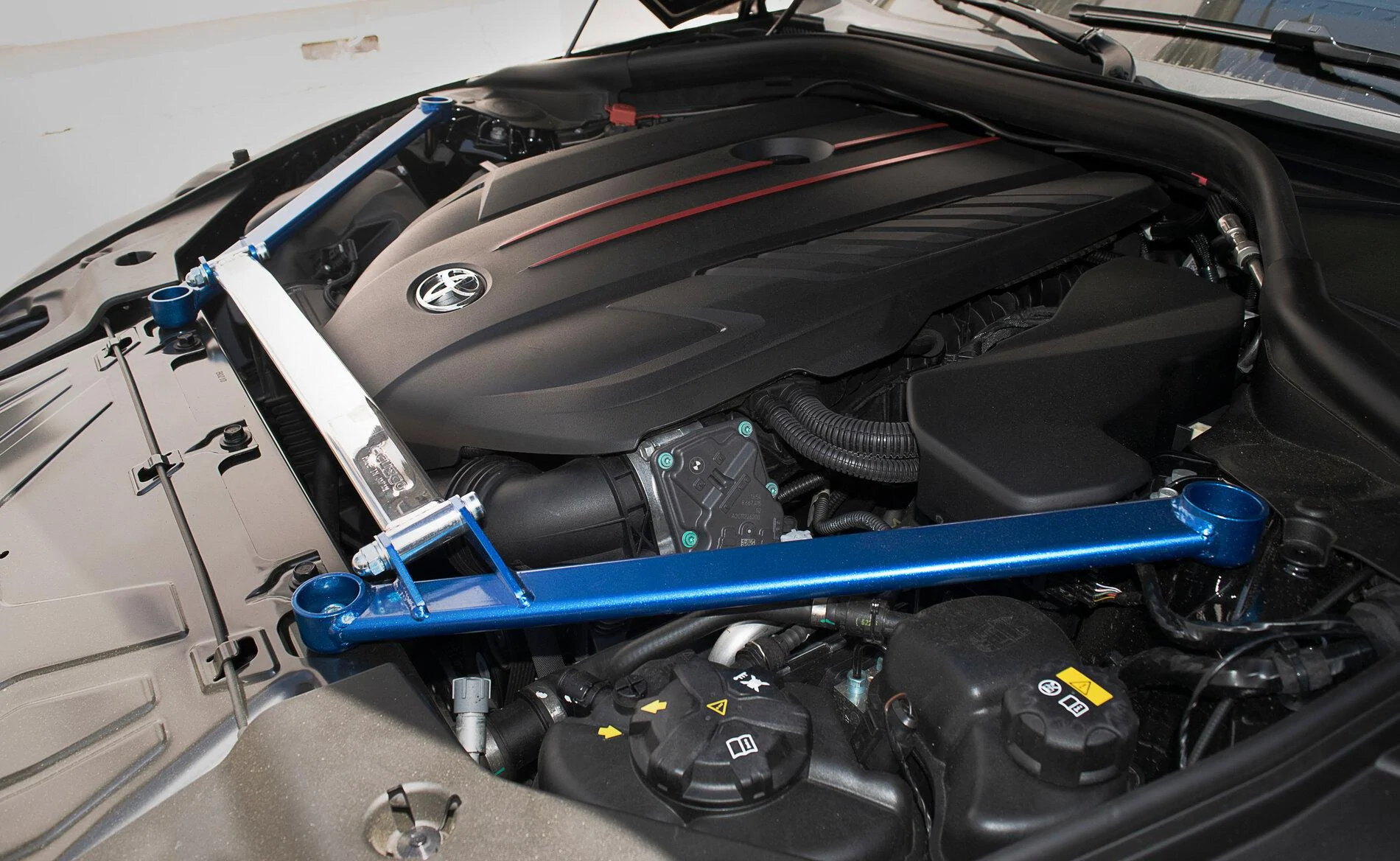

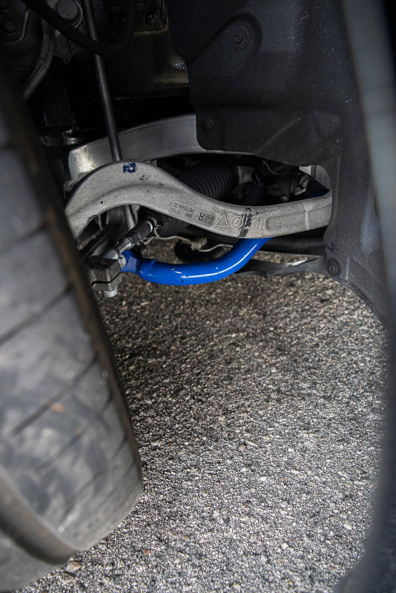

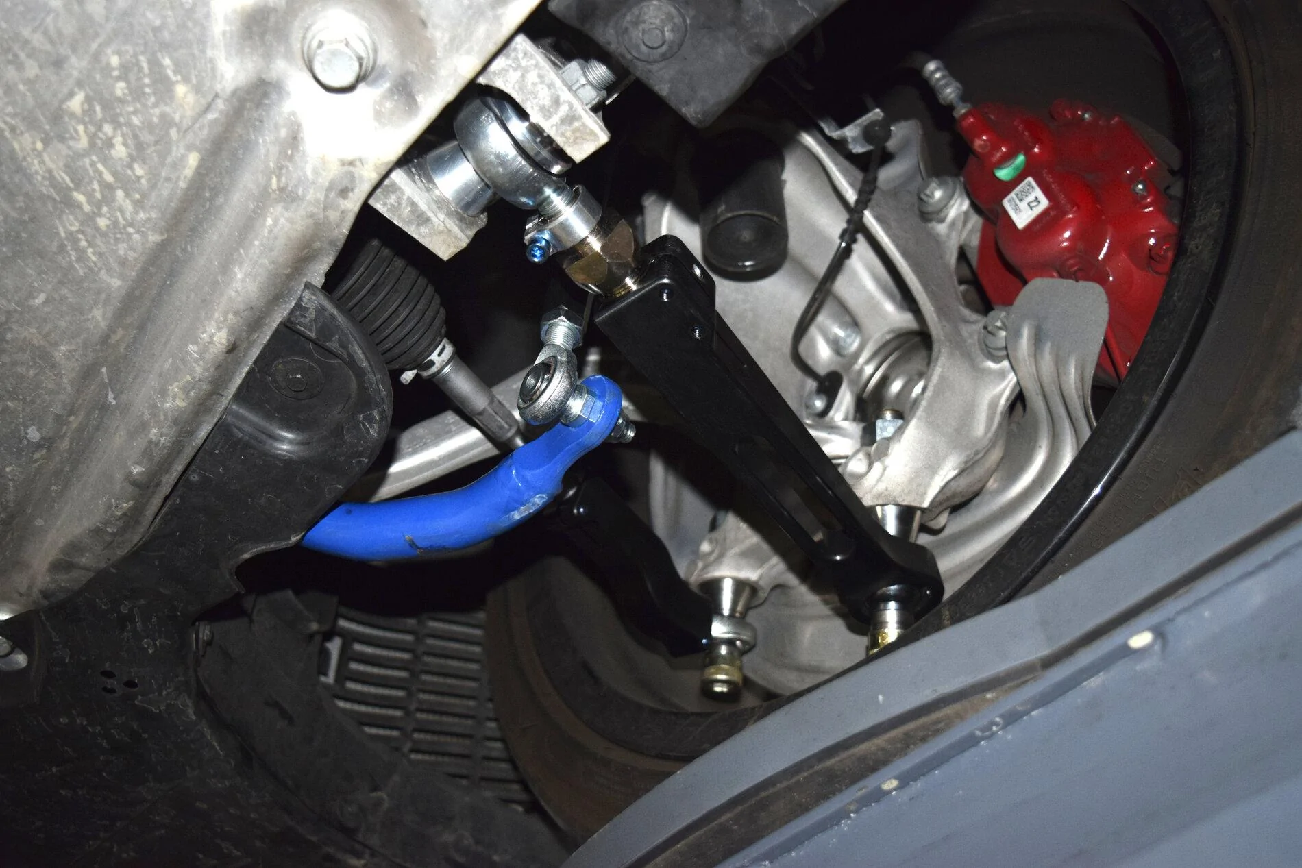

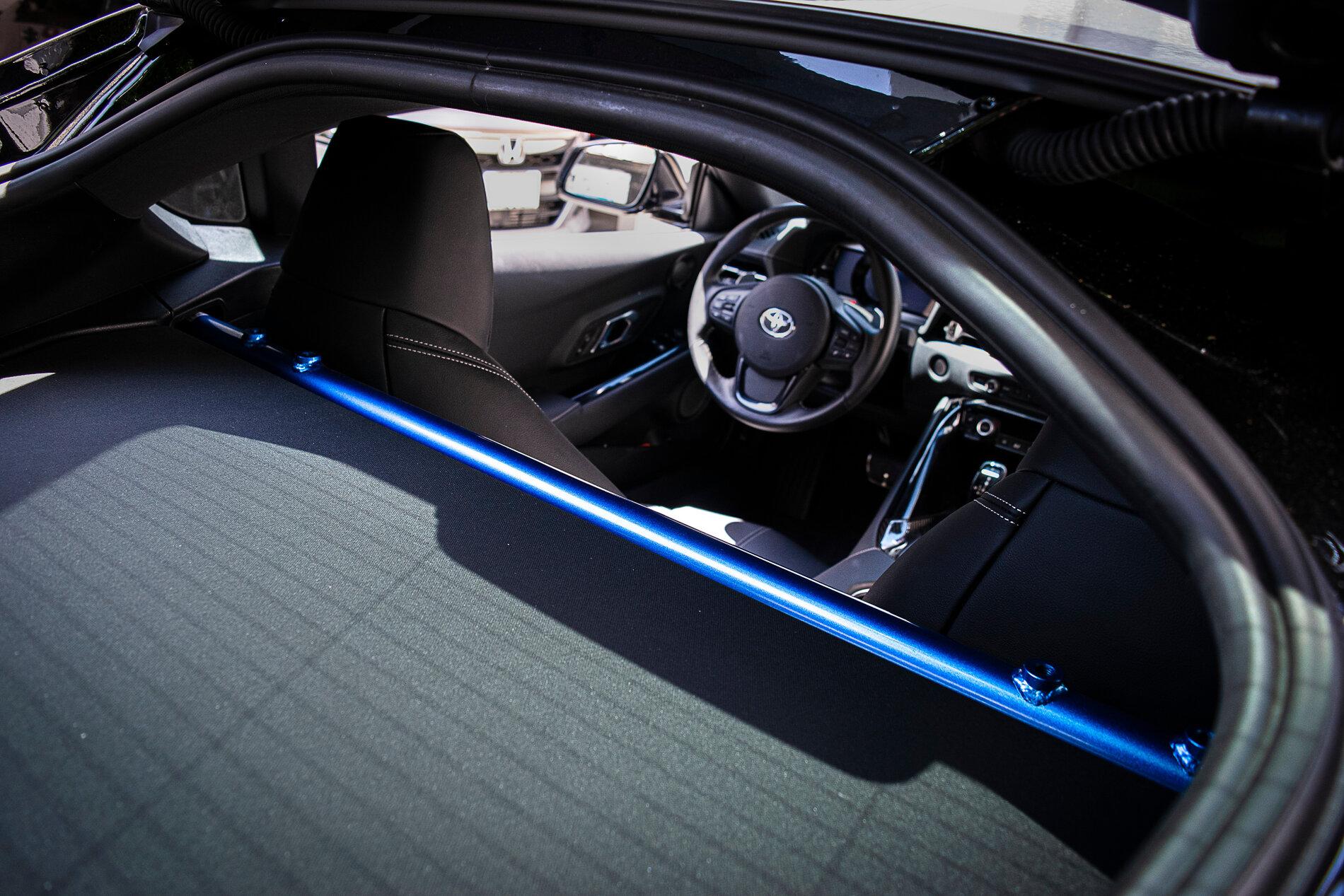

The first real modification was the Cusco parts. The car has very noticeable body roll, in my opinion, and I wanted to fix that. I choose Cusco because I was only finding good things about their parts, they offered a full range of parts that I was looking for, I like the blue, and my parts guy had them available.
I put in the power braces myself and had a shop put in the sway bars, that back one is a hassle. These made a big difference in the handling/body roll and I am very pleased with them. This was a great start to modification.
I did run into two issues though:
  1. When the car is cool (just started driving and/or cold out) there is a not-so-nice noise under the car when going over a bump. Most noticeable when going over a speed bump. I have a strong feeling the bushing were not adequately greased. The shop that put the sway bars in said they will fix whatever is wrong for me (teflon tape/grease), but in the meantime I am going to try greasing these up myself to see if the issue goes away. Currently the issue goes away after about 5 minutes of driving.
  2. Lightly accelerating in very tight turns (ie u-turn) there feels like some sort of rubbing, there is a slight rough vibration and noise from the wheel opposite of the turn (ie front right wheel in a left turn). Does not look like anything is actually rubbing but it might be, I need to have someone watch from outside as I do this... I suspect traction control might be braking that wheel slightly? I need to test this more in a parking lot with traction control off and so on. Maybe the suspension was not fully/equally loaded when the endlinks were torque and there is some imbalance?
Both of these issues are pretty minor and have not caused any real problems.

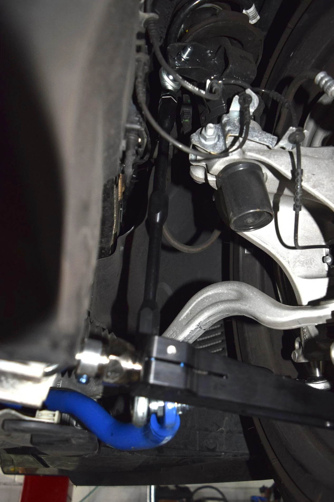

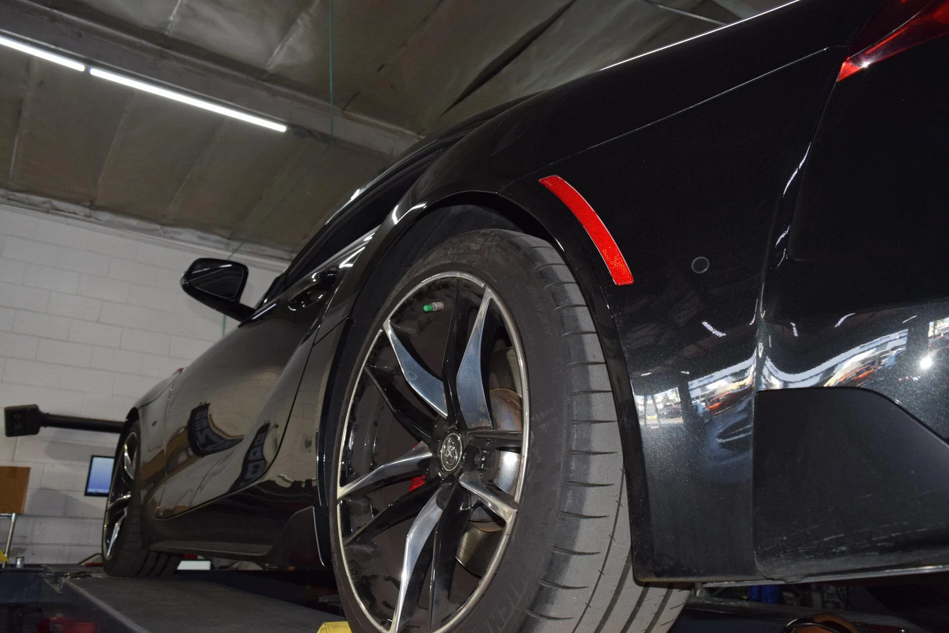

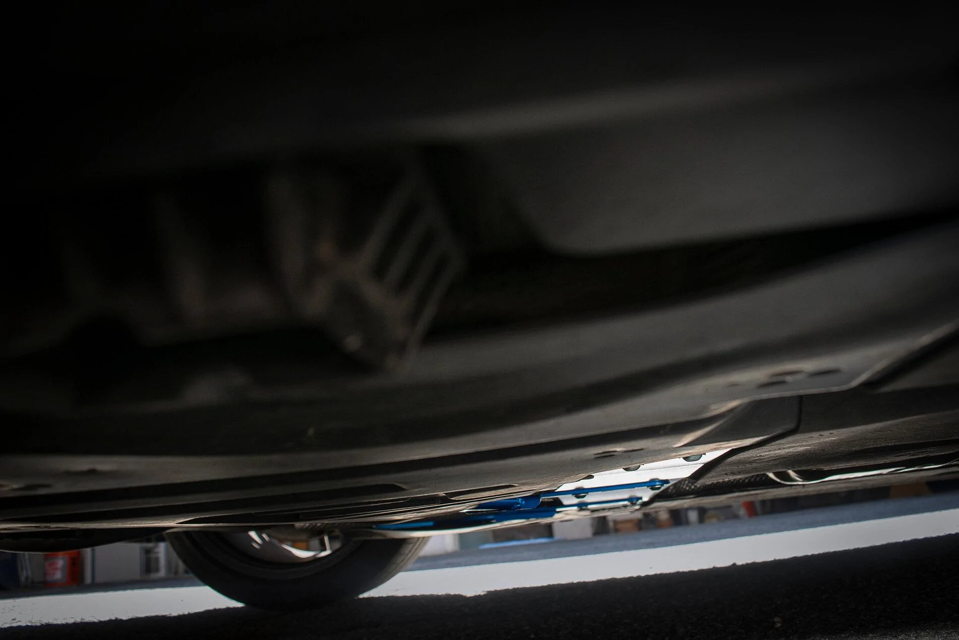

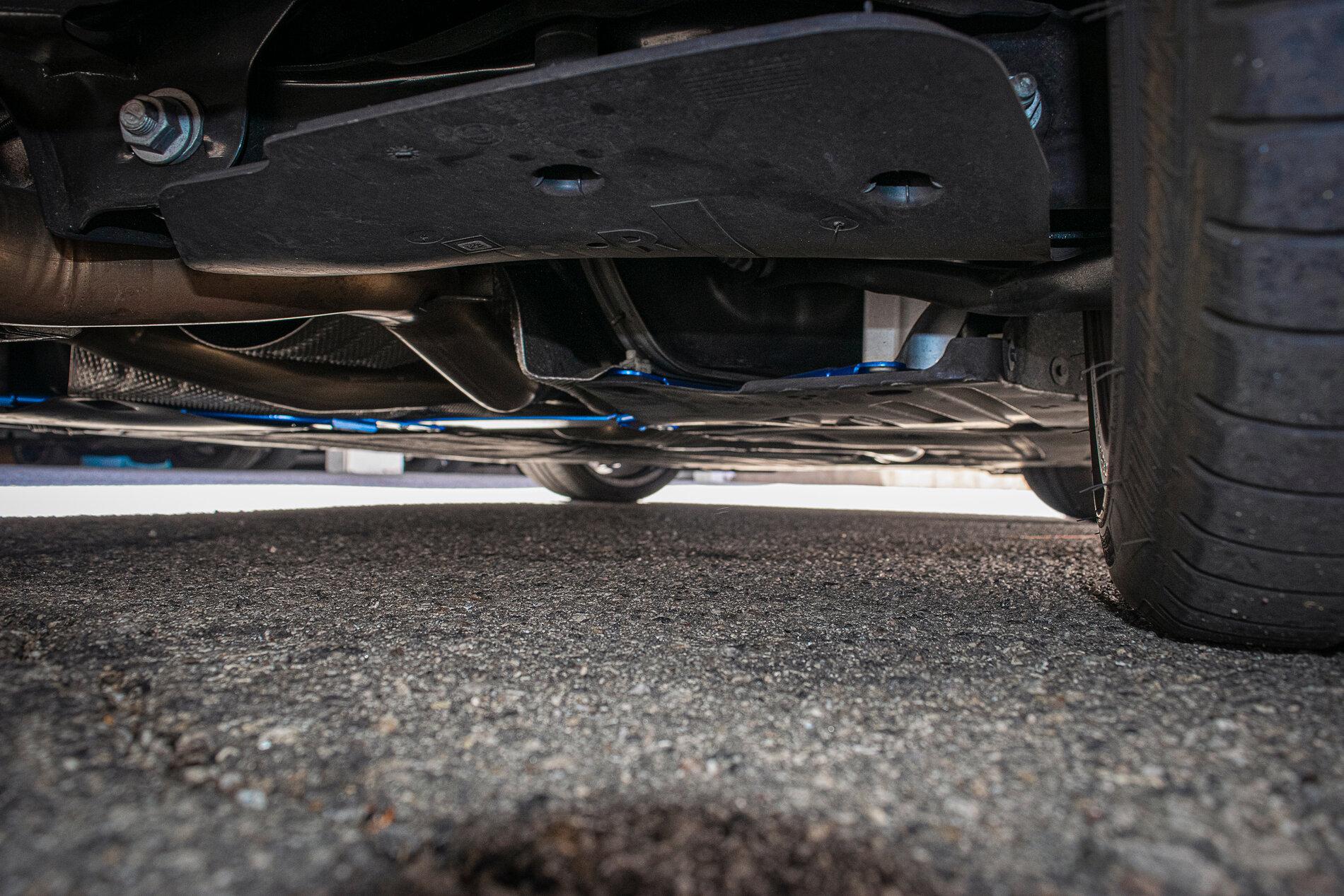

Update - Some images, underside is not the best but I will try to get better ones next time the car is on a lift:

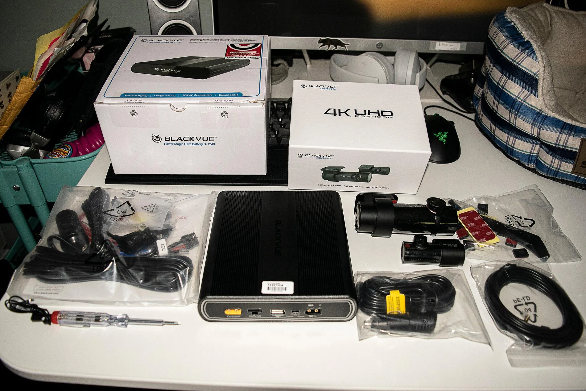

I got another "Other" modification for the car, Blackvue DR900S-2CH. Plan on installing this weekend and will get some posts installation pictures. I plan on following @jgoad13's DIY Guide. My only concern is losing the cigarette lighter up front as it is nice that me and the SO can charge at the same time now. Wondering if there is another fuse I can use... Will need to take a look at the fuse diagram. Picture of the parts below, disregard the messy table.

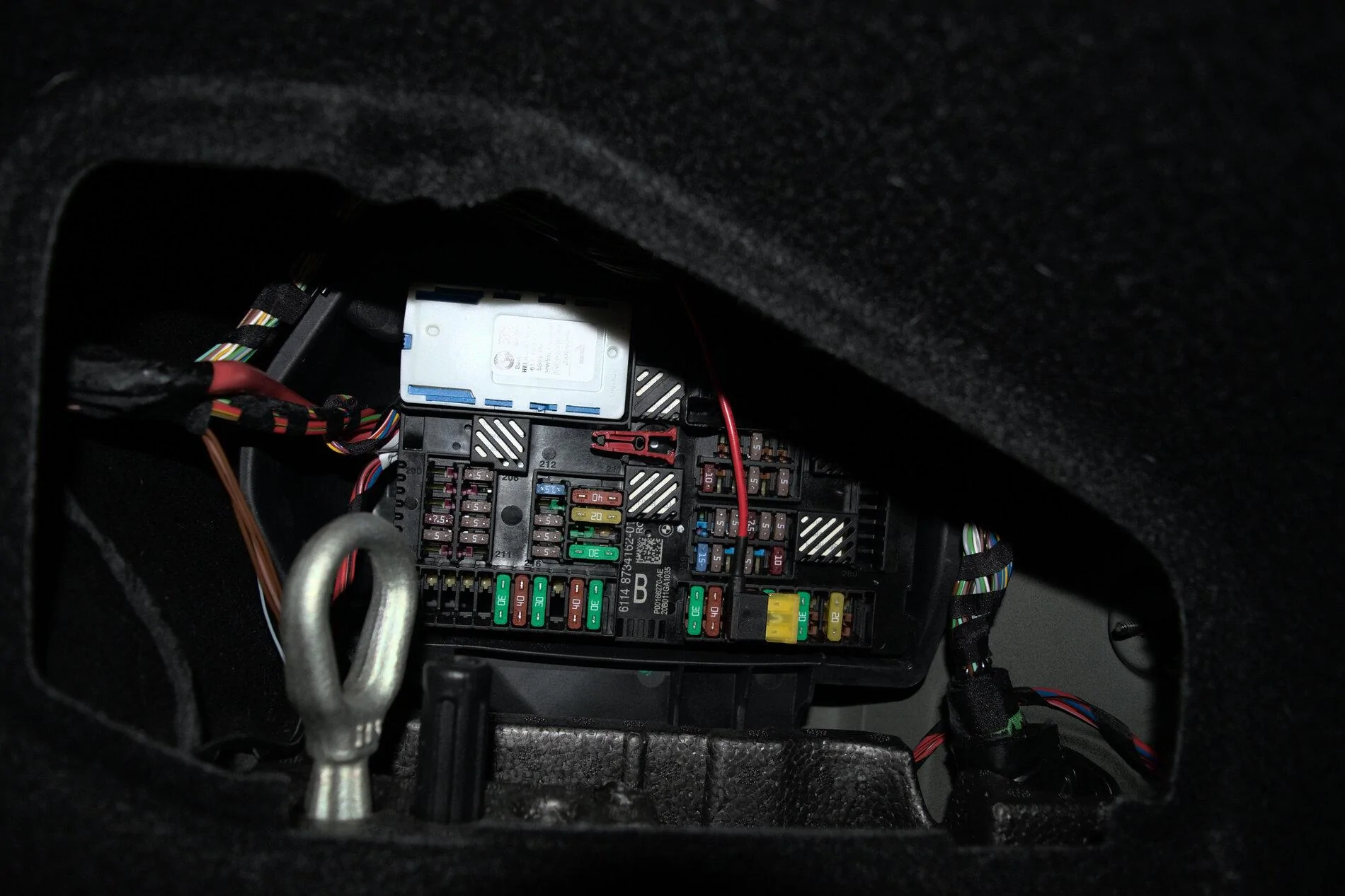

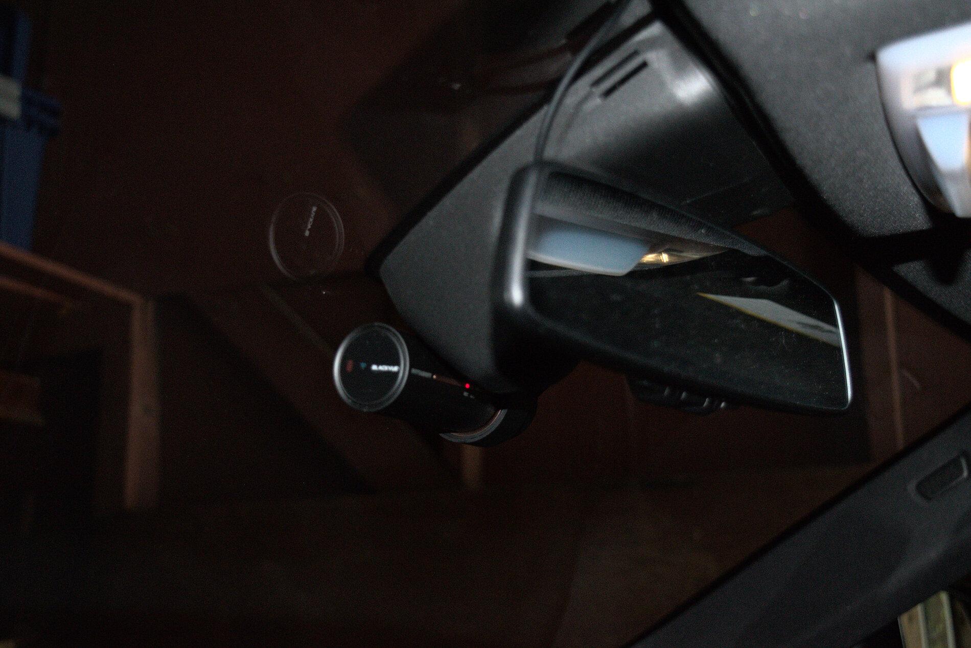

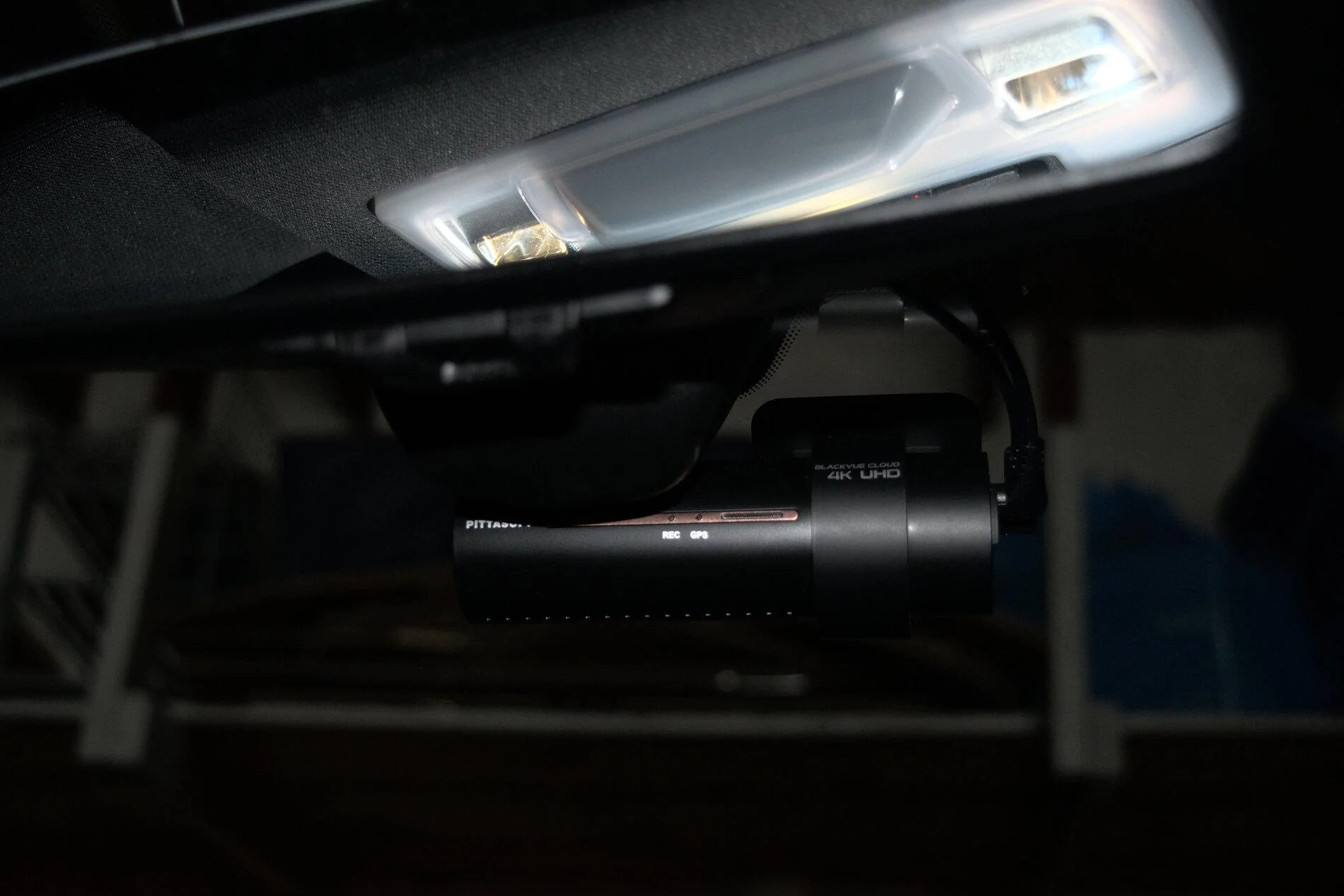

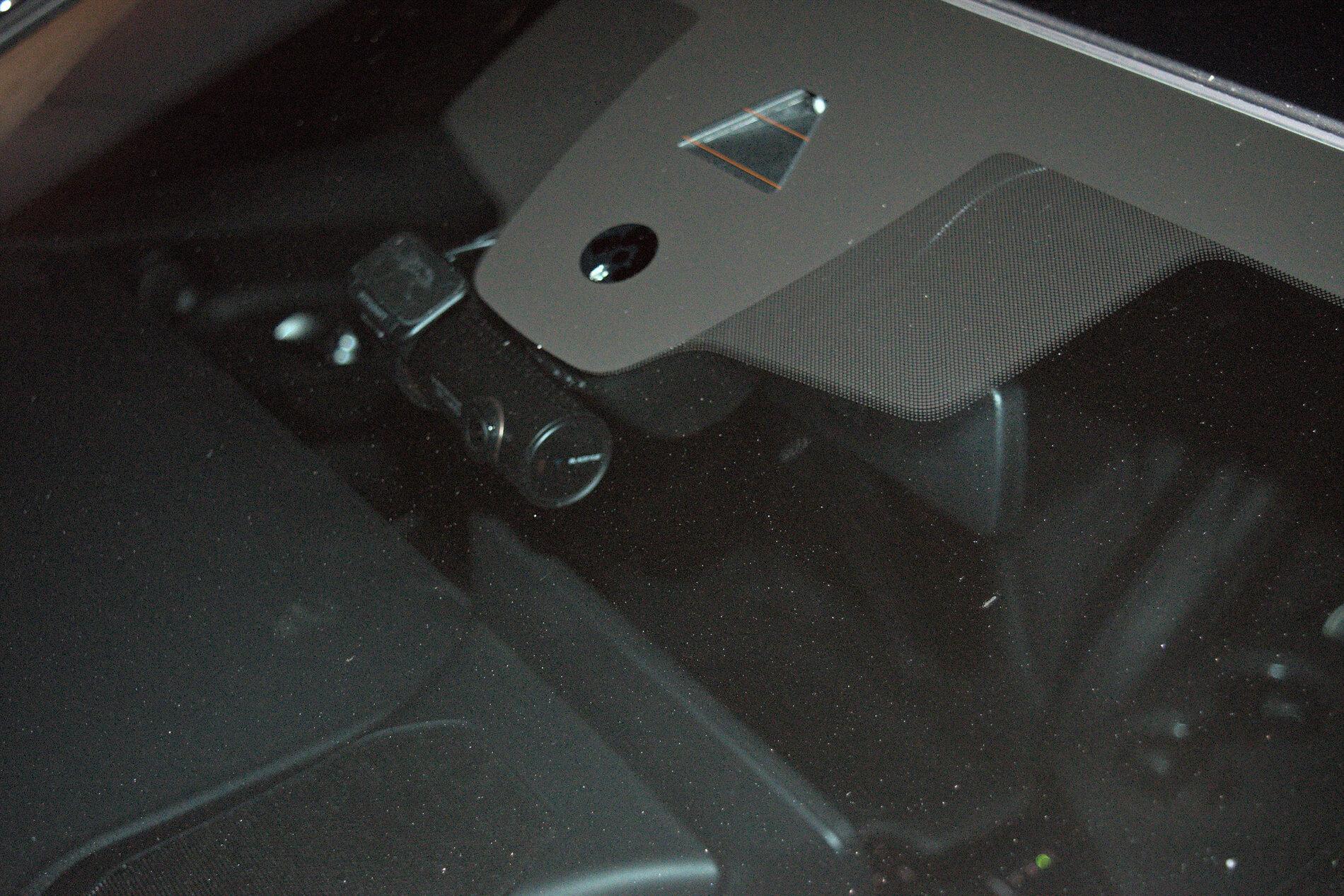

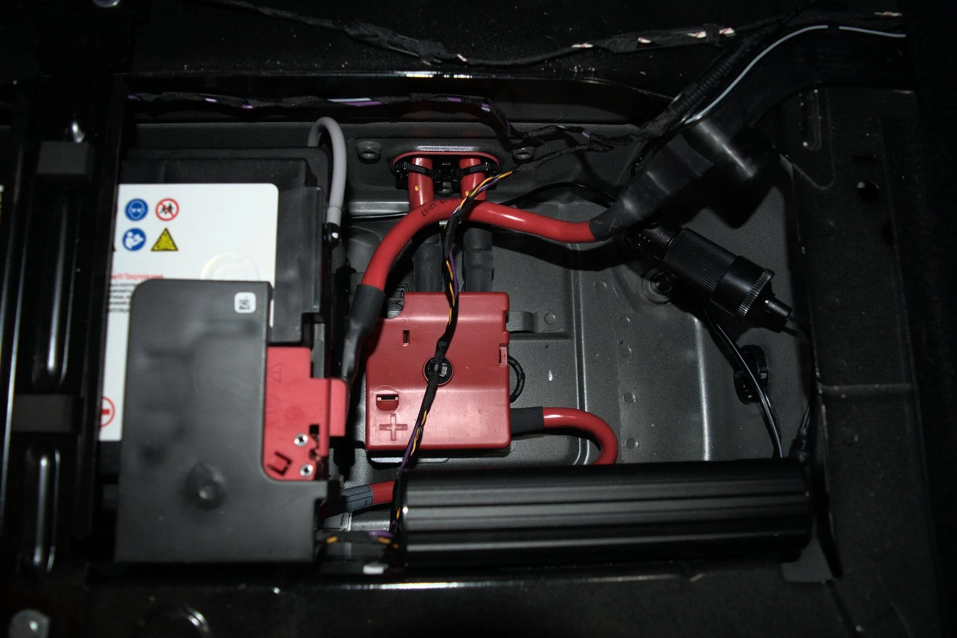

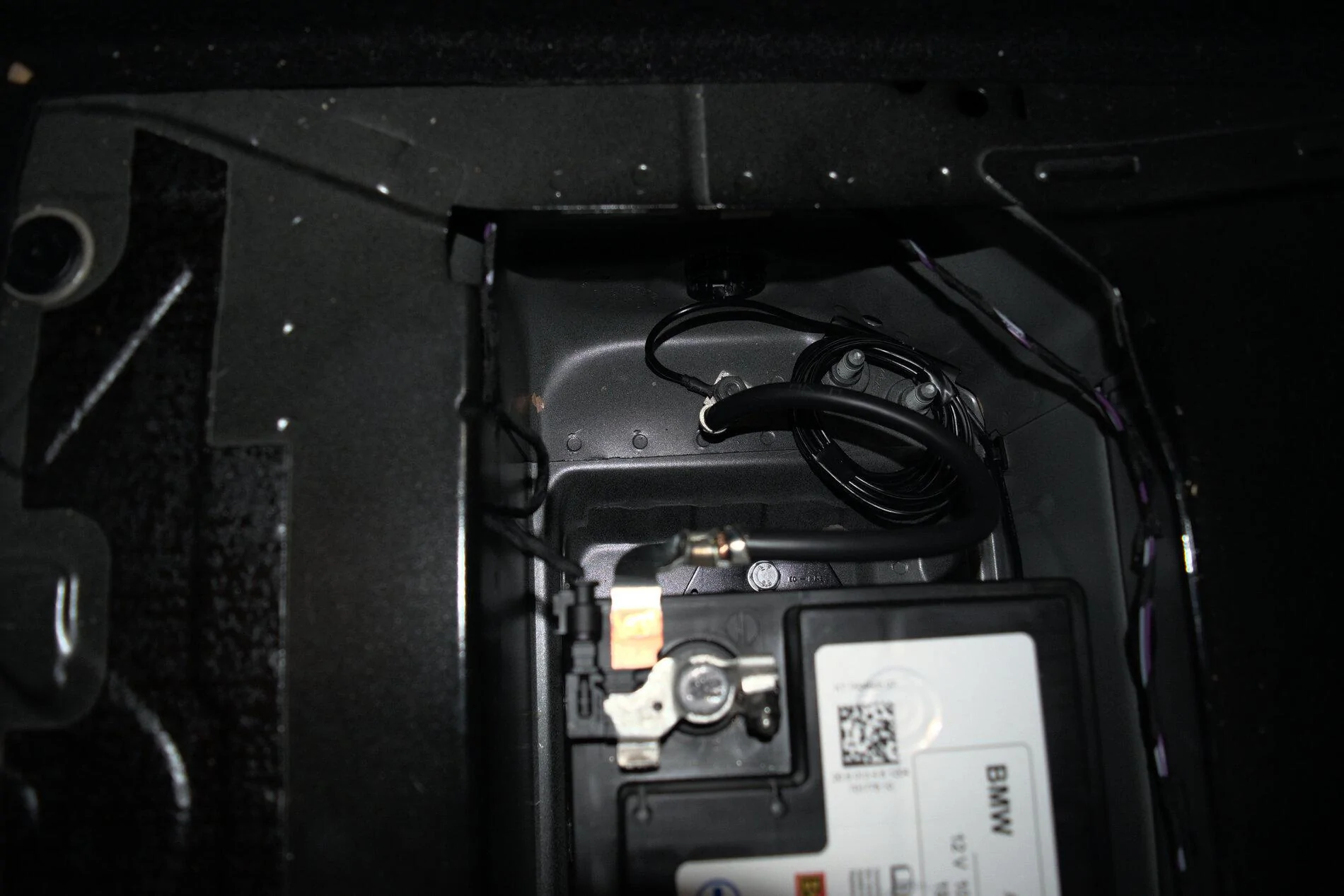

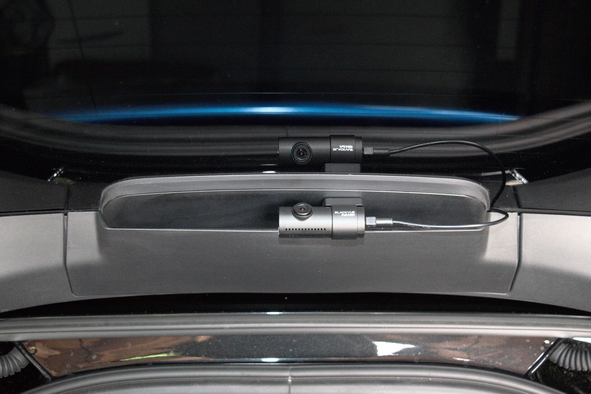

Got the dash camera installed, the guide was very helpful. I ended up using fuse F267 instead of the cigarette lighter. This fuse slot was unused but already equipped with a fuse mount, others are missing the metal bracket to hold a fuse in place. I tested this one to make sure it turned on and off in the same manner as the cigarette lighter fuse and I had an extra fuse for the second adapter slot. So far everything is working great! Although I am not entirely sure that the parking mode is coming on as expected. I have come out to the garage and seen that the camera is recording before even unlocking the vehicle. I need to play with the settings a little more.
I was not thrilled about the front camera mount being very noticeable through the windshield, even with tinted windows/windshield. But the bubbles have gone away a little more and either way it is a small price to pay for the peace of mind.
Here are a few pictures, excuse the dark garage and dirty windshield. Even caught a jabroni on the first drive, not too close of a call but I would recommend against driving on the wrong side of the road when coming through a blind turn...

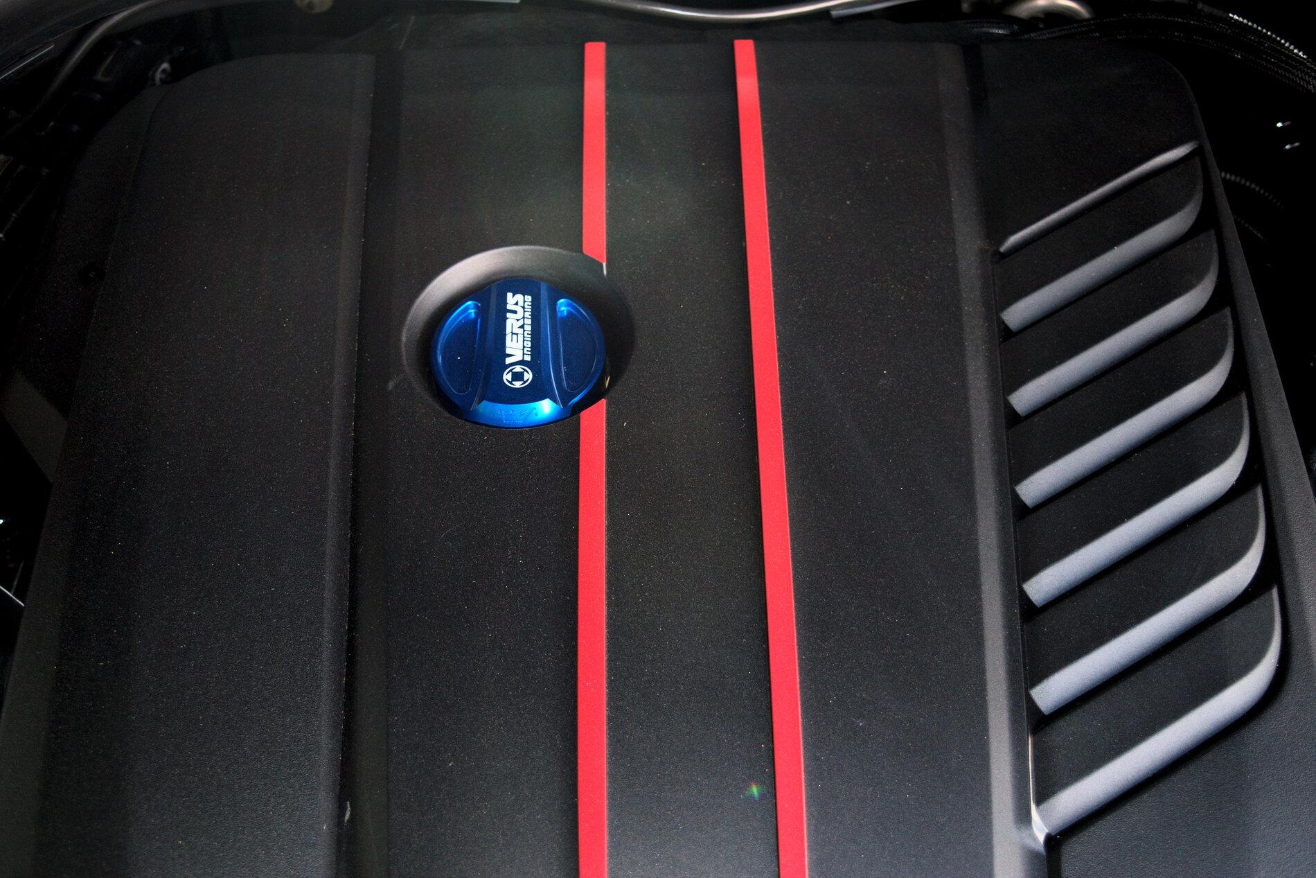

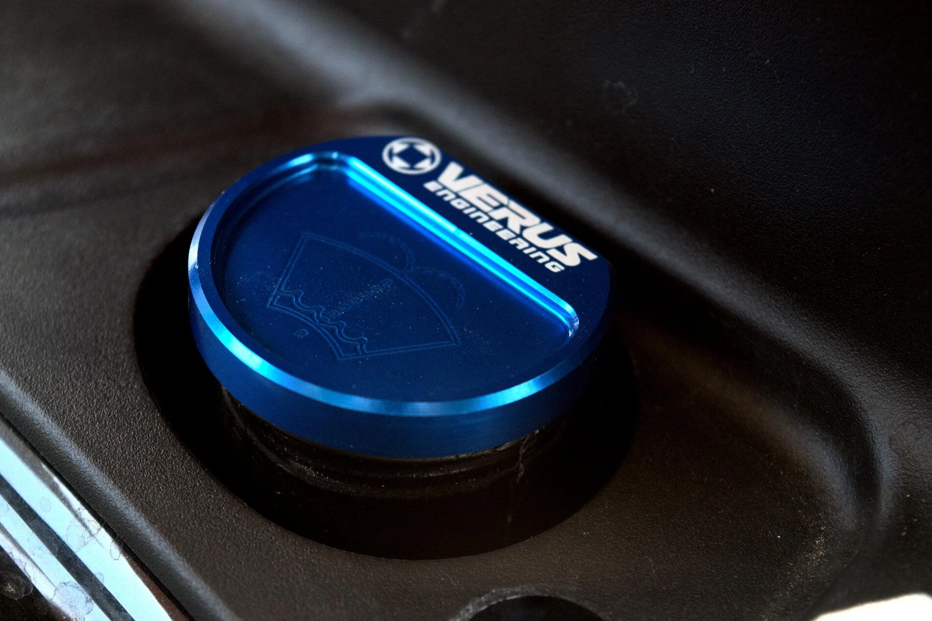

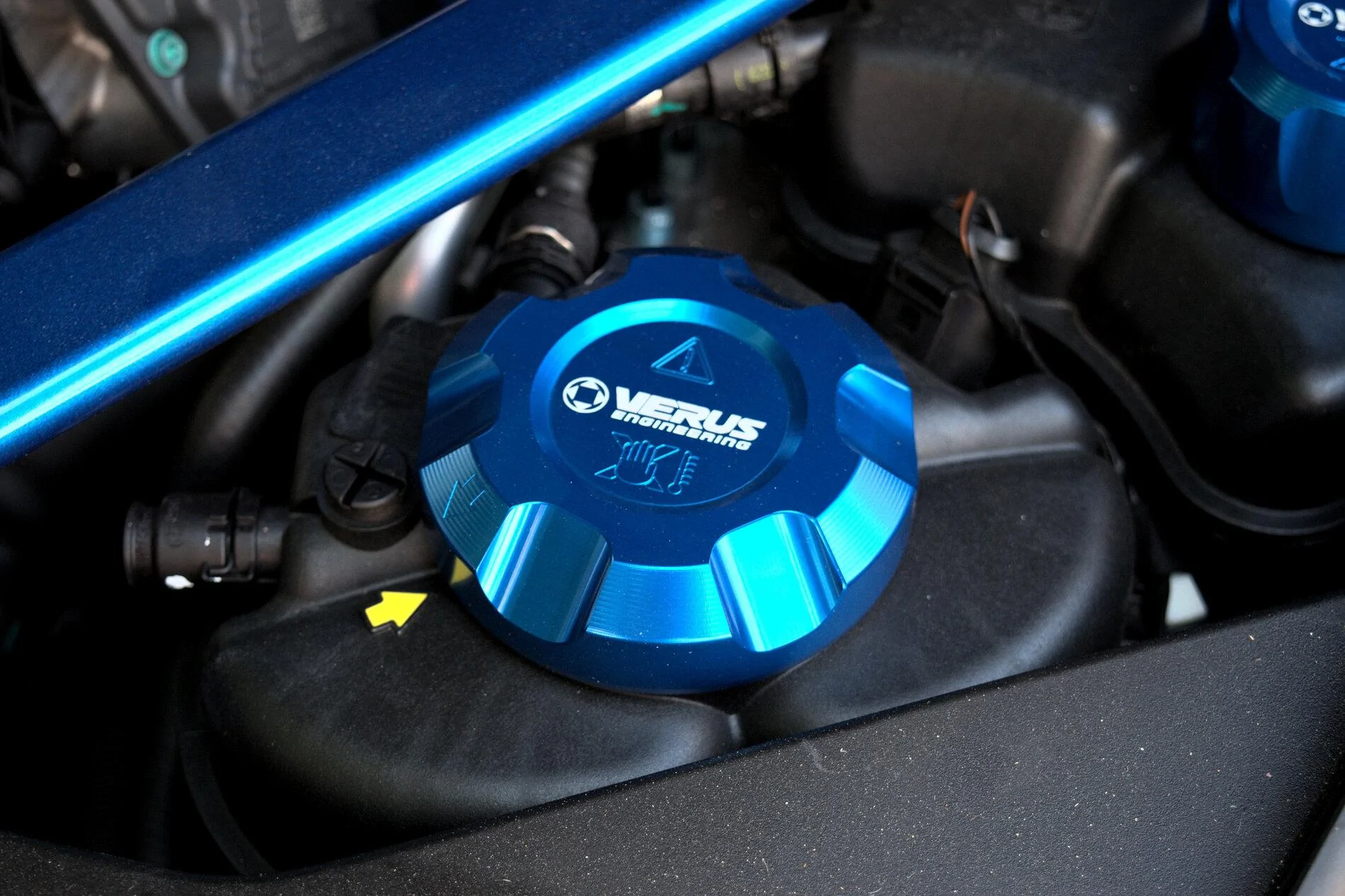

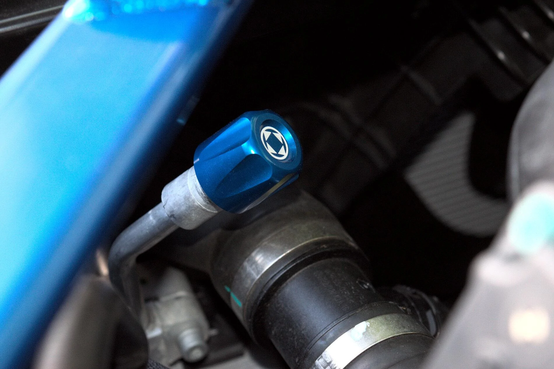

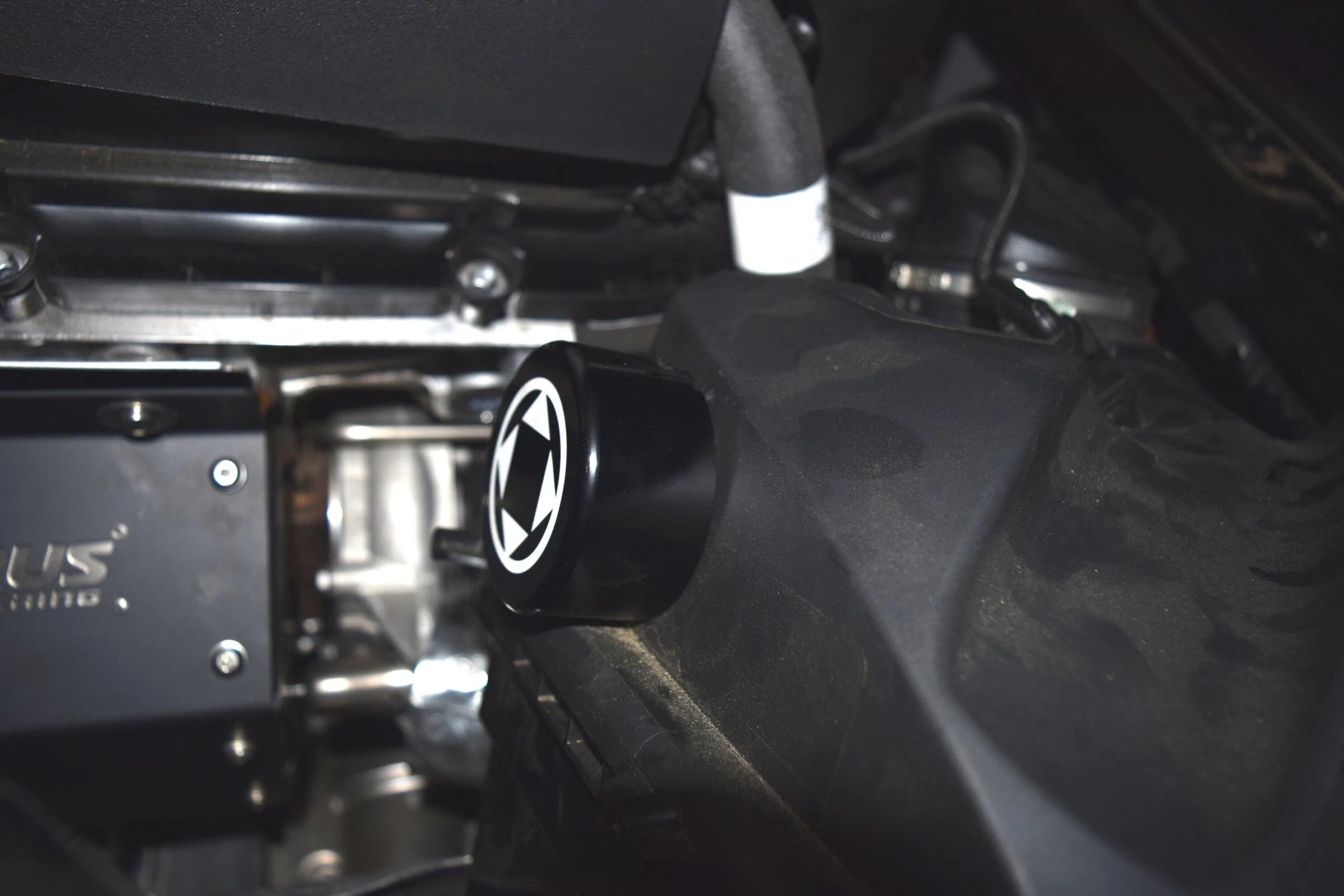

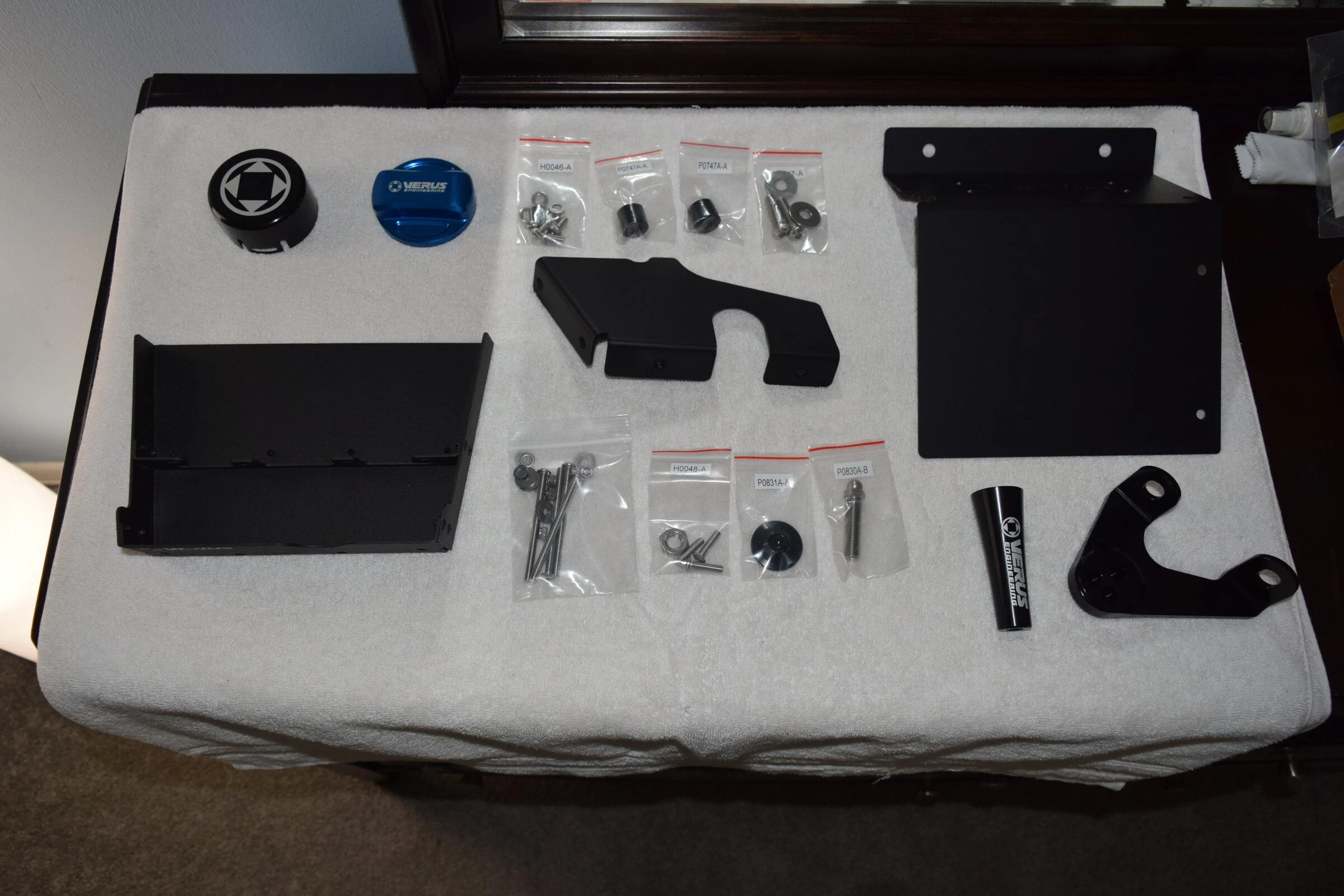

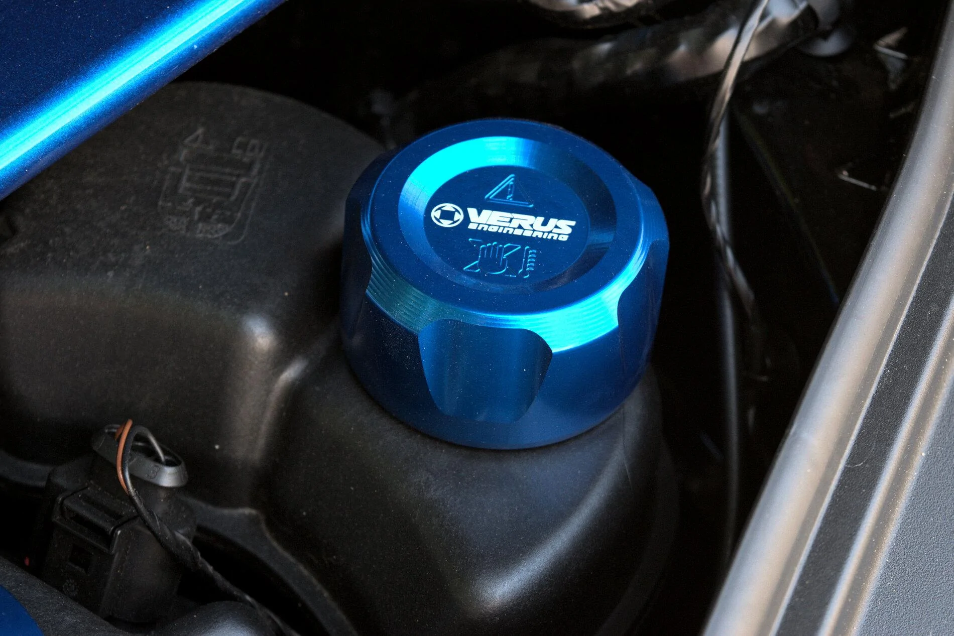

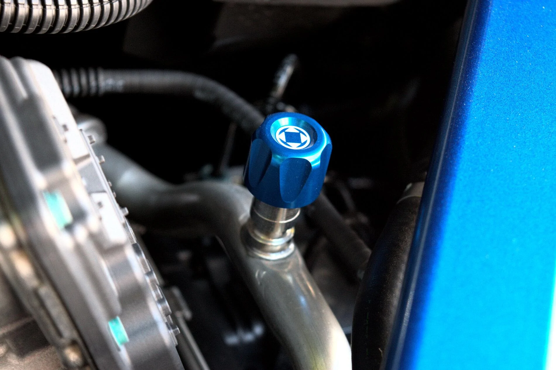

Some small cosmetic updates went on today, thanks to Verus Engineering. Continuing the black and blue theme. Got the Engine Bay Fluid Cap Kit, A/C Cap Kit, and Windshield Washer Fluid Reservoir Kit. Some quick pictures are attached below. I think I need to paint the engine cover stripes blue now, going to look into some paints that will match the blues here and work well with the plastic/heat.
I have a more interesting update coming soon.

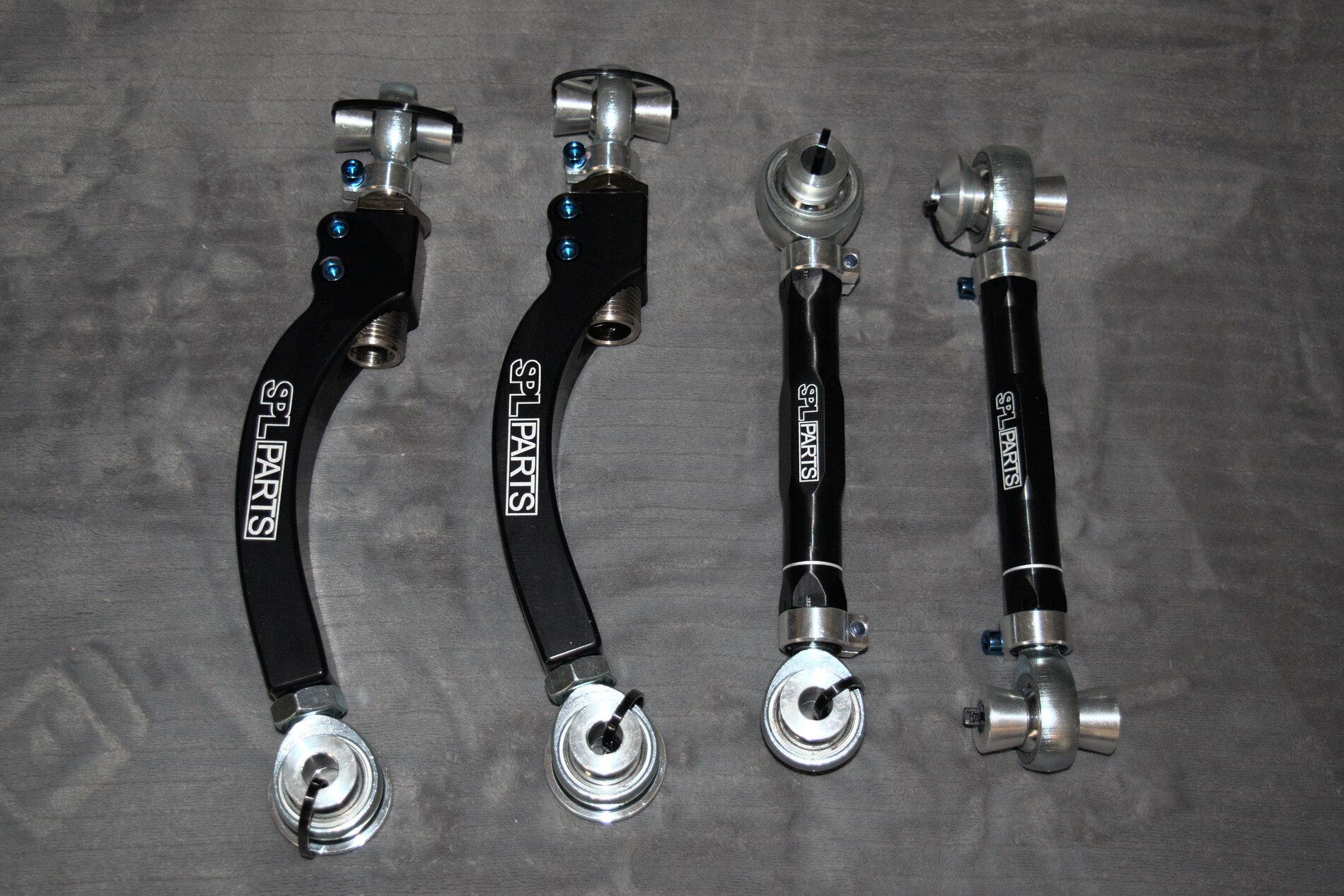

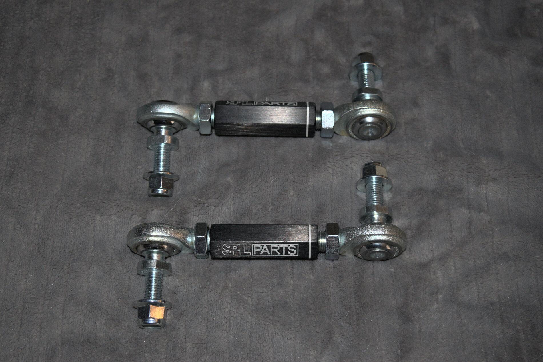

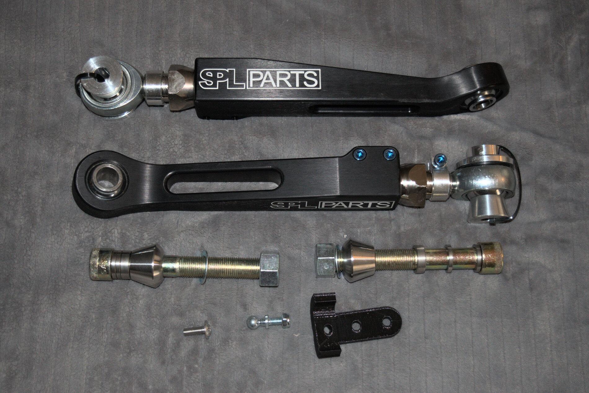

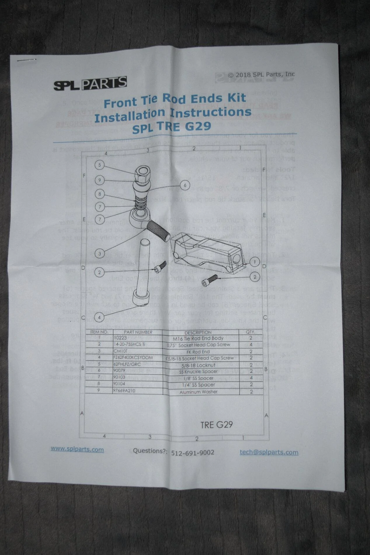

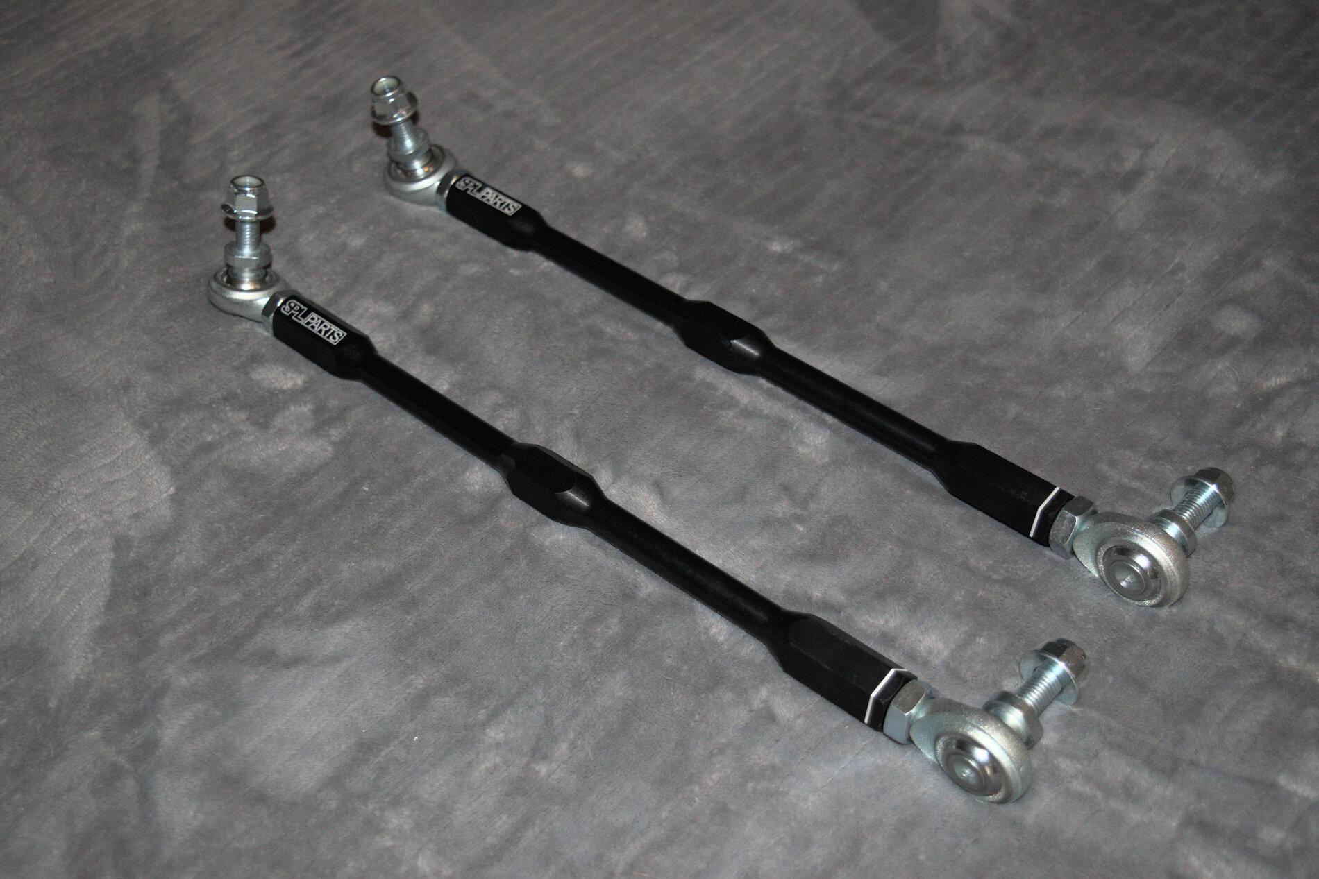

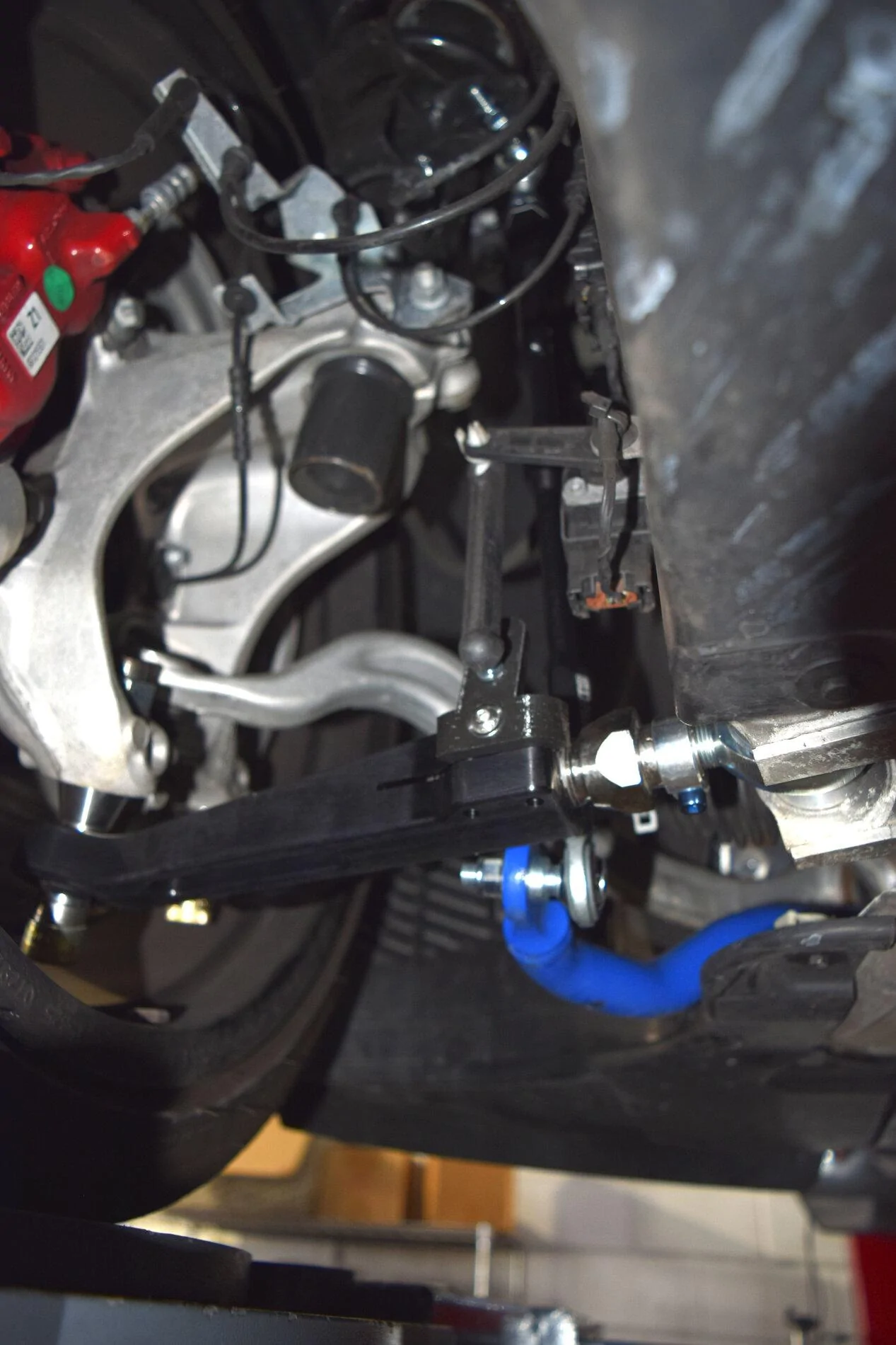

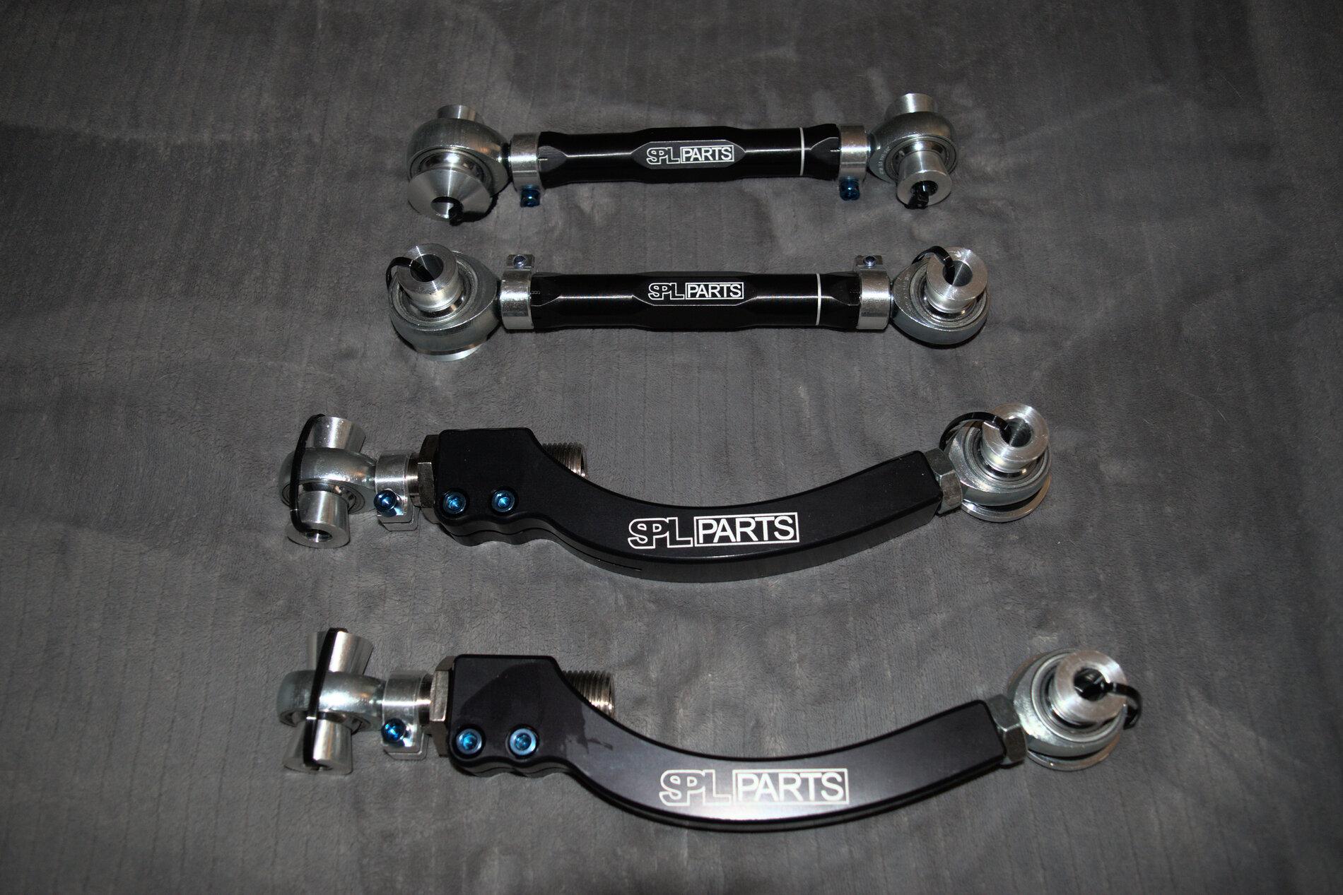

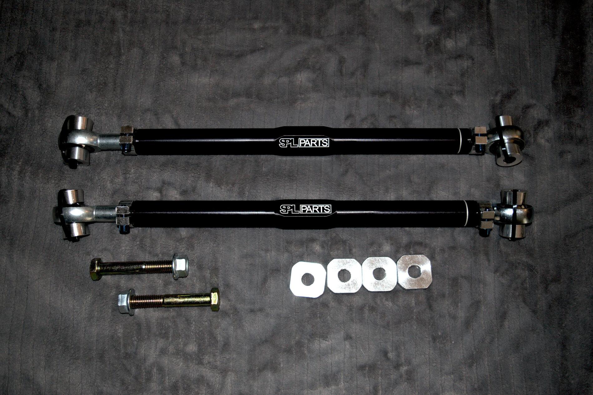

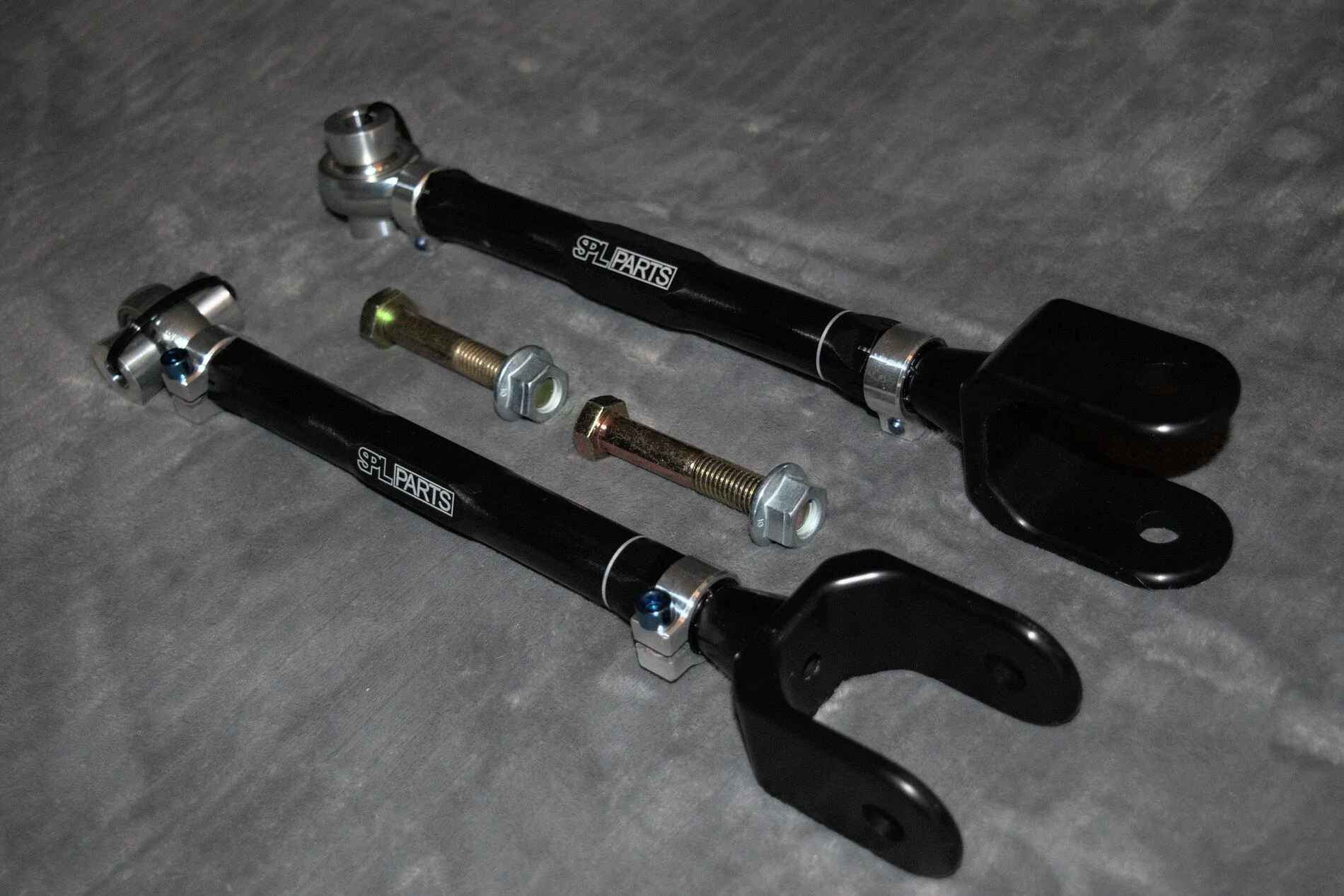

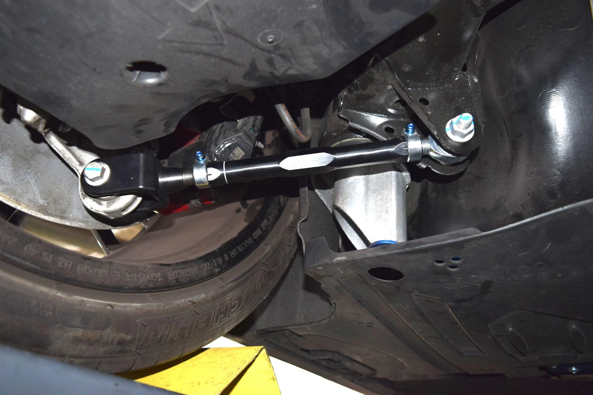

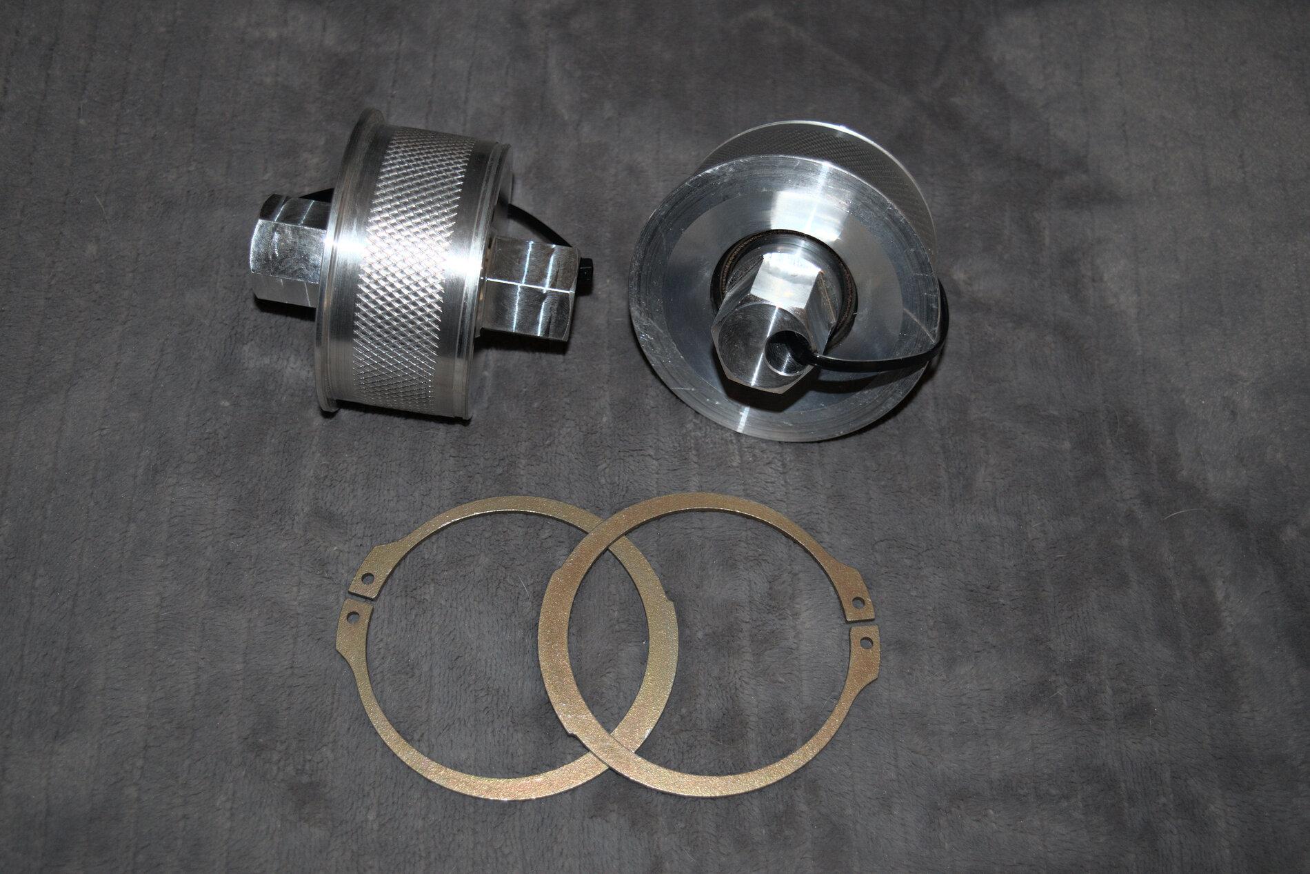

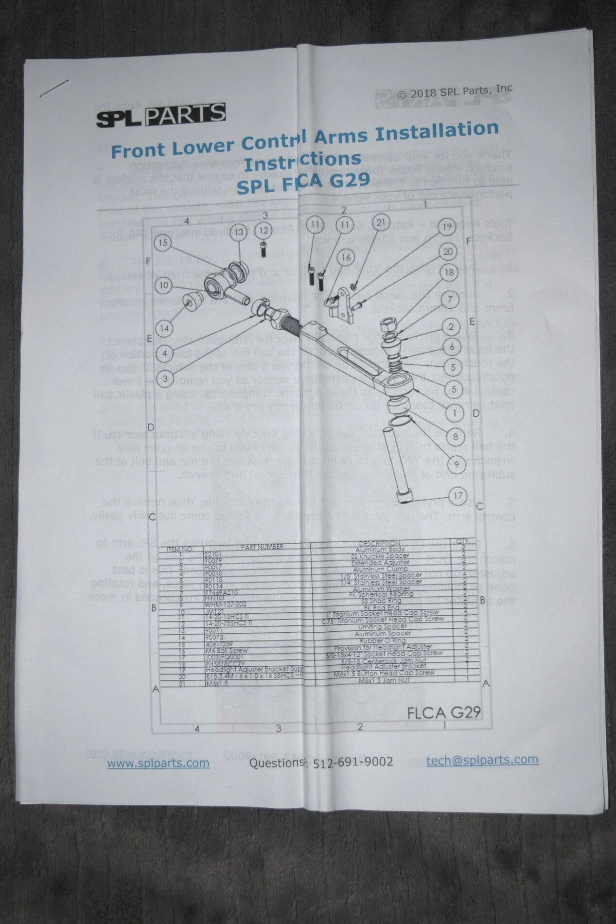

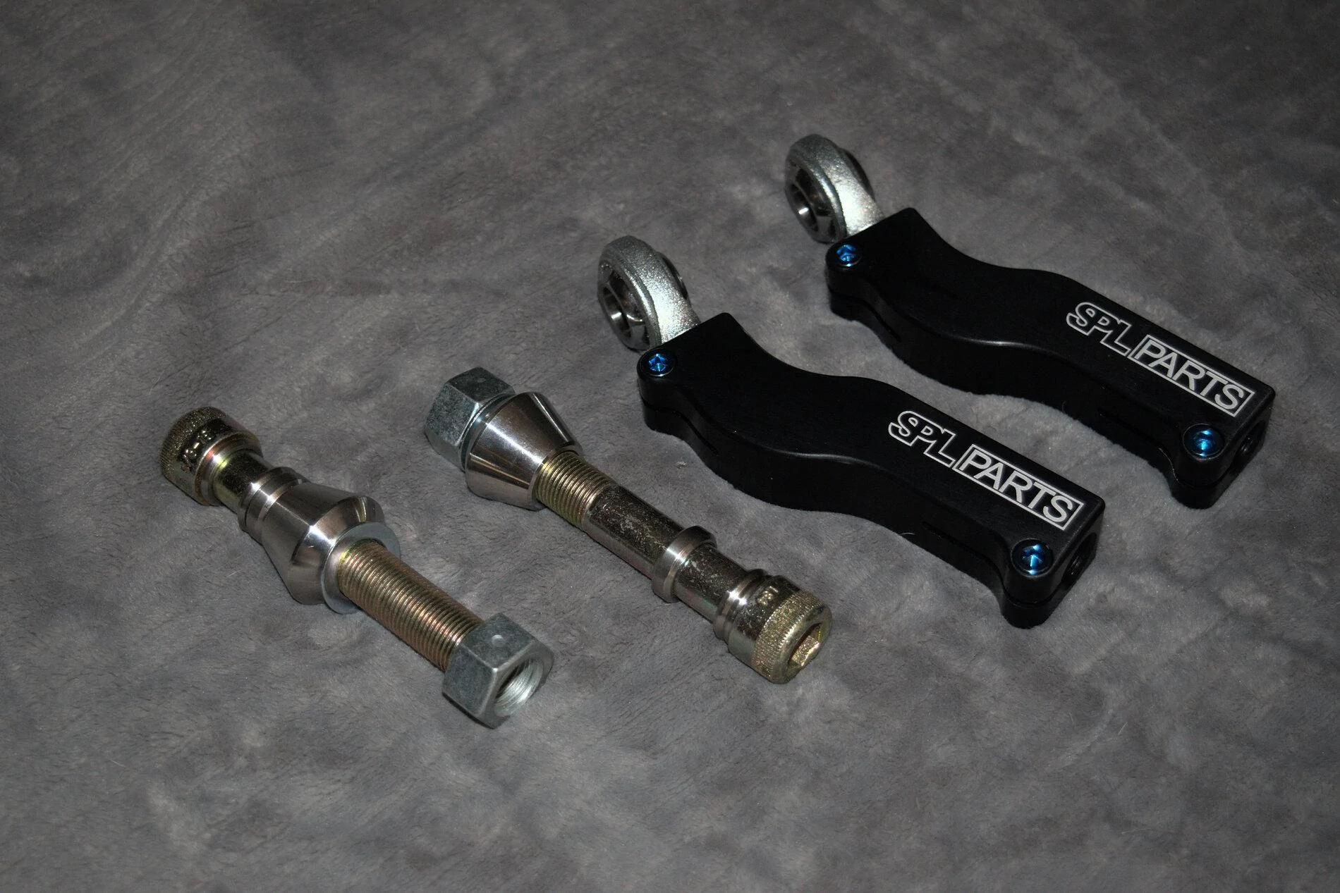

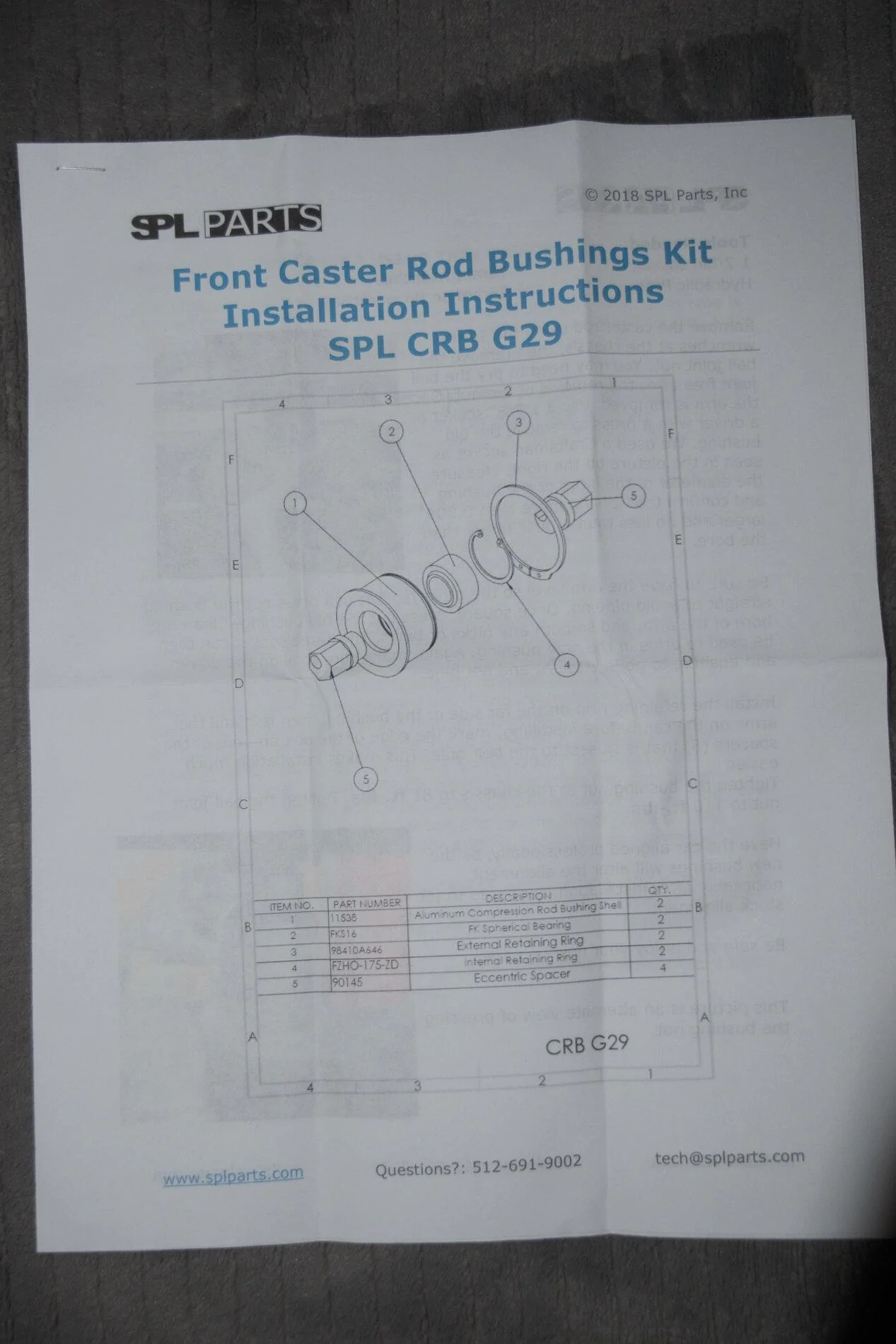

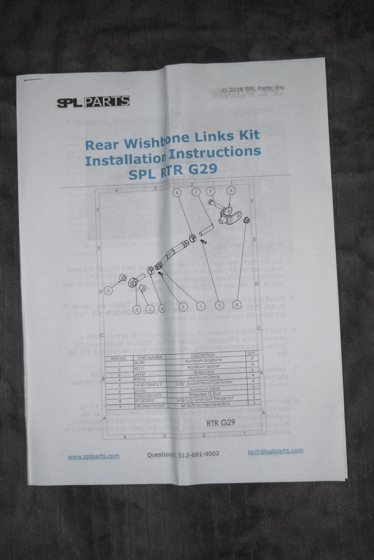

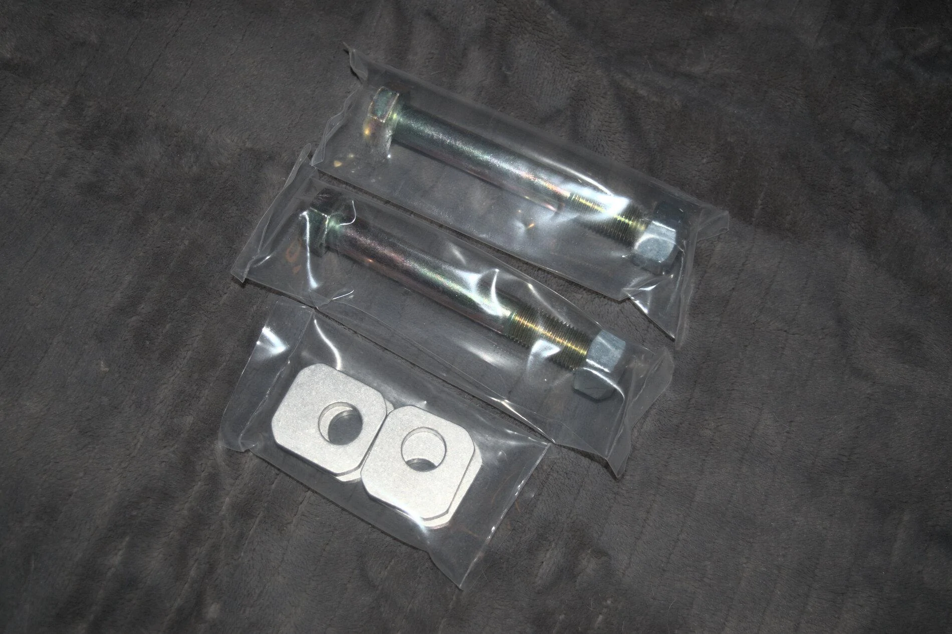

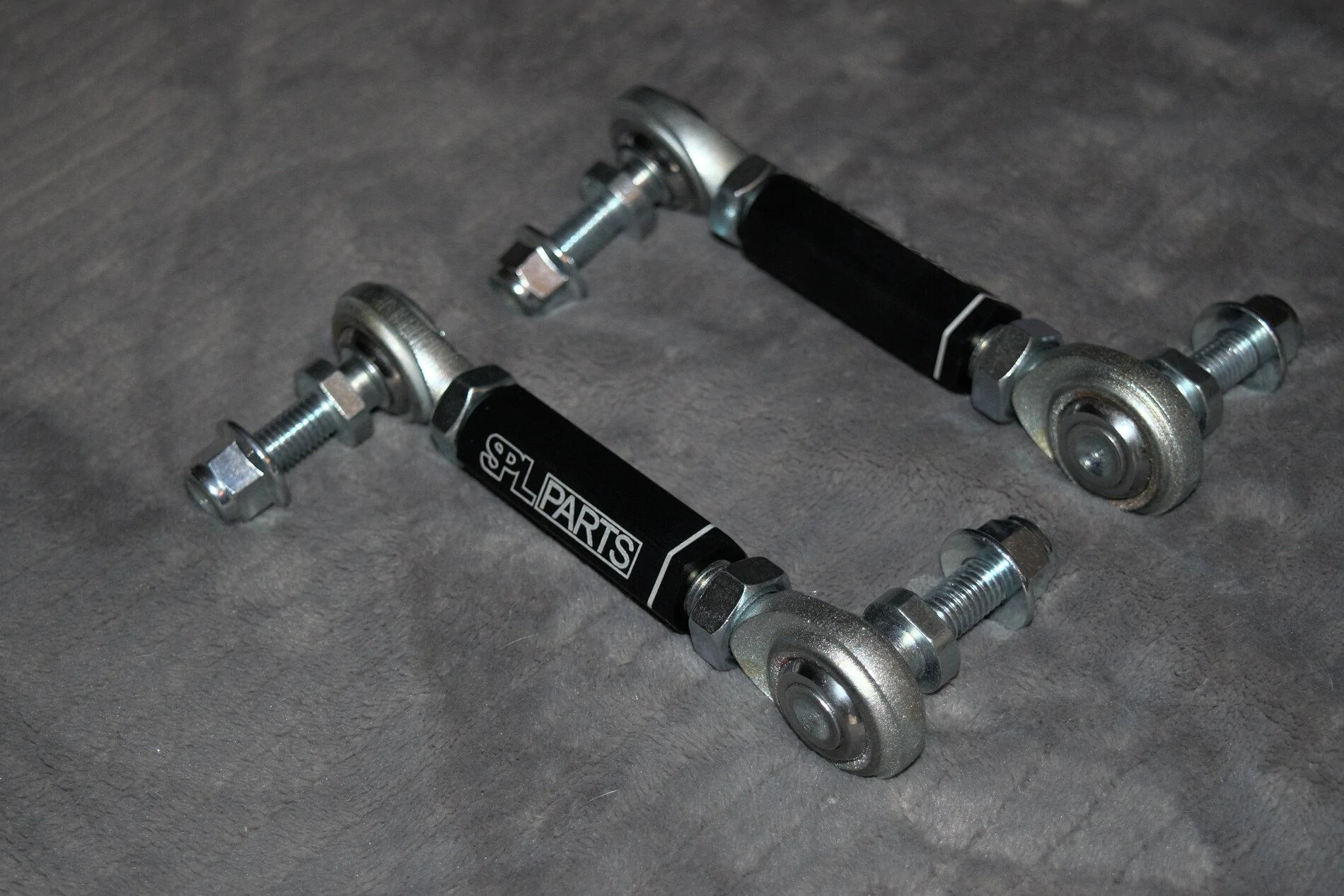

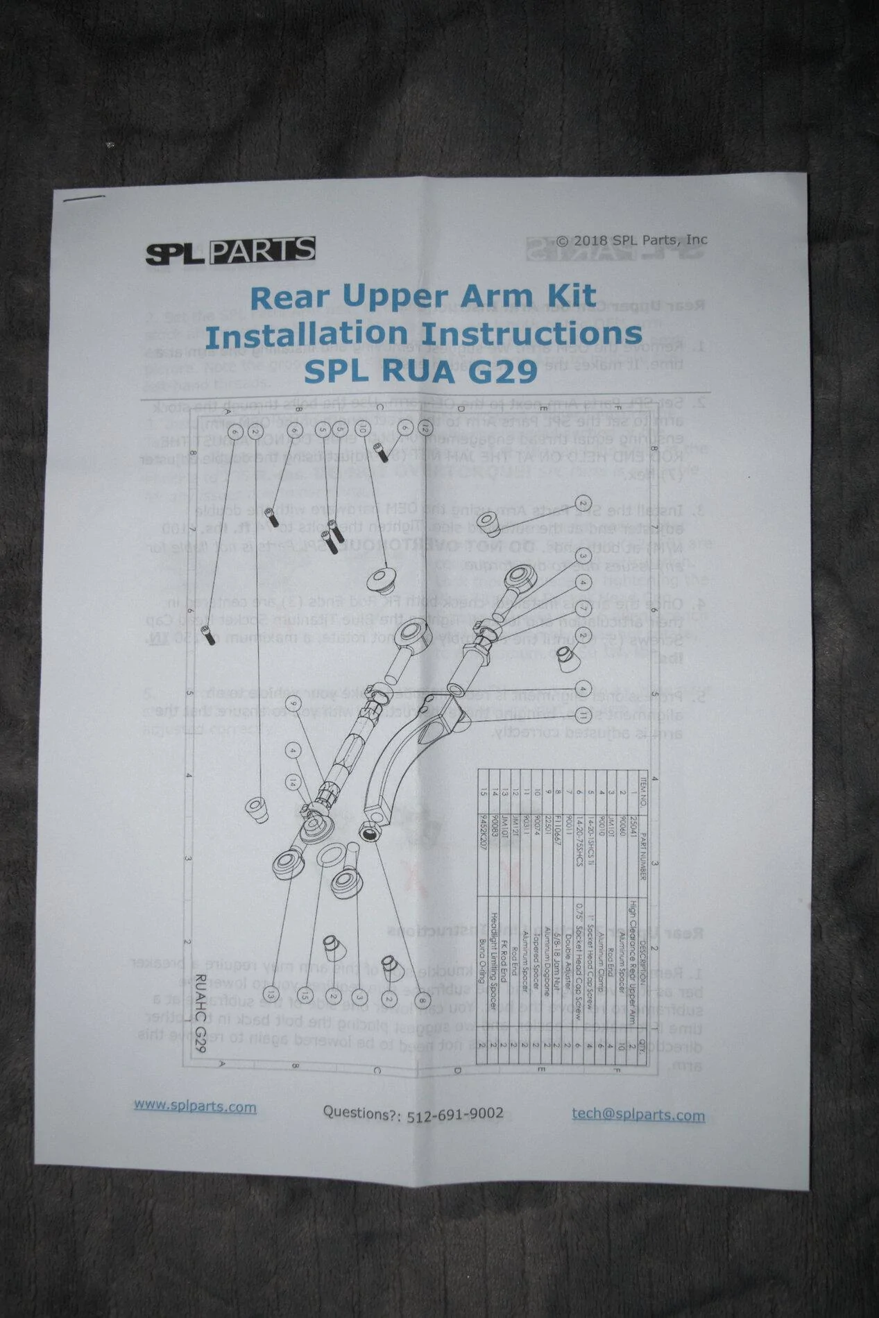

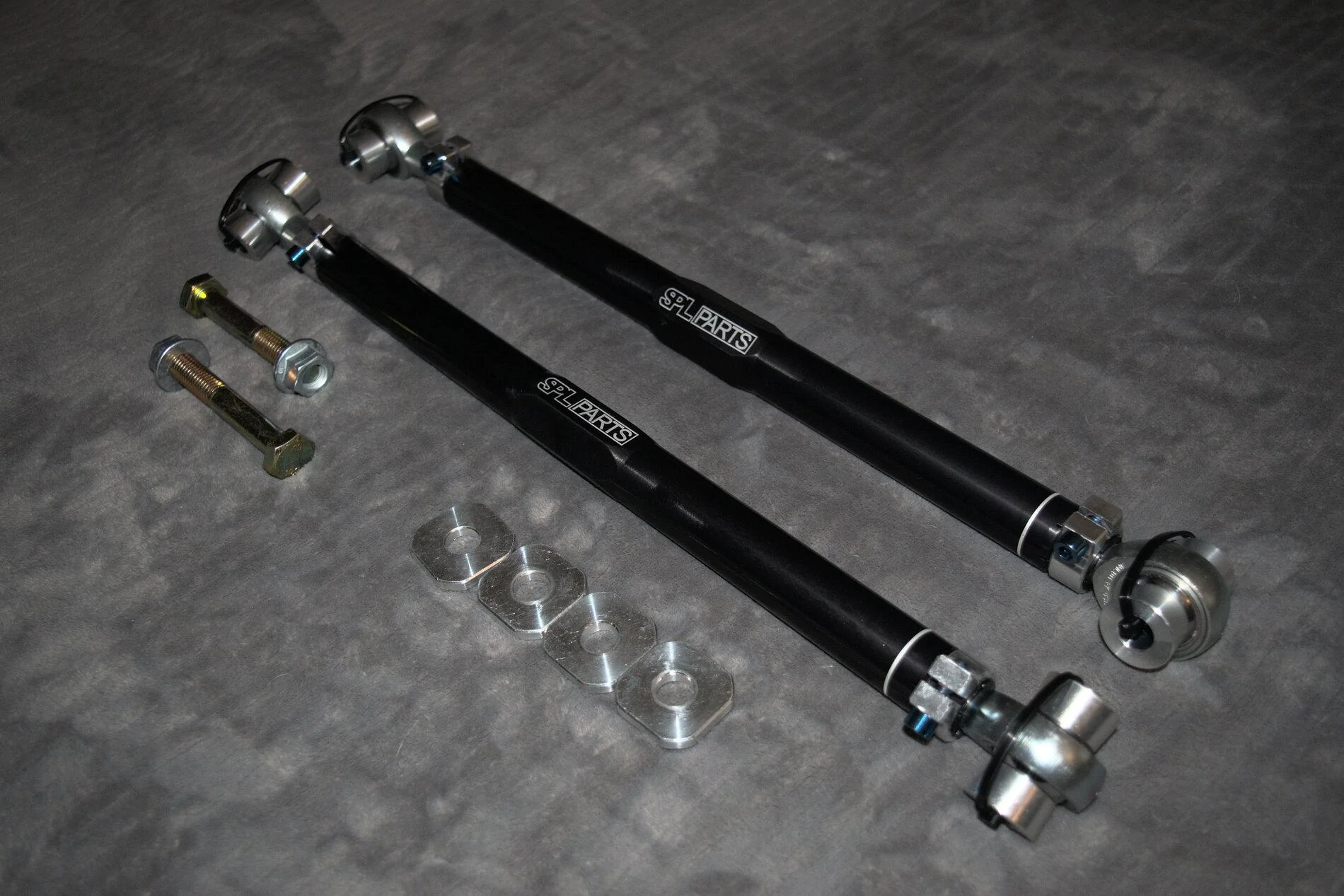

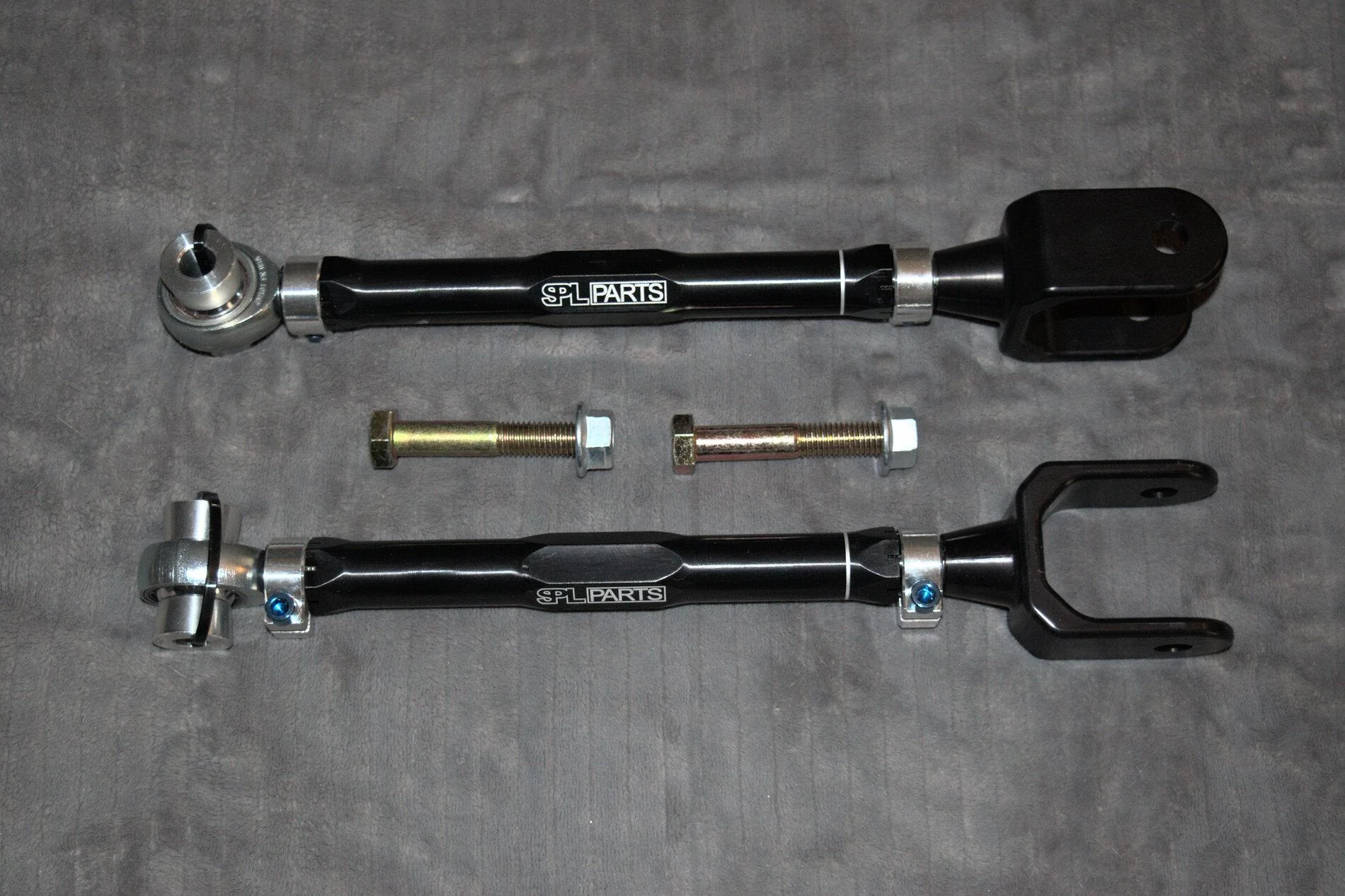

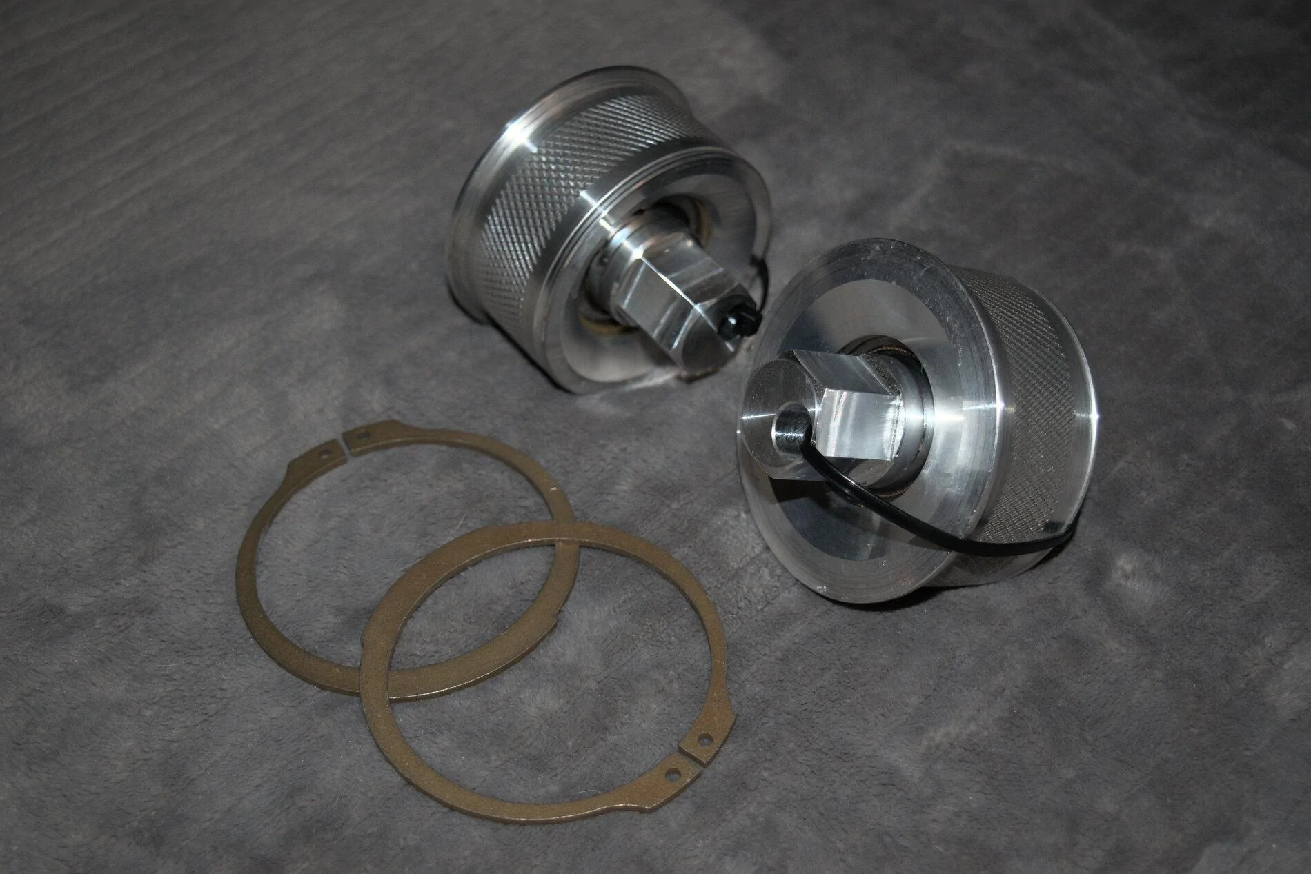

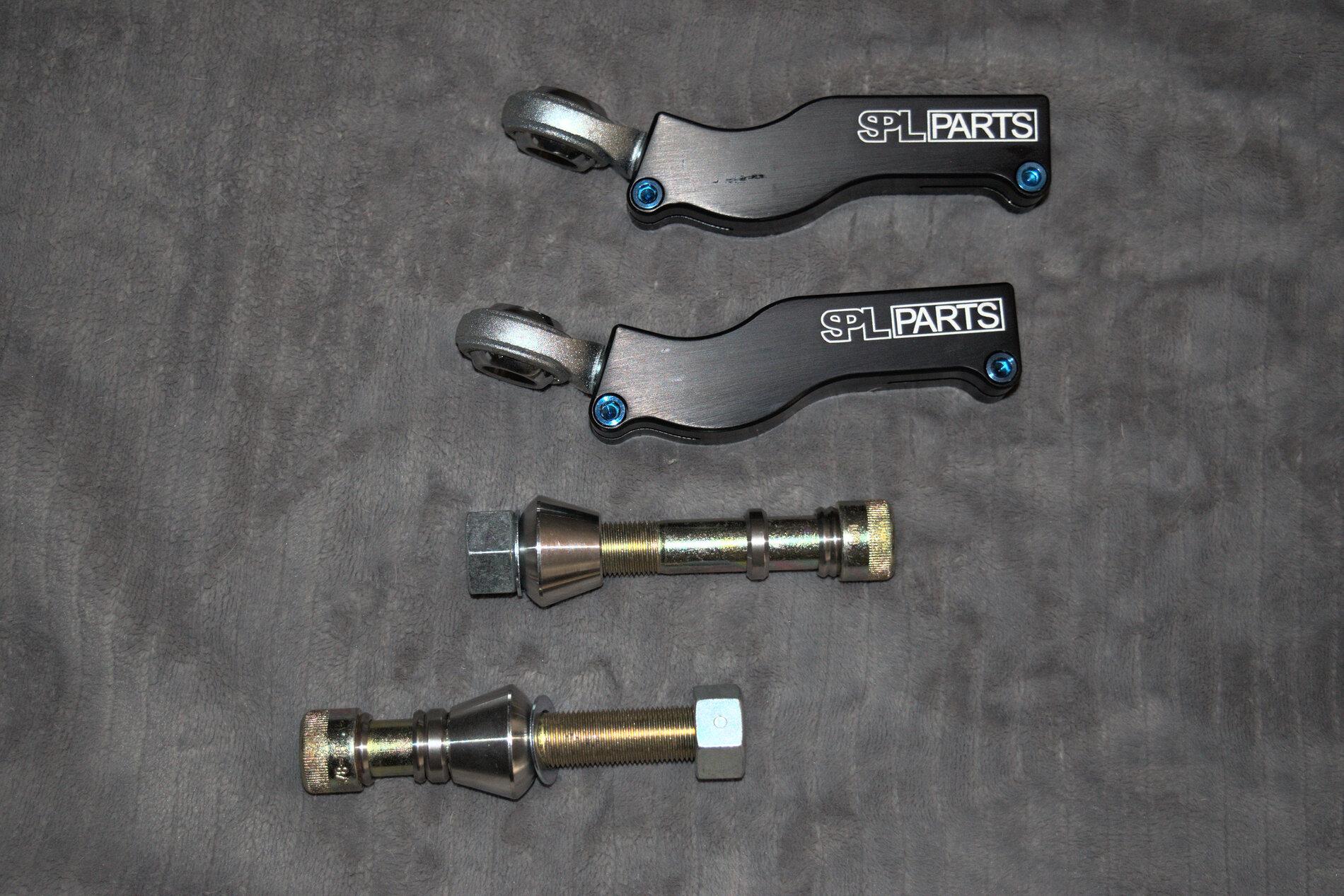

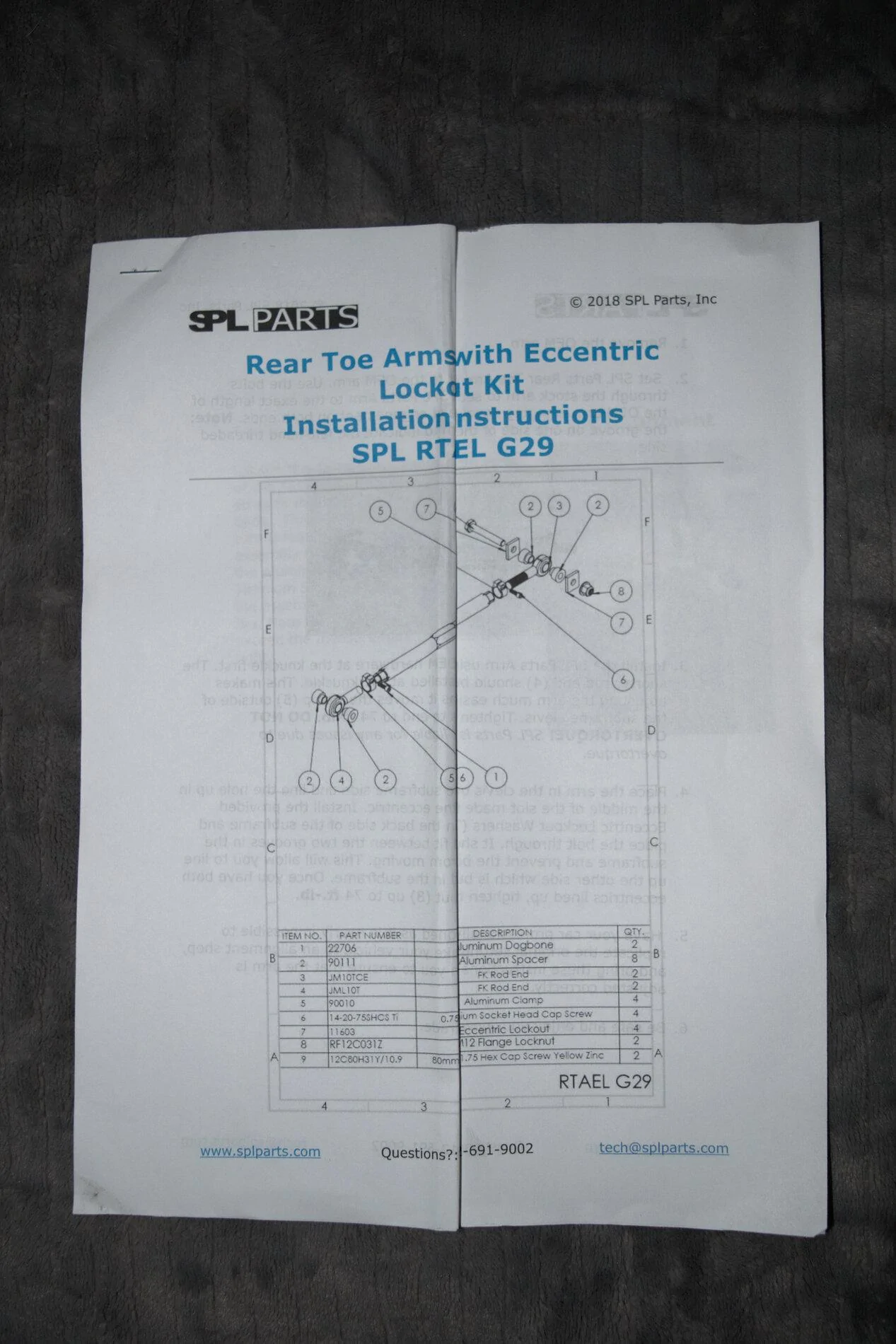

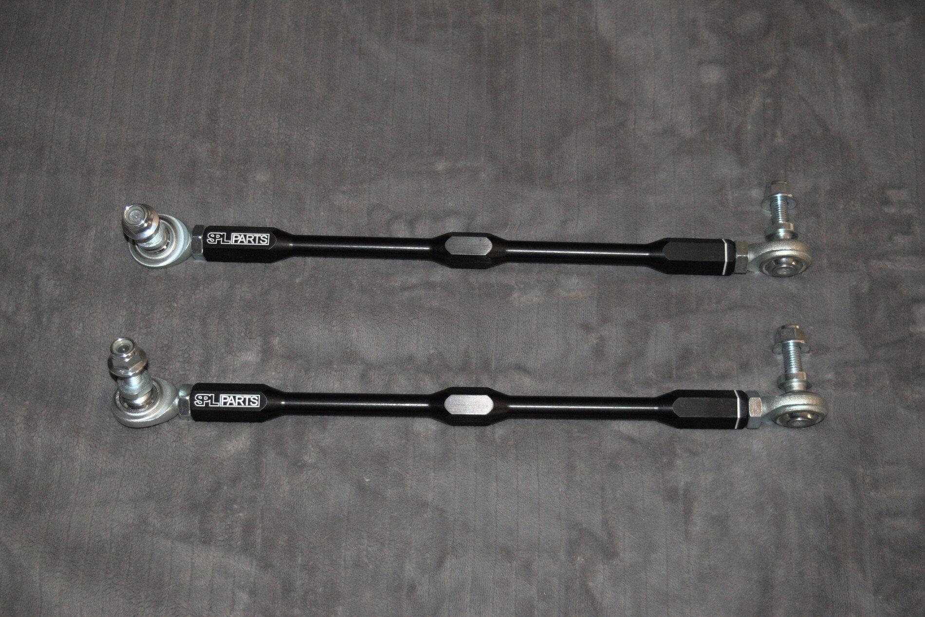

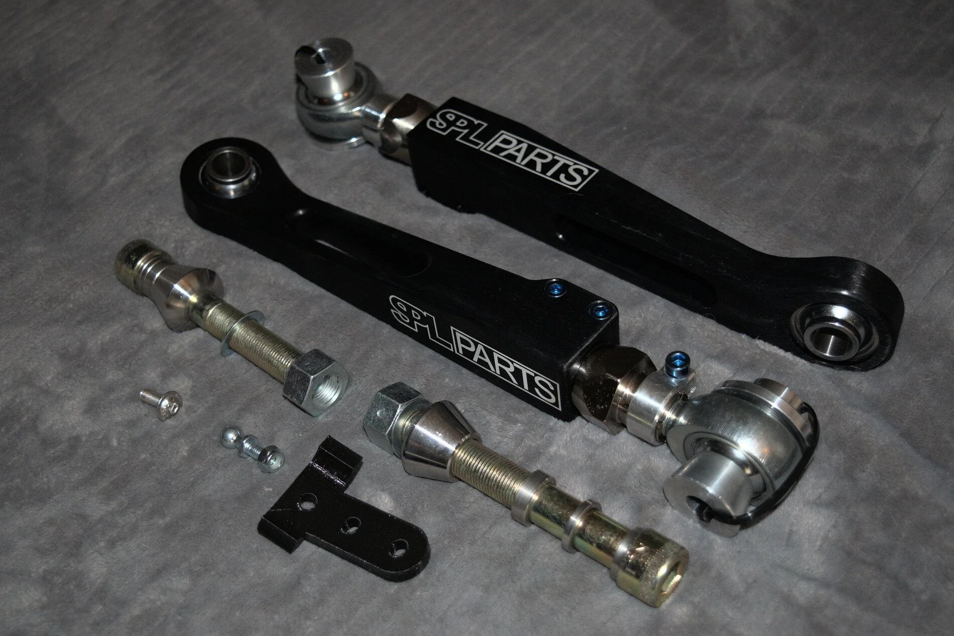

SPL Parts installed! Could only get pictures of some of them...
Great upgrade and I am very pleased with the feel now. I would not say driving dynamics have changes but everything feels tighter and more controlled; I feel much more comfortable during spirited drives. Aligned to essentially stock specs for now. A little more road noise but mostly from interior trim vibrating. Might look into sound dampening next. One little hiccup with the rear sway bar endlink nuts getting loose but a quick tighten and no more issues.
I think I am looking at some minor things and maintenance for a little while: tires (RE71R or RT660?), brake fluid/pad upgrade, cosmetics, and sound upgrades. Next bigger items are coilovers or wheels, but it will be a little while.

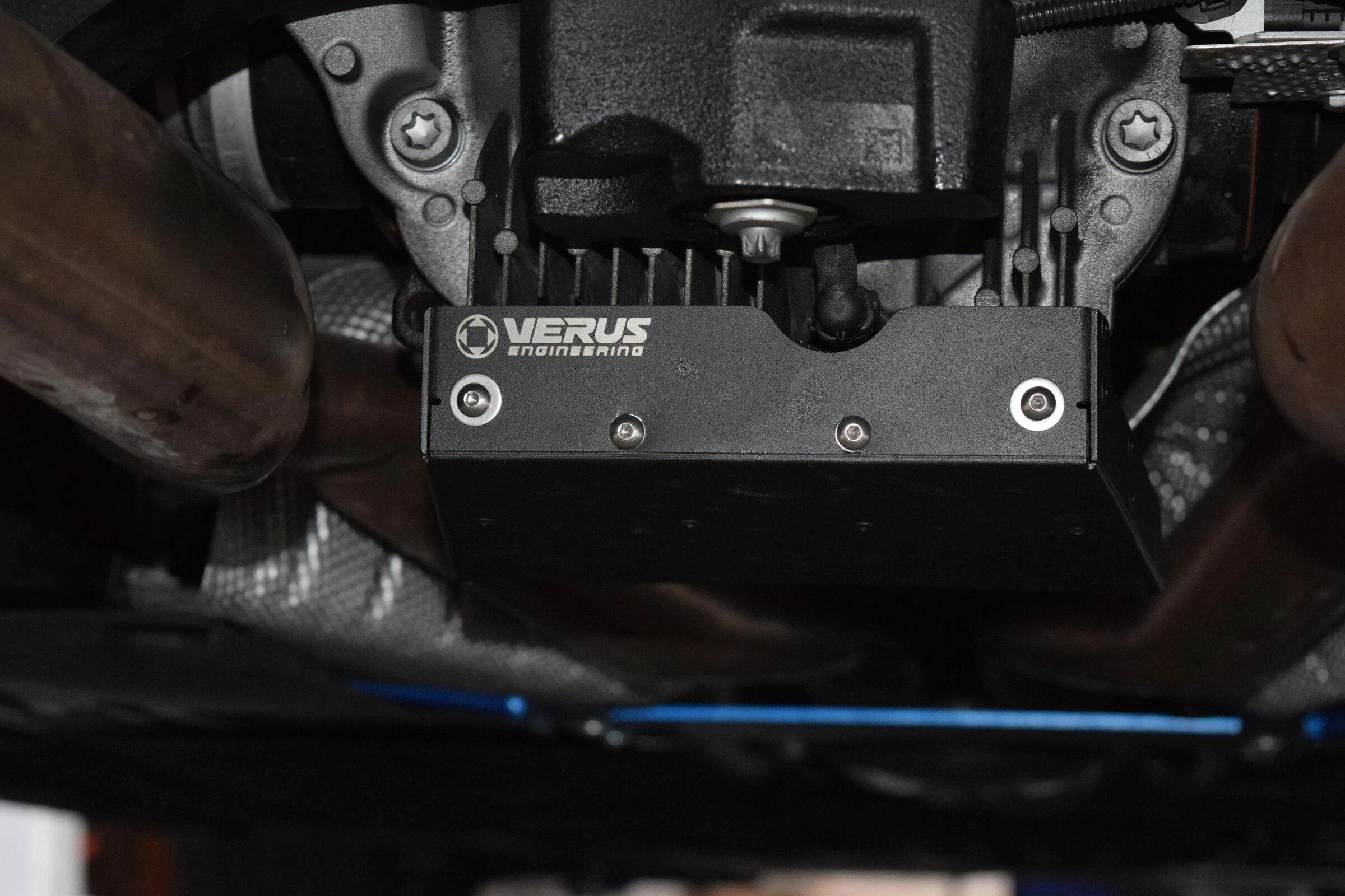

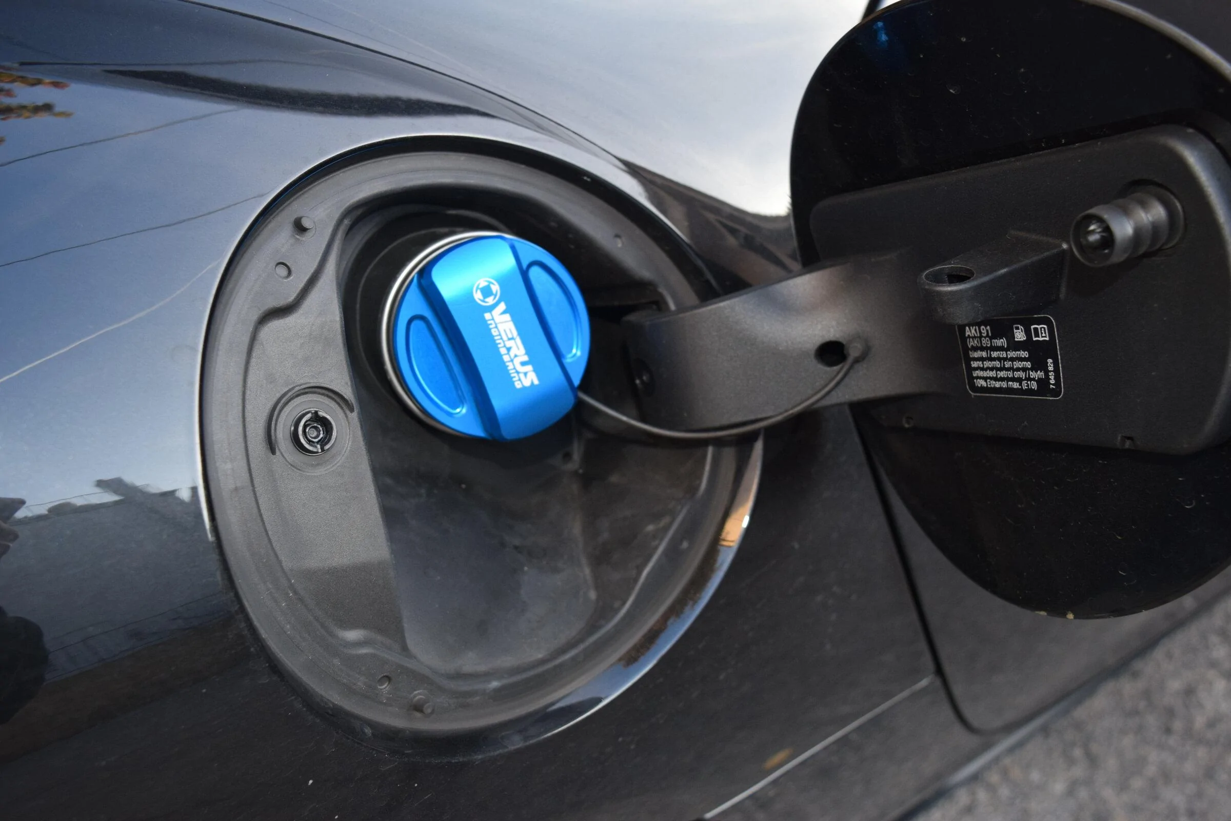

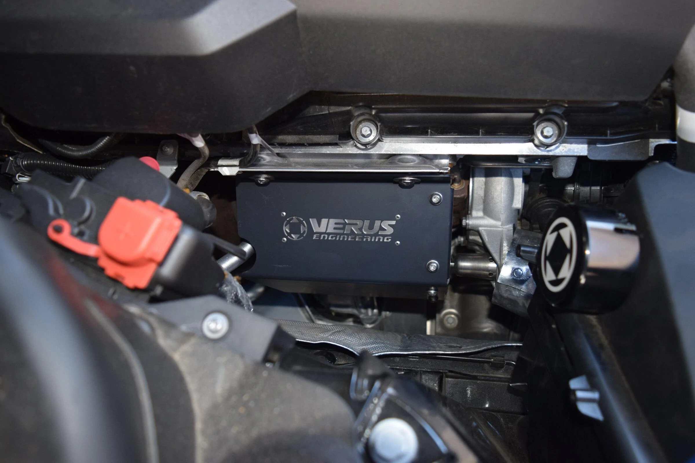

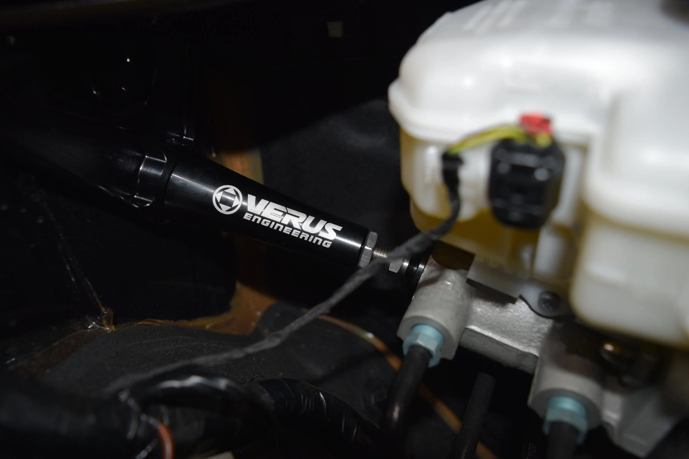

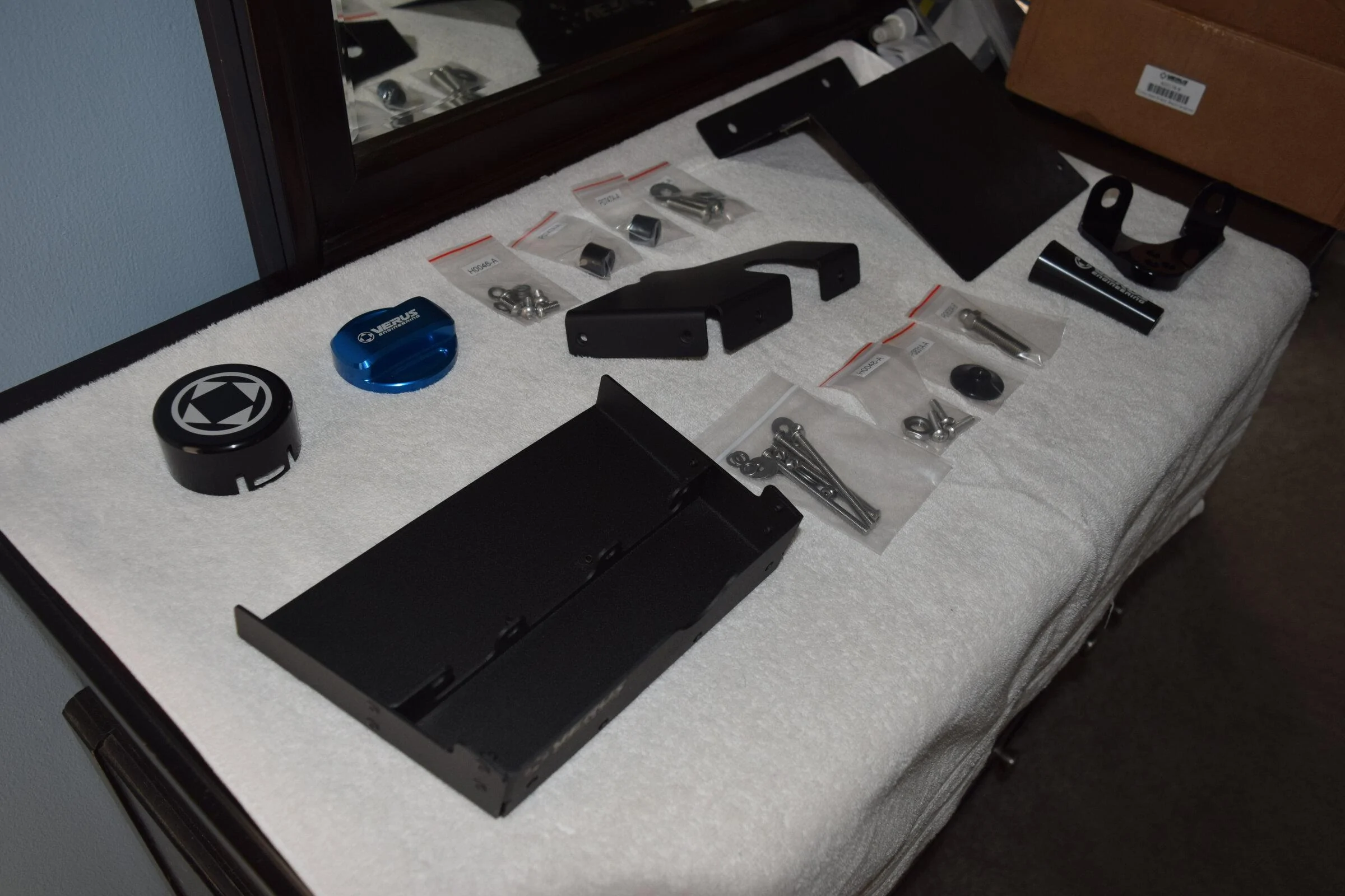

Got some new Verus parts in the car this weekend! Just small touches for now.
I got their diff and turbo heat shields just to throw on. The resonator delete which did improve intake sound slightly and lets me see the new turbo heat shield. The master cylinder brace for some extra support there. And the gas cap cover to match all the other covers on the car.
(Excuse the dirty car, needs a good cleaning once the weather is a little nicer)

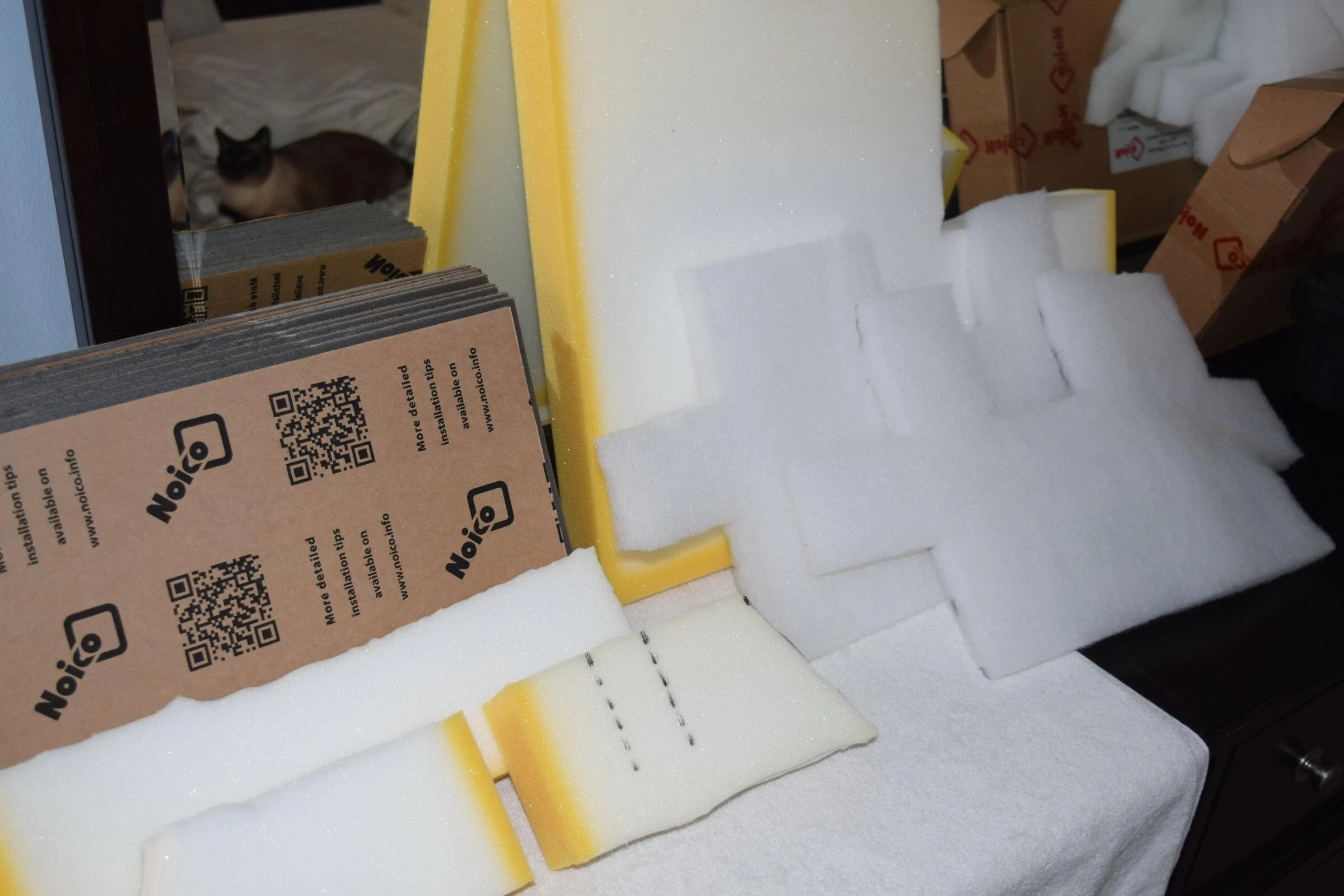

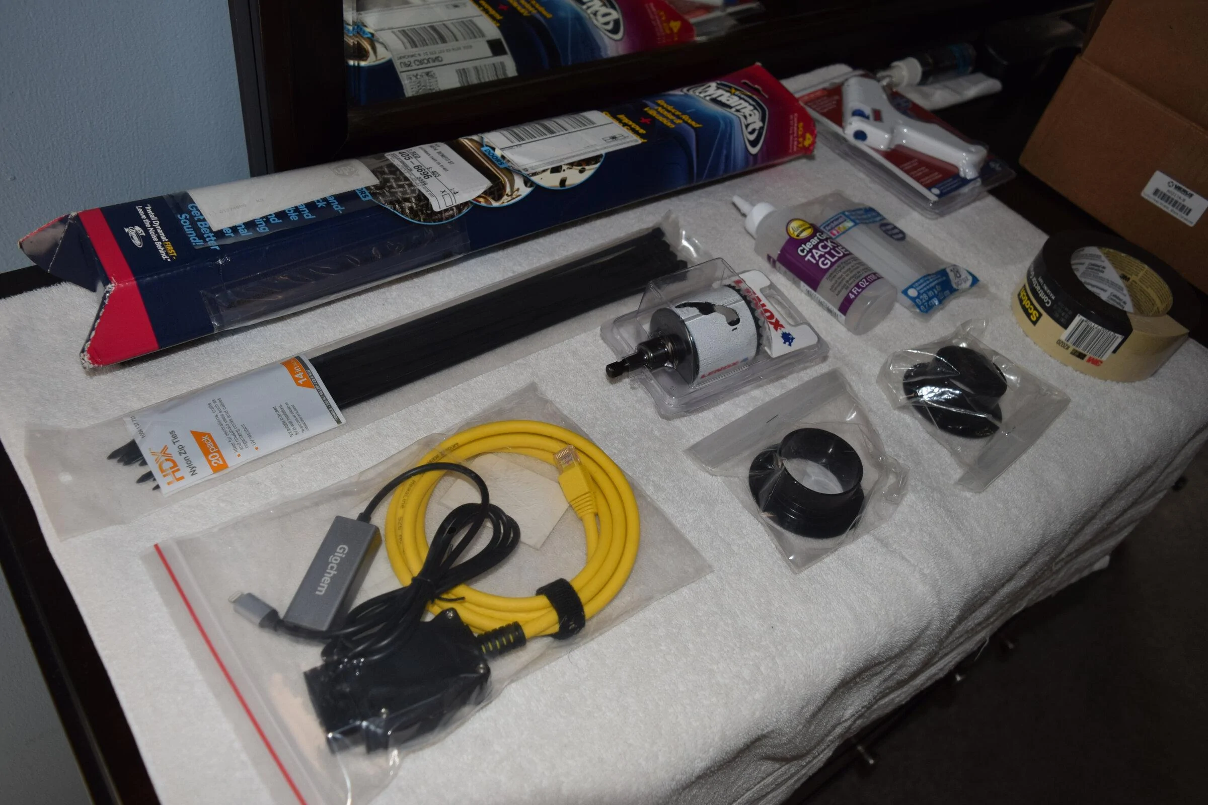

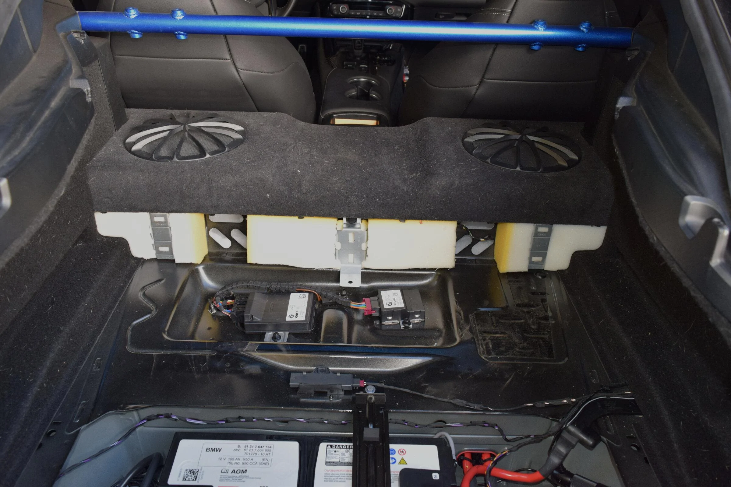

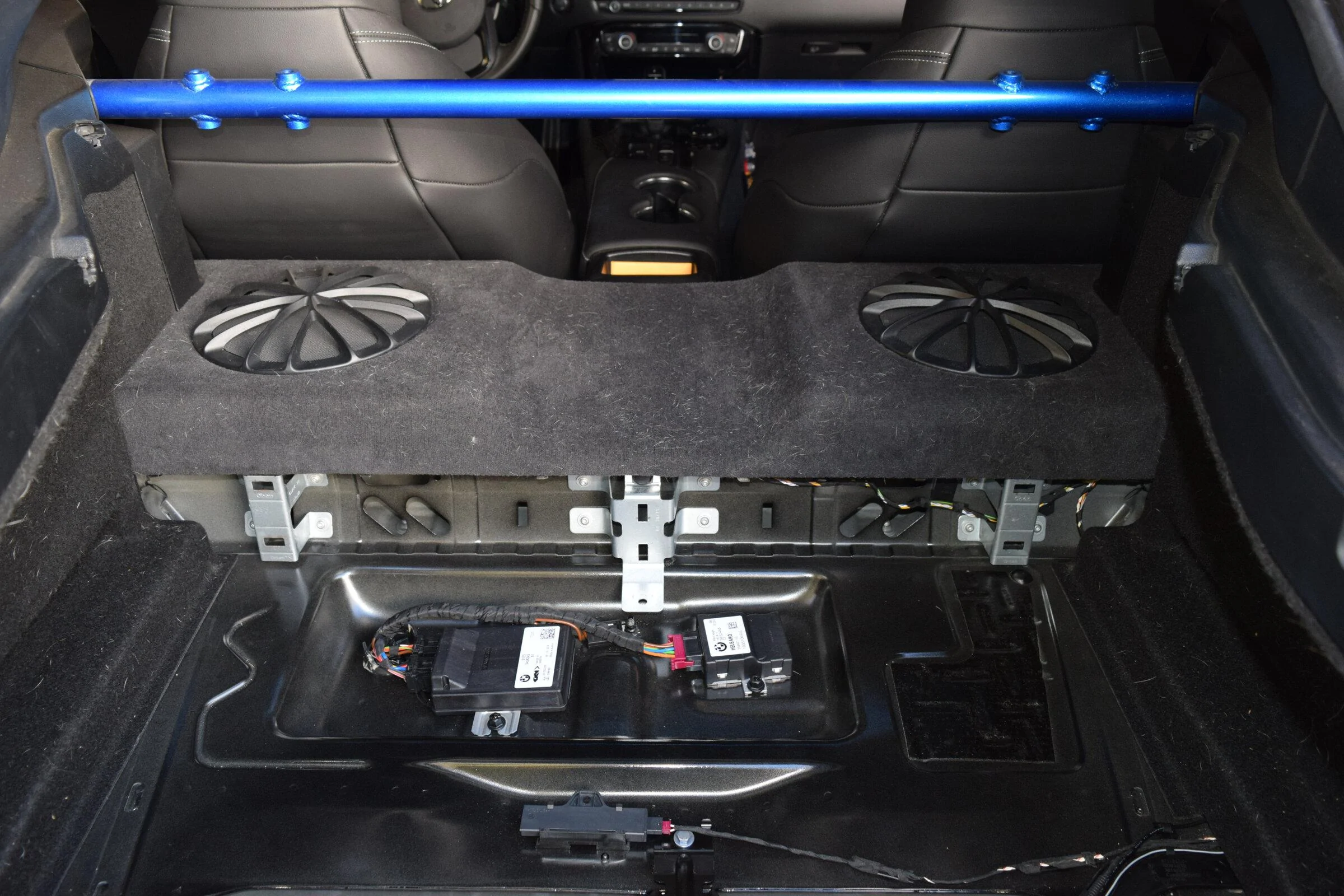

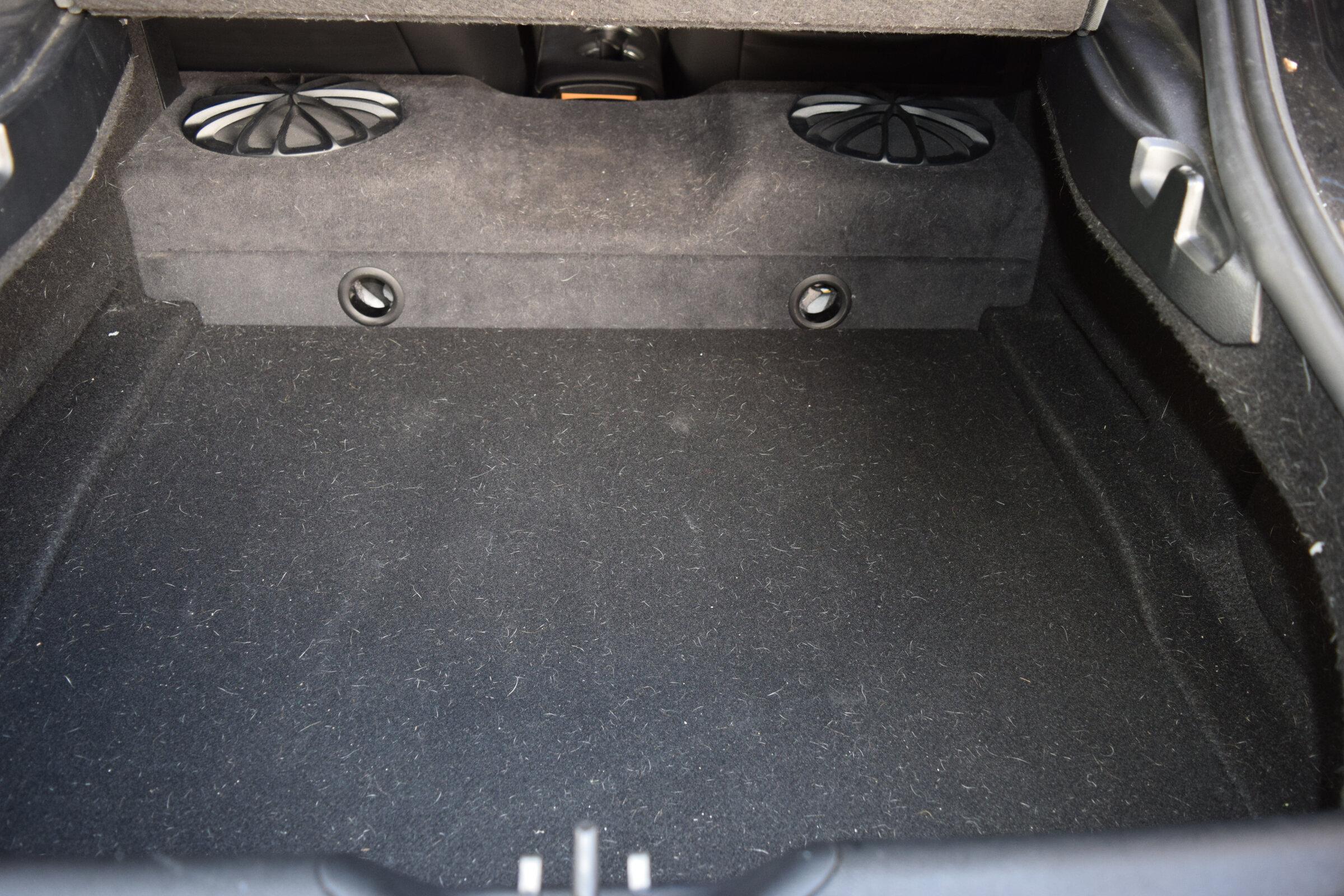

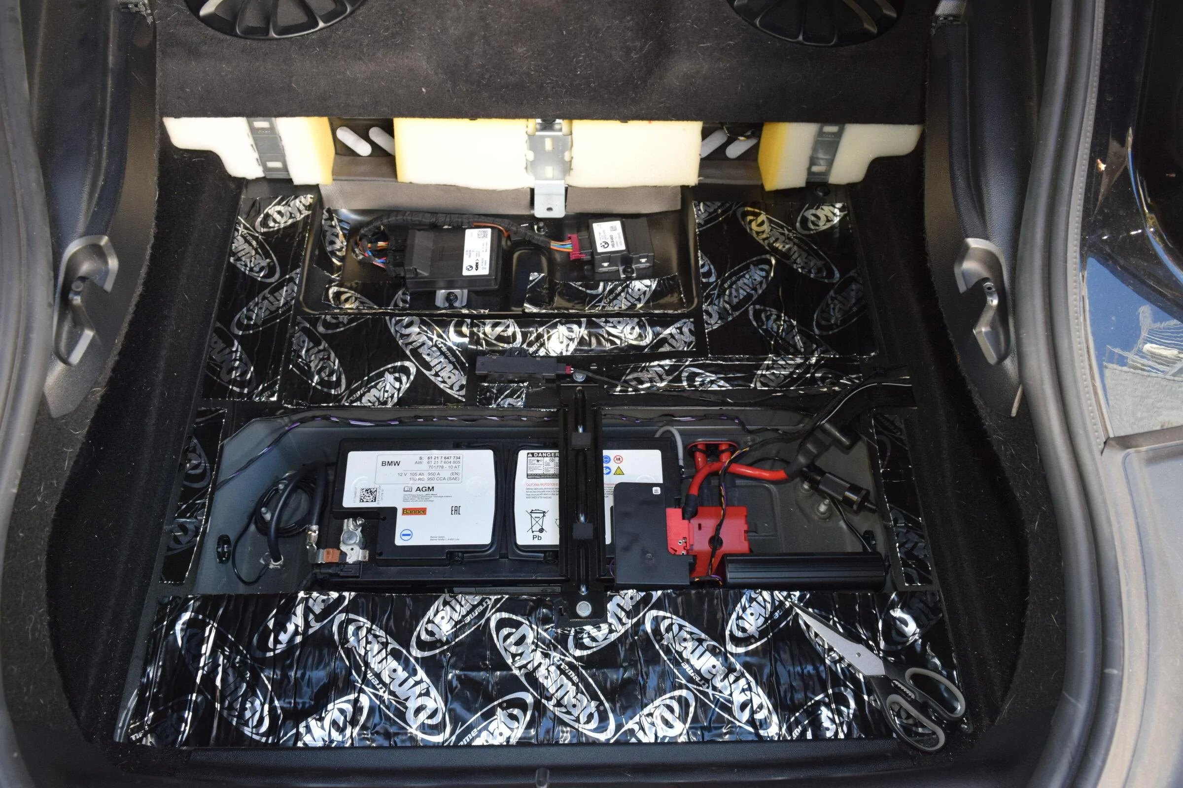

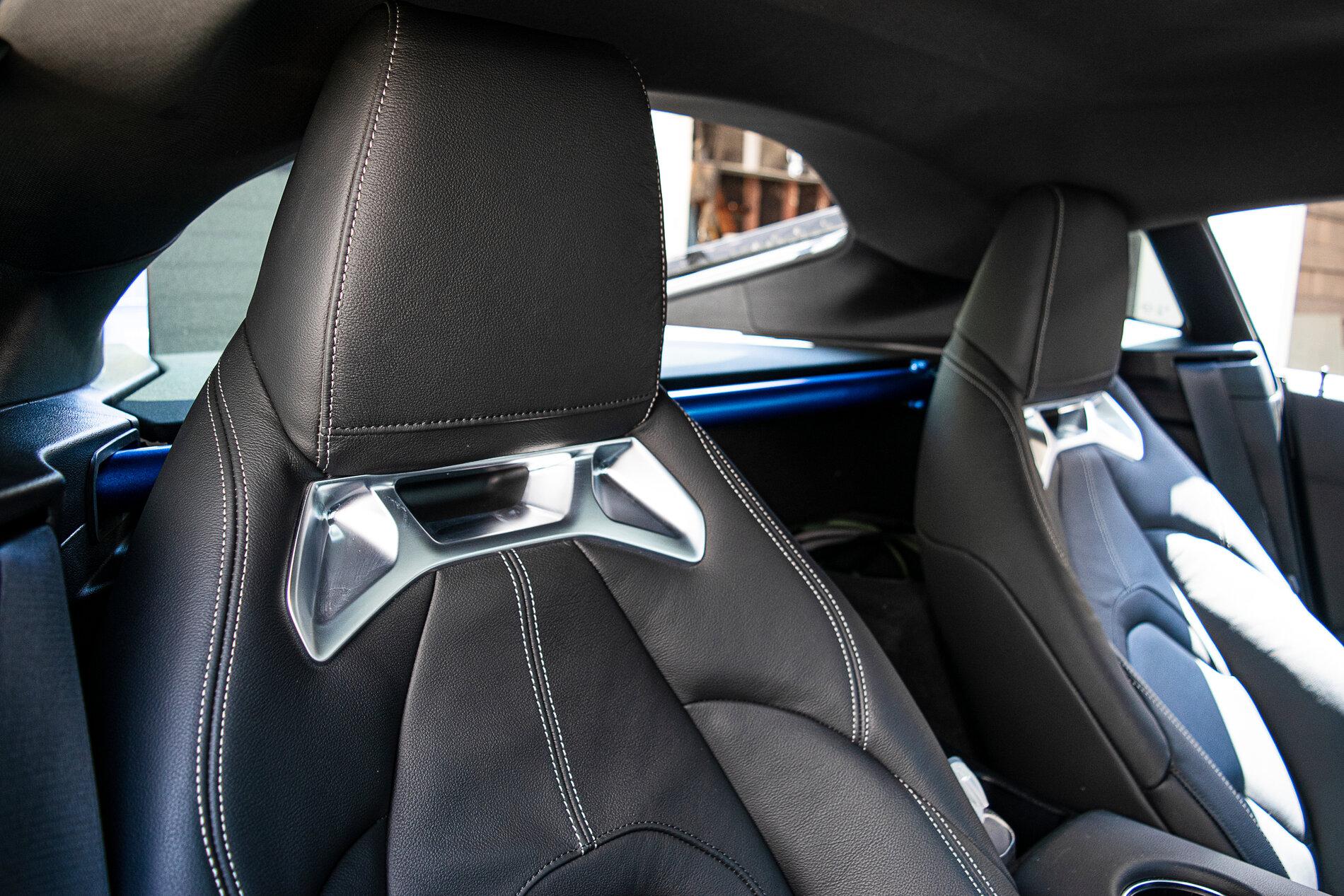

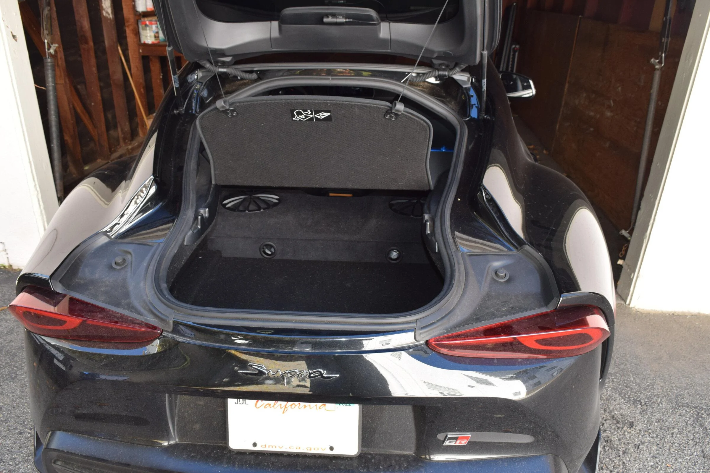

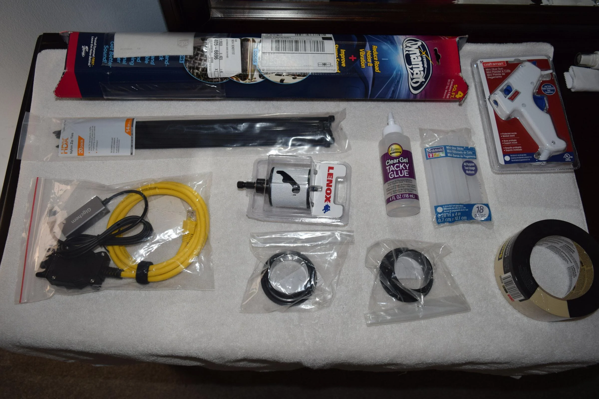

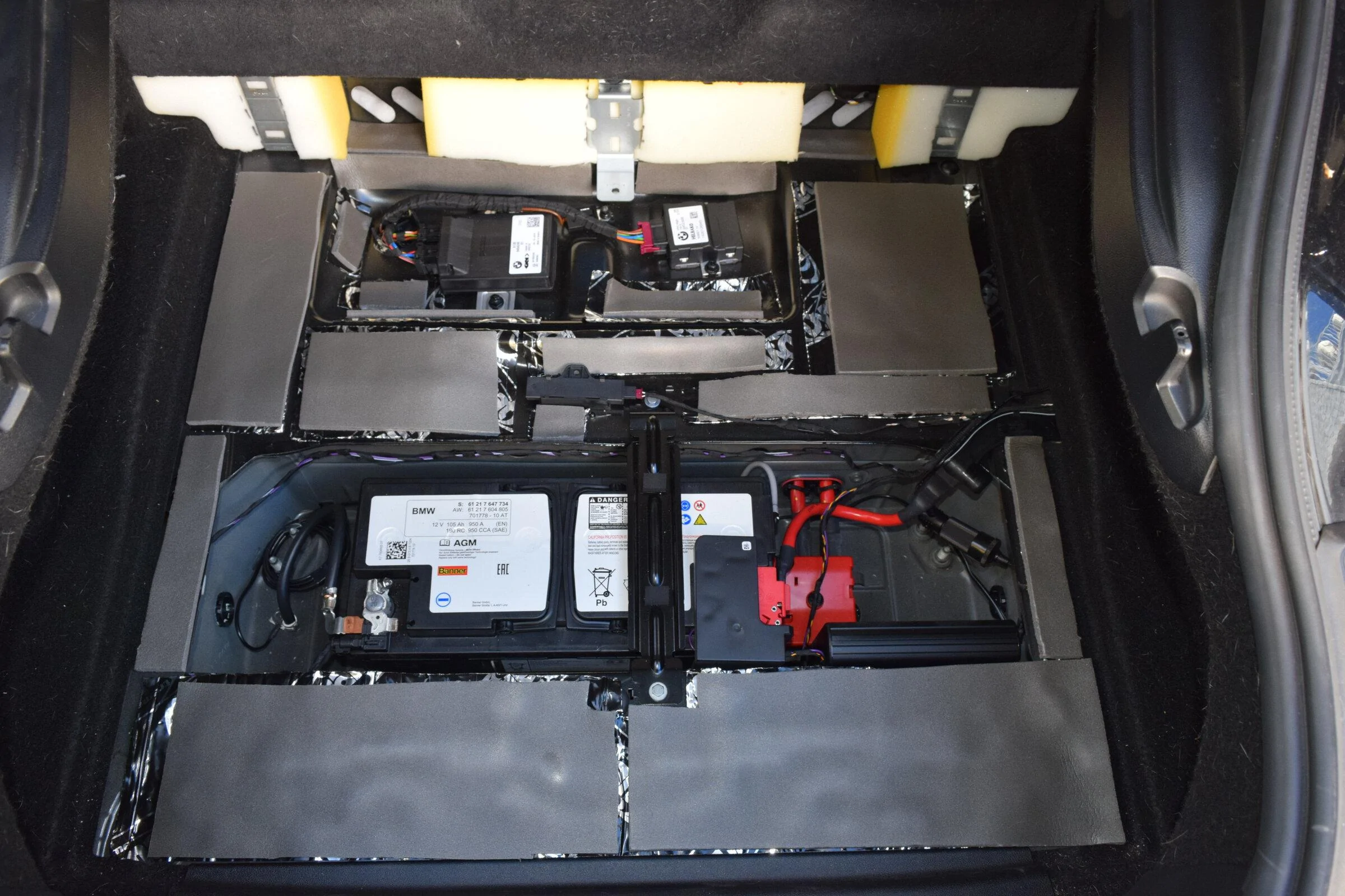

While working on the last post I also got some sound improvement in. I followed @tadda guide on sound improvement for this. I still need to isolate a few of my own vibrations that remain, but wow did this make a huge difference in sound quality! Really appreciate the great guide.
I was pretty careful but still managed to make the two enclosure ports slightly offset, but its not too noticeable so I wont drive myself crazy about it... Skipped the mesh over the exhaust ports but I think I will go back and add them since I can see the wadding inside the box now and I would prefer a black grill there.
So much air leaves the exhaust ports that I cannot believe these were covered up by a panel before. I have to say again, this really improved the sound quality in the car (to my ears at least).

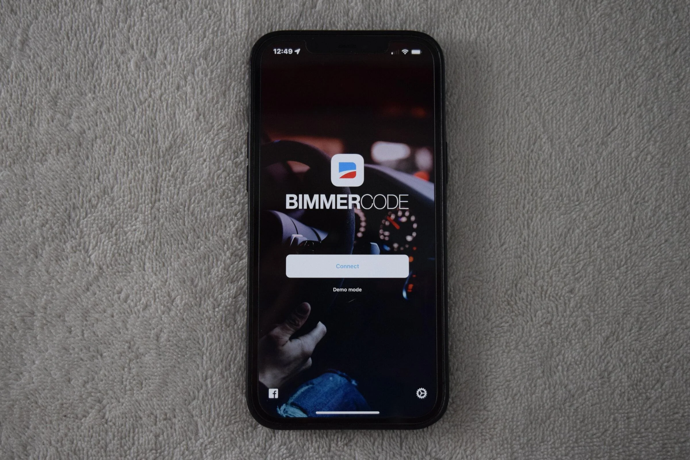

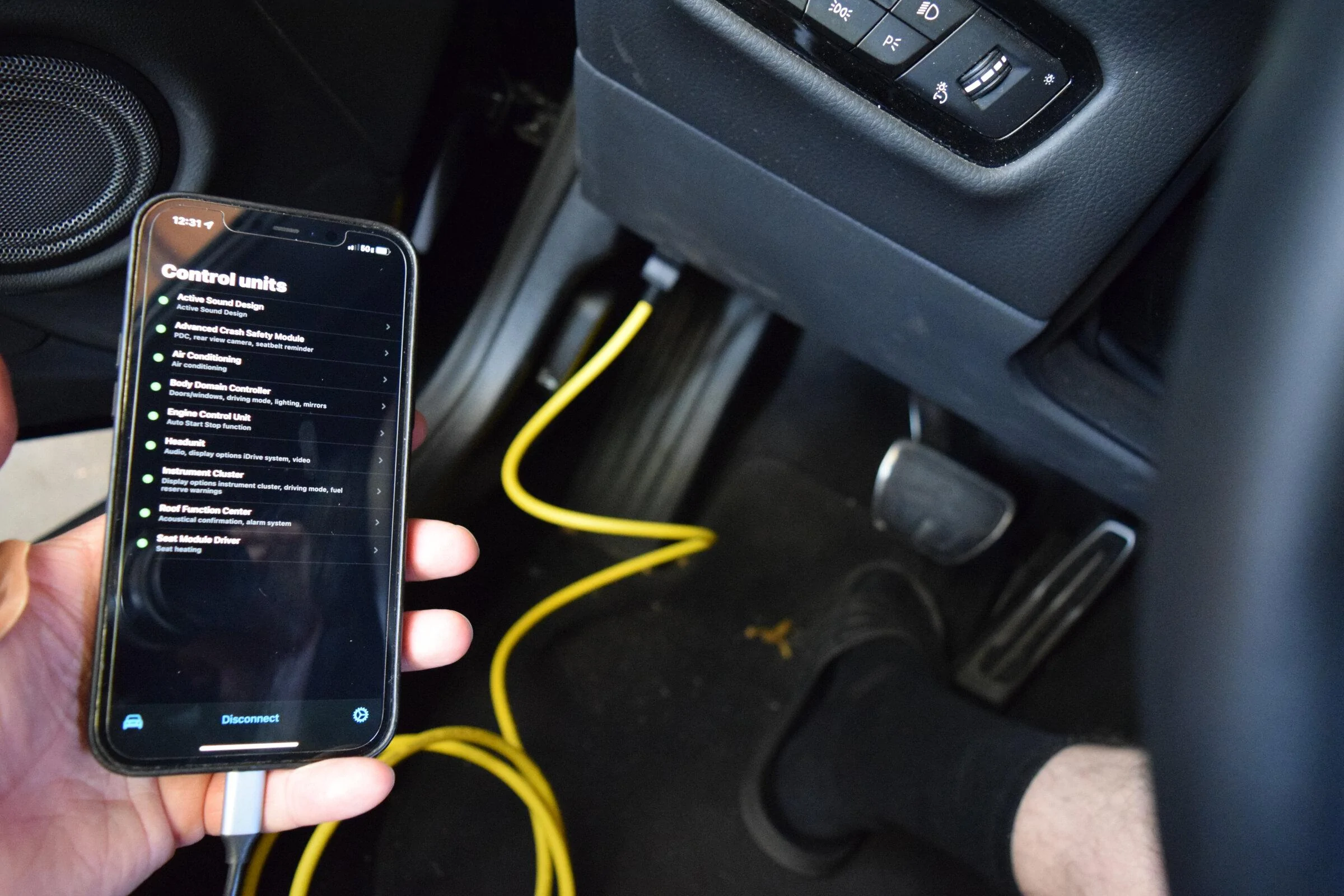

Also used the BimmerCode to change a few other settings around but nothing really worth noting.
(Ignore the mess again, the dog hair is impossible to remove...)
