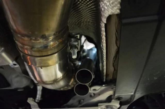

Just confirming in the 2nd photo, the two pipes beside the downpipe are the wastegates for the blowoff valves for the turbos?
I am guessing it is not going to work with the stock ecu?
"True 4" downpipe" means not compatible with stock exhaust? The 2nd picture looks like the stock clamp...

The turbo is twin scroll which is why 2 wastegates are being used to properly control boost. The two tubes are the exhaust from the wastegates. In the picture wastegate exhaust is being dumped to atmosphere vs. being plumbed back into the downpipe.
The advantage of open dump is that the wastegates tend to be able to regulate boost better at higher power levels since the gate isn't competing with the exhaust flow out of the turbine housing.The downside is that the setup can be annoyingly loud which will attract unwanted attention; especially if you live in a city.
The setup only has a single blow off valve which you can see on the charge pipe at the right side of the picture. It vents boost to atmosphere between shifts (when the throttle closes and the intake manifold develops vacuum) to prevent damage to the turbocharger. The better/more efficient setups plumbs the vented boost back into the intake so that the energy isn't wasted. This setup doesn't do that though. It will produce that loud PSSSSSSHHH sound which is what most people seem to want.
Ahh... that makes sense, dump pipes are for wastegates. The BOV is "hidden" under the charge pipe in the engine bay photo.
