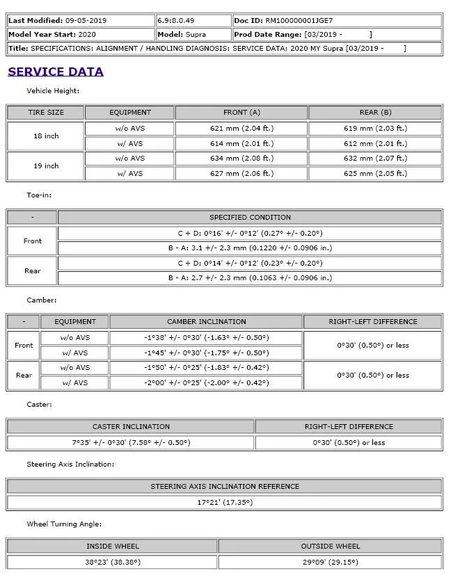

Taken from Supra Shop Manual...
tadda Well-Known Member First Name Tom Joined Dec 14, 2019 Threads 24 Messages 1,251 Reaction score 2,158 Location Arizona Car(s) 2023 C8 Corvette Z51 2LT Coupe Vehicle Showcase 1 Jun 4, 2020 Thread starter #1 Taken from Supra Shop Manual... Sponsored
XtremeMaC Well-Known Member Joined Aug 8, 2018 Threads 41 Messages 2,958 Reaction score 3,208 Location _________ SE Michigan, USA Car(s) 2020 Supra Jun 4, 2020 #2 Awesome info! What are the values in the parenthesis? also C & D? gotta renew TIS membership at some point..

OP OP tadda Well-Known Member First Name Tom Joined Dec 14, 2019 Threads 24 Messages 1,251 Reaction score 2,158 Location Arizona Car(s) 2023 C8 Corvette Z51 2LT Coupe Vehicle Showcase 1 Jun 4, 2020 Thread starter #3 XtremeMaC said: Awesome info! What are the values in the parenthesis? also C & D? gotta renew TIS membership at some point.. Click to expand... Note in some cases values are shown in inches in parenthesis verses mm In other cases it's single side spec value verses total spec value in parenthesis including tolerances Sponsored Last edited: Jun 4, 2020
