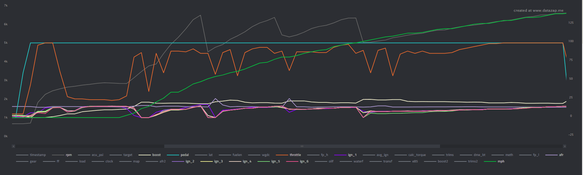

First time out with the car to get some baseline numbers and start figuring out the 60'. Conditions were not ideal ~2000' DA and a gnarly headwind/crosswind but the track was empty and hooking, so can't complain. Goal was 11.5 or better but mostly concerned with getting data and seat time.

First two passes were 1st gear launch, 2nd gear afterwards. Lots of takeaways so looking for 11.0's with a few tweaks and ideally better DA next time out. Next up axles and ECUTEK (early, unencrypted 2021 :thumbsup: ), at least. I'm experiencing some pretty invasive and extremely annoying throttle closure and don't believe that can be solved with out a tune.
(quality is terrible since it was DM'd to me)

Orange is Throttle :nono:

Dragy of the 11.34 run

What’s the unit on the X axis of your graph, time? What’s the scale if it’s time?

X is time, it's "JB4 clock ticks." The JB4 uses a 555 timer. It doesn't correlate to wall time exactly.

Are the throttle closures just shift points?

No. While there are throttle closures at shift points, there are several more. They can be smoothed out a little bit, but these actually don't look all that bad. It never fully closes. JB4 will adapt a little bit over time.

Can you feel the closure like if you hit the rev limiter? Or it’s just computer things happening in the background that are unnoticeable unless you check a log file?

You can feel the throttle closures. While it does do a good job to regulate boost, it's also restricting air into the system. The car will 'fall flat' for a quick second. OPs graph for example might be close enough in time to not notice, but I'd expect a little bit of oscillation from the closures.
The throttle blade is physically closing (well, partially) in the throttle body. You might maintain speed, but you won't accelerate as quickly as you'd like.
