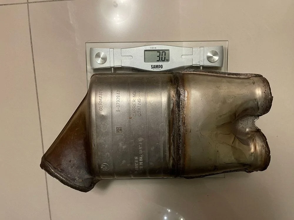

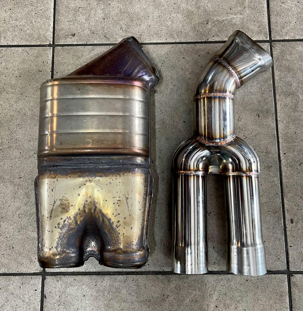

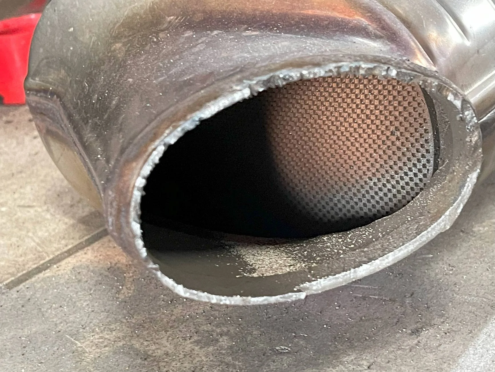

Step 1. Cut the OPF and replace it by OPF delete pipe (Y pipe)
Step 2. Coding with ISTA to turn off OPF detection (somehow the OPF flag affects the pops and bangs)
Then you will get the genuine sounds back:
BTW, you save about 3kg!
