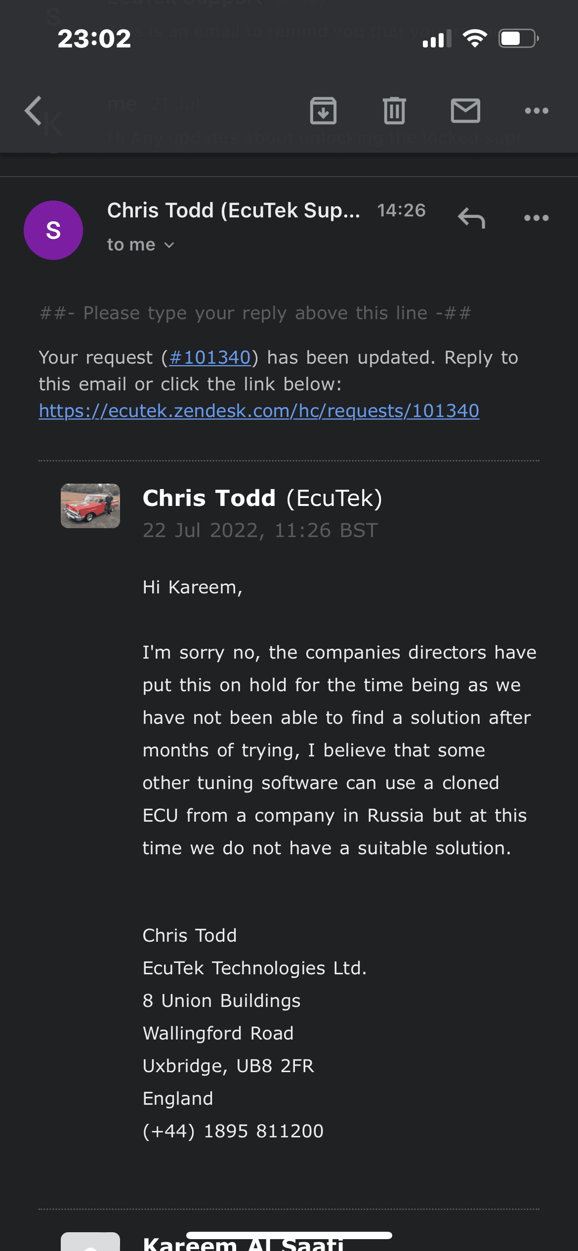

BTW -- any of you know if any tuners are working on cracking the current ECU? Is it "uncrackable" or we just need to sit for a couple of years before someone figures it out?

Regarding your last point, an interesting reply I got from ecutek today. Femto is your only option i guess

Femto is the Russian group (now based in Finland) that is conducting ECU unlocks/clones for guys like us with 2020+ DMEs. They are currently the ONLY company or service doing this.
We have seen rumblings that bFlash will offer this as a similar service as well (without the need for a clone). But they have kept their cards close to their chest. See my thread for more details on bFlash:
https://www.supramkv.com/threads/bf...your-2021-supra-is-finally-almost-here.13412/
There is another group working on their own unlock software product, but @Carl - Driveway Labs is the only person on the forum to see it in person.
