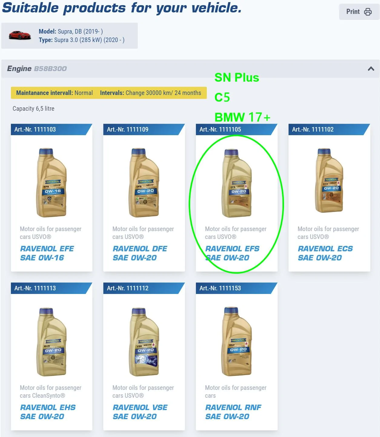

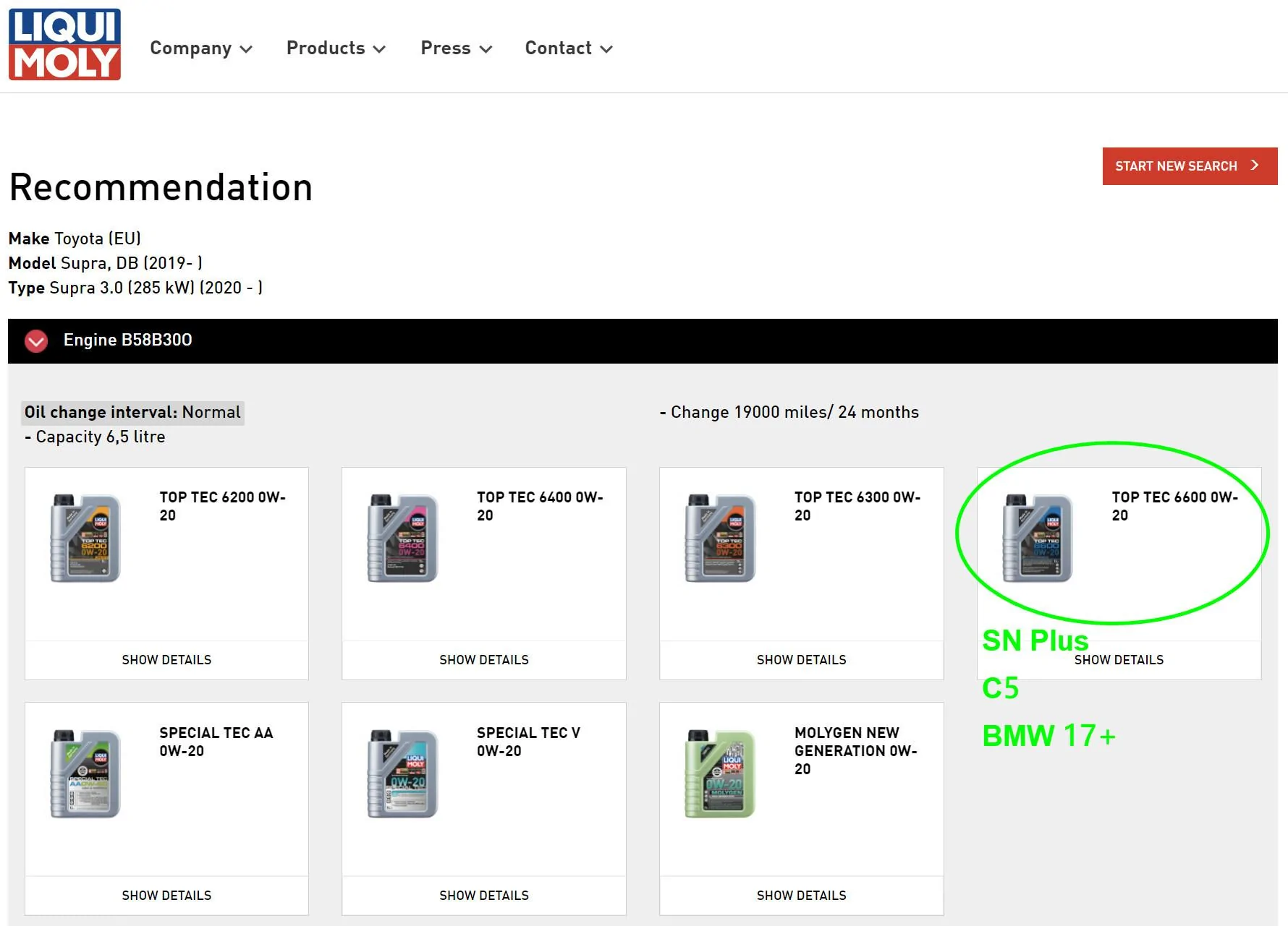

If you like to match the OE GR branding motor oil spec, remember there are just a few products have SN Plus and C5 certifications.
