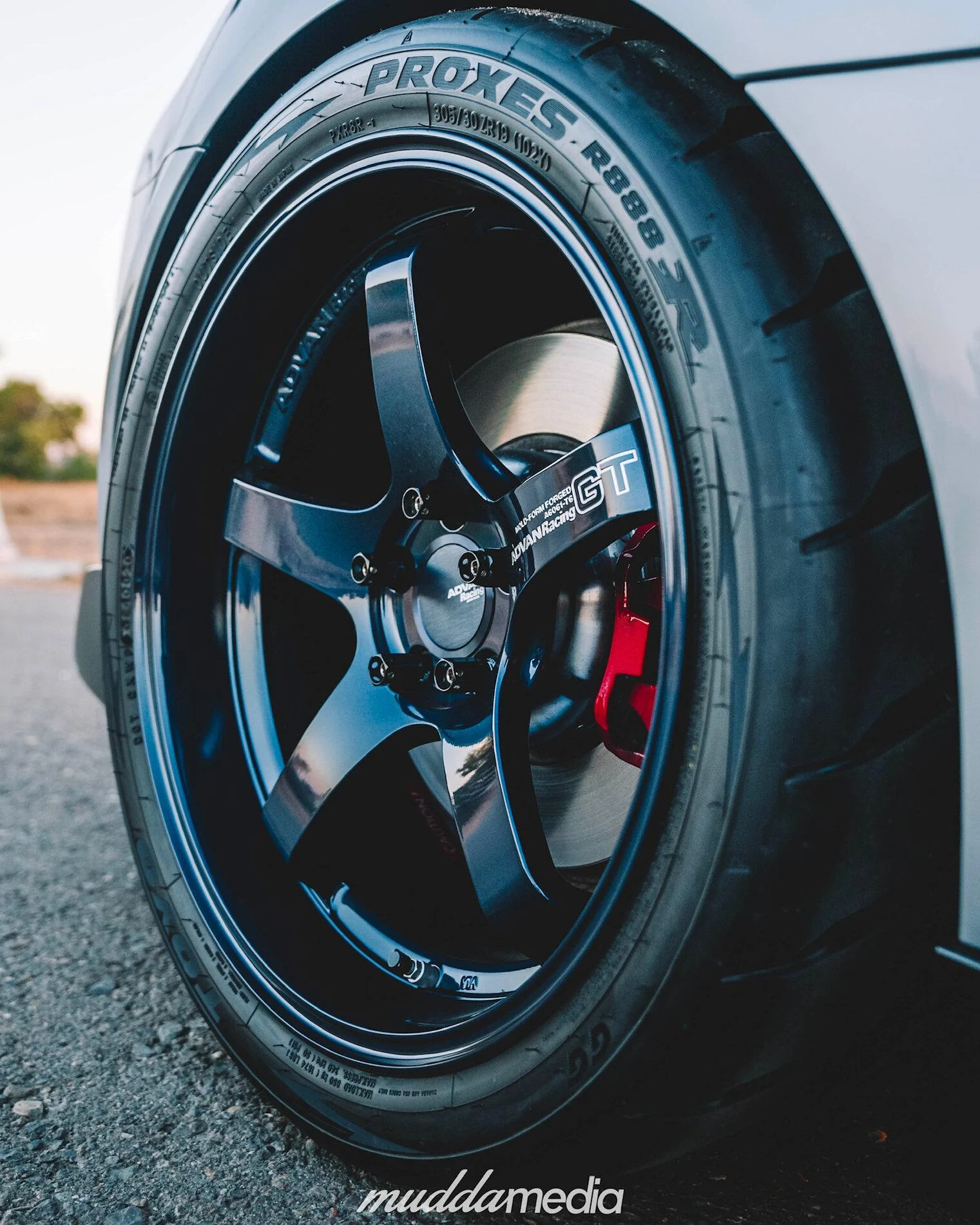

im running 305/30/19 with 19 x 11.0, lowered on H&R springs, no rubbing at all.

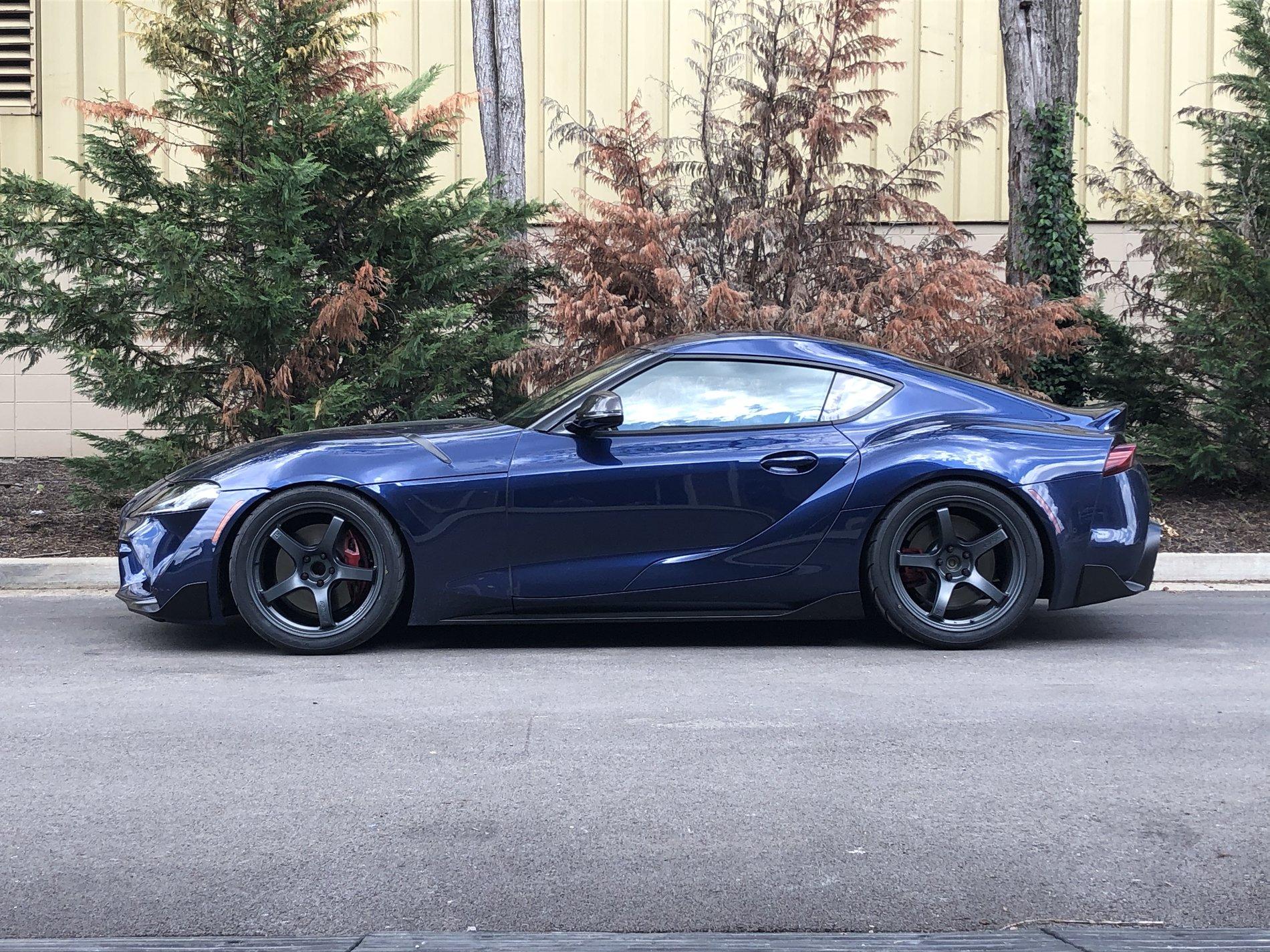

So the r888r 305/30/19 are a perfect fit. No rubbing. It’s actually the 265/35/19 up front that have some minor rubbing. There is a small tab on the fender that the sidewall rubs against when the spring is compressed under load. More negative camber will fix that though. Camber plates on the way!

Can confirm that 305/30/19 Toyo Proxes R888R does not rub whatsoever. Also lowered on Eibach springs.
