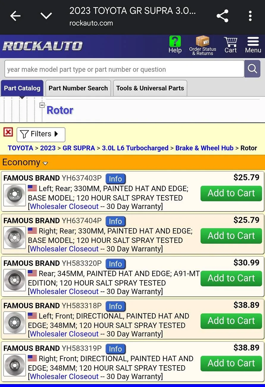

That sounds like a lot to me. The Supra isn’t light, you probably aren’t grandma driving her and might even have decent pads on yours = will go through them quicker. As for mine, I chew through my front rotors about 2.5x faster than my rears, as expected. Track driving with track pads will absolutely eat through rotors (and pads for that matter).
As far as our other lighter cars in town cars, they get about 15k miles or more depending on the pads that are on them. My daughter’s Ford fiesta has about 45k miles on hers. Light car, ceramic pads and driving on flat in town Florida.
So lots of variables brother. Regardless, I buy only the best cheap rotors that are rust prone for my family. LOL, sounds like a sit com and commercial, all at the same time.

What pads are you running? Pretty sure your rotors aren't warping, it's kind of a myth and very rare when they actually do. Normally it is pad deposits. Do you know what the actual measure width or your rotors are when they state to you they need to be replaced?
As far as rotors, I can purchase eight pairs of rotors for the price of one pair of Girodiscs, so I just do that. Much better price/performance ratio.
