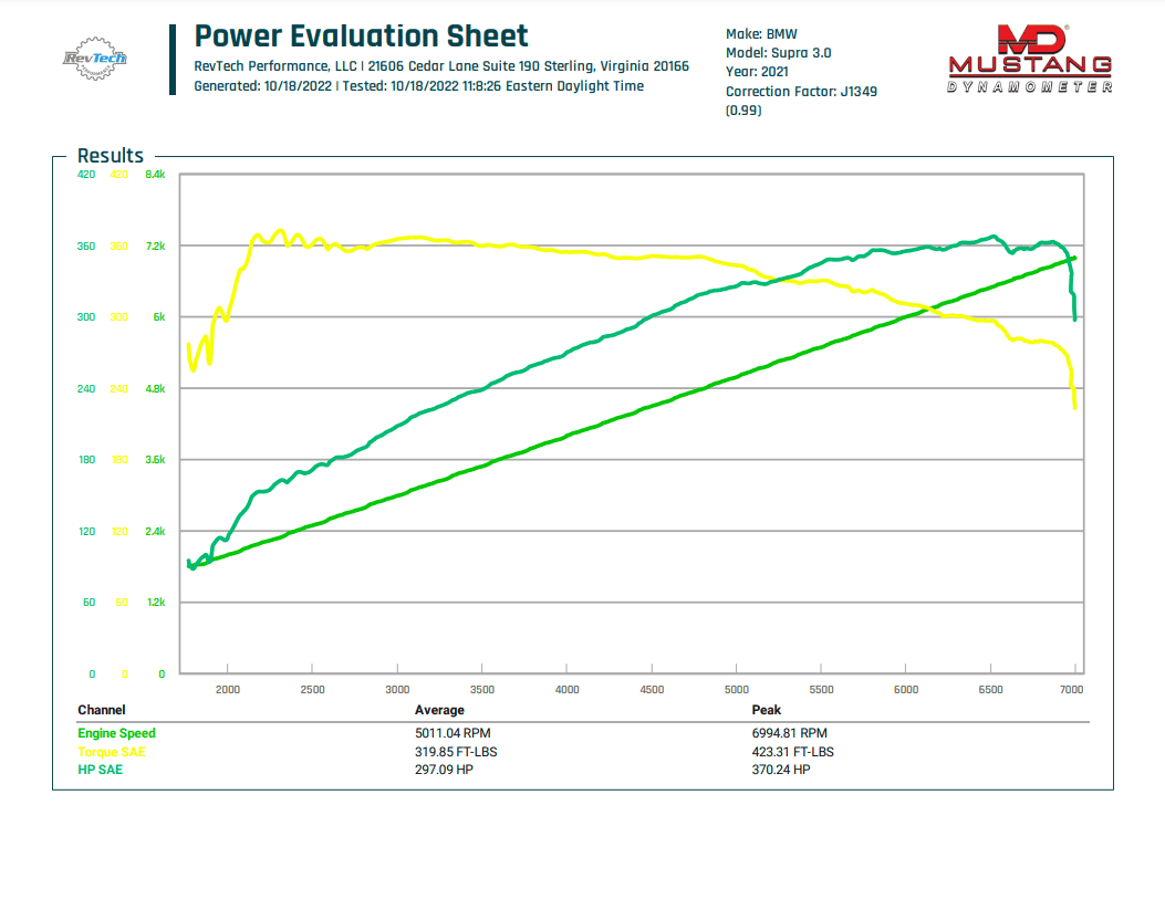

Picked up the car on Tuesday last week and I want to put some mods on but properly document everything this time. Other owners please share your results! It would be cool to see how everyone is progressing.
Currently has no mods and 300 miles.

Did they really plot engine speed vs engine speed, and it's somehow not a perfectly straight line? And why does the header say it's a 2021 if it's an MT?
370 on a Mustang seems reasonable though.

Seems like pretty high numbers for being stock on a mustang dyno. I'd bet it would be over 400whp on a dynojet.
Don't play that game. I'm going to assume that MD is setup to read like a dynojet as that is high for a "normal" MD.
Note that the torque plotted is different than the peak numbers listed below. Plotted it isn't anywhere close to 420wtq.
Also, whoever chose to have TQ plotted in yellow on white is making bad life decisions.
Also, whoever chose to have HP plotted in yellow on white is making bad life decisions.
It makes sense to me. I'd expect a manual to read a little higher than the automatic and the automatics already dyno at like ~390whp stock on a dynojet.
Not too sure about the engine speed plot either but it looks straight enough to me. Maybe it's just a smoothing thing in software.
As for the 2021, My old car was a 2021 Supra 2.0 so they must have just not updated the entry.

Dynojet, please

Dynojet, please
Sure Iā€™ll try to schedule a session tomorrow. Found a shop that has one but itā€™s much farther from me than this one. Is dynojet the golden standard?

I was being halfway facetious but by all means please put it on a DJ if you can! A Mustang Dyno is an excellent tuning tool but impossible for true comparison's sake. Barring any wacky weather correction factor and/or significant elevation differences, Dynojet are all very very consistent dyno to dyno.
