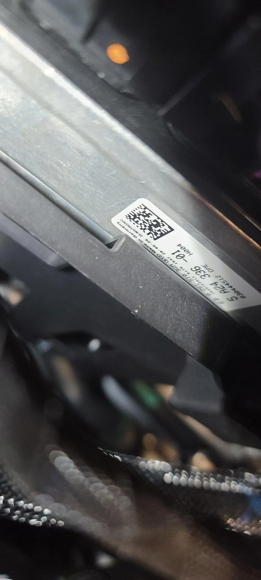

Most probably locked. Every ECU ive had after 6/10/2020 could not be unlocked.
My ecu date is 6/6/2020. I need to have it checked out some day and see if it is able to be unlocked. It's so close to the 10th of June that it may be able to narrow down the dates for tuners even further.
