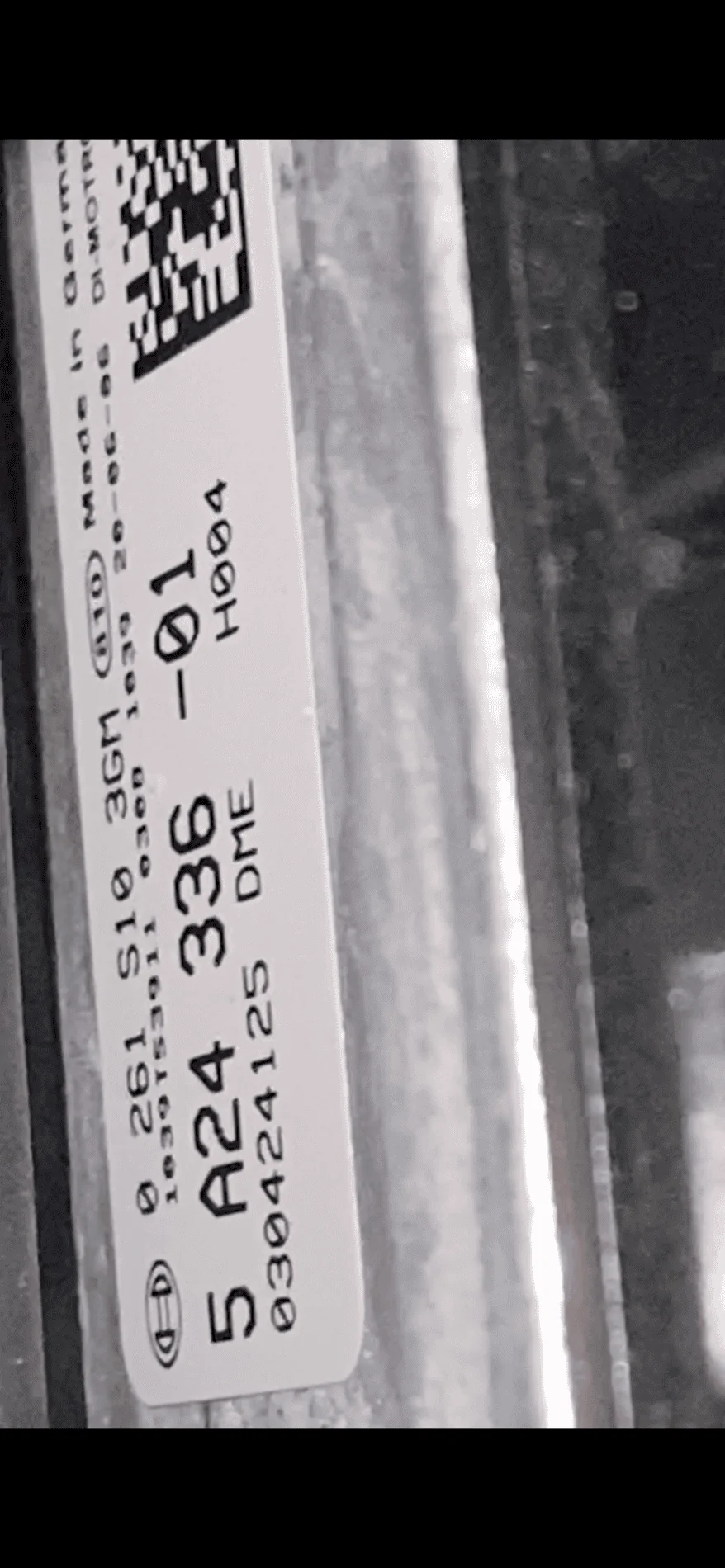

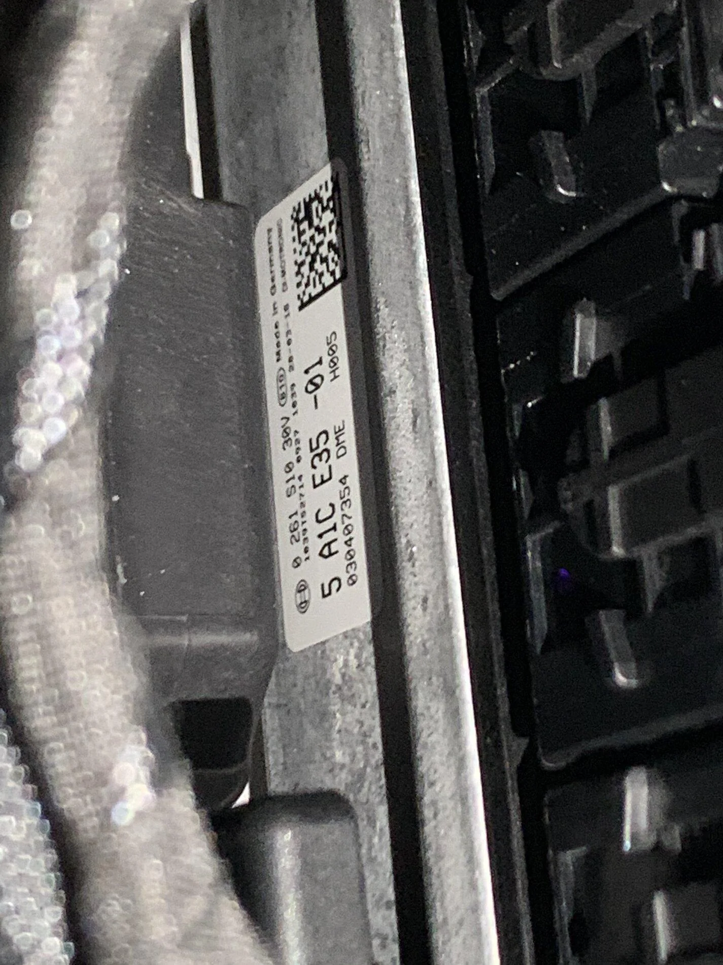

looks like it can be unlocked right??
I believe that looks like 3/16/20? If so, yep! You're good to go!

No such thing as an A91 LE. 21 Supras can be unlocked after a bench unlock. The A91 special editions cannot, yet...
This isnt all correct information.
Correct ... no such thing as an A91 LE. You have an A90 thats a LE and an A91 Edition .... 2 different things.
Incorrect ... A91's can be tuned depending on the ECU date. We've tuned multiple A91s that had an ECU date in May.
