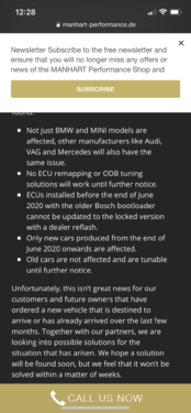

IIRC this effects all Bosch ECUs, built after start June 2020 not just the Supra ECU
this is likely. Im just not sure if toyota added layers of encryption or not.
if its all bosch ecu’s, thats good. Economy of scale is our friend
