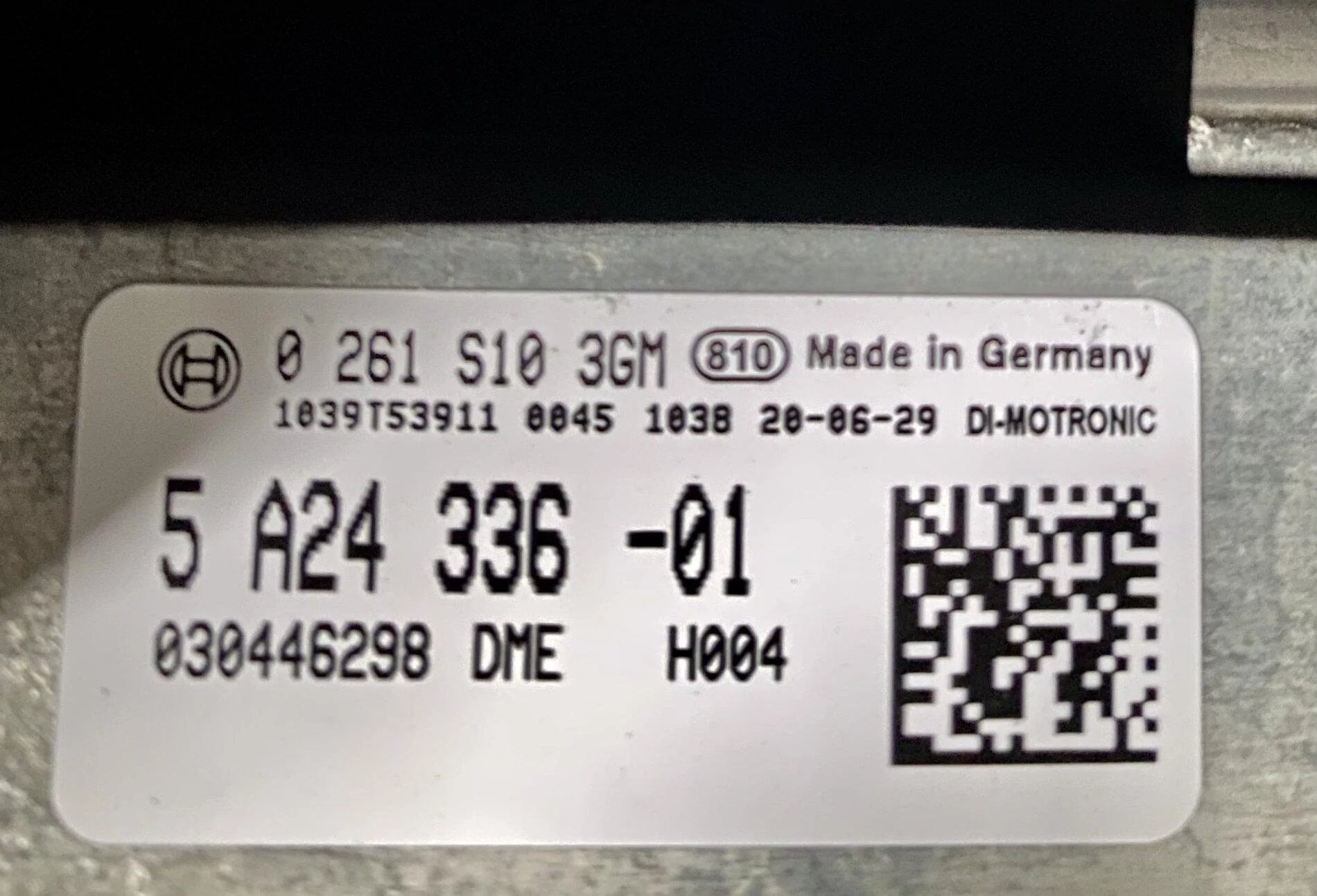

My apologies if this is clearly articulated here, but over the almost 50 pages of posts, Iā€™m not quite sure. What is the cutoff date for the ECU (not build date of the car) for tunable or not? I have a July build and a 6-27-2020 ECU.
~ Yours is locked. The ecu would need to be stamped 5/20 or earlier.
You missed the cutoff by 27 days. The second option you have is a JB4 piggy back system.

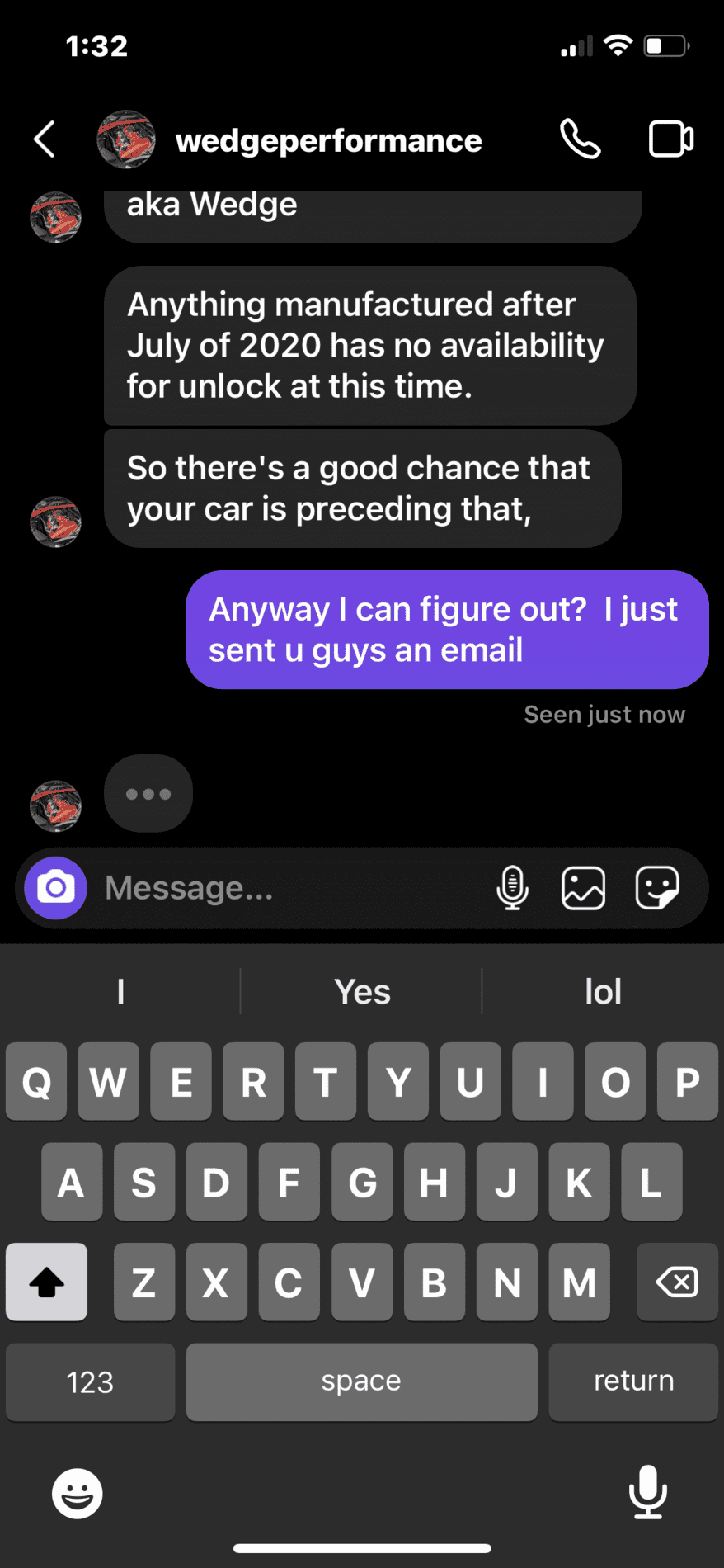

Might be a glimmer of light for A91 & Recent 2021 Supra owners.
About 6:35 into the video - seems like it could be tuned.
ECU build date cutoff still applies 05/31/2020. The DME unlock is required first for a certain range of tunable cars. The first 2020 Supras came with DME unlocked from the factory.
