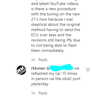

So, to refresh on this, as of right now, post 6/20 ECUs (not just for the A90 but any car using the Bosch MG1 ECU, including G8x, G20, etc.) cannot be unlocked but they can be flashed by a Russia-based tuner, Femto? And any other tuner offering a "solution" is likely working with Femto to put their tune on the ECU on a kind of one-time basis? Do I have that right?

I believe once it's unlocked they can reflash as many times as they want to. Here is a reply from RKTunes on IG:
From talking with Femto, it’s an OBD unlock but it only works with their proprietary tuning solution. DME must be sent to them for bench unlock still.
