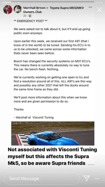

2021 Supra Issue with MG1 ECU Tune
I recently came across this article posted by "JACKIEJDING" He Participates in races (Supra 2020) The issue with 2021 Supra is there is no wayto Tune this 2021 Supra. Bosch has Changed the Security system.

I believe the genius tuners will find the way to crack it soon, the market of B48/B58 engines is too big.
