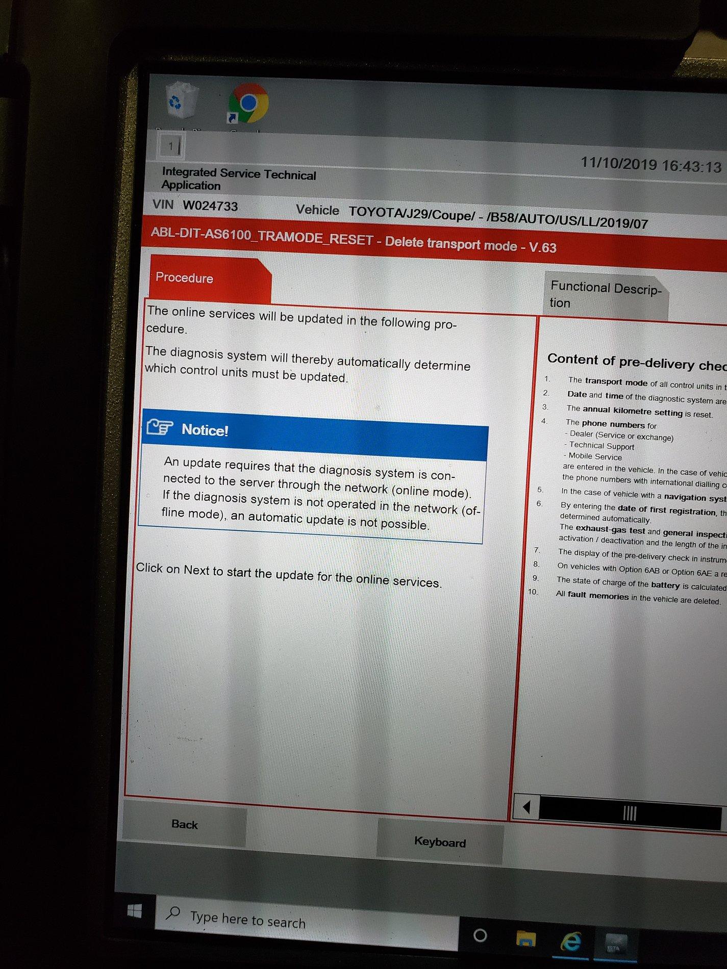

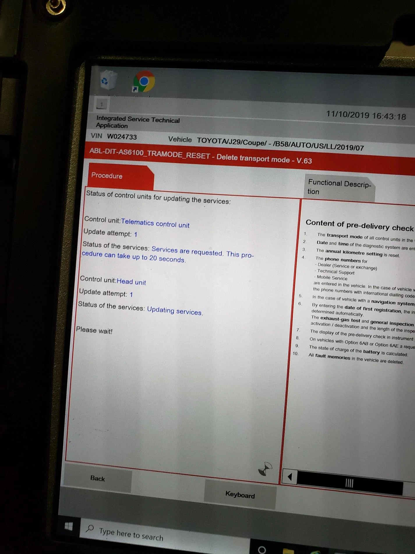

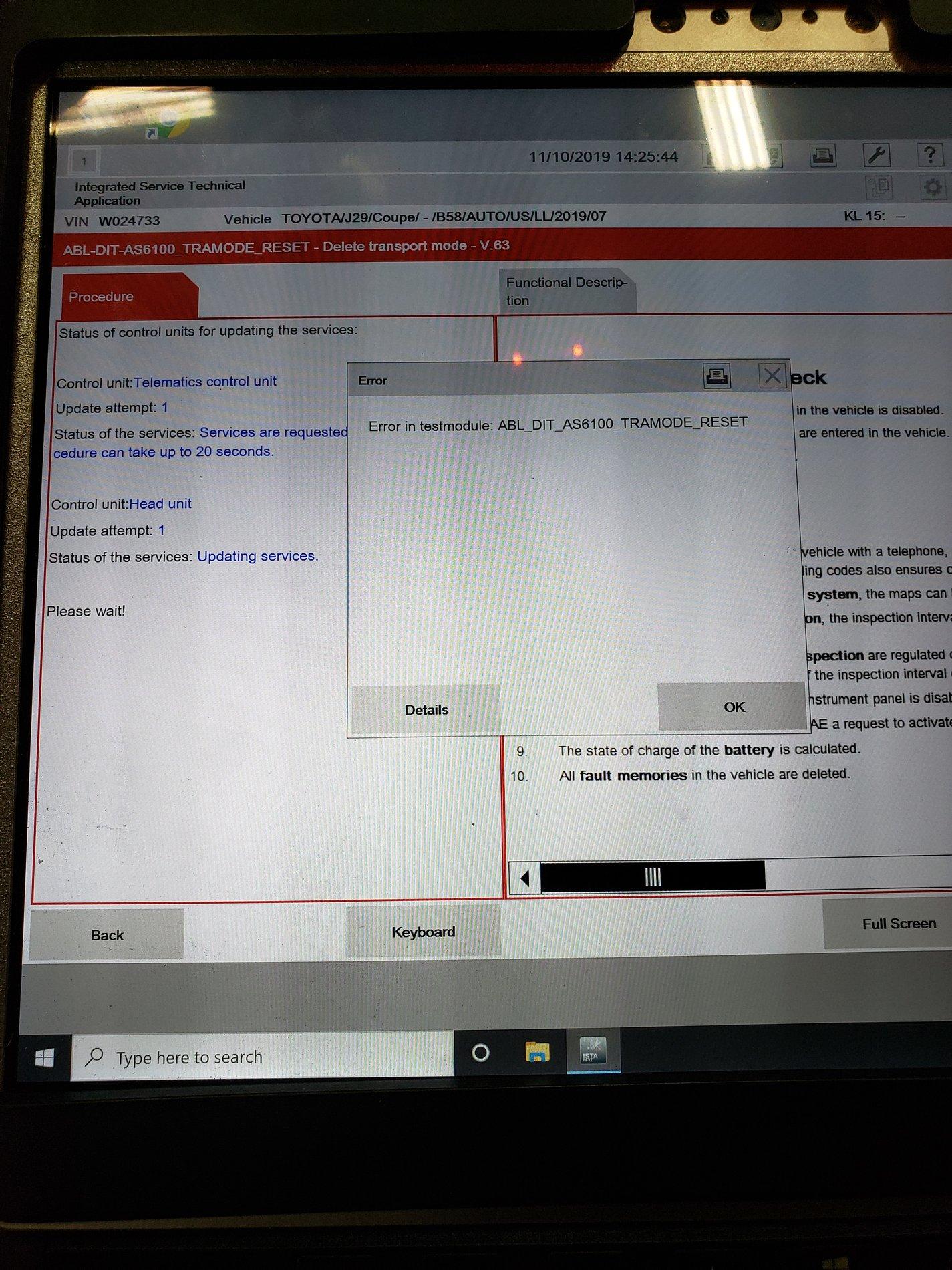

    Hello, this is for all supra technicians at any Toyota dealers out there, I've done several PDI's on supra's now and this is the first time running into this situation. I'm doing the deletion of transport mode which was fine...to an extent I guess. But whenever I go to the step for Telematics control unit, it gives me an error code "Error in testmodule: ABL_DIT_AS6100_TRAMODE_RESET". If I try to bypass it, it will then prompt me later on to do the steering wheel initialization which fails each times because it times out. I know I'm doing it right, it's just THIS one that seems to be real stubborn.. I've already made cases and spoke to engineers but were all pretty much stumped at this point. I disconnected the battery and will try again tomorrow.. any help would be greatly appreciated. NOTE: yes my ISTA is the LATEST update.

    Vehicle completed and fixed, had to do manually through ABL for steering and disconnected battery to do a hard reset. Admin/Moderator can close this thread. Thank you.
