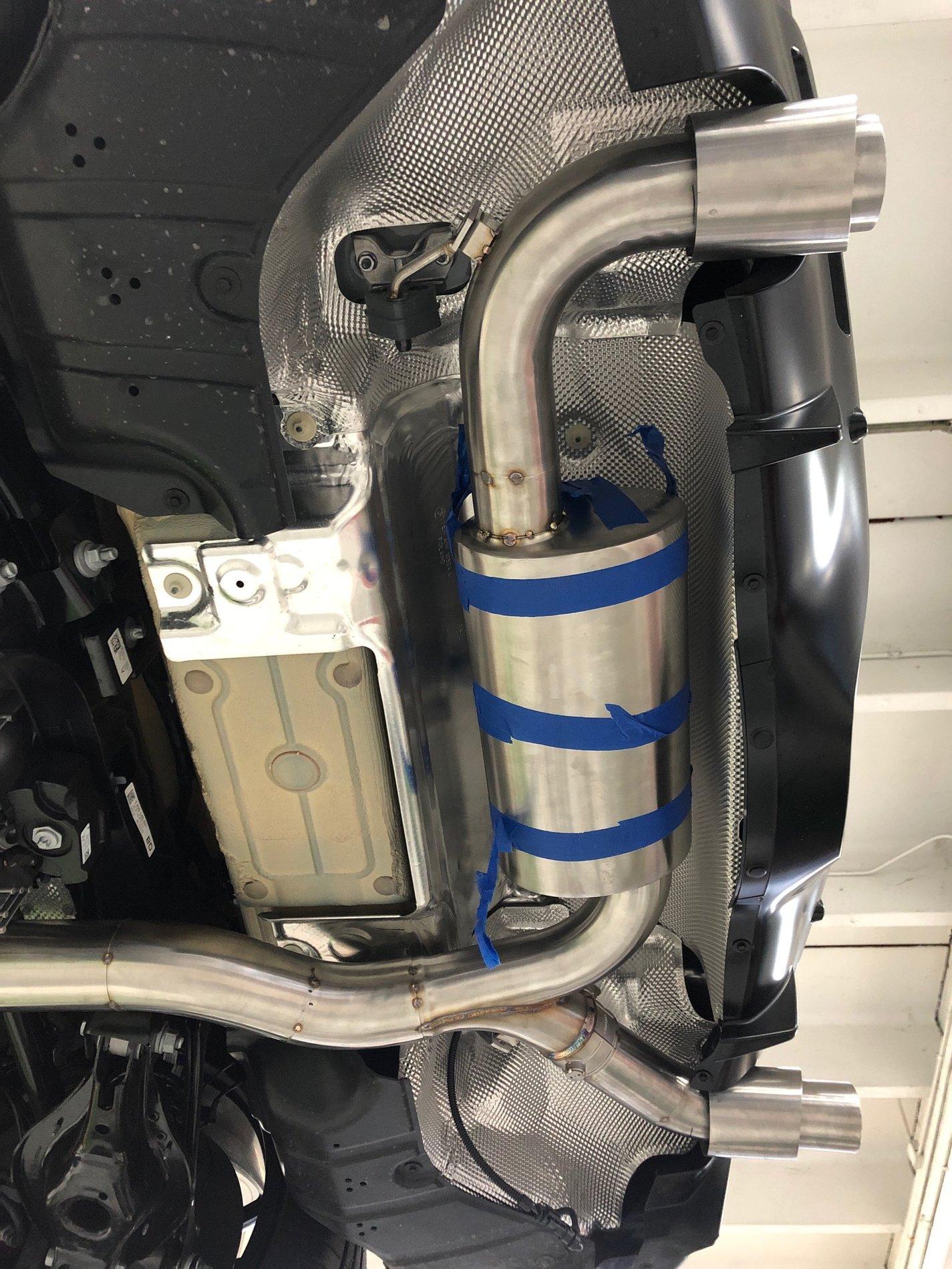

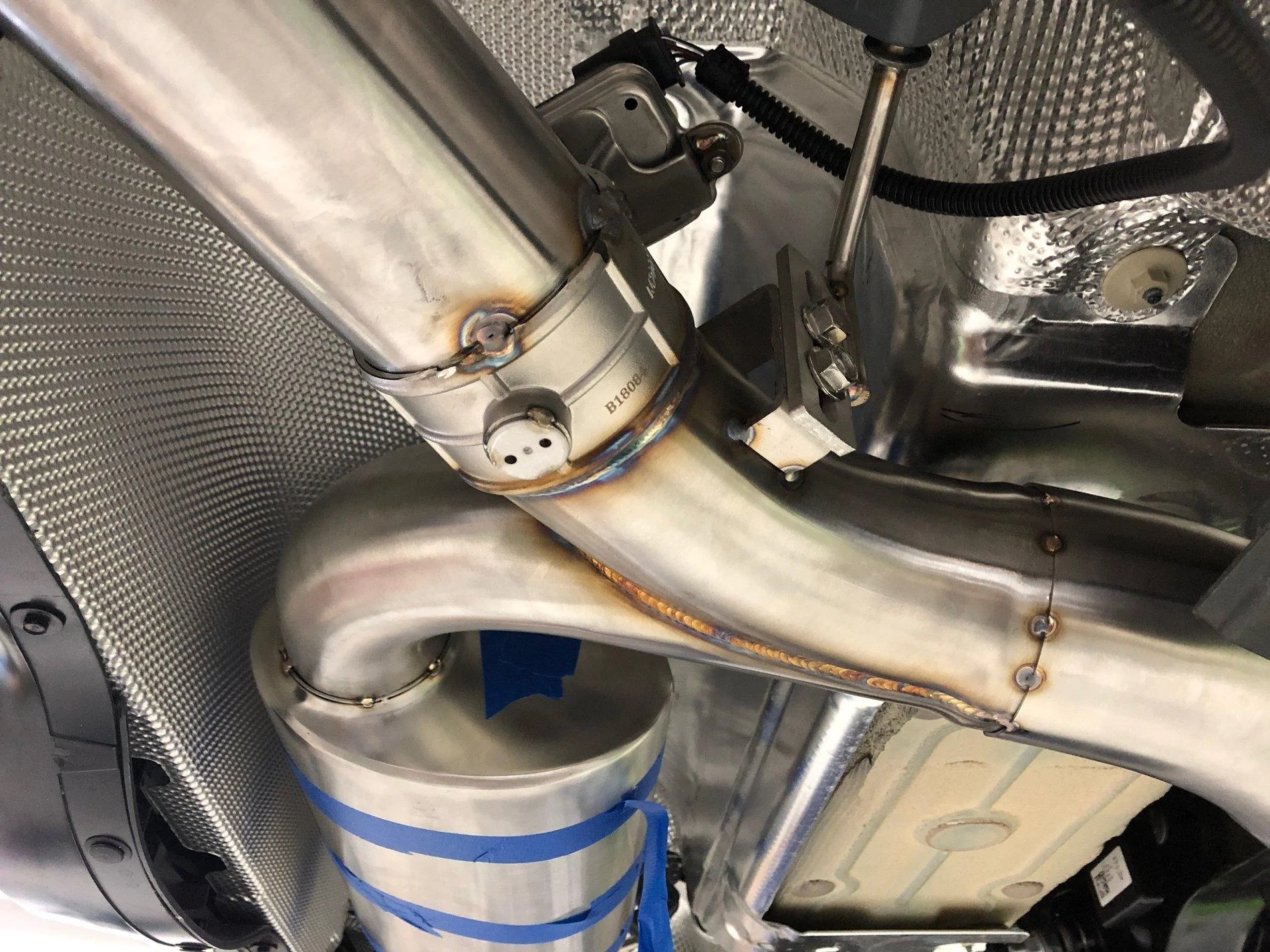

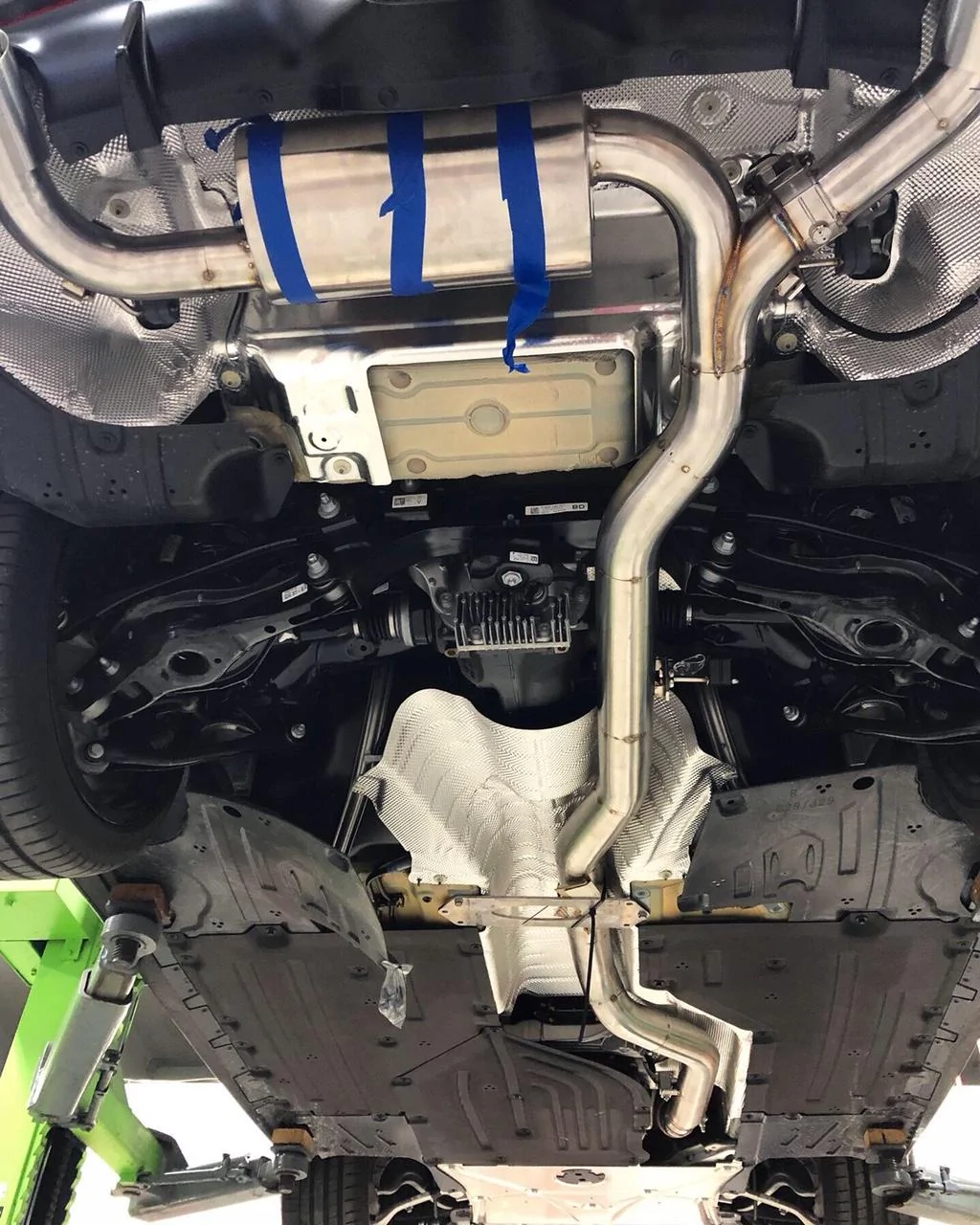

We've had our exhaust system completed and installed on the car for about a week now. It retains the stock valve motor so that comfort and sport modes have different exhaust notes. We used a true 3.5" diameter pipe from the downpipe back to the Y.

Looks and sounds brilliant. How's the ground clearance with the 3.5"?
Looking good, pricing and availability?
Thanks! The clearance is fine with the 3.5", it's a touch lower than stock up by the transmission, but at every other point it's not the lowest part of hte vehicle.
I'm aiming to price it around the $2k mark. They will all be hand made here in Miami using TIG welded 304 stainless, mandrel bends, etc.. Since this was made on the car it's all one piece at the moment. We're going to section it for easier shipping and assembly. The valve assembly is casted aluminum and since we have experience with these from our BMW market, we've already gone through the R&D of dialing the valve in to eliminate any rattles while still allowing smooth operation.
