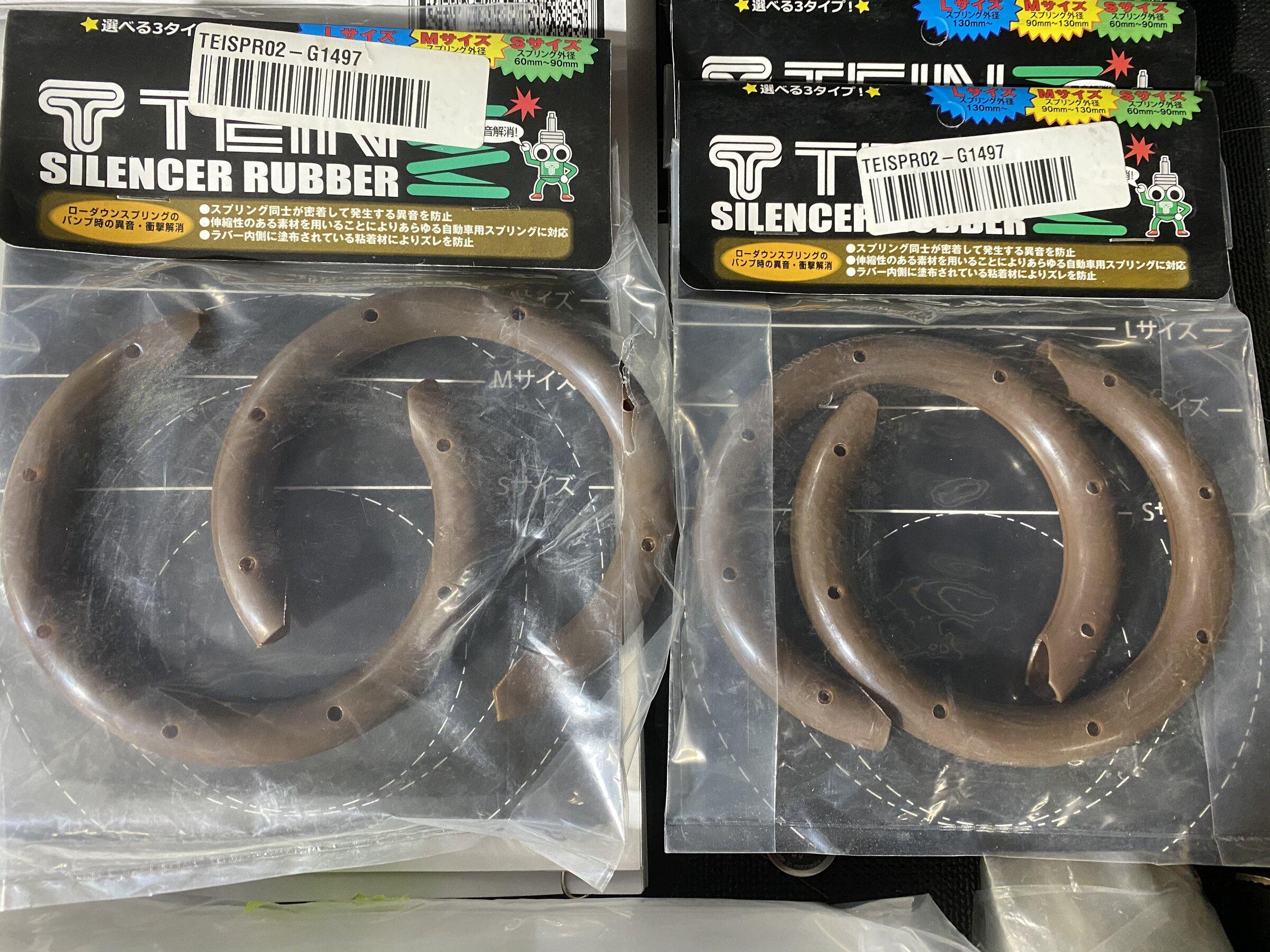

Here’s the ones I used for the rears. Which is the area you’ll get the most clunking from.
Tein (SPR02-G1497) Spring Silencer, Medium 90-130mm
