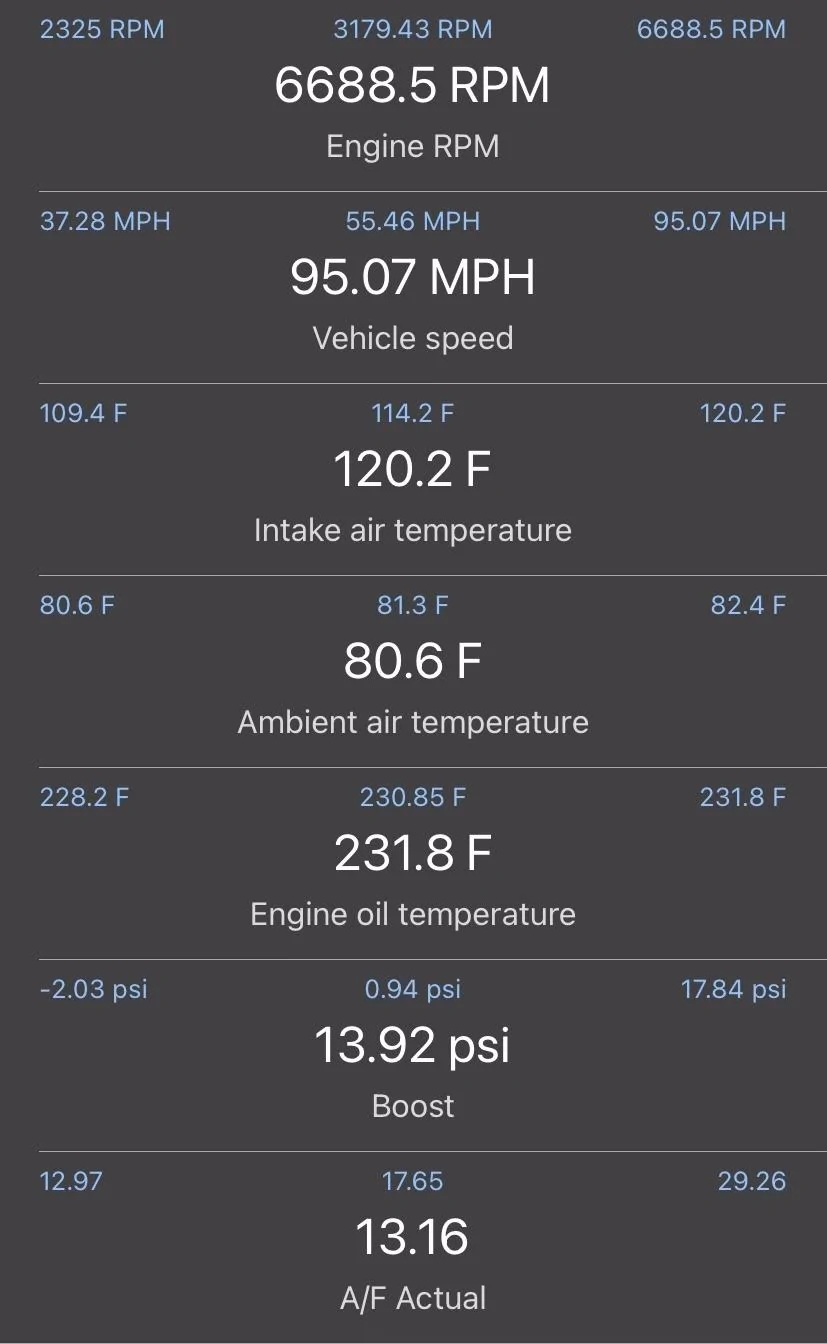

I am currently running titan motorsports protune and curious if anyone has logged AFR on the different maps? I understand stock is 14.6ish but am seeing anywhere from 12.9-14.6 at WOT given whatever map setting I am (downpipe plus bolt ons 93 vs 100 octane). Do the JB4 and Titan protune piggybacks change target AFR or is 14s still the target? Any JB4 users on e40 reporting richer AFR? I am trying to keep my car healthy and not use to seeing such high numbers lol. Any help would be appreciated!

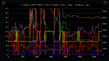

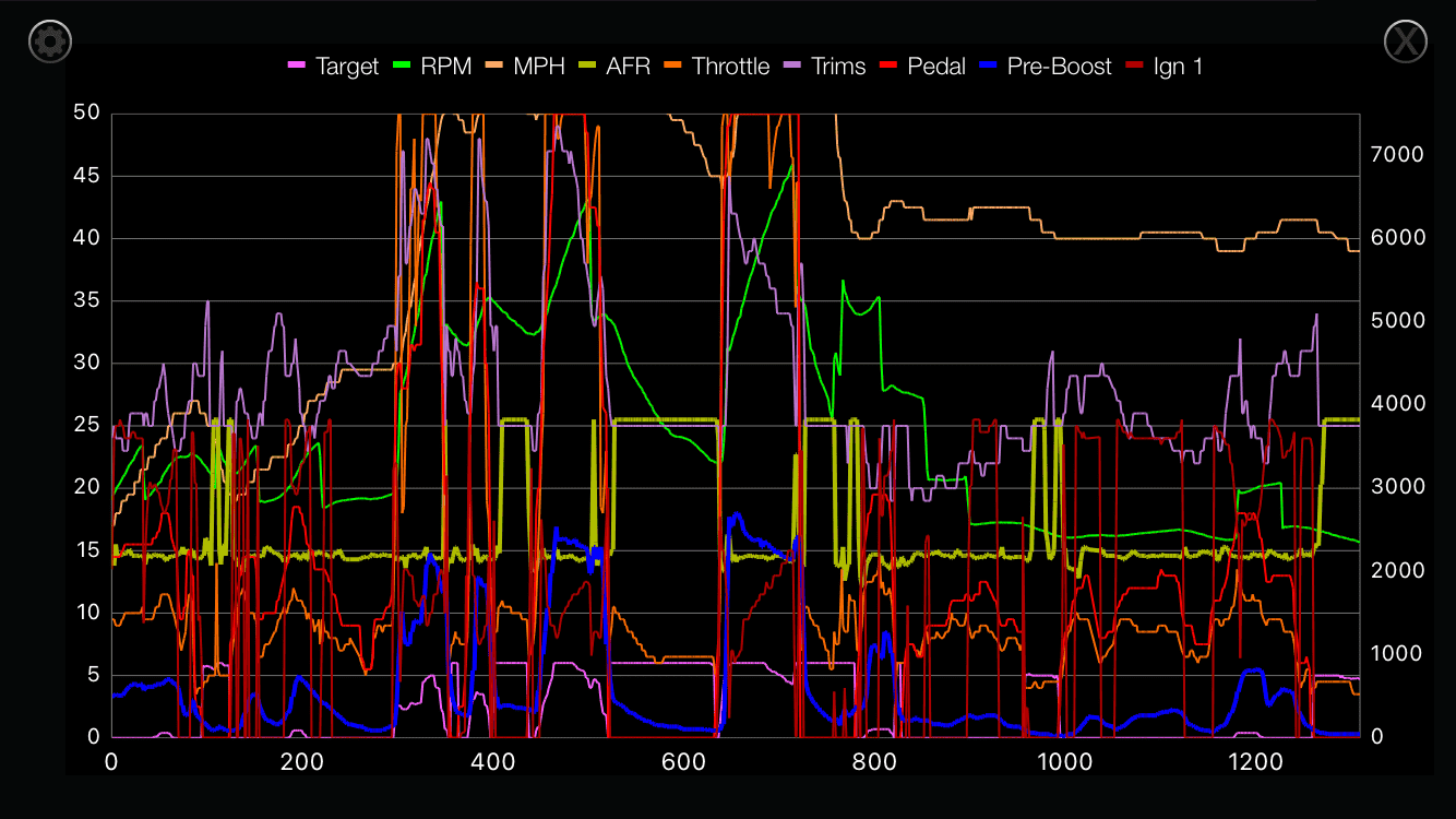

I have the JB4 and notice that my AFR remains at about 14-15 but I see spikes to 25, it then settles back to 14-15
edit: I think itā€™s normalbetween shifts. I think fuel supply cuts off temporarily from each gear
Yes correct itā€™s normal to jump high between shifts or when you let off the gas. Are you on pump or a mix of e?
I have mappings with e30 and pump 93 oct
below is e30 when I was on the highway going from 40 to 136mph repeated
