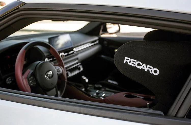

Hey...has anyone upgraded to aftermarket seats yet? I want to install some Recaro SR7's but so far have only found Bride rails online which are still in the pre-production phase and don't really know the first thing about custom seat rail mounting or the implications of removing the stock seats (airbag sensor, etc). I've swapped stock seats for stock seats on an older American car, but I'm sure that's much simpler than trying to do this. I'm aware the stock seats are pretty nice but looking to save little weight and they'll look nice.

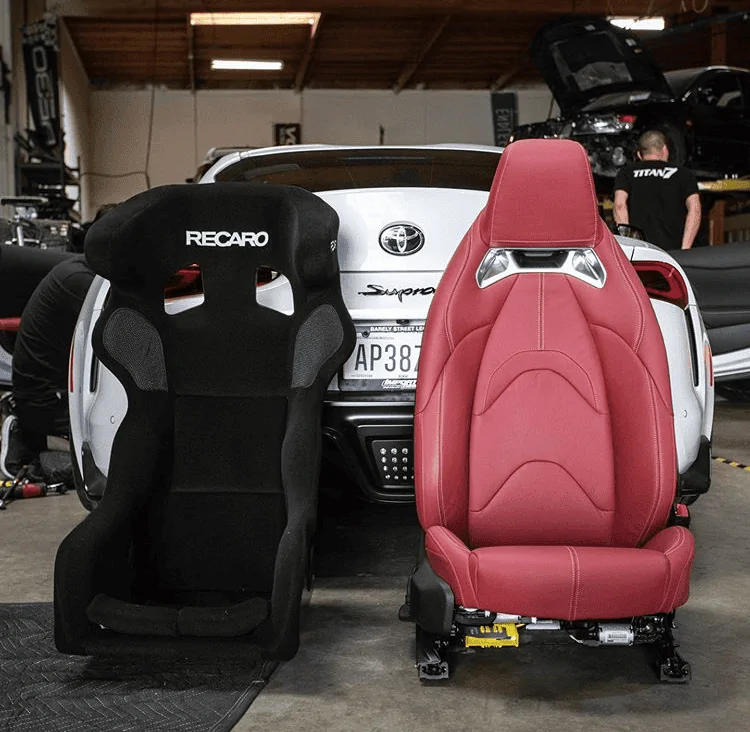

Anyone else feel like the red LE seats aren't ''red enough''? They look like a softer pastel lipstick type red, maybe something more vibrant could be an eyesore over time but for comparison here's the red LE seats compared with the Recaros I was planning to swap in:

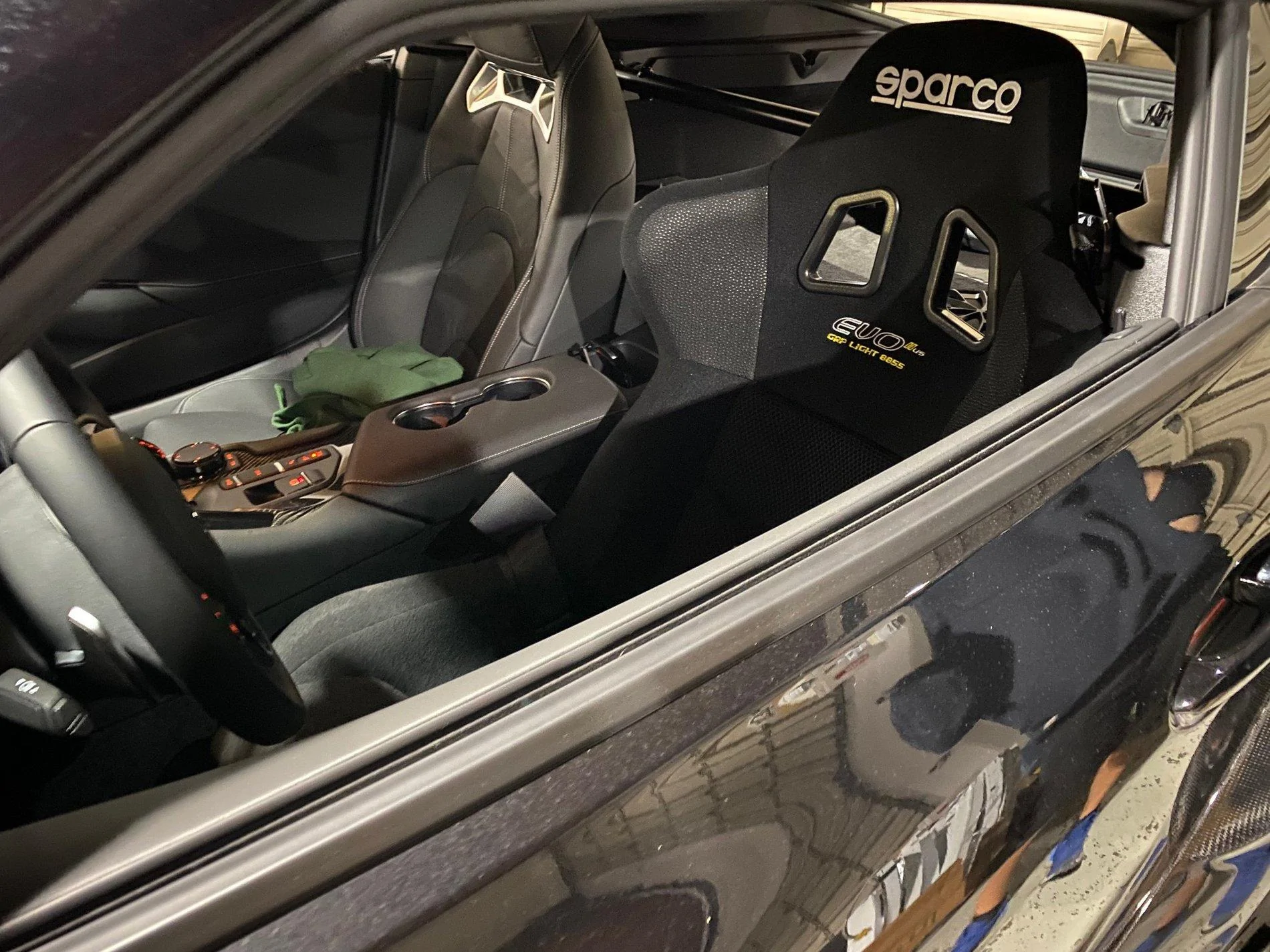

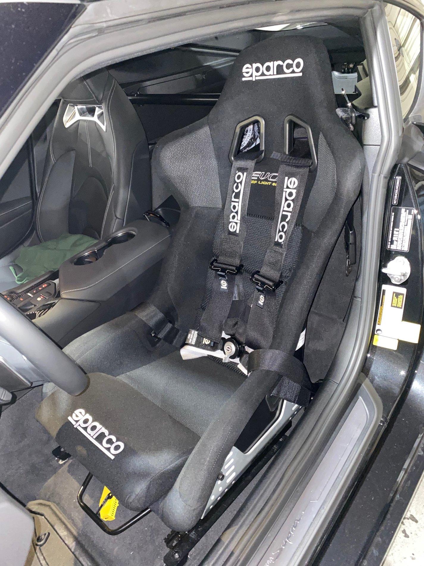

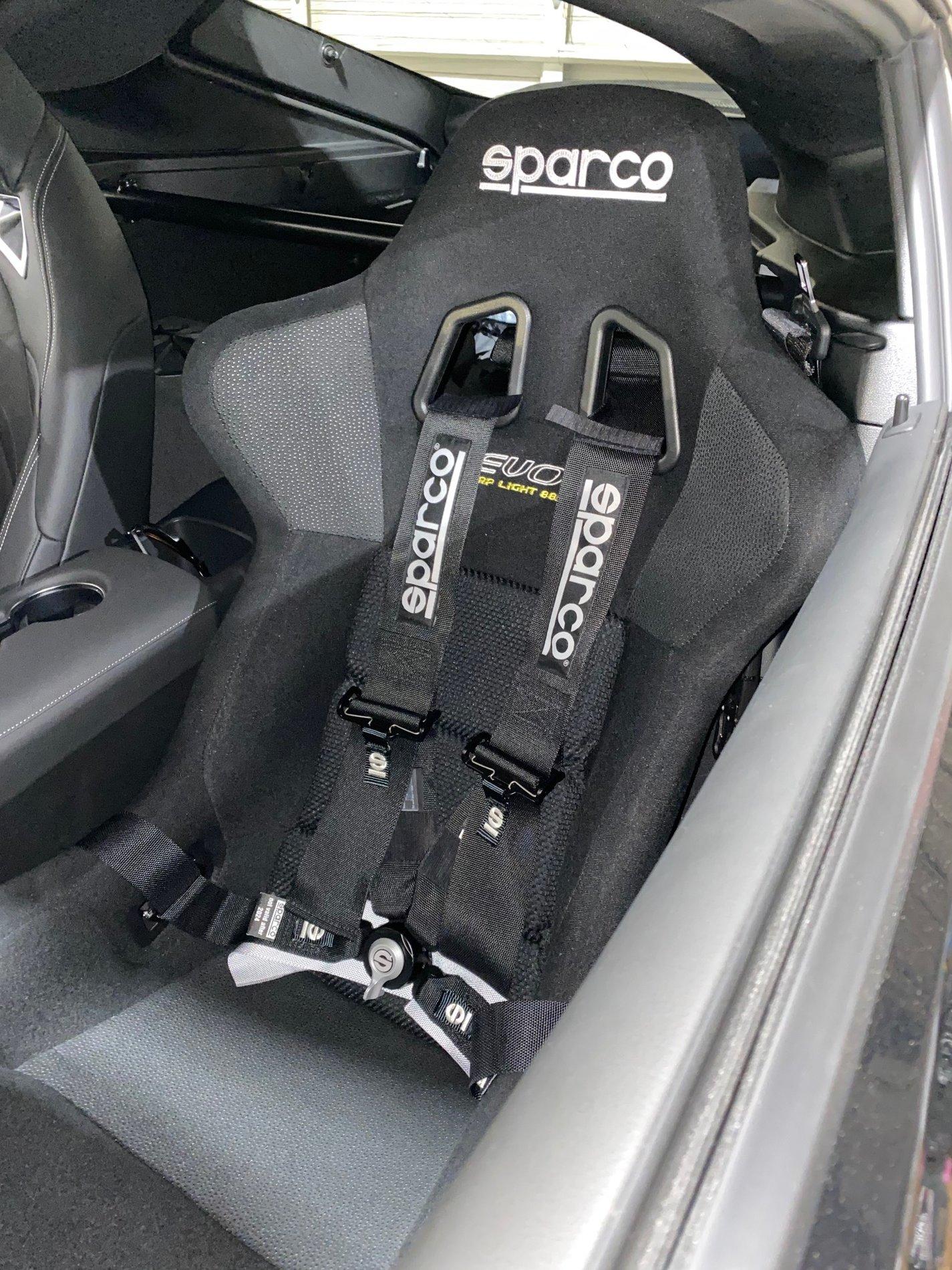

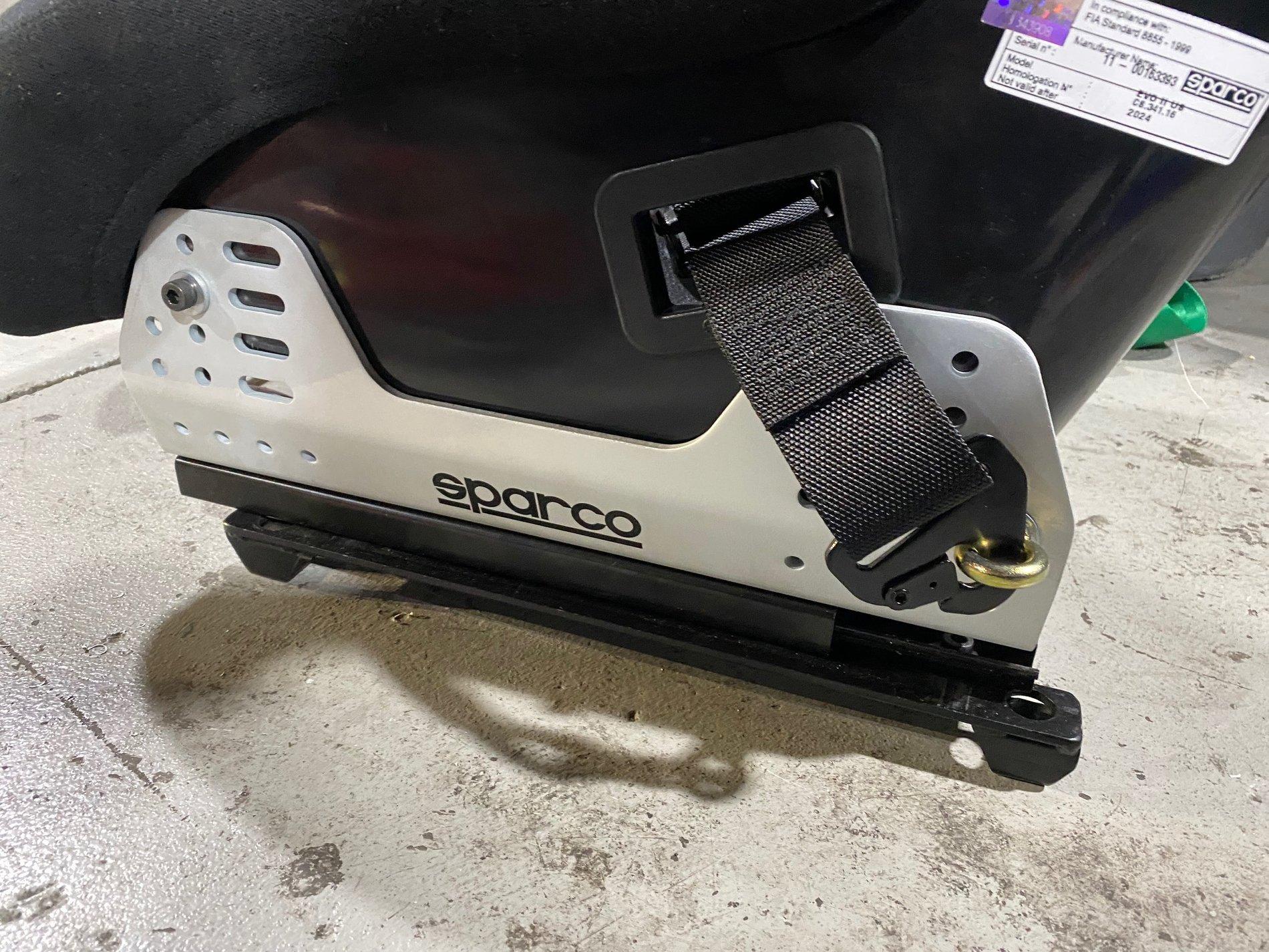

---SO MADE SOME PROGRESS WITH MY CAR LAST NIGHT!

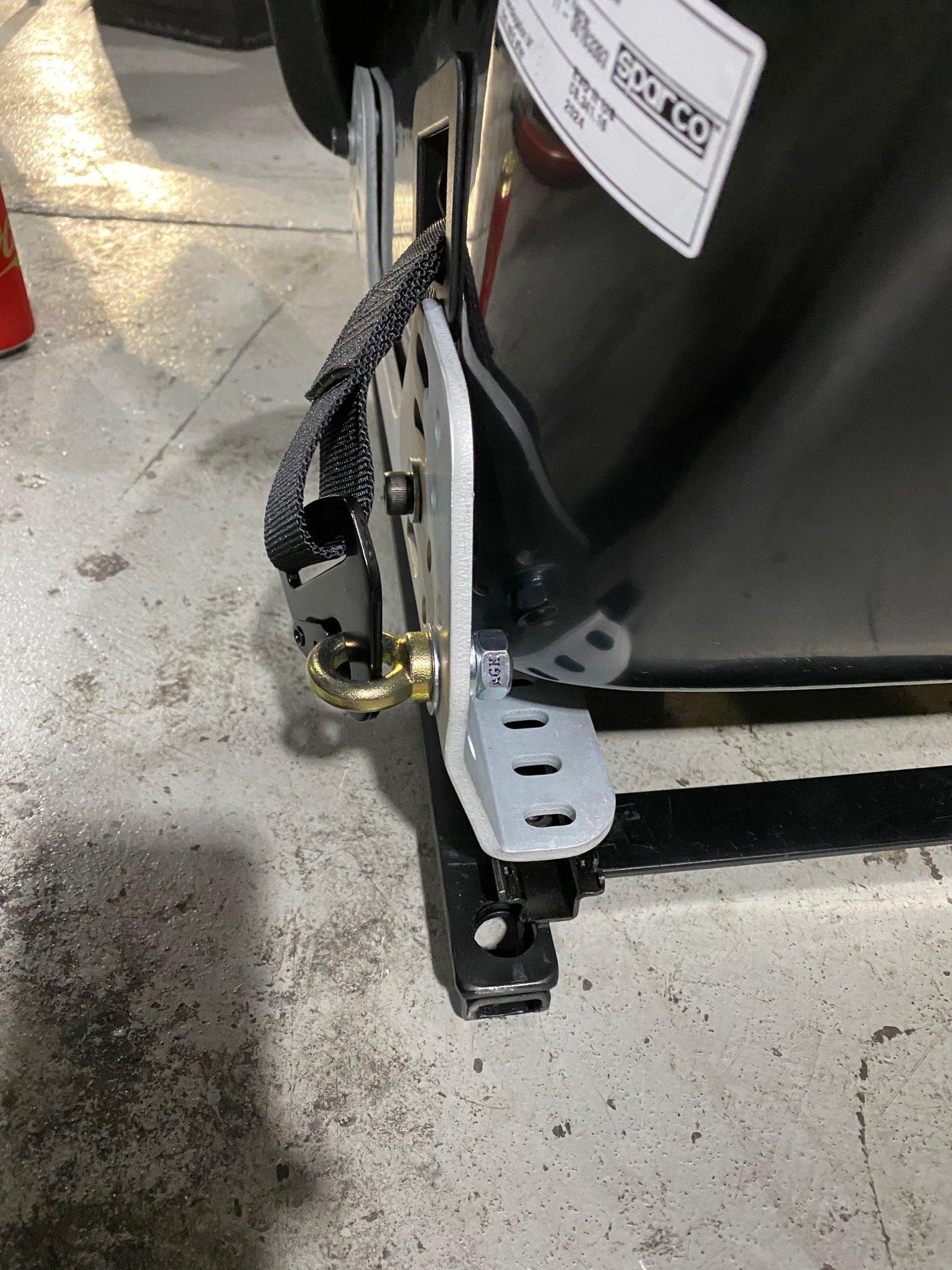

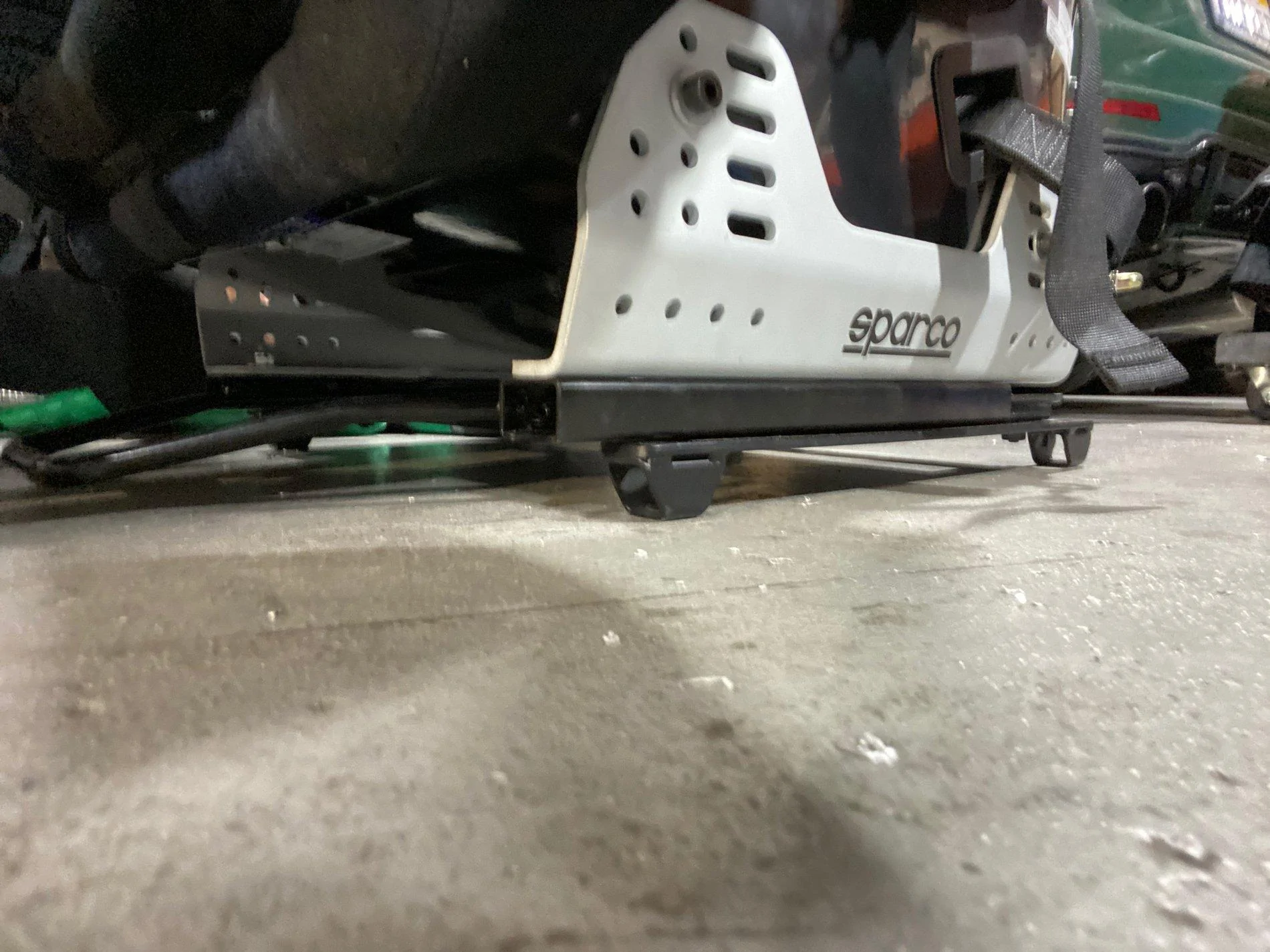

I am using a P2uned Slider Rail Kit along with the Sparco HD Side Mounts.
The seat I went with is the Sparco Evo II US version.
I'm 6'3" 195lbs and have broad shoulders so I needed a wider seat.
I first tried the Macht Schnell Floor mounts available now for the A90 but that put me way too close to the wheel and I also couldn't close the door properly without the corner of the seat contacting the door impeding it from closing correctly. When those didn't work, I picked up a slider rail kit from someone local who had one on the A90 Marketplace FB Group.
First side mounts I tried the PlantedTechnology Aluminum 90 degree side mounts which did not work because the 90 degree bend bit into the side of the seat. The slight bends that the Sparco HD mounts have helped get a secure and proper fitment.
The P2uned slider came with OMP side mounts but were super thin compared to the Sparco HD's.
The combination of the P2uned Slider Rail Kit and the Sparco HD side mounts was perfect!

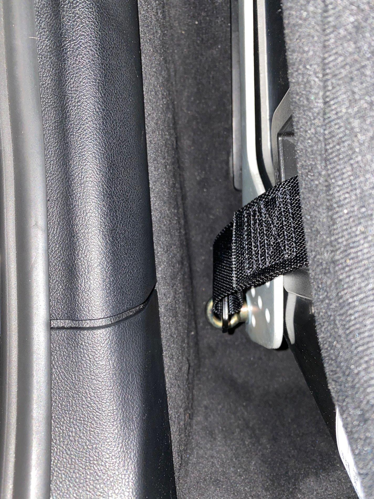

---THE NEXT THING WE HAD TO DEAL WITH WAS THE EYEBOLTS
After speaking with Randy at EvasiveMotorsports he emailed photos of Sam's car and where they drilled holes to mount the eyebolts.
I did NOT want to drill holes in the car just yet so we had to think of something else.

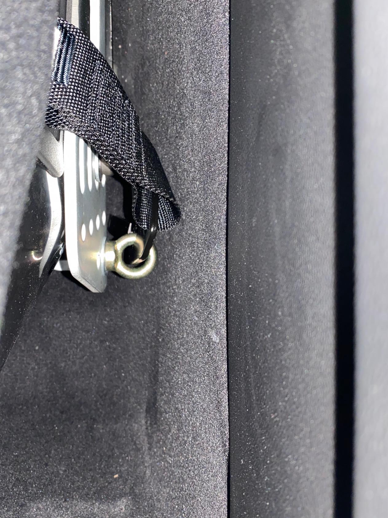

The Sparco HD side mounts are some of the thickest I've ever seen so we decided to bore out one of the rear holes not being used for mounting to thread the Sparco eyebolts included with their harnesses.
It took maybe 30 seconds to have both mounts bored out and eyebolts affixed with grade 10 bolts and lock washers.
INCLUDED PHOTOS OF EYEBOLT CLEARANCE WITHIN THE CAR. PLENTY OF SPACE FOR THE EYEBOLTS TO PROTRUDE AND HARNESSES
I spoke with some techs at Sonoma Raceway, showing them photos of the setup. Based on what they saw and the thickness of the side mounts it will pass tech. I would not try this with any other side mount except the Sparco due to the thickness.
---FINALLY WITH ALL THAT SAID AND DONE THE SEAT WENT IN
The final thing I was worried about was the door closing. I'd seen in person how close Sam's was to his door but was optimistic as far as using the Slider to push it further back. It worked! The door closes perfectly, I can fit 5 playing cards between the door panel and the seat. No movement between the seat or panel when it is closed.
I HOPE THIS HELPS SOME PEOPLE
STAY TUNED AS I HAVE SOME SPARE AIRBAG AND SEATBELT CONTROLS ON ORDER FROM TOYOTA AND WE WILL BE PLAYING AROUND WITH RESISTORS AND WHAT NOT TO TRY AND GET THE AIRBAG LIGHT OFF THE DASH WHEN AFTERMARKET SEATS IN INSTALLED.

I have mine installed this week. No major issues, fits and everything, only thing we havenā€™t figured out is how to deal with the side airbag light, but itā€™s not beeping/preventing you from turning off TC, I should say that I have put a resistor on the side airbag thingy and it didnā€™t do a thing.
which resistor you use? 2.2 ohms or 3 ohms? i heard bmw use 2.2 ohms
