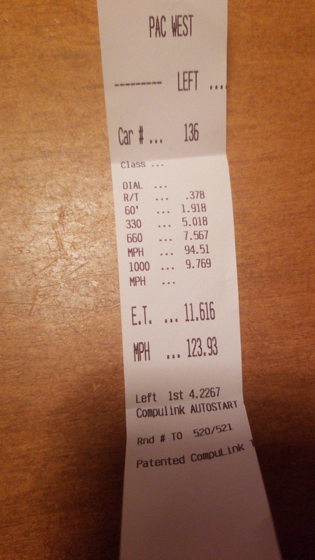

Hi,
I went today to the Sac Raceway, great people running today. My best was 11.6 s with 123.9 mph, worst 11.7 124 mph.
I really need tires and practice, this trap speed is for a high 10s run.
The setup is just AMS Downpipe and the MST CAI, with the OTS Stage 2 E30 from BM3. I don't think more is needed for street use. It was 70 °F and the carr have full weight.
Here the Log:
http://www.bootmod3.net/log?id=5e361570d10b430e28b520f7
