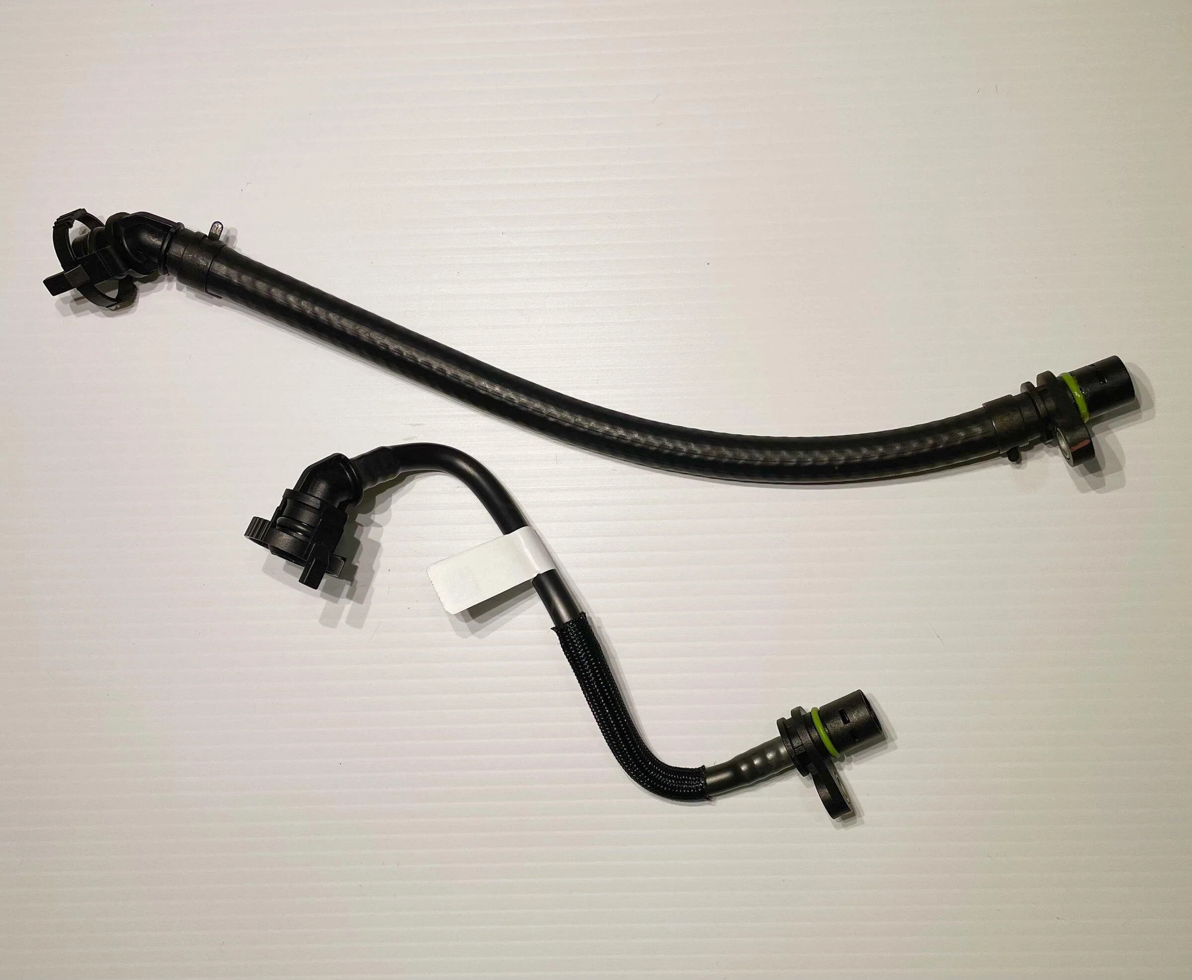

I decided to replace the stock CCV hose with reinforced fuel vapor line.
The fit is better now and allows for any movement the engine might have.
-RJM

Hey @Loco38SUP ! Thanks for sharing. I actually used the Armaspeed intake and was one of the first with the Forged Carbon design, so I remember this intake quite well.
This maybe an install tip with this as I remembered this from when I installed mine:
Install silicone to CF Tube
Insert into Turbo inlet
*** Here is where you want to attach the CCV hose***
Then continue with the install of the box and intake.
That allowed me to install the coupling to the turbo then turn the turn the tube into the intake box. Installing it this way did not give me any issues with the CCV hose.
Is that how you installed yours? or did you install the CF tube to the turbo and box then tried to attach the CCV hose? That way did would not work for me.
Here is also a good video on the install. I tried to time stamp it but go to 3:40 of the video.
Let me know if you have any further questions. I'd be glad to help :)
