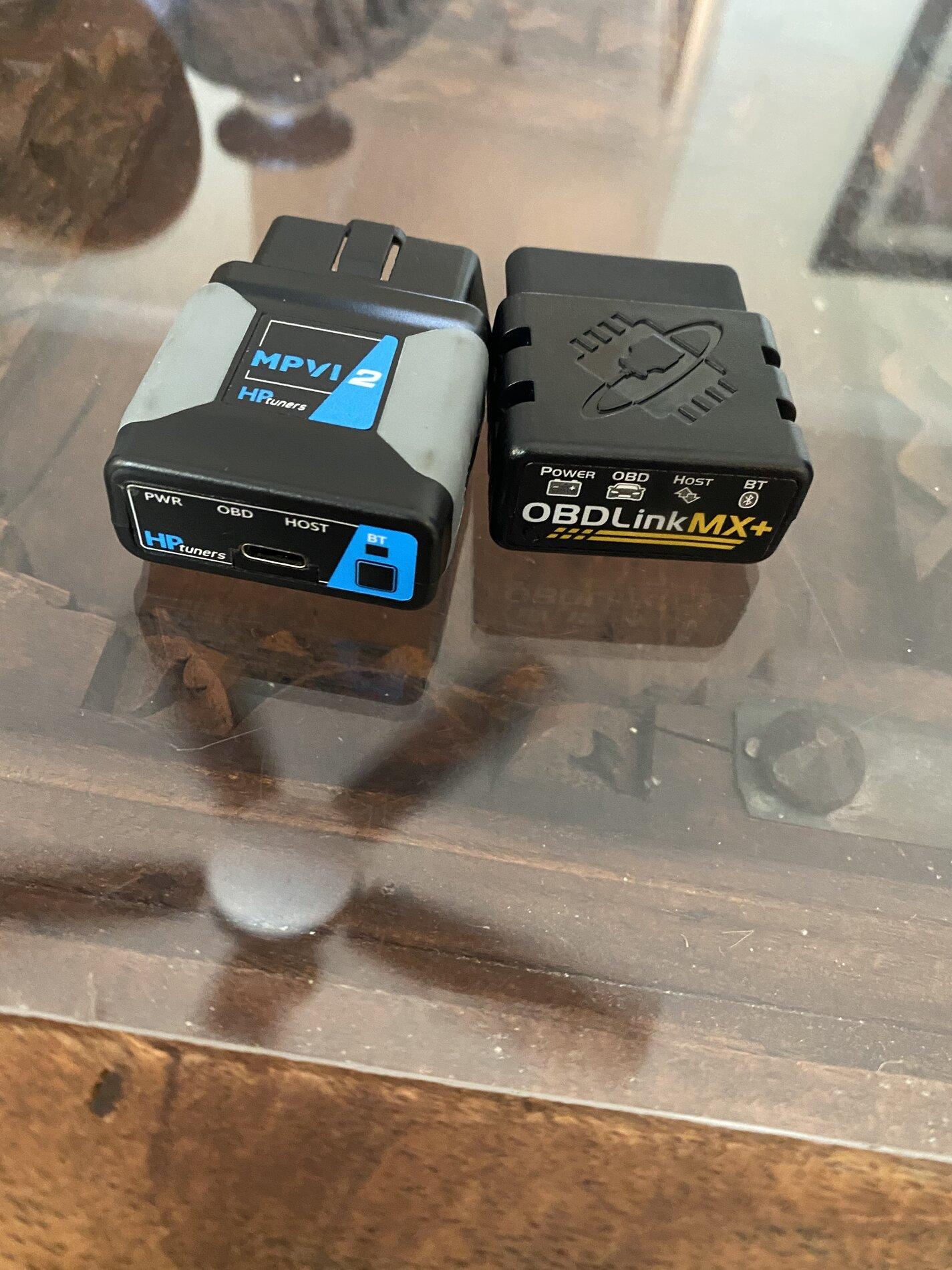

I have an HPTuners MVPI 2 with is a full featured flash programming adapter used with HPtuners Software (primarily for my GM and Ford cars). Since Track Addict is an HPtuners software product, the two work very well together for around 10Hz OBDII scan rate over bluetooth (only supported on android devices).
I also have an OBDLinkMX+ Bluetooth OBDII device. Although it is compatible with TrackAddict, the scan rate is very low (approximately 2Hz).
I you want a really good solution for fast scan rate for OBDII and GPS, I would go with the RaceCapture Track MK2. It works very well by itself for "Big Track". If you need an autocross solution, I would recommend the SoloStorm/RaceCapture Track MK2 bundle.
ahh interesting. I’ve been reading up on track addict over the last week, and one thing that has not come up is OBDII scan rate. Definitely makes sense. I only have IOS so I’m going to give track addict a shot with XGPS160 and veepeak obd device. I really want the video, and sounds like I’d have to pay another 200 for the SoloStorm software and an android device
