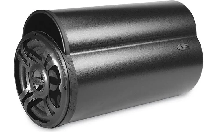

That’s quite a build. I don’t know a lot about car audio but I’m curious. Did you ever consider a Bazooka sub instead of the custom enclosure?

When you say bazooka, are you referring to a powered sub enclosure? Yes I did weigh my options of placing one over the oem enclosure but I preferred a more catered look.

Yes, that’s what I meant.

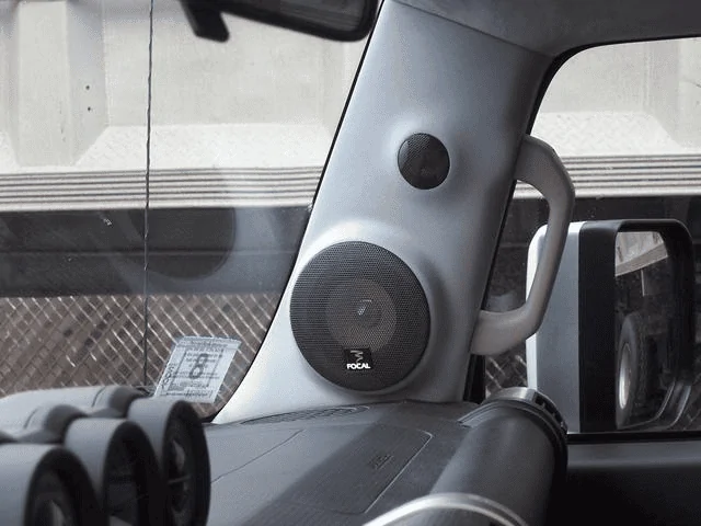

Yep, this was 100% of the apprehension I had when previously considering the OEM+ solution. The problem isn't as much a lack of impact or extension of the sub-bass... it's the 100Hz-500Hz region that needs the most help. Even at 300Hz, you're talking about ~4 foot wavelengths (45.2 inches). Expecting a 4" transducer to create that within a semi-sealed enclosure (with near zero volume) is a monumental ask - no matter who makes it or what exotic materials are involved. Especially while also handling the busiest midrange region as well (and from a position ~1.5 feet away from the tweeters).
Naturally, if you're chasing SPL not SQ - then not as much of a concern, but I don't usually listen to EDM so it is a concern of mine.
Too bad there's not really enough room to roll something like this (in an FJ):

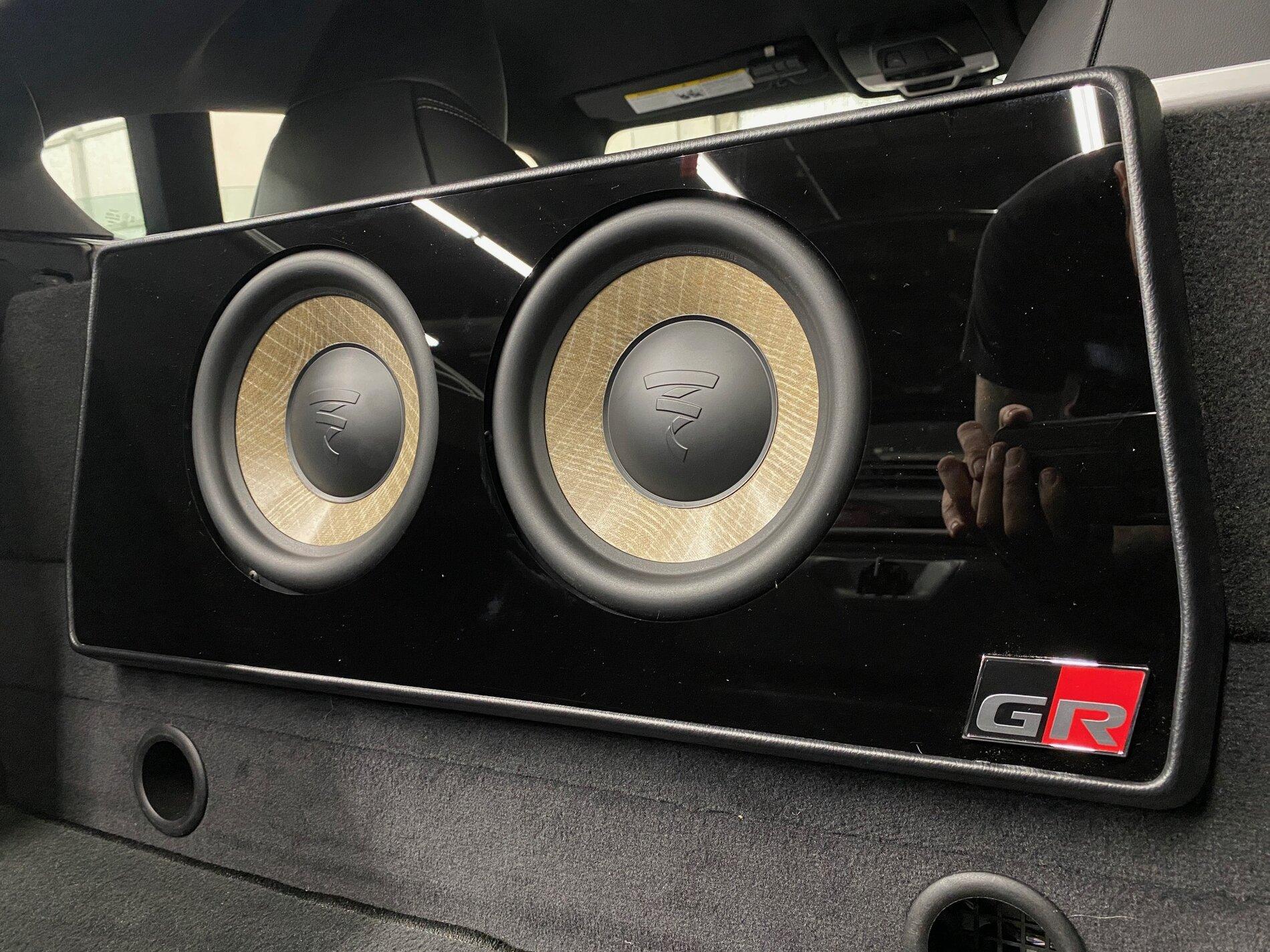

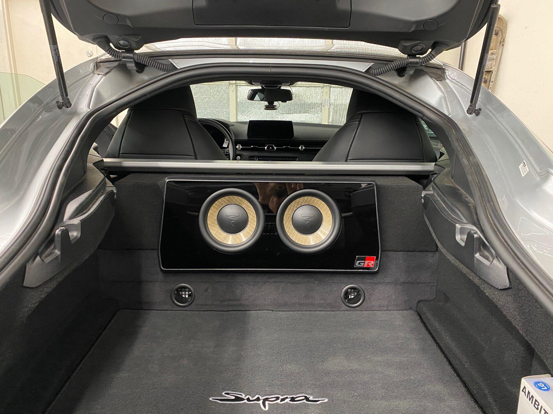

Subwoofer Enclosure Revision
The shop redid the whole rear panel on the sub enclosure last Friday. Originally the panel was built too tall touching and causing the top privacy trunk cover to bow and spread vibrations through the other panels in the trunk. Since the top was shortened the Supra emblem no longer fit and we decided to fit the GR emblem on it instead.
