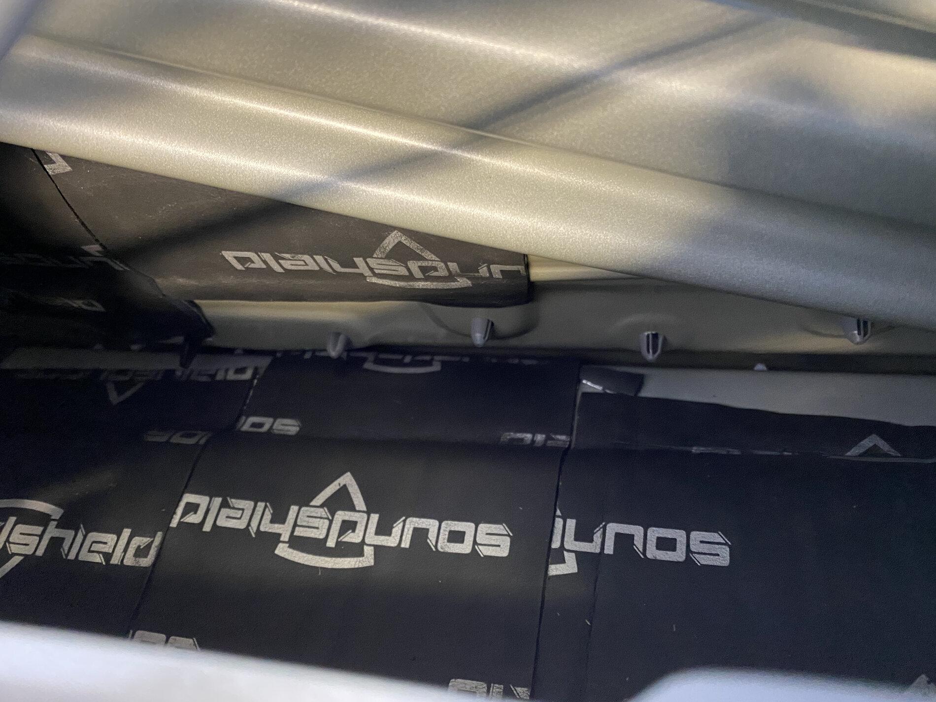

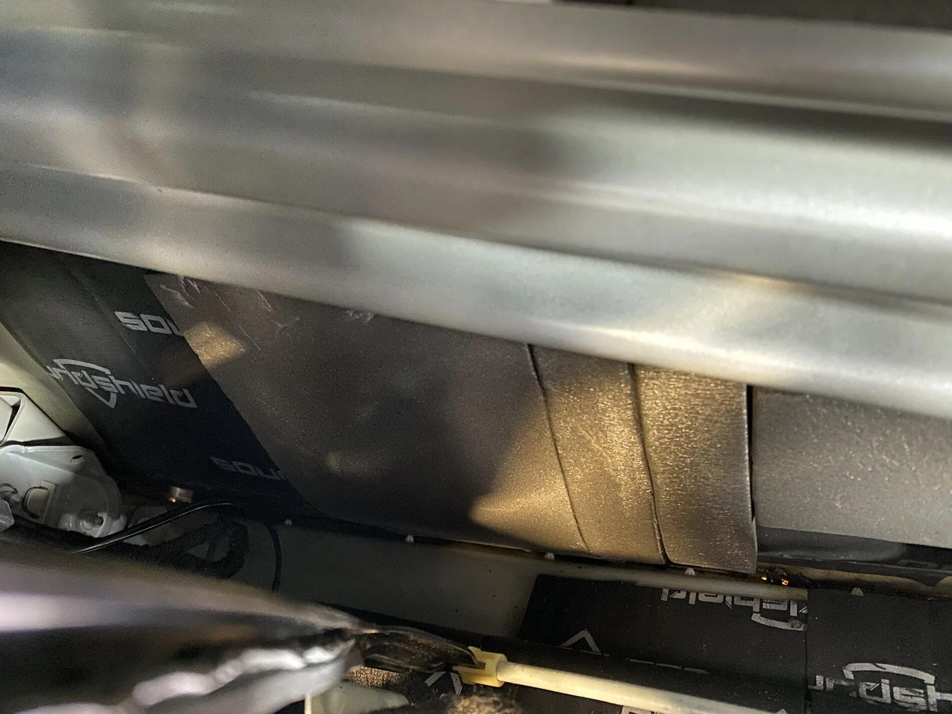

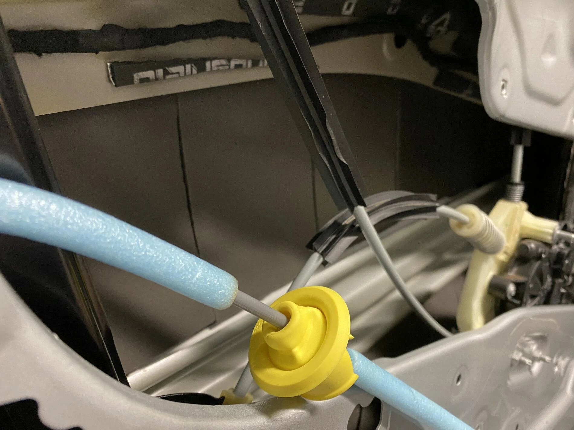

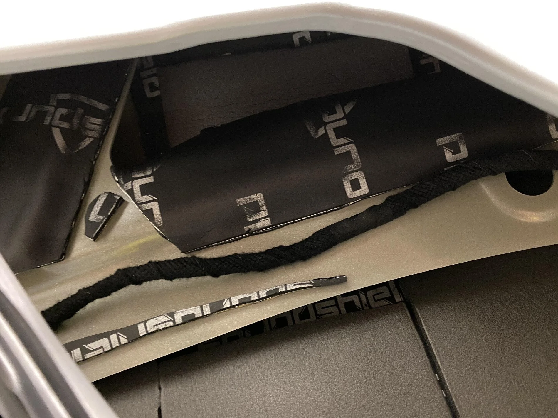

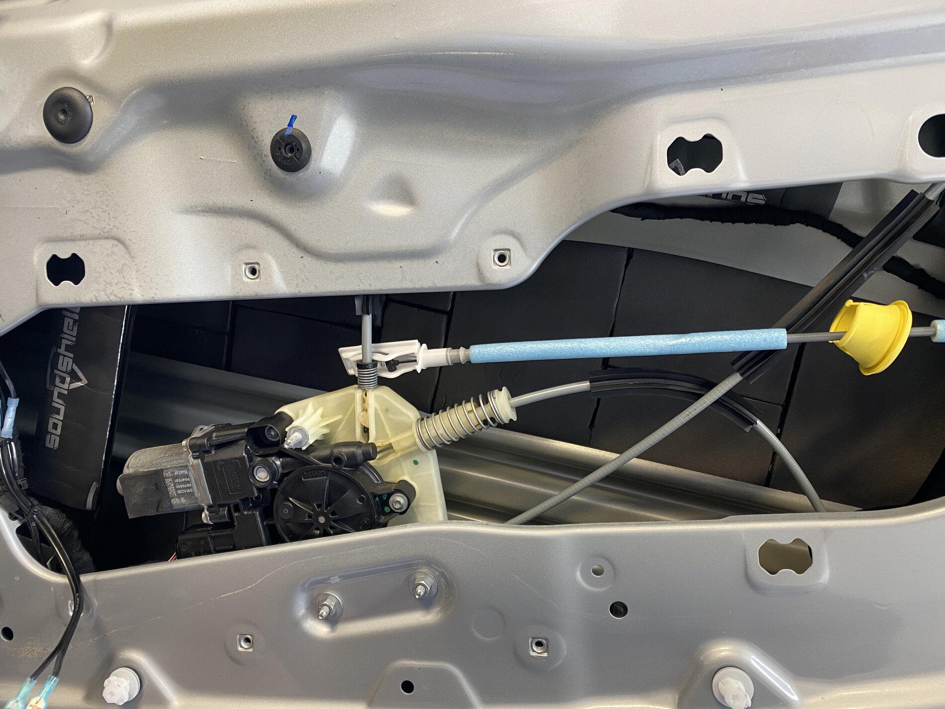

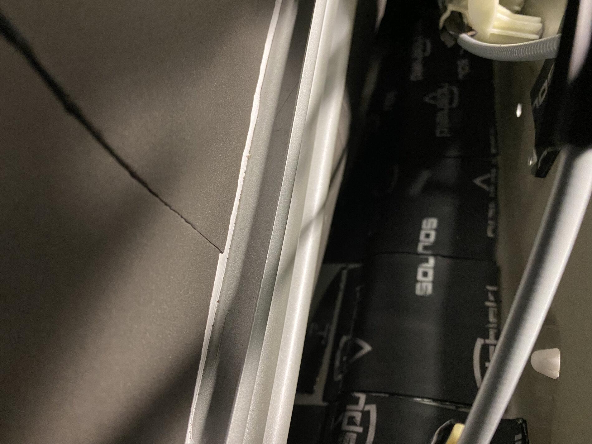

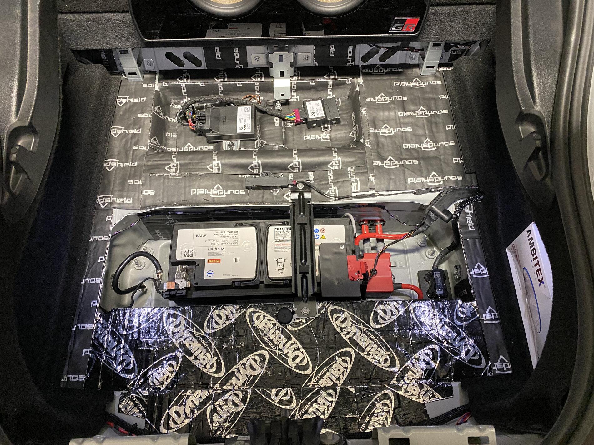

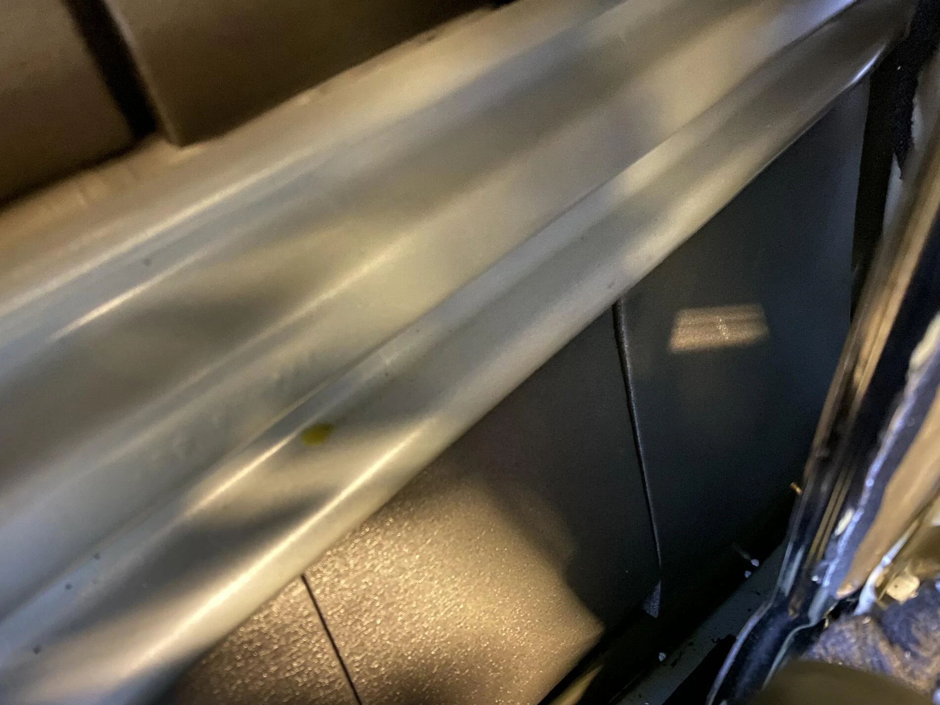

Sound Deadening
Did some additional sound deadening, using SoundShield this time, inside the doors. Added Noico 315mill Red I had left over, on top of the SoundShield for some thermal insulation. Also did a layer of SoundShield in the trunk over the Dynamat and areas not covered before. Forgot to take a pic before putting the side panels back on but there is not much to see back there.

Now all that's left is to pull up all the carpet and line the floor boards... ;) I bet it sounds like a 7-series now as far as road noise.
Yeah not going that far. It does sound very tame inside.
