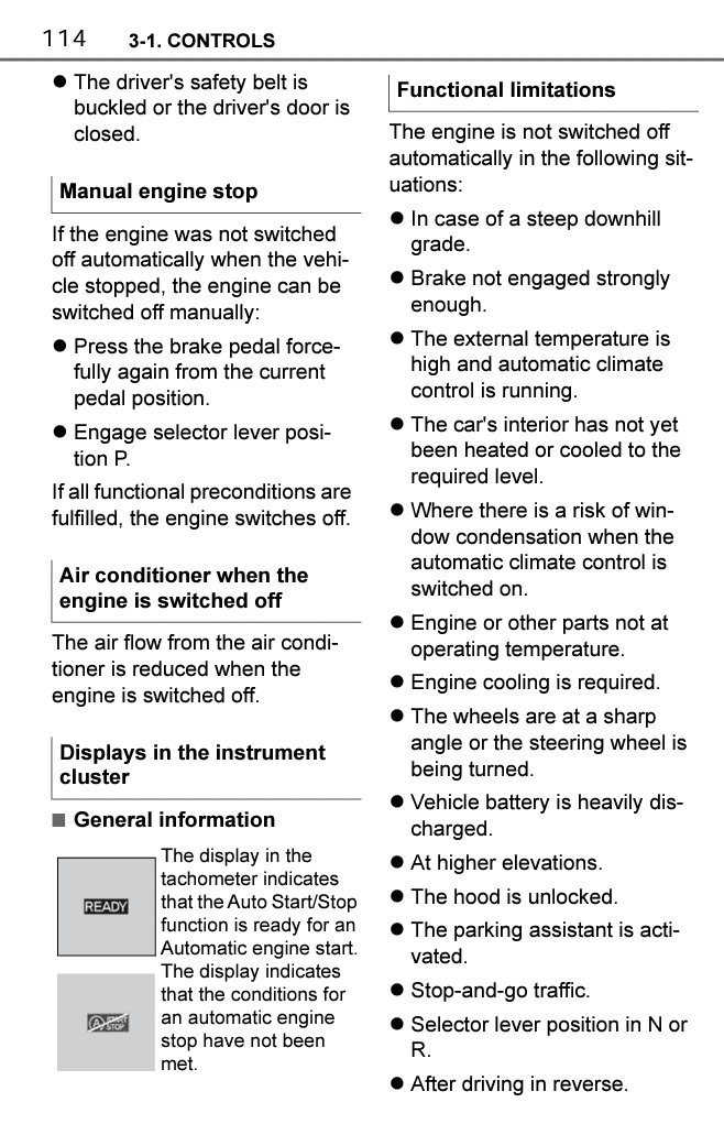

Recently noticed that the engine auto off feature stopped working. When I stop it always shows an A with a line thru it and Off. I'm driving in Normal mode so this has me perplexed. Any ideas on why this is happening? Thanks.
Aug 8, 2018
2,958
3,207
If you're positive that you've not bimmercoded it out then you're not meeting the conditions of auto off as in low battery, AC/heater need, etc. It's in the manual somewhere..

I have coded some things but not this. It used to work. Interesting about the heater/AC but today it was off and still happened. I'll check the manual and see what is says. Thanks.

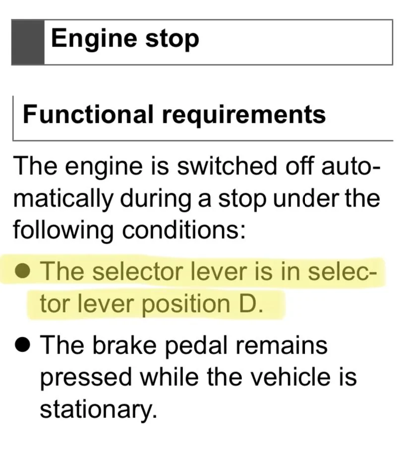

Are you in Drive or Manual?

Battery may be weak for auto start/stop to function so it’s disabled until it is fully charged by the alternator.

OK, but why would the battery be weak? I drive all the time. Is there a way to check the battery health?

BimmerLink can show the battery’s charge.
