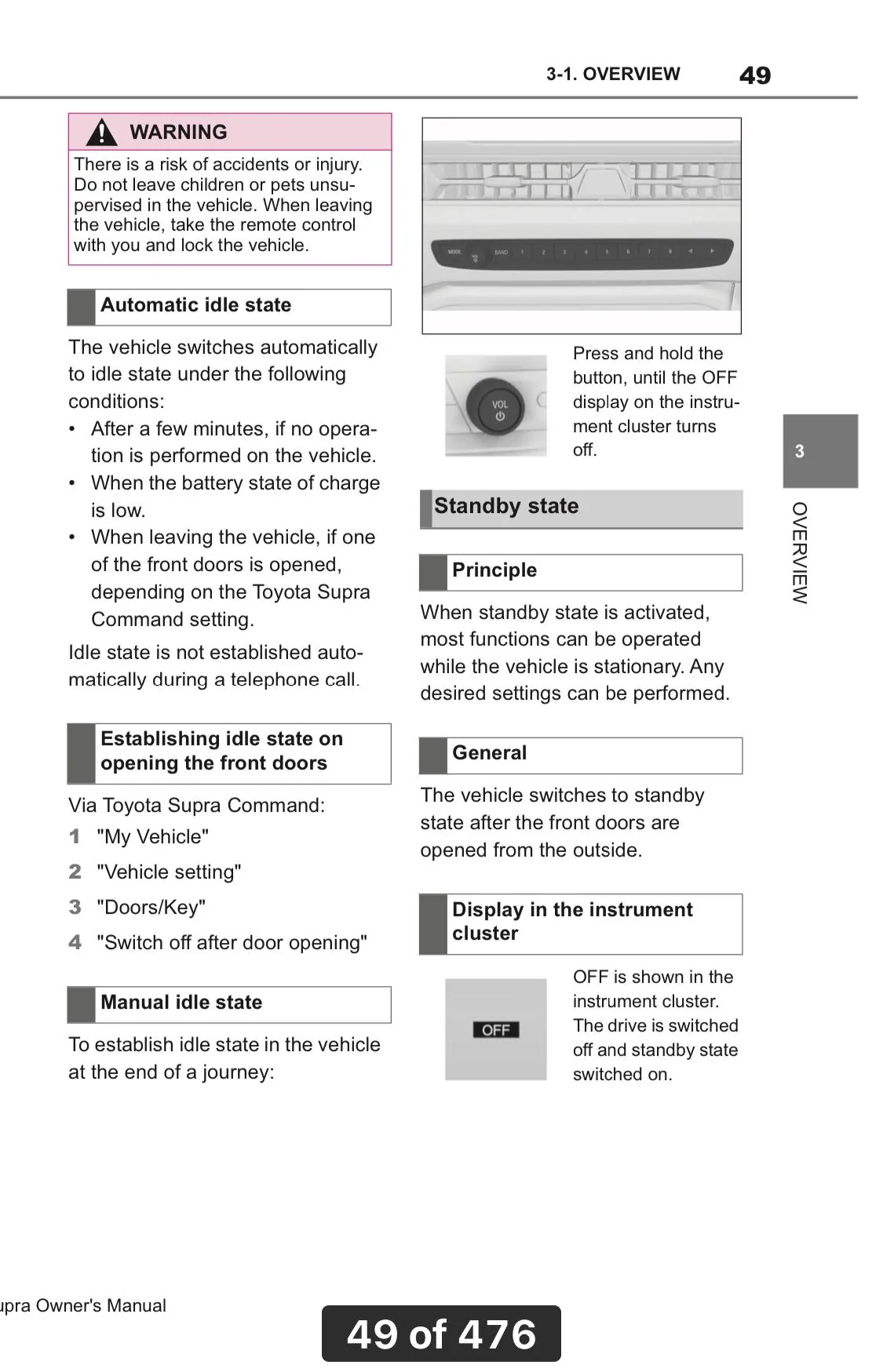

I was just curious if anyone knows if or when the Supra will automatically turn off when you do not lock the car. For example, when I park the Supra in the garage, I often don’t lock it. However, I have noticed before that the car doesn’t seem to turn off for quite a while.
Does anyone know if it will eventually turn off and if so, how long it will take? Thanks.

I wouldn’t trust the auto shutoff even though it’s supposed to happen. Who knows what code gremlins might keep the car awake.
You want to be in Idle state FYI.

Thanks. The weird thing is it is in “off” on the display, but it doesn’t seem like the car actually turns off all the displays and whatnot.

Off means it’s in Standby state. When Off disappears it’s in Idle state (true off).

You may want to know that by pressing and holding the on/off button, for the radio, will put the car in idle state (off) without having to lock the doors. Try it.

Is there a setting where all the electronics shut down when the car is turned off??

Define “turned off”.
Just read and digest the screen grab I posted from the owners manual. If you set the menu option to do so, the car can go into Idle state (as “off” as it gets) when you open the door to get out of the car after you’ve entered Standby state.
