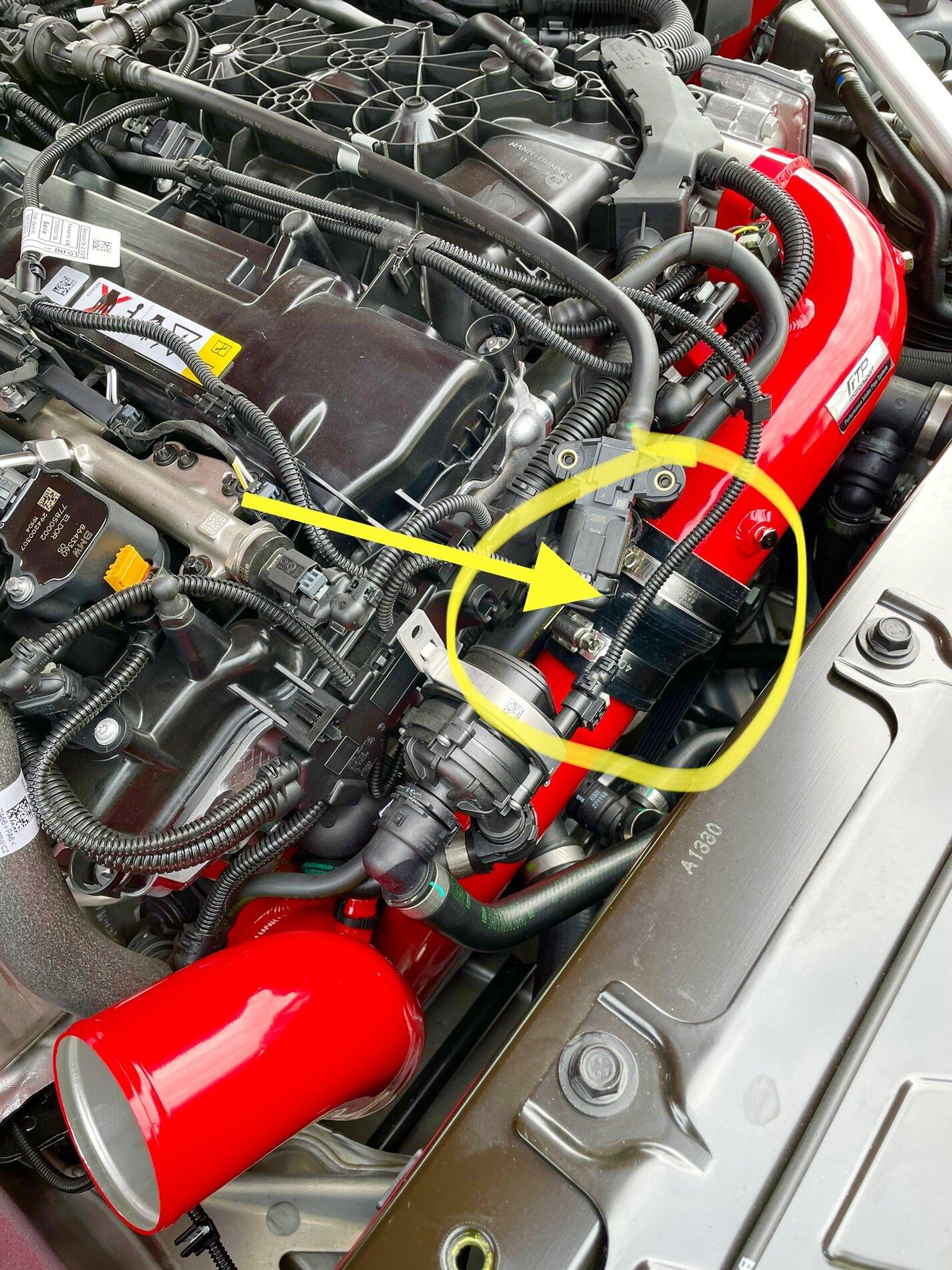

Are you referring to the section that bridges the two halves of the charge pipe? (see picture below)
If so how much boost are you running to blow those pieces apart? You can always install high pressure clamps to ensure the 2 halves stay connected.

I am referring to the section of pipe you mentioned and I have tried the SS Tbolt clamps you have referenced above, to no avail. I am running a level 2 Bootmod tune with a 200 free flow catted downpipe and standard air intake. A BMW engineer who was at my last track day tried to help. We tightened the T Clamp to the absolute maximum on the smaller end of the pipe, but it still slipped off after 2 laps. His comment was as follows:
1. the quality of the silicone pipe was suspect as it had flared our considerably from my attempts to seal it to the porcelain pipe.
2. he believed that the length of the narrow end of the silicone joiner pipe was not long enough to get a wider T clamp on and this was the major factor.
3. He was surprised of the gap between the two silicone pipes even though they were fitted perfectly.
I have been a big fan of FTP charge pipes and have run them without any concerns on previous vehicles running much higher boast.
My supplier Andy at Flashtuned Suite 12 / 2 Ambitious LinkBibra Lake WA 6163 P: 0419940526 is the ultimate professional, and is trying to source me a new pipe and clamps that will fix the problem. Any advice you have would be greatly appreciated. I am not the only one who has experienced this problem on the Supra. I have two colleagues who have reverted to the original one piece charge pipe and are running much more boost. Thank you Glenn

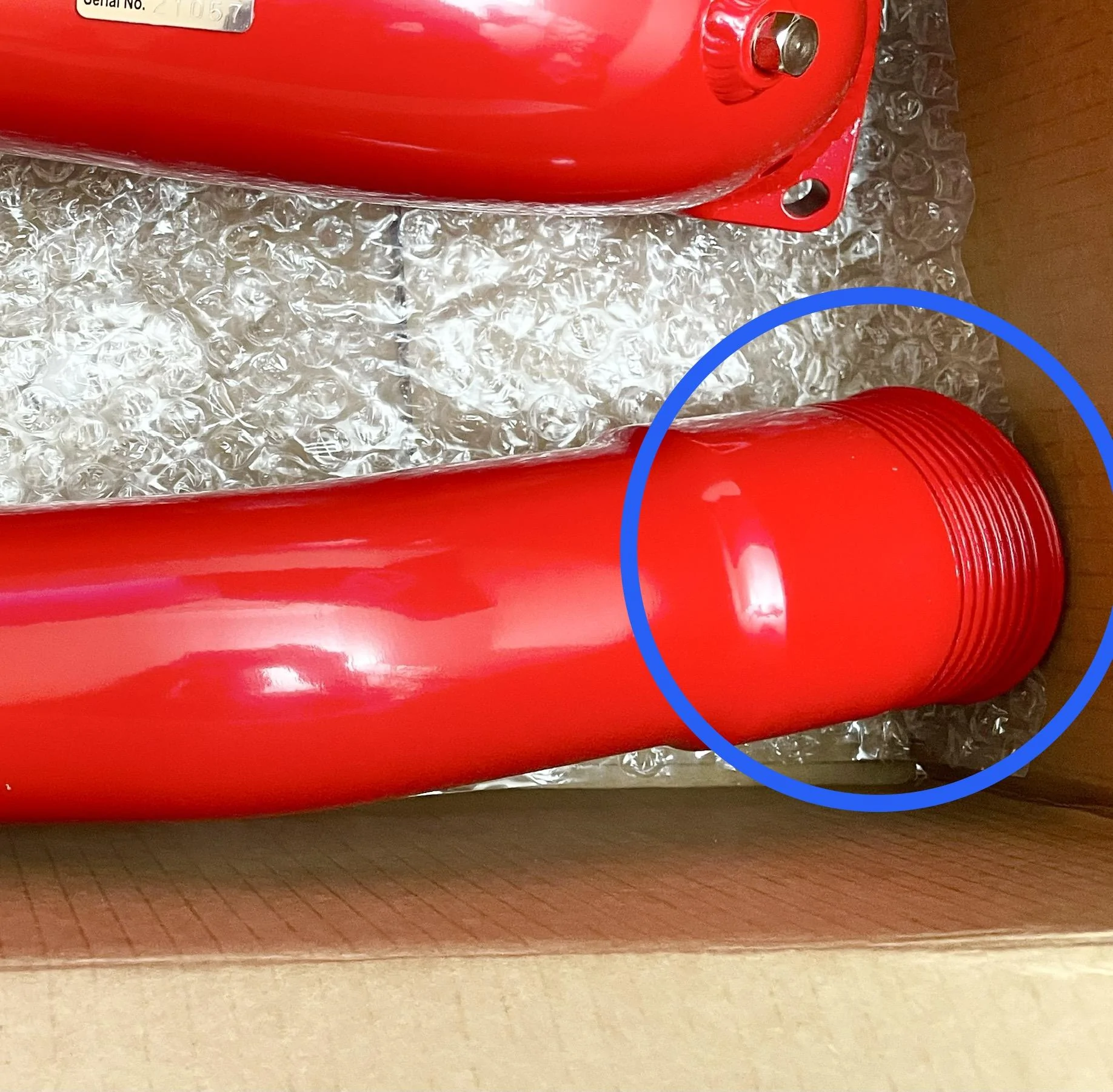

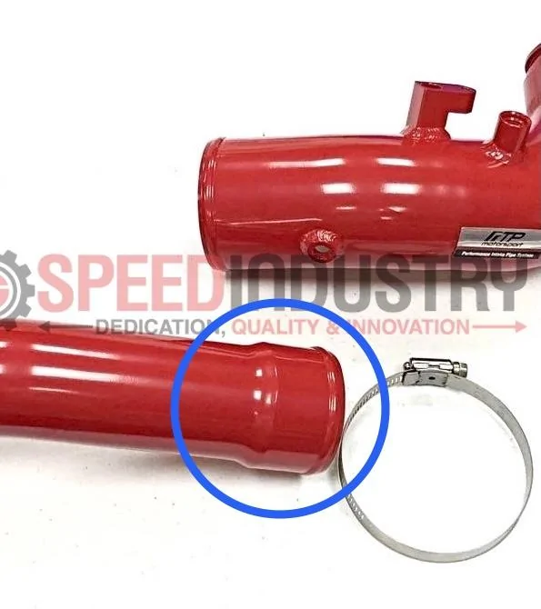

You do realize there was a design update to improve the connection between the two halves of the charge pipe.
Is yours the early version with only a smooth surface or the new one with the ridges?

Thank you so much. Yes mine was the earlier version. I was unware of the update until you told me. Thanks for your time in advising me of this issue. Glenn
