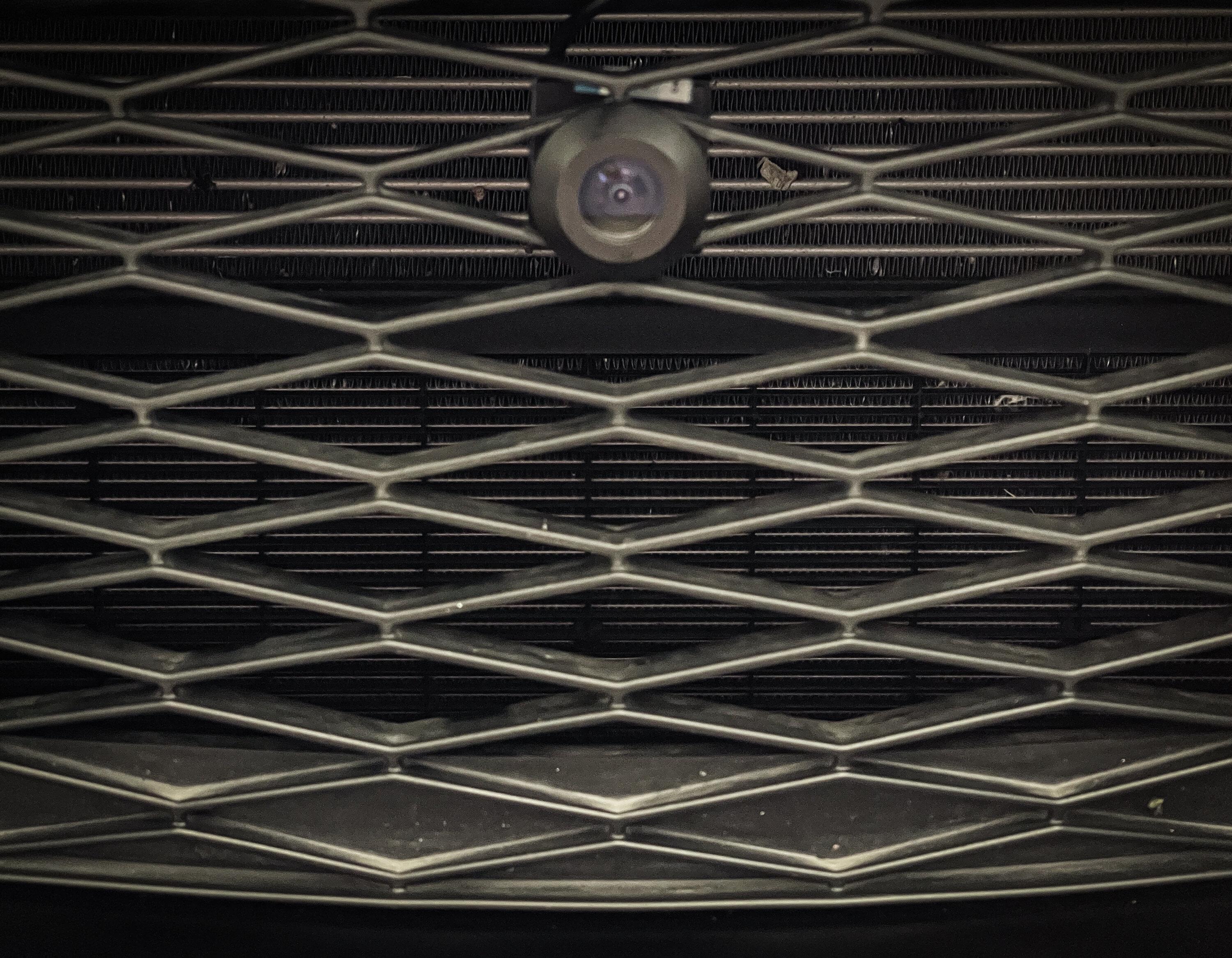

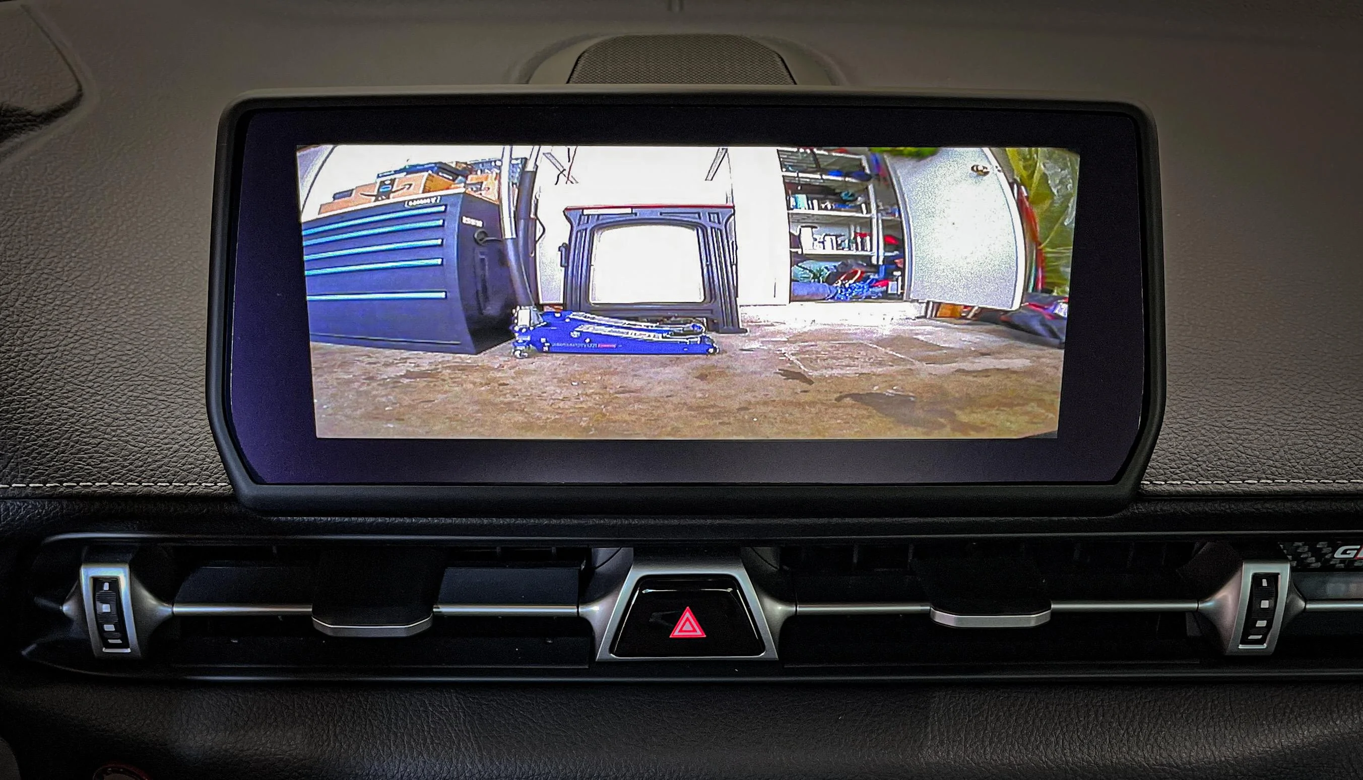

I've spent the last 20 minutes trying to upload a video of the BimmerTech camera in action but this site won't let me. I've even tried multiple re-encodes at smaller and smaller resolutions but it always results in "something went wrong." Oh well.
In any case, I've been using the camera for a few months now and the camera works relatively well. I have recently begun to use it quite regularly as I've moved my Supra in a tight garage space and it's quite handy for what it is.
The camera is engaged and disengaged by pressing and holding the physical "option" button located in the center console. The quality is good enough to get the job done but in 2024 it really is potato quality. Despite the cost, this isn't all that surprising considering the camera is connected to the MMI box via a single analogue RCA video cable.
The camera can be engaged any time including while driving at speed which is a nice novelty but it wears off pretty quickly - partially due to the video quality. Also worth noting is that having the camera on overrides everything else being displayed, ie: engaging reverse doesn't invoke the camera if the front camera is already active. This also means the camera stays on once the car is turned off (presumably until the electrics turn off) so it is best to turn it off via a long press of the "options" button before exiting the vehicle.
It all works quite well although it does briefly flash an iDrive screen (options) when turning the camera on/off which isn't a big deal but does make it a little clunky.
Overall, I'm happy with it and I'm glad I had it installed.
PS: This is my experience with the BimmerTech camera installed on a MY23 MT Supra.
Additionally: The MMI box itself can be accessed by pressing the number 8 shortcut on the dash. It brings up options and access to Android Auto functionality but I haven't bothered or messed with any of that other than setting up the camera to function as I want.

I had a shop install it - in their words, it was "a fucking nightmare." A lot of the interior panels need to be removed to install the MMI and the front bumper also needs to come off to fit the camera itself - great excuse to add that low tone z4 horn! BimmerTech does provide instructions and a video.. but it just looked too much for me to bother with.
