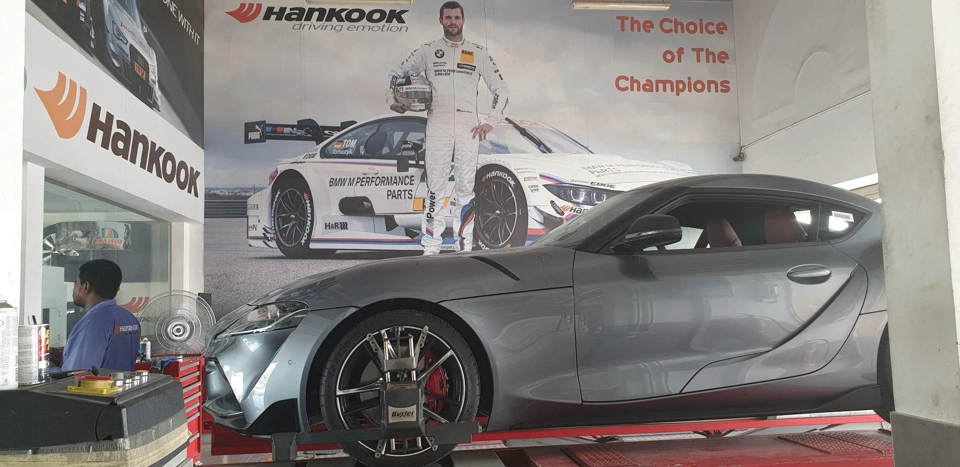

I really enjoyed using it as a daily, but I had to do track alignment since the first track of the season was on the same week.
Ended up at -1.6 front camber and -0.05 front toe. while I had 1.6 rear camber with +0.03 rear toe.

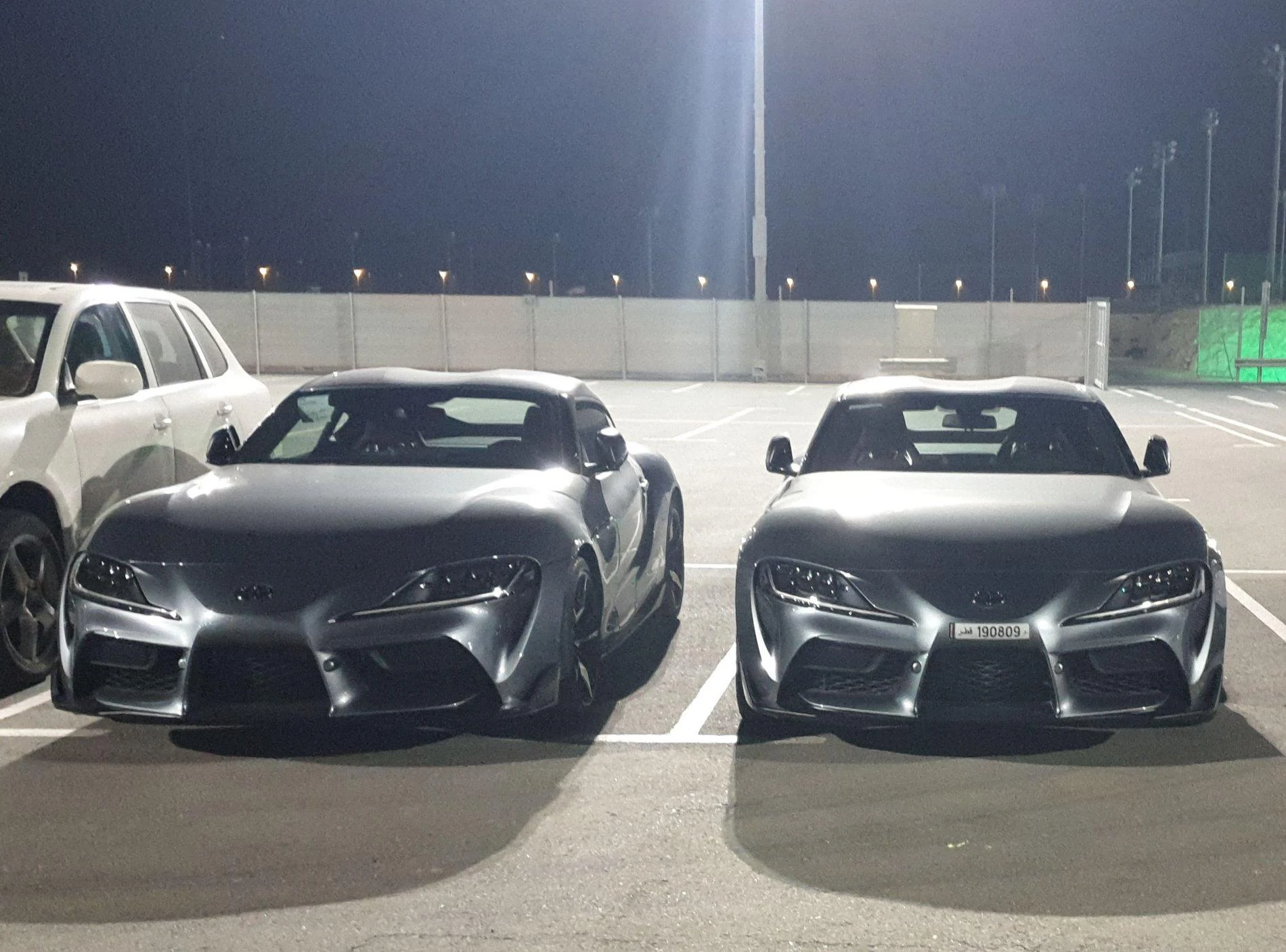

Some photos of my S2000 with the Supra at the trackday.

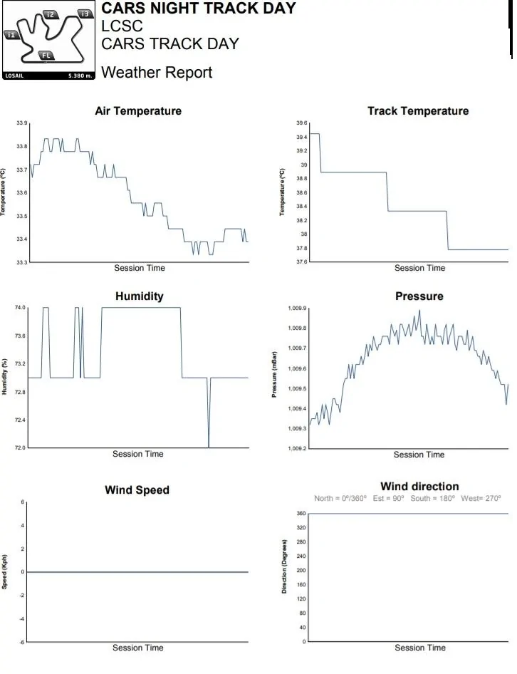

Now the weather these days in Qatar is extremely hot and humid, however it was at night so I thought how bad could it be? Well it was really bad. I had the secret menu opened to monitor the oil temperatures and was surprised that it idles at 110 C. Anyway I went out and did one hot lap only and the oil temperature jumped from 110 to 146 C as can be seen in the video below.

Note that there will be no warning if it overheats and it will just reduce power (you can notice it in 5th and 6th gear in my video) so I recommend anyone tracking the Supra to use the secret menu and monitor the oil temps. I want to make my self believe that the temp sensors are over exaggerating as the car idles at + 210 F and start to reduce power at + 295 F
