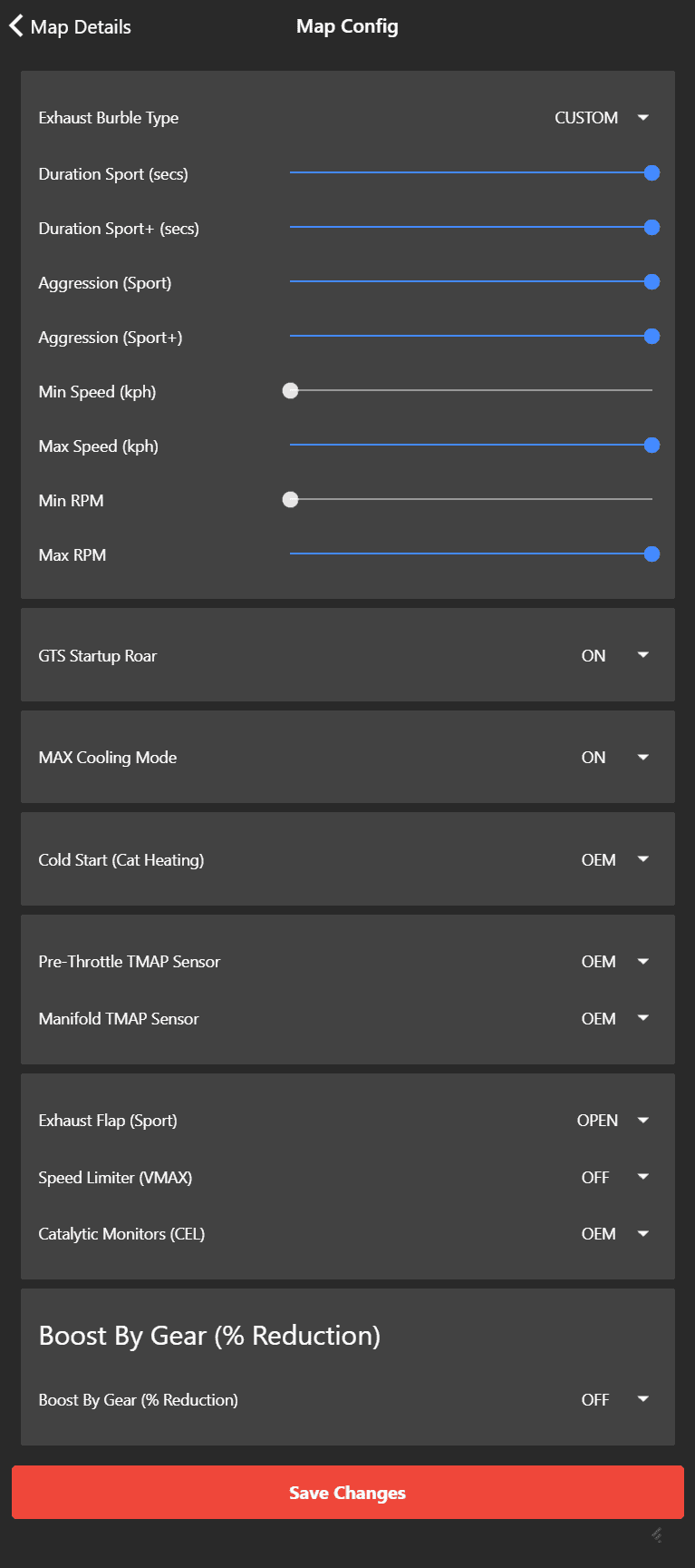

I really like some of the bootmod user configurations of gts roar. Cooling mode etc. But I think MHD also has some of these? Any pics of user adjustments?

I was in the same boat, went with bm3 just yesterday. I'll play around with it tomorrow and let you know, provide screenshots and hoping to take bunch of videos for different exhaust stuff.

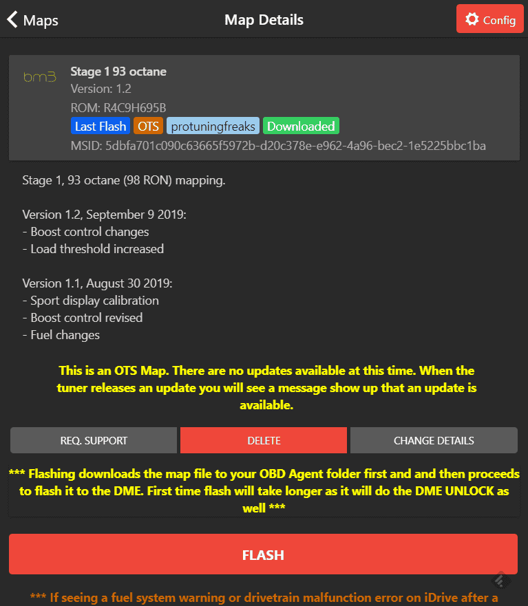

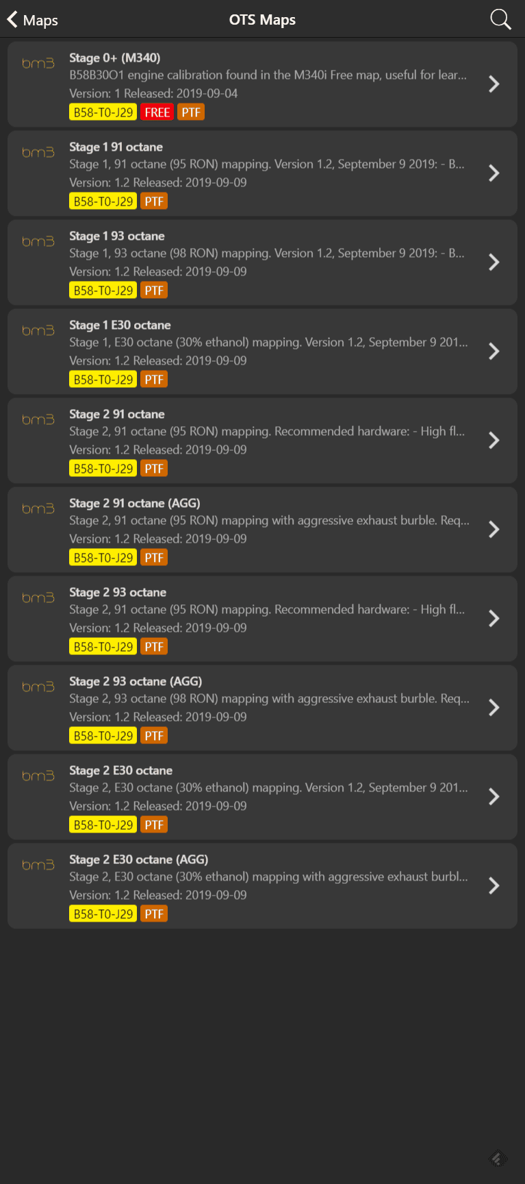

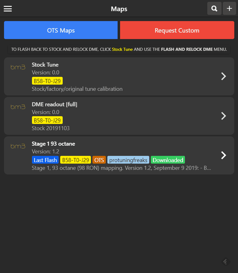

To begin with, everything is stock in my car (so no downpipe at the moment)
So, I tried the OTS Stage 1 BM3 93 Octane with Startup roar. Roar didn't exactly amaze me too much, but again stock exhaust.
However, the OTS claimed 24% increase in power surely is noticeable. Now I'm getting bunch of wheel spin :)
Burble/crackle/etc. I pretty much had to max the sliders to notice differences. I'm exaggerating, they are nice, but I'm in need of the MagnaFlow exhaust! Need funds! :)
I did a full backup of DME first, which in total took ~30 minutes.
Then 1st flash took almost 4 minutes.
2nd time I flashed, it took like 30 seconds.
(these are actual numbers, not estimations)

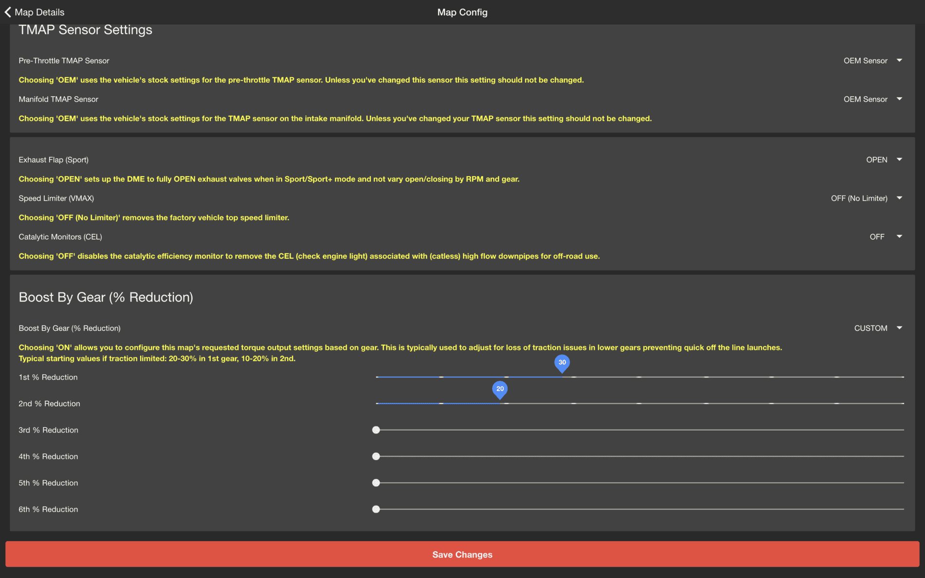

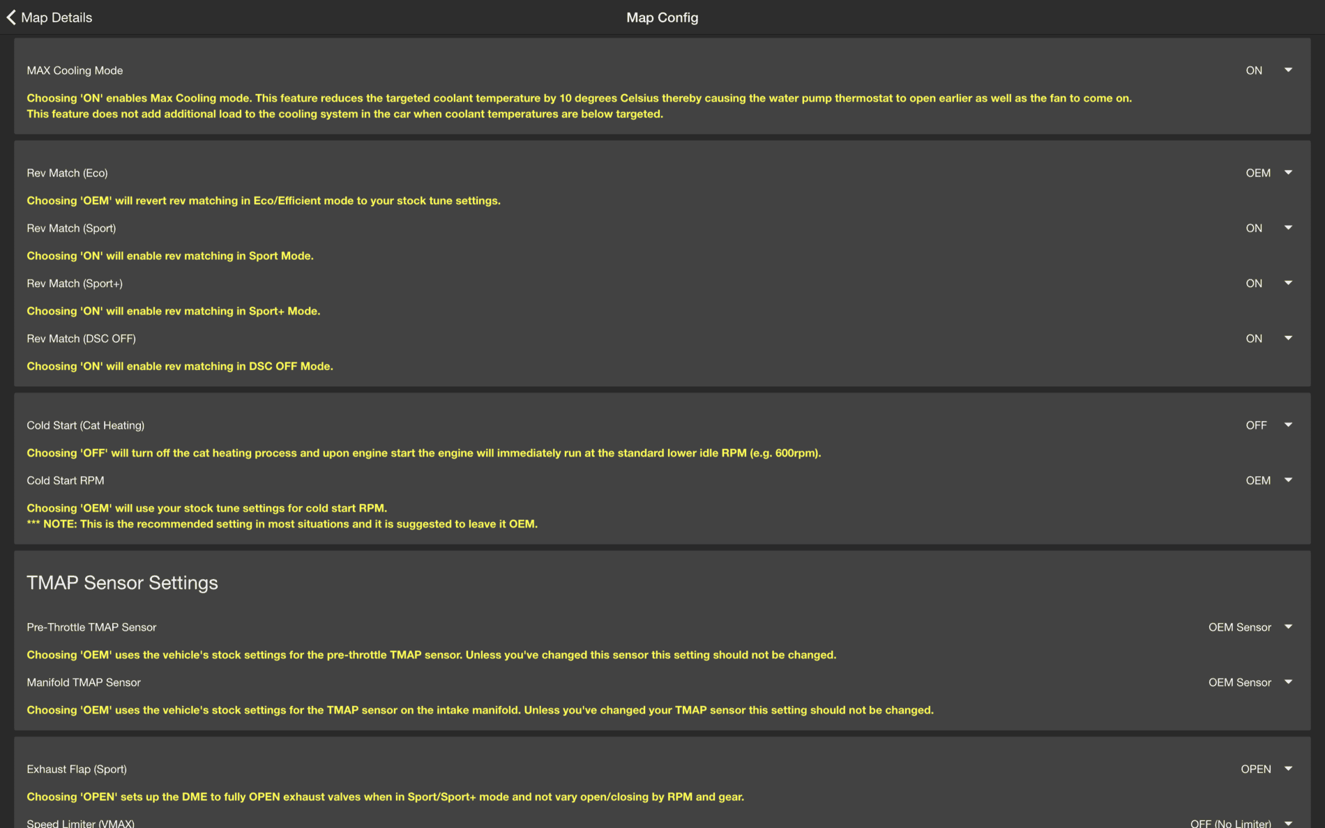

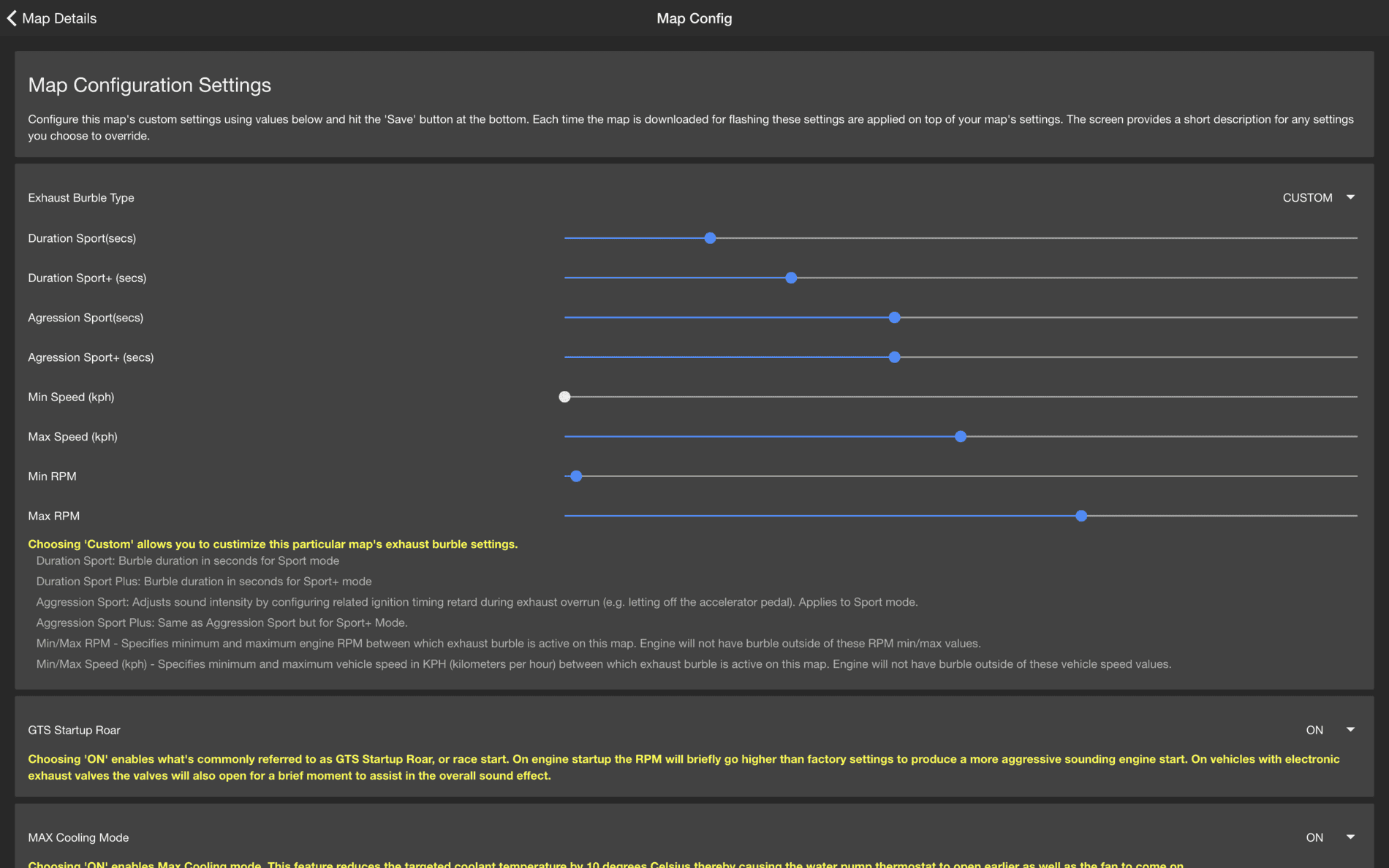

Below are the screenshots of few screens.
My only caveat at the moment is, with my touchscreen laptop, I cannot pan up/down (scroll) on the Map config screen or any other screen for that matter. didn't check the html to debug that.
Overall, I like it, haven't tried to use the cloud tuning editor. Where exactly is that?
I forgot to take a screenshot of the overall page.. Will do that later. Hope this helps!
I don't know why these sample screenshots are not provided in BM3 or MHD pages and people have to rely on members. anyhow there they are.
disclaimer: these are the pages I see with my subscription and Supra A90 vehicle, screen layouts/info/etc. may be different for other vehicles :)

UPDATE: Map configuration screen update with descriptions for all settings and values available.
This should help those using the screen for the first time get a sense of what the values are if or when they may not be clear. I realize some of you will enjoy these being added right in the screen even though all of them are documented in the actively maintained bootmod3 User Manual (lots of details/screenshots of the mobile app screens which are shared with web app).

I'm running OTS BM3 and love it! I'll be doing a catless downpipe soon too. Glad to see solid tuning solutions on the market!
Will I need a custom tune to remove the CEL for the downpipe? Or is this something I can turn off using the app?
