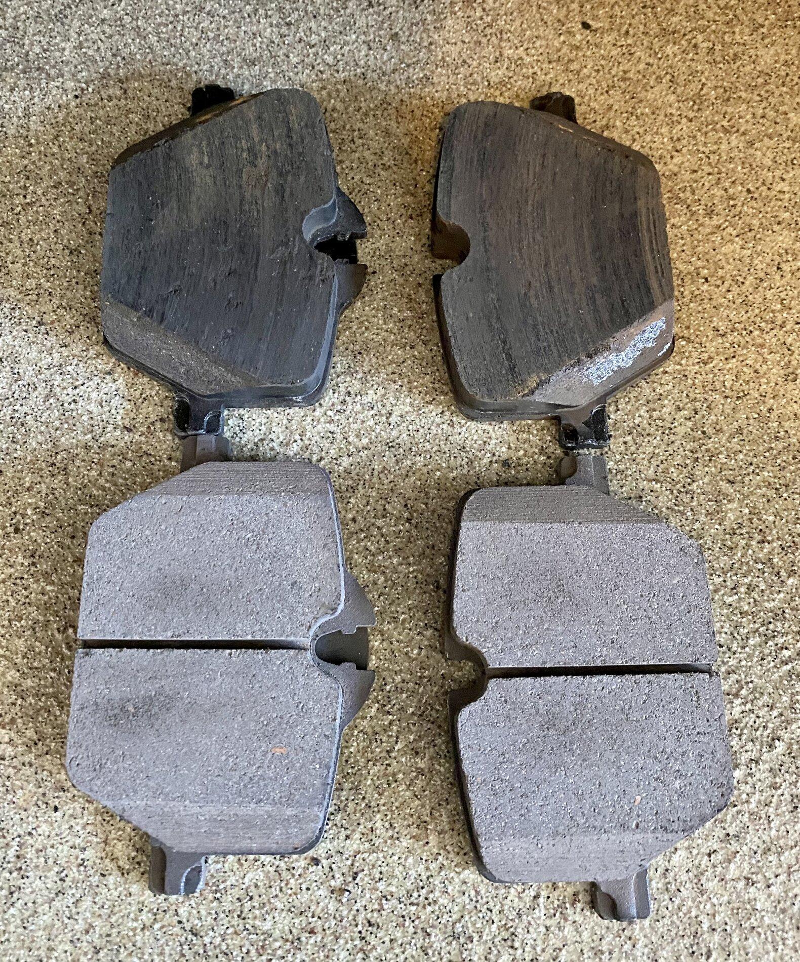

Thanks for the suggestion. No loss of stopping power with these pads?
From my track experience, you will lose about 20ft on 100 mph to 60 mph during hard braking. see below although the discussion is more oriented for track day.
https://www.supramkv.com/threads/brake-pad-discussion-dont-take-r1-ceramic-to-track-day.9946/
I psudo-ceramic coated my new wheels and dust comes off so much easier. I'd recommend doing that than compromise stopping distance. You will never know when you wish that you had extra 6 inches to avoid an accident. but that's just me.
~ For daily driving on the streets you will see no difference in performanceā€¦ just much much less brake dust.
As for the track, you may notice some slight differences but I donā€™t track my car.
Iā€™ve been running these pads (Z16) on my Supra for nearly 6,000 miles (including some aggressive braking). Zero issuesā€¦ just much cleaner wheels.
I noticed a little loss, less initial bite so it feels less like a BMW and more like any other car. Braking is more linear and you have to push a little harder to get it to stop as quickly IMO
