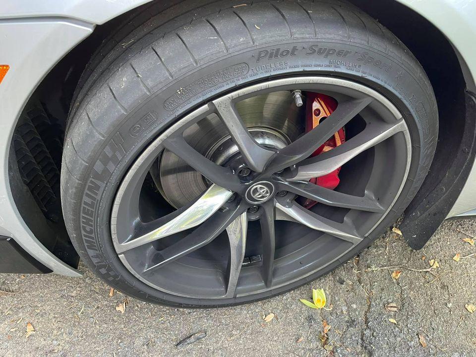

Too low and the tire flexes too much generating more heat and pressure, I usually loot at the side walls, this photo was after running at the Dragon in TN last week.
