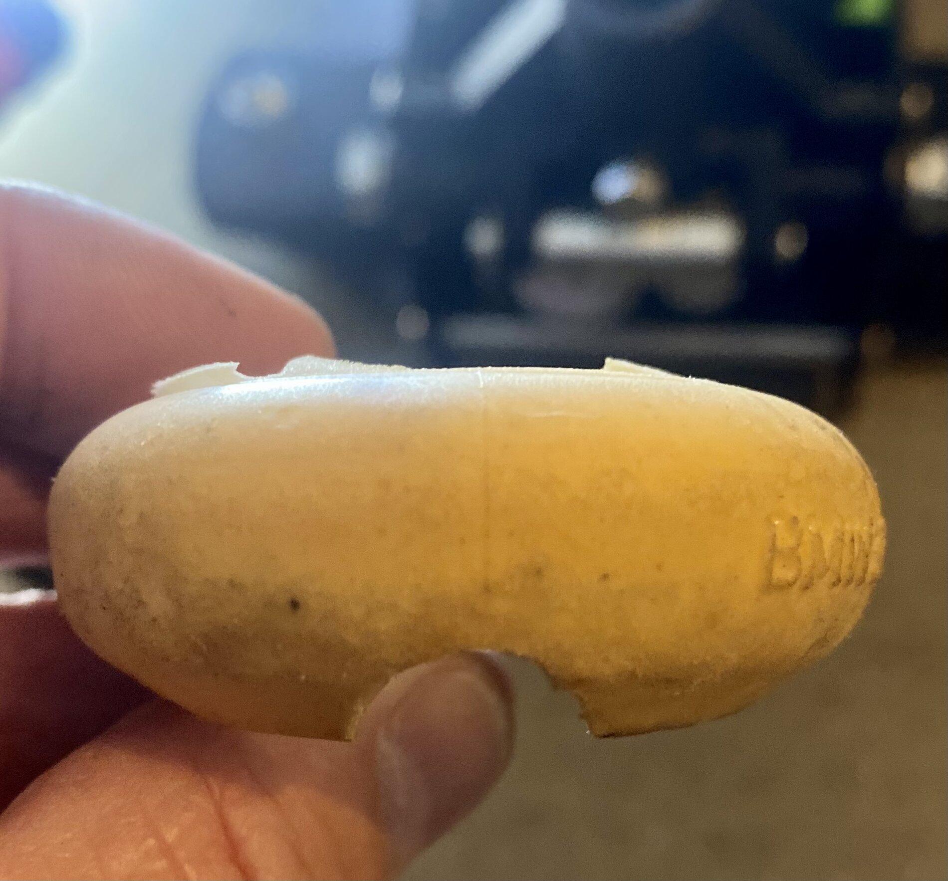

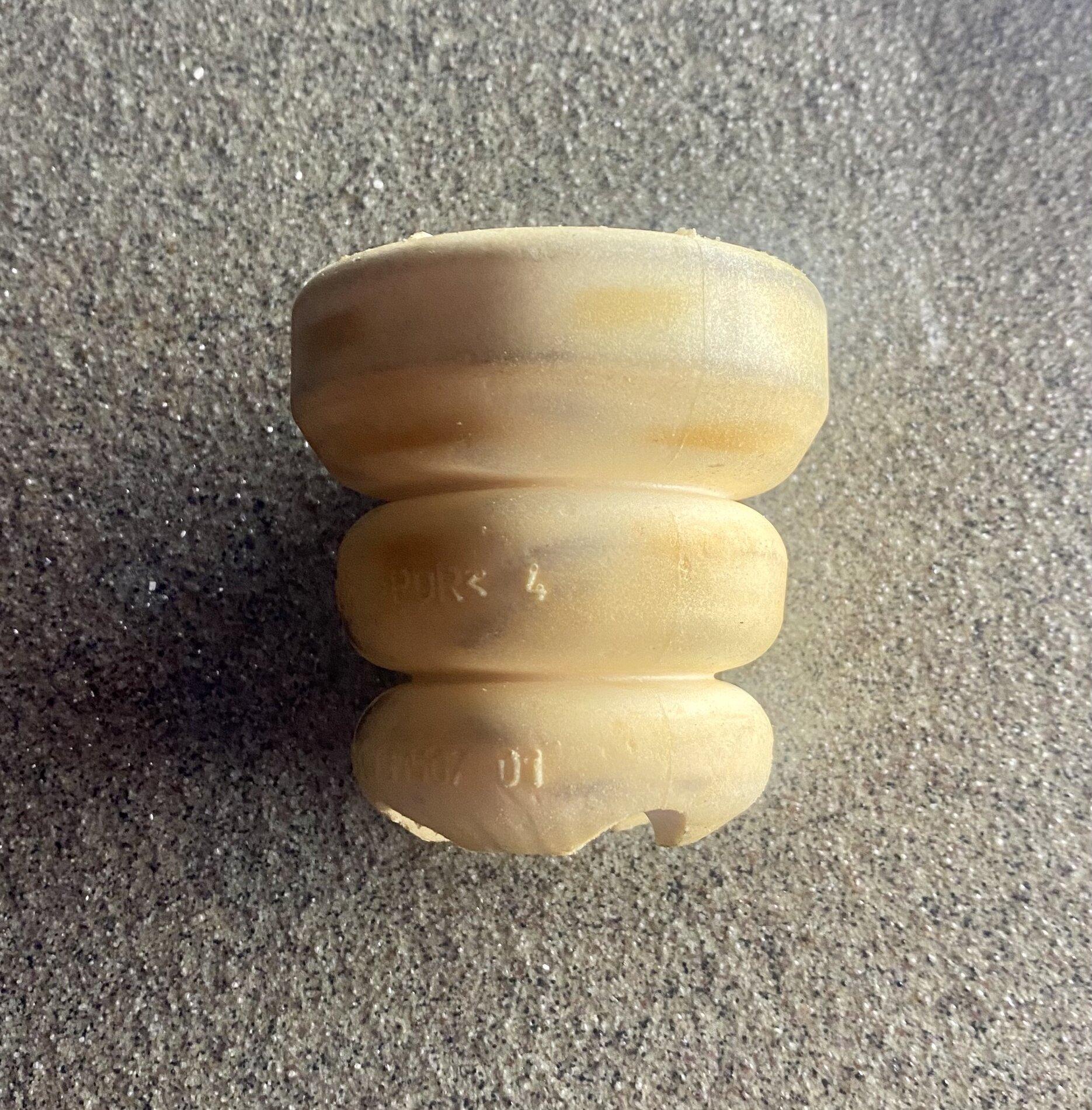

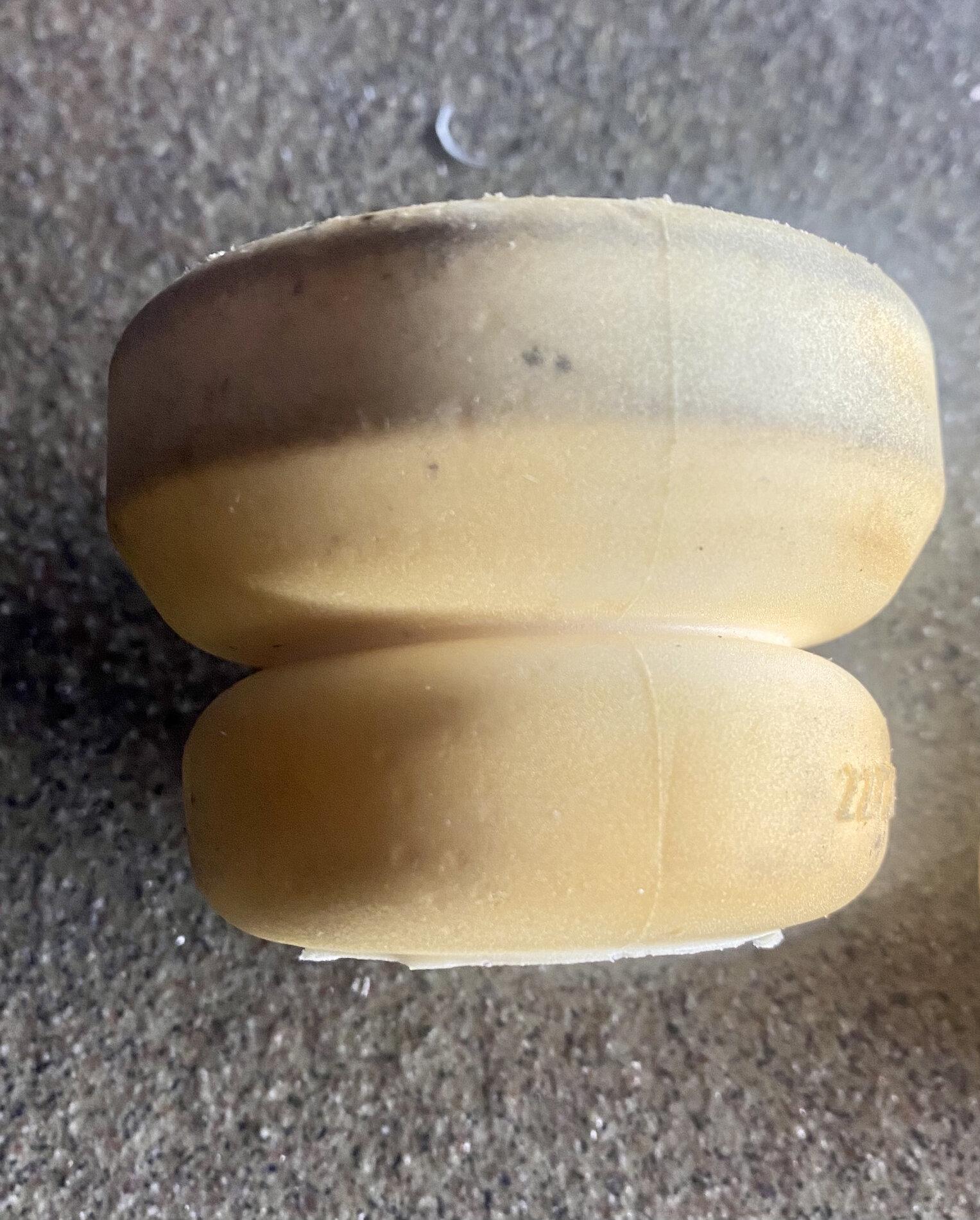

I cut one donut (round circle) off each of the bump stops when changing to lowering springs. Cut the rounded end - not the flat surfaces side.
See below:

You just trim the one round donut front and rear.
