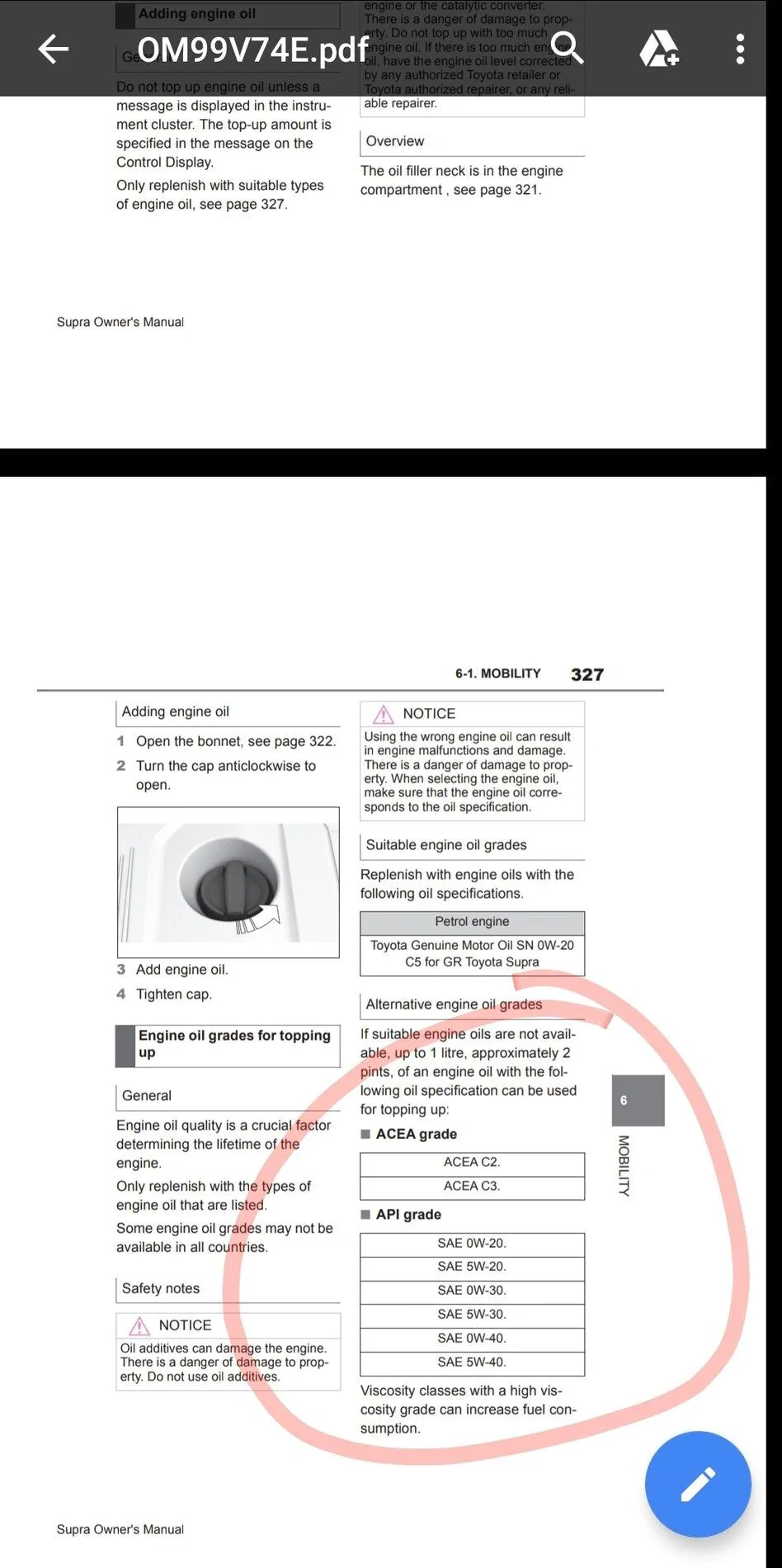

You could try 0-40W but I would keep with factory(0-20W) as higher grade oils have less fuel efficiency as described in manual.

If you're not tracking, you'll be fine with the stock oil even in higher ambient temps. Without actual empirical data on oil pressures+temperatures, there's really no point in just guessing on diff oil weights for the hell of it, as is the pastime of so many forum dwellers. Your car will run just fine on the factory oil, it was tested in your ambient temps as well as absurdly cold climates as well.
