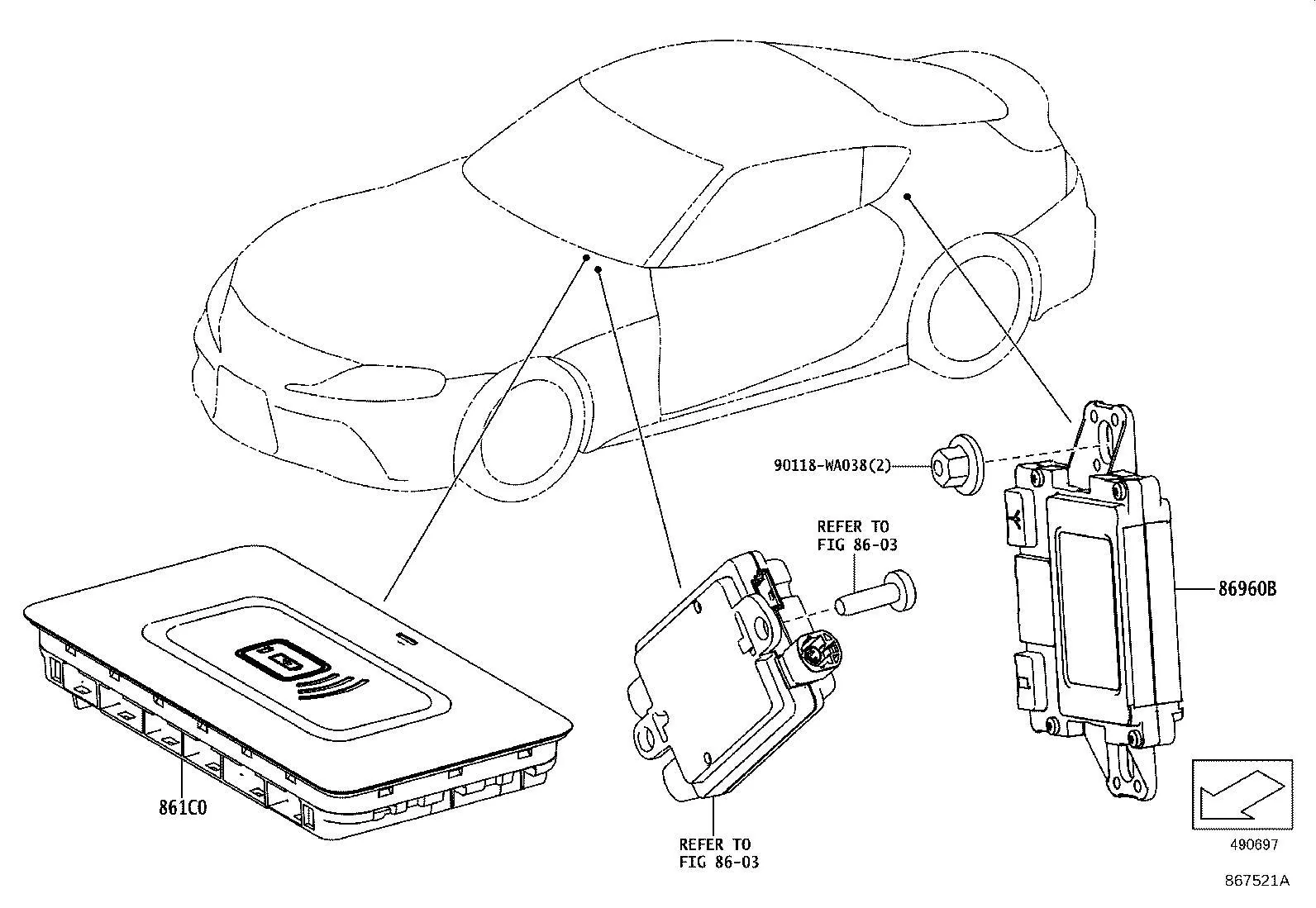

Unfortunately, Canadian Premiums have everything minus the wireless charging.
I'm trying to find out if it has the wire harness connectors in it (being unused) or if it's a different IP wire harness all-together. It would be super easy to order the wireless part and just drop it in. Potentially needing to activate the module in the ECU.
Does anyone have any idea? Have the adventurous guys popped some panels off and seen anything?

I don't know about this but a new BMW 5-series owner friend just bought wireless charging pad off of ebay and said he easily installed it.
I'm sure you can piggy back off the cigarette lighter plug. I don't know why you'd need the ECU other than the reminder feature of the car that throws a warning chime on the dash if you left your phone to charge but leaving the car..

it's just nice to have the feature built in and not use up the cigarette lighter plug and take up the limited room there is.

I'm saying buy the part and then use the wires underneath the lighter plug to power it up if there is nothing else around.

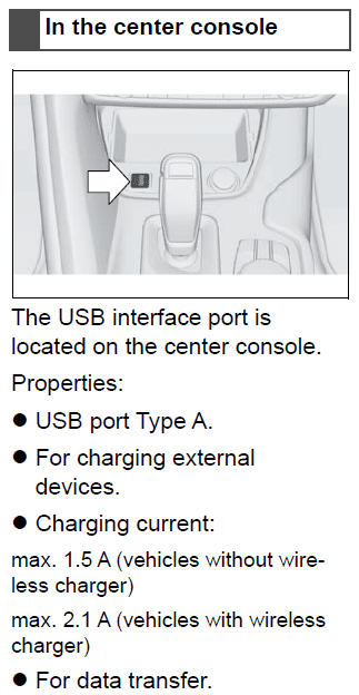

Also, FYI:
My S8+ with cover doesn't fit in there or I've to push it real hard. I am planning on not fiddling around with the interior parts, but when I do I'll check to see if I can 3d print a part that suits my needs.
