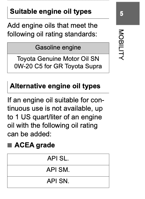

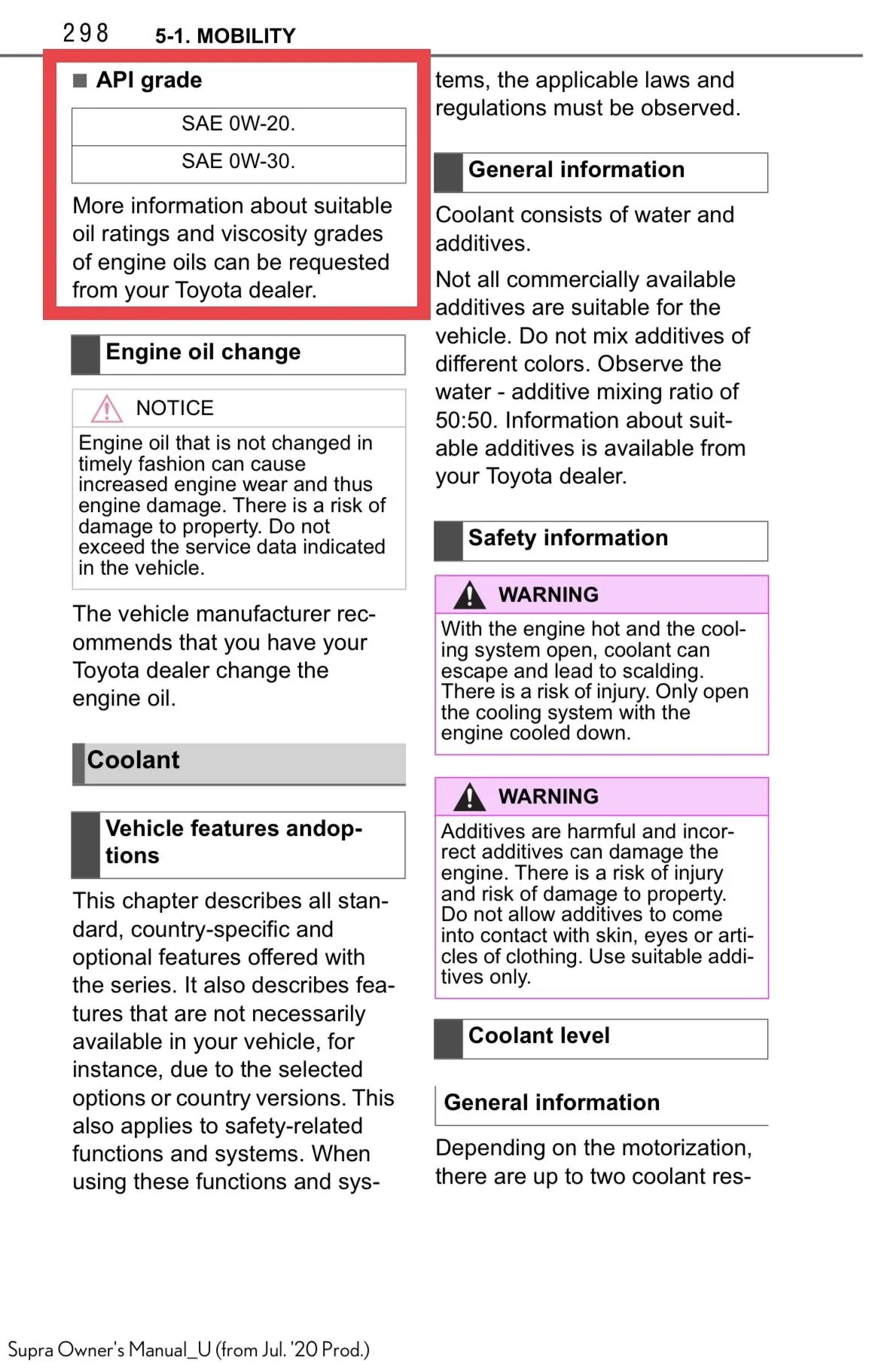

You will not void your warranty! Did you read the GR Supra owners manual? Toyota is approving a heavier weight oil as a safe alternative. See manual excerpt below. Also as you can see from the graph the 0w-20 is better for below zero temperatures but falls short in the hotter climates.
Let’s be honest these cars will rarely see below zero use, most of the driving will be during warmer weather days. Be informed my friend and make your decisions based on facts and not internet hearsay.
-RJM
It may be important to refer to the beginning of the highlighted section on the preceding page (pg. 297) for context, as it explicitly limits use of the "Alternative engine oil types," including the one you mentioned (0W-30), to up to 1 US quart/liter if the Toyota Genuine Motor Oil SN 0W-20 C5 for GR Toyota Supra isn't otherwise available. I am by no means an expert, and I concede that there are others on here who may well be, but I personally wouldn't vary from the manual on this subject out of caution that it may be used against me should an engine problem develop in the future.

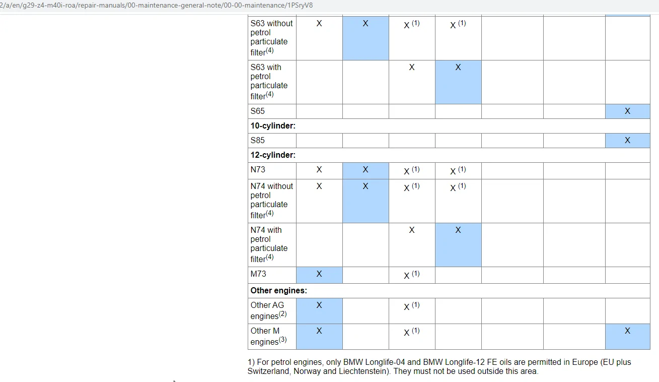

Found a 2019 TIS manual for the G29 Z4 that says the same. I very seriously doubt it matters if our gas is that low in sulphur, but it seems BMW's standpoint on LL04 hasn't changed. I'll err on the side of caution still.
