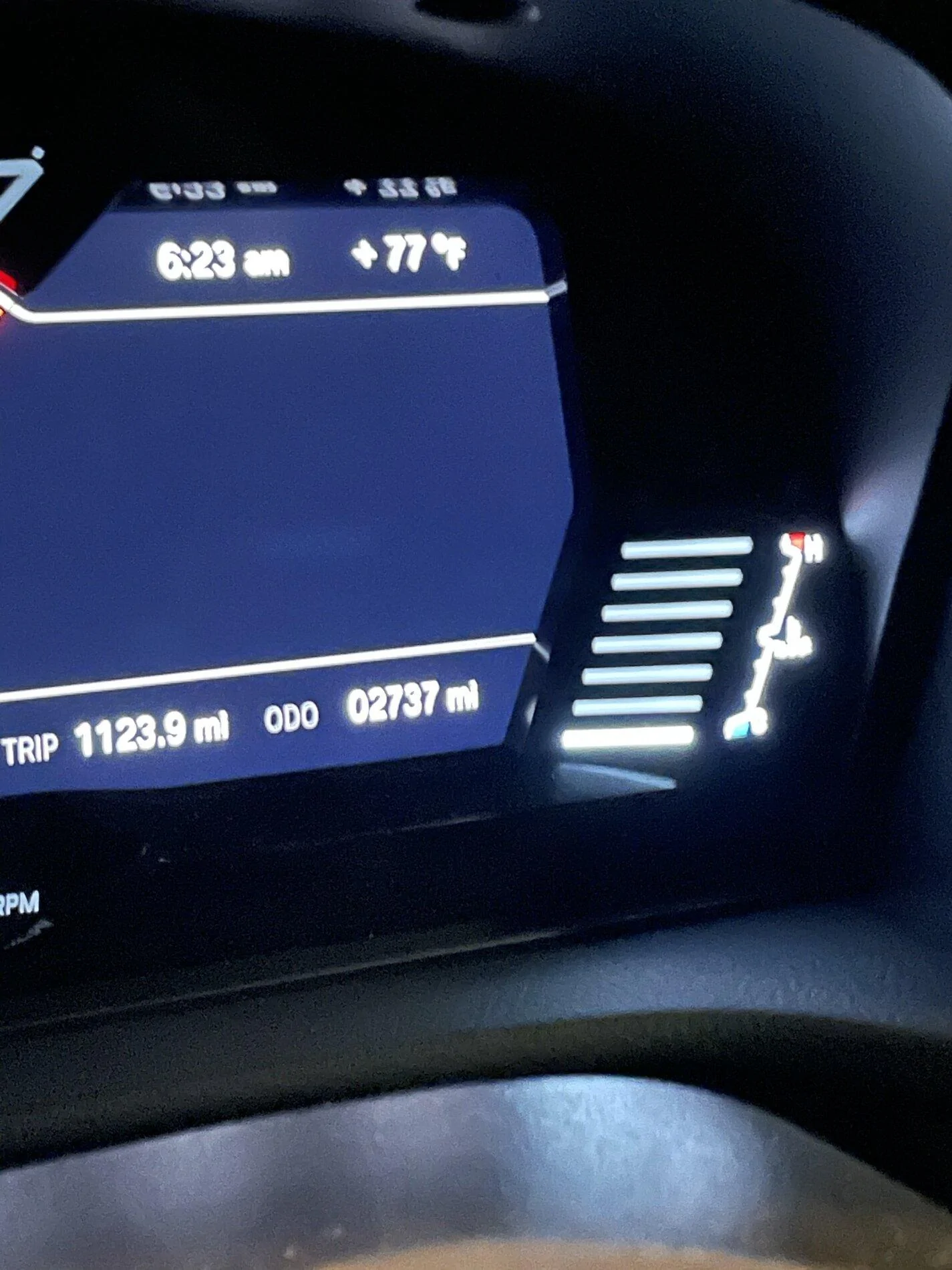

Last week after seeing this thread, I decided to do a measurement oil test. With 2737 miles, the minimum oil warning came up so I went to dealership last Saturday to fill it up and was told to drop the car today for follow inspection which required me to leave it over night. During the whole "break in period", I didnt baby it but I didn't floor it. Disappointed that this is happening but hopefully Toyota finds a solution for all our headaches.

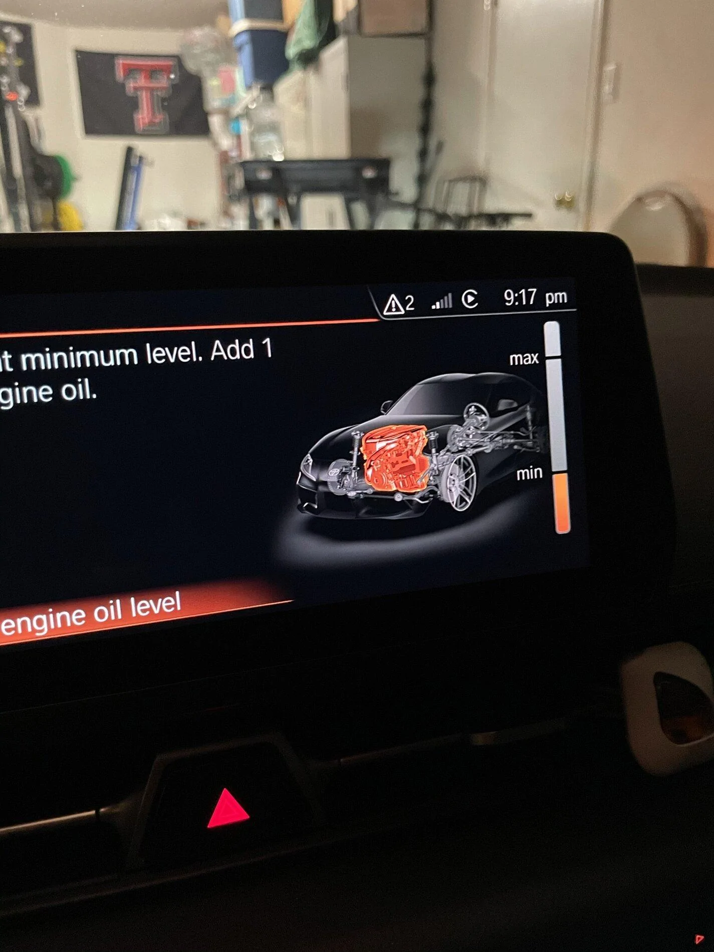

One thing Iā€™m still confused about...when we get the low oil warning asking us to add a Quart...does that mean our engine has burned through exactly one quart of oil? Or is the notification asking us to add one quart of oil to bring it back above the minimum threshold?
I was reading somewhere that low oil warning meant thereā€™s about ~3 quarts of oil left in the engine.
No definitive answer and it appears that everyone on this forum is assuming that if you get the low oil warning, you have only burned through one quart (which I donā€™t believe is correct).

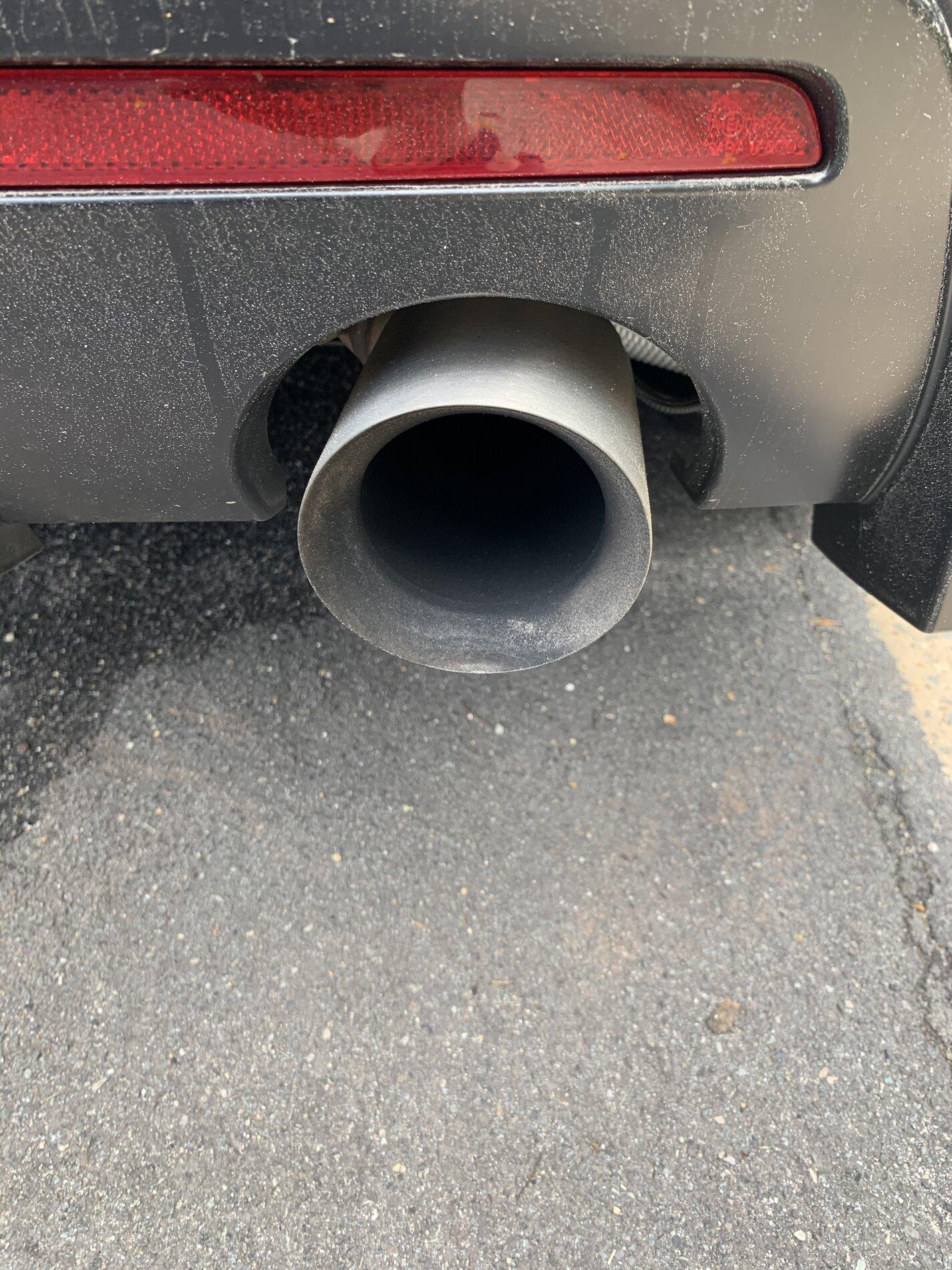

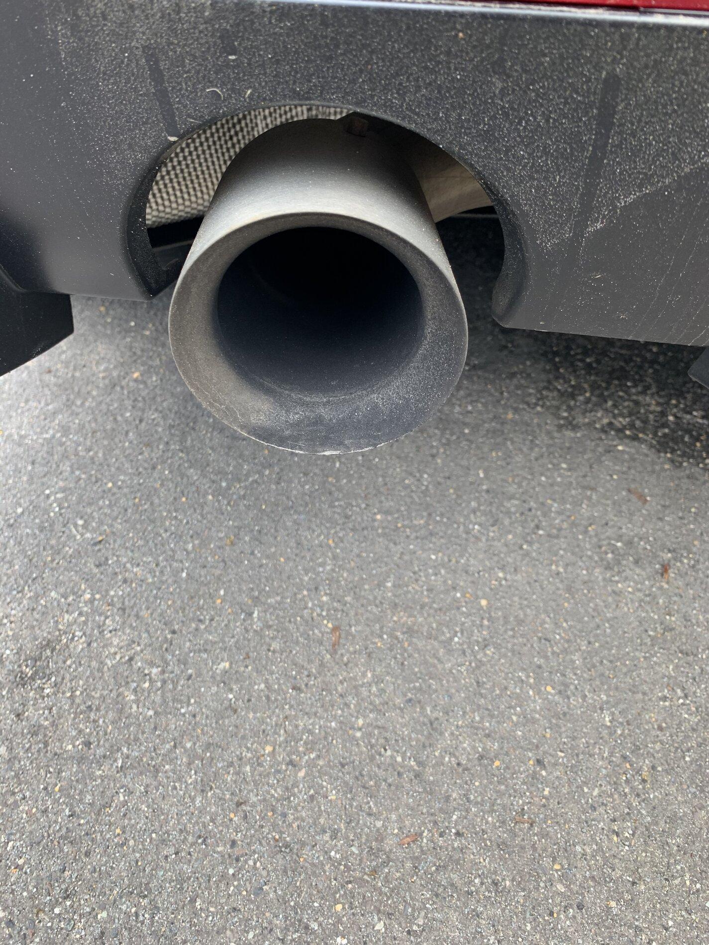

I got the low oil warning right before 5k miles and Iā€™m pretty certainy engine has burned through more than one quart, as noted by my exhaust that is COATED in oil.

Have you owned other turbocharged vehicles? I only ask because it's been my experience most of em end up with dirty exhaust tips mostly from what I learned was excess carbon. I had an Audi and a Golf whose exhaust tips would be covered within 100 miles of driving after a good clean. My Supra has actually been cleaner than those cars...but hey we all know what VW group does :rolleyes:.
Your photos make the exhaust tips look fairly dry and not wet, so I'm thinking that's probably not oil. But again I'm not the one there and I cannot physically inspect your exhaust.

Something definitely ain't right with that exhaust and engine health. Poor fuel/air ratio; blue smoke? I feel for those new A91 owners.

that just looks like normal carbon build up from a direct injected turbo charged car. Youā€™ll know itā€™s burning oil from blue smoke. Very unlikely oil makes it through the exhaust without burning up unless you have a catastrophic failure and pour all your oil out at once.
