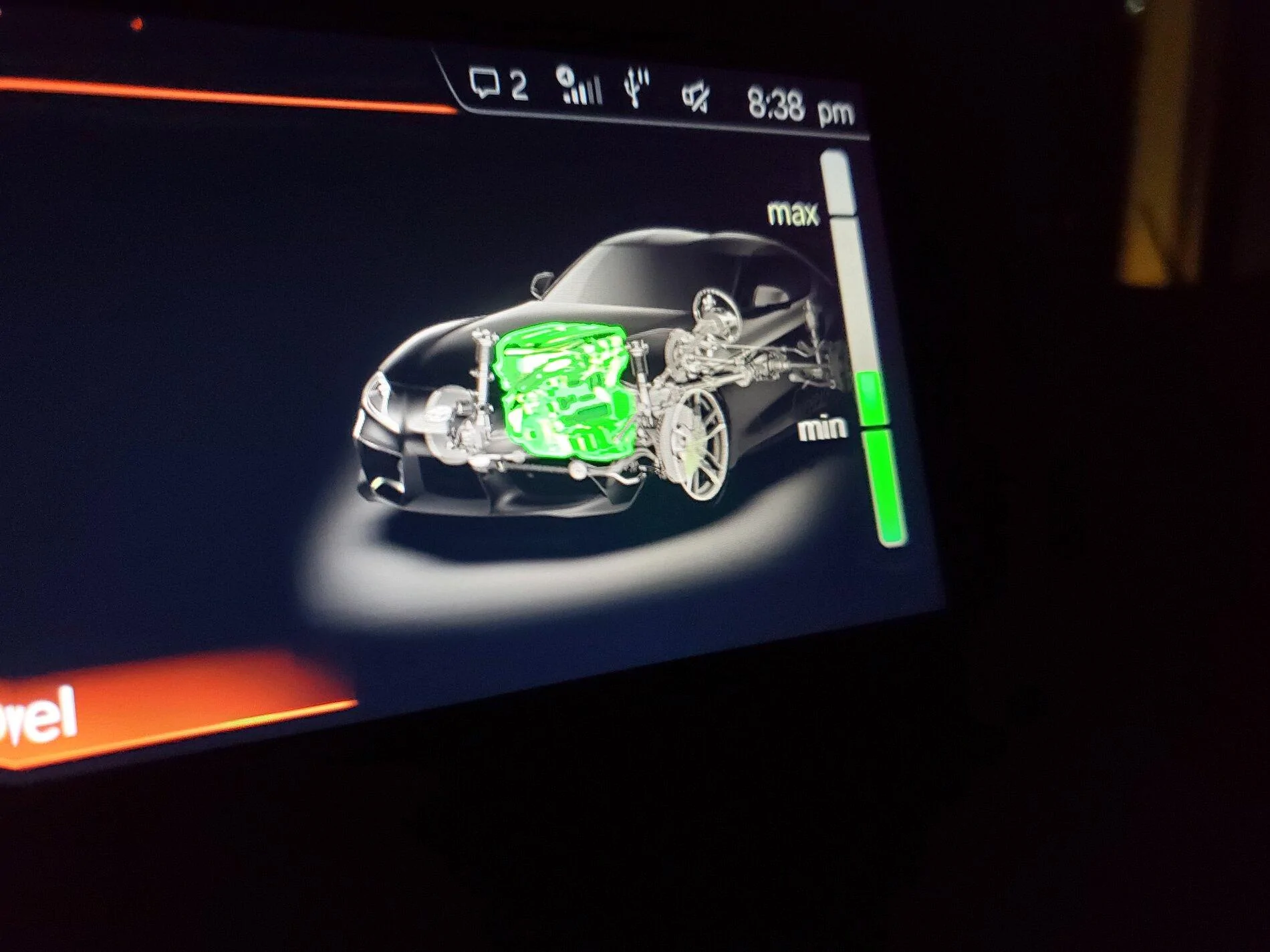

Tick below "Max" last time I parked the car. Had a spirited 70 mile drive this evening... Tick above "min" now.

When you get a chance, can you try to measure it again a few times over the weekend? Saw a few guys on Facebook saying they had the low oil readings after a fun drive, then tested it again a few hours later in a few different locations (they wanted to be sure they were legitimately on flat ground) and it came back with different oil levels. I doubt it's software related (bug) but maybe worth a try.

I really wish these cars had a dipstick. Its so much easier to see oil level that way. That or have BMW give us the tolerances for the graphic displayed on the oil measure screen. I bet money its at least +/- 1/4 quart in accuracy.

I understand why they went the electronic way, but I find not having a dipstick to be nerve racking at times.
