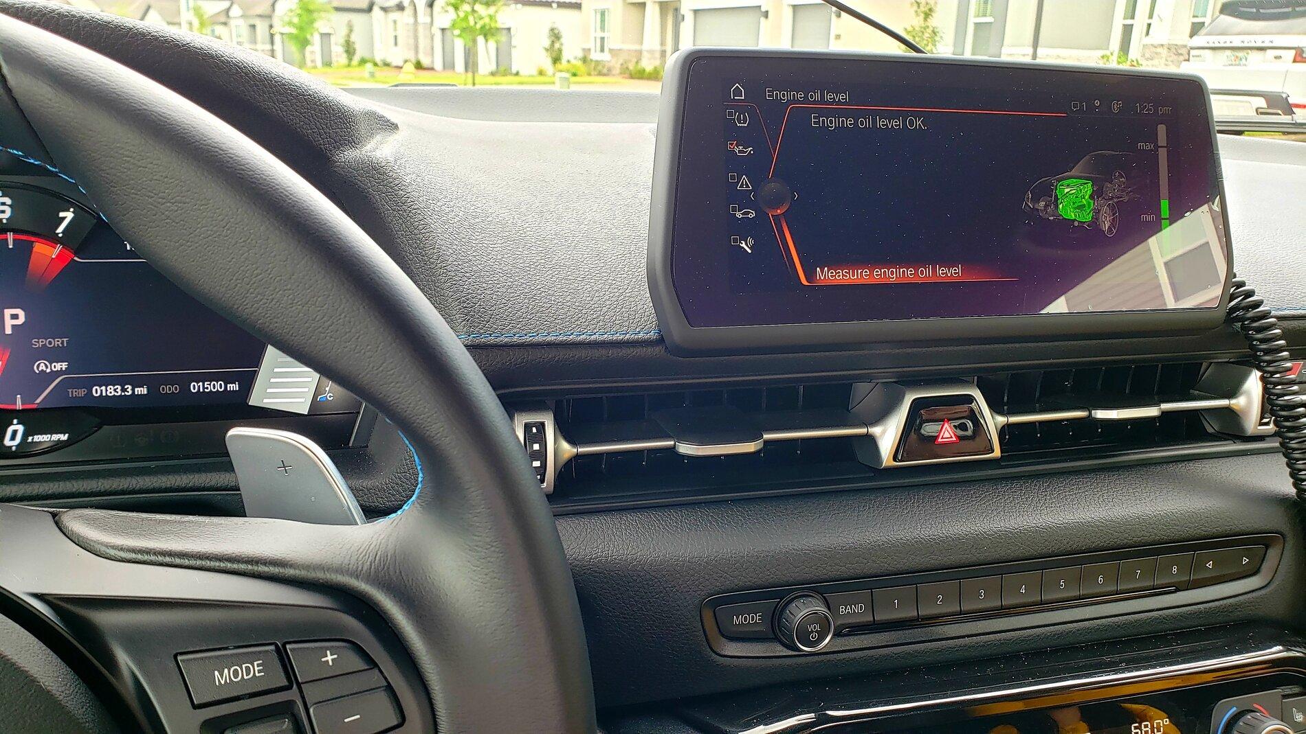

I put in 0.1q extra into mine, and it's nearly to MIN after 2500 miles. The key part being it went from MAX to MIN within the last 200 miles. I think there's just too many examples of this for it to be a mix-up or mistake of that nature.
I noticed the same rapid drop happening to mine as well. My Supra was at the Max level up to 1300 miles and when I checked again at the 1400 mile mark, the oil indicator showed me losing 1/4 a quart of oil. I finally hit the 1500 mile mark and the oil level is slightly above minimum.
I just bought a jug of Castrol Edge 0w20 and will top it off once I get the low oil warning message. When the car is due for its annual complimentary oil change, I'll provide the service advisor with the pics so they can begin documenting the issue.
Gah, that sucks, man. I thought I was out of the woods when I had passed 2000 miles since my oil change and not a drop was burnt. I am thinking that the max-min lines might be less than a quart, maybe half or a quarter, and that's why it rapidly drops.
