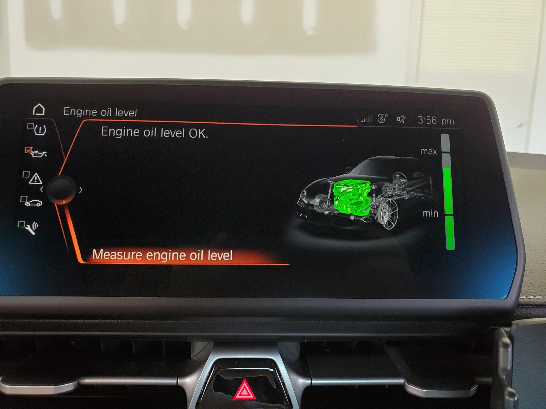

So I took the Supra out yesterday and today, racking up about 200 miles. The car is at 2,265 miles and this car has been driven HARD the entire time, I'm the first owner, the car had 18 miles on the odometer when I bought it. From the time it drove off the lot I've been sending it everytime I drive I. I checked the oil level today and this is the readout following a 60 mile trip filled with very spirited driving.
For clarification, this is a 2021 and I bought it back in October of 2020. It's a 6/20 build date car. This car HAS NOT had an oil change yet, this is still the original oil. For people who know more than I do, does this seem like a normal oil readout for a car still on break in oil, that has been driven pretty damn hard its entire life?

Yup. Looks perfectly fine. BMW states a quart per 1500 miles is acceptable and you're well above that, and you're nowhere near a quart low.

Thanks! Out of curiosity have you noticed your oil move off of the "max" line in any of the oil checks you've done? I suppose this question is for everyone actually, especially 2020s. Have any of you noticed the oil move from the max line at all?

No but to be fair, I drained that watery crap oil that came from the factory and put in 5w30 liqui moly. I'll update as times goes on. 2k miles on the moly and still reports full.
Never. I had mine since dec 2019

2020 or 21? When did you do your first oil change?

Mine has never changed. I did a hard break-in, as I do all my cars. I changed my oil around the 900 mile mark and put in 5W-30. I'm at about 2000 now. Still max.

2020 or 21? When did you do your first oil change and how often do you check the oil level?
Well I donā€™t think the the 2021 came out back in 2019. Lol
Itā€™s a 2020 and every 6 months. First change after one year.

I'm thinking I'm going to be swapping to 5W-30! I'm assuming the 0W-20 is just for less emissions crap? I've actually never used anything less than a 30w in my life.
