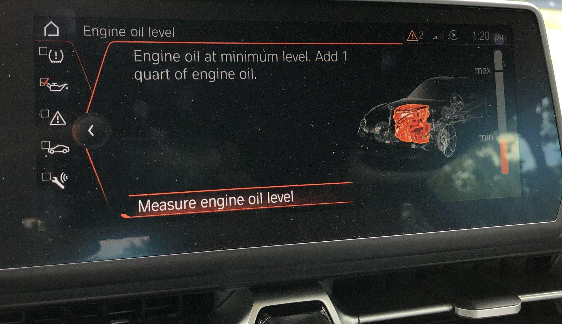

I'm running Amsoil 0w-20. I've already put one quart of the oil in. I'm afraid the dealership wouldn't do anything now because I don't have the low oil warning message anymore.
I'm gonna try and call them Monday to see if they have cases like this and make an appointment. I will definitely take everything off before going to them. I'm not risking it and let them have any chance to get my car flagged.

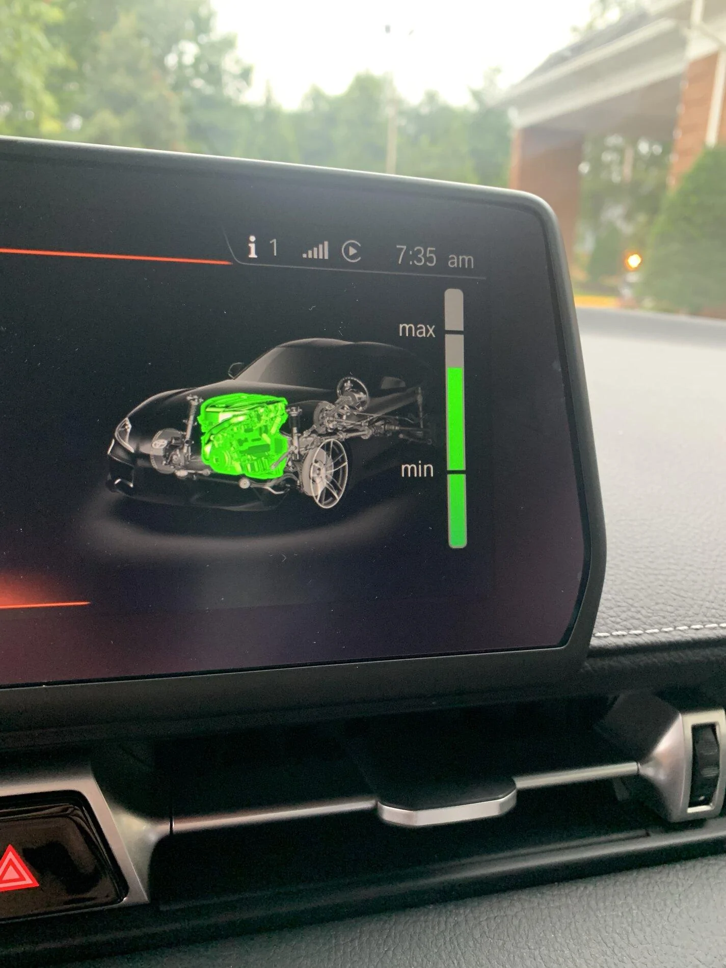

I had a low oil warning 450-500 miles after a recent oil change. I added oil as directed, and the level returned to maximum.
while the change below is within operating level, it adds to concern as there has been a measurable drop after only about 200 miles. No evidence of leaks.
this measurement was taken 200 miles after you topped up a quart? Seems excessive. Is there any chance that last oil change wasn’t topped up properly in the first place? Cos a low oil warning just 500 miles after a full oil change is also pretty crazy.
Yes, that is possible and is my hope.
What would be particularly telling is if it gives me the must add warning oil warning in the next couple of thousand miles. That’s the only benchmark I have. I added a quart when it said “must add” so when it gets there again, that should be a rough approximation of how many miles to 1 quart of loss. All we really know as of today is that a measurable amount of oil was spent in 200 miles.
if they were short on the oil change, could explain both the incidents. Since the oil measurement isn’t super precise, perhaps the change was short from “true full” by more than 1 quart in the first place.
i plan to run the oil measurement every 500km after the last oil change, to see how soon it drops.
good luck with your car, fingers crossed it’s a one off and the consumption stabilizes. Keep us posted.

I just had the low oil message pop up yesterday in my 2.0 after some spirited driving. Car has 6k miles (9 months).
After what I've read since yday about BWW turbo engines, break-in period, driving styles and the 1 liter per 1,500 miles rule, I think in my case 6k is reasonable.
Gonna add 1 quart of Toyota GR oil later today and booked my 1st service appointment for oil change on Friday, which I was planning on doing soon anyways.
