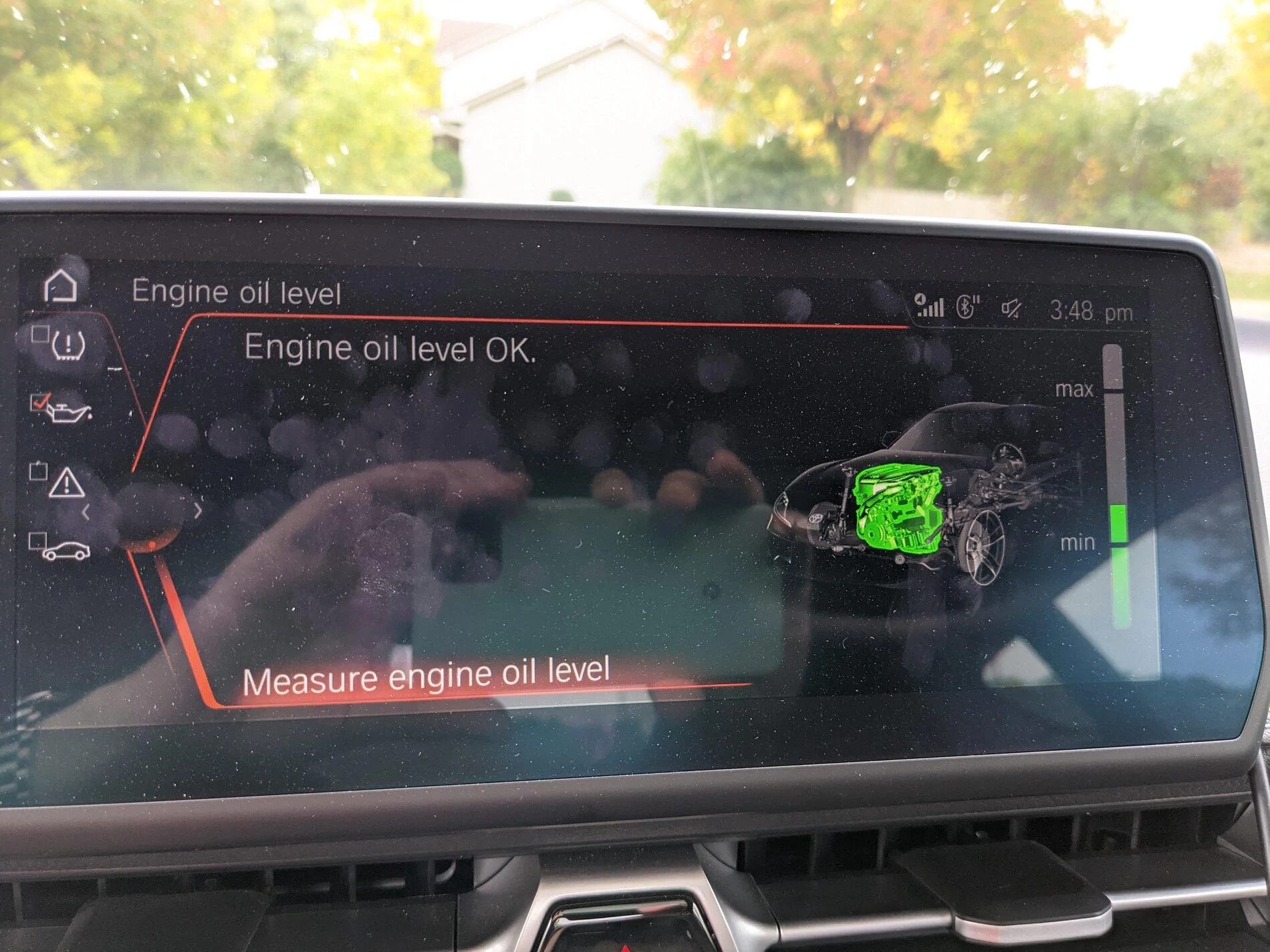

I was aware of the oil burning discussions and was doing regular checks. Factory oil never went below the max line during break-in.
Followed break-in and to be safe I had the Toyota dealership do an early oil change around 1,200 miles. (Checked it was factory GR oil which bizarrely was priced at $360 on the Toyota system).
Now car is at 4,300 miles the oil level is near the low level threshold (see image)
Meaning it has burned through that much in 3k miles ?
My driving has mostly been cruising and about 35% in sport mode(only when engine is up to temp), doing things like hard pulls onto the highway and occasional high speed duels with AMGs, STIs, Mustangs. Never tracked, no mods.
Spoke to the GR Supra tech at my dealership who owns a 2020 himself. Told me the majority of 2021s he's seen have oil burning issues and no resolution in sight. Just says take it in to measure the oil drained, examine the inside of the engine if I want and add the data to a long list of '21 cars being reported to the Toyota regional rep.
It appears to be running fine. Certainly no performance issues. Only slightly odd thing is I think one exhaust looks a bit dirtier than the other.
I've been looking at various forums, someone was suggesting a valve that regulates oil pressure might be at fault? Anyone hear more on this?
